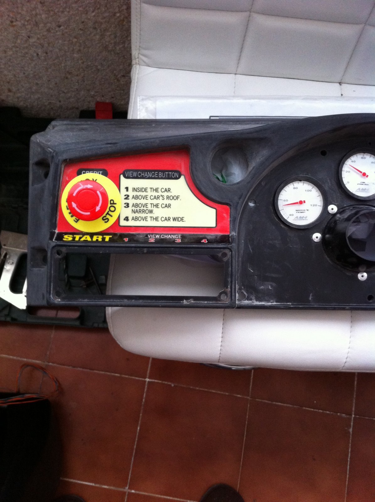

    I've also thought about safety, before a sudden there will be a push button type mushroom cut current engine when placing games without movement, interrupted current shall also mention mere precaution.
    This is the button, so I put it there to try, but I have yet clear your location.

    I suppose that you have connect it to the power supply HP DPS-600PB... in the input position o directly to the pins 6, 10, 8 to turn it on?
  8. Petar2
    Petar2 Member
    May 23, 2014
    59
    Valencia
    715Coins
    +42 / 0 / -0
    Directly to the input source

    What type of button you've bought?
    How many Volts and Ampere it manages?

  12. Nick Moxley
    17,057Coins
    +2,507 / 30 / -2
    All i did was use the 4-6-8-10 pins.....4 and 8 together and 6 and 10 together to the 3 separate "blocks" on my switch. Each block control's a 4/8 and 6/10 lead which when using a (Normally closed block) works exactly as it should, Button up is power on and kills when you push the button.
    Different PSU's but you should get the idea,
    Multiple blocks and Illuminated, These are aavailable for only Some of the kill switches.

    @Nick Moxley so if i connect the switch directly to the pin of the power supply instead of the input of the power supply i can not consider the Ampere of the switch?
    The emergency stop button is a simple NC On-Off switch with 2 pin?
  14. Nick Moxley
    17,057Coins
    +2,507 / 30 / -2
    Most of these switches are rated at 300-600v so no worries on the power.
    Yes the blocks can either be had in NC or NO. So its up to you how you want it to work.
    here's a link to a Spare block and close look at the switch i got.
    http://www.ebay.com/itm/221397882989?_trksid=p2059210.m2749.l2649&ssPageName=STRK:MEBIDX:IT
    he has other Voltage switches too, I choose 12v for the fact i can run the LED off the PSU when powered On.
    NC or NO blocks
    http://www.ebay.com/itm/321215203765?_trksid=p2059210.m2749.l2649&ssPageName=STRK:MEBIDX:IT

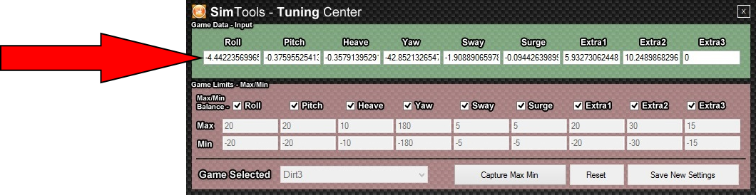

    Hi @Petar2
    Possibly a dumb question, but can you see flickering data in Tuning Centre?
    (You can open Tuning Centre in the System Tray
    TuningCentre.jpg )
  19. Petar2
    Petar2 Member
    May 23, 2014
    59
    Valencia
    715Coins
    +42 / 0 / -0
    Well it may seem silly question, it is not much, because I did not look at .....
    Thanks for the hint, I'll look as soon as I put forward the motion.
