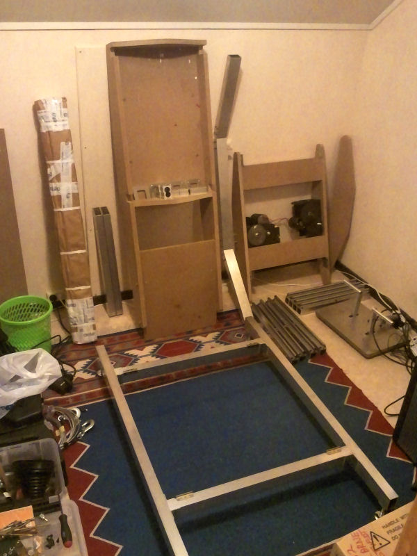

    I got a lot of work done this weekend. I decided to make brackets for the aluminum frame instead of welding, because it lets me modify and recycle the materials if I decide to change the sim later.
    This weekend I have made all the hinges, milled mounting feet, milled aluminum brackets and angles, mounted the servos, and test assembled most of the parts. I will paint the MDF parts before I try a complete assembly. Assembilng and disassembling it is a lot of work.

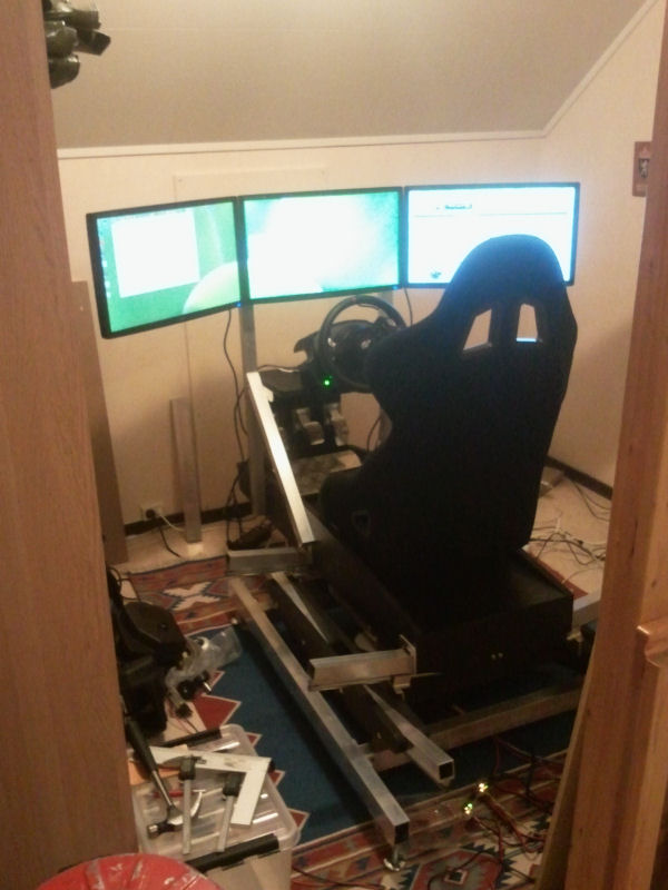

    Test-running the sim now, with me in it. It's plenty strong and fast. So much for specifications. :p The gear backlash is a bit of a problem though, and will have to be fixed later. It's really fast and throws me around pretty well at 13 V. The noise is not loud enough to be a problem with headphones. I the pitch control rod while jerking it back and forth in the Pololu software so I'll have to lathe some stronger rods, at least for the pitch, which has to move the most weight. I'm going to order a couple of 500W 15 V power supplies now that I've tested the servos and established that they will do the job.
    I will have to add limit switches and an E-stop to this thing to avoid breaking stuff if the feedback circuit is broken. I prepared a cable for it inside and will wire it up when I get the parts I need.
    Hopefully I can get the monitor stand and wheel support mounted tomorrow and try it out properly.

    I take back what I said about the noise before. It's really noisy. I hope it won't be too much trouble while playing. I think it's the mod 1.0 spur that's making most of the noise. That gear could probably be made from plastic since it's such a low torque stage, which I think would kill the noise.
    I tried driving in LFS with the sim running, and it works well, but I can't run at full power because I will bend the rods. It still throws me around pretty good when limited to 10 A. I'm going to get some thicker rods tomorrow. I'll also try to find some headphones. My speakers are downstairs on the desktop, while I'm testing upstairs, which doesn't exactly help to drown out the servo noise. :sos:
    Lots of work left, I'm going to enclose the rear part of the bottom frame with aluminum sheet. I just need to wait until I get all the componets I will install so that I know how big holes to route of the sheets.

    I replaced the pitch rod with a thicker rod, and it works, but as I was playing just now the roll rod broke in two. :D Guess I'l have to replace that one as well.
    Didn't have time to make new gears though. I made a short video of me riding it. Bear in mind I need a stronger counter balance spring on the pitch axis, and it hasn't been optimized at all yet. I'm just too excited to not play with it. :D

    I imagine the long + lateral force feels great from what I see, but is the roll and pitch limited to the strength of the long lat force. So you cannot move pitch and roll without moving long and lateral.
