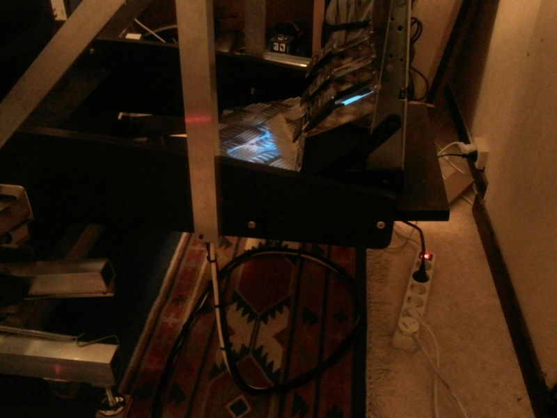

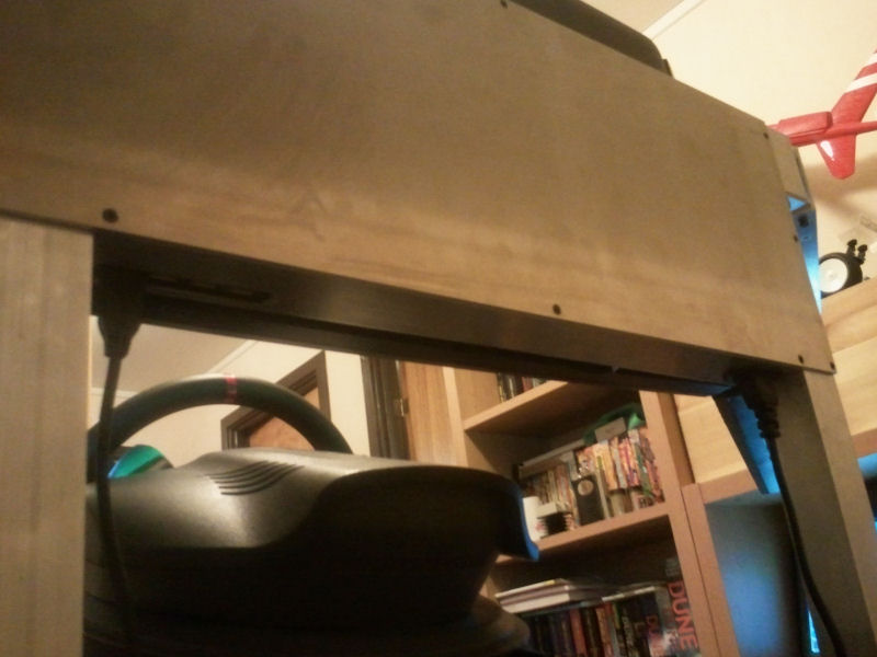

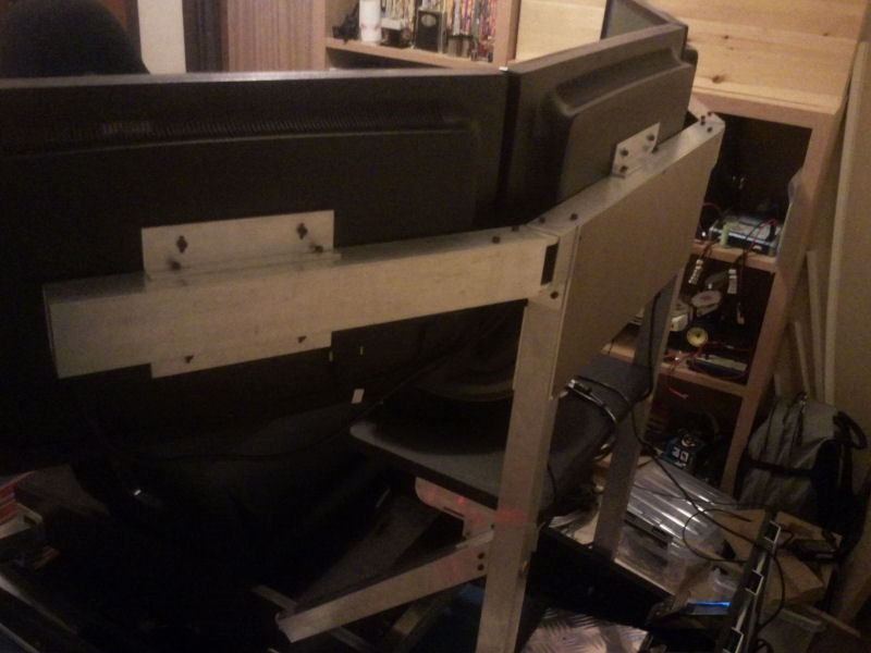

    Here are a few shots of the results of the work I've done this weekend. I have created an electronics box behind the monitors which distributes power to the wheel and three monitors, HDMI cables for each display, and a four port USB hub. The USB hub is accessible through an opening on the right hand side of the box, and power for the steering wheel is accessible on the left hand side, as shown in one of the photos. The cables run inside the aluminum tubes, and exit with a huge loop to spread the movement over a long section as the simulator moves. It's very tidy in front now. I have four available USB connectors for the steering wheel and shifter, or a bunch of helicopter/airplane inceptors. The steering wheel can be unplugged from the box and the whole table removed by removing four screws.
    When I get the PSU and doo dads for the sim I'll make the rear electronics box which houses the JRk's, PSUs and safety circuit.
    BTW. Can I daisy chain the two (or more?) JRk's together so that I only have to use one USB cable? Do I connect the TX and RX connectors on the two boards together and set the first one up for USB chained? I'm afraid to destroy it if I try, and the instructions are pretty cryptic.

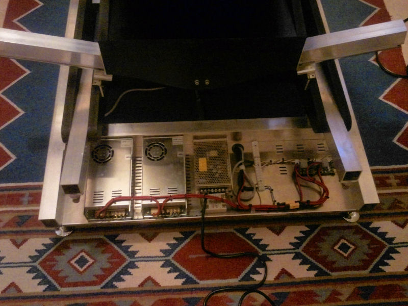

    I've CNC-cut and installed the bottom tray for the rear electronics now, and it's working fine. I also laid up the E-stop cable. The E-stop triggers a solid state relay which fires up the two main power supplies. I have three power supplies in there. One small 5v/12V combines PSU for the E-stop and fan, and two 500W 15 V units for the servos. I will make the top cover when I get the last power switch/connector. I can't cut it out until I know how big a hole to cut in the sheet. The power cable you see hanging over the edge is temporary while I'm waiting for the switch/connector assembly.

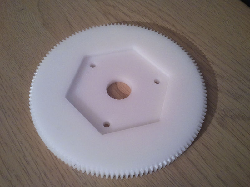

    Delrin arrived today. 9,525 mm (3/8) thick. I can mill gears now. Not sure I should bother until I get the new bearings though.
  14. tahustvedt
    tahustvedt Member
    Nov 23, 2011
    201
    62Coins
    +8 / 0 / -0

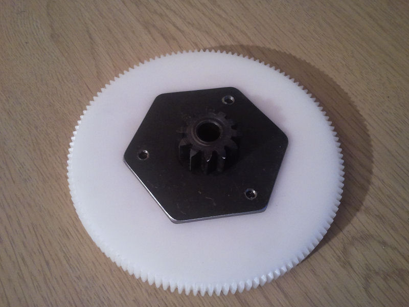

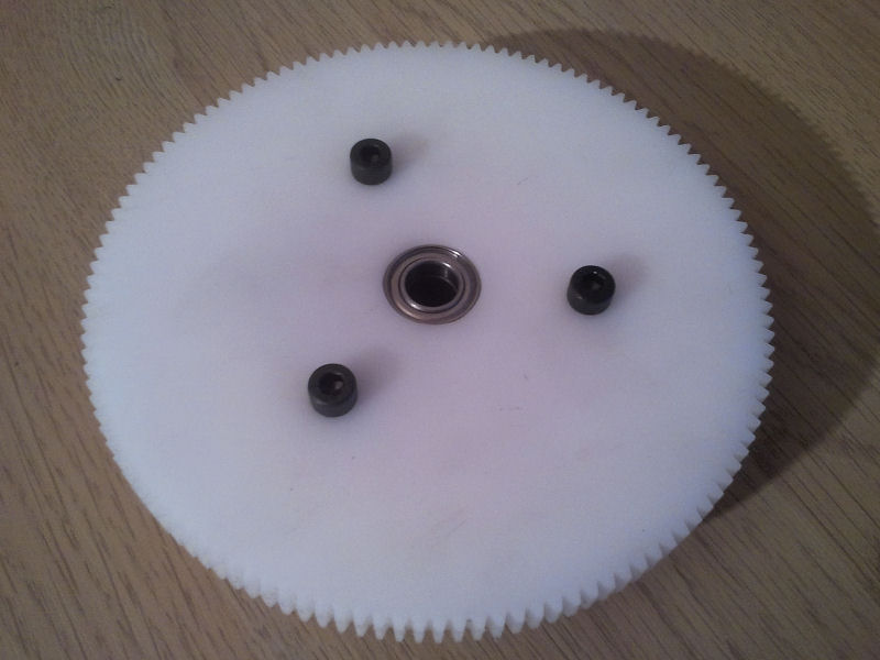

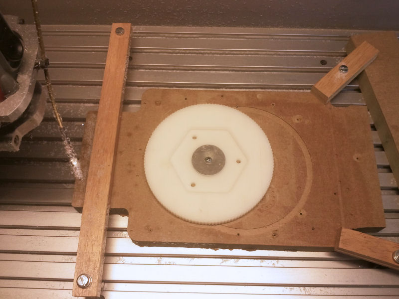

    Here's one delrin gear. It's 127 tooth, instead of 126 like the stock steel gear. That should tighten up the first stage just a little bit. Delrin is a very slippery material compared to the original, rough steel gears, and it doesn't ring like steel. :)
    It turned out beautifully, but my control pendant started acting up and I had to re-align the CNC router half way, so it might be ~0,05 mm off center. It probably won't make any difference though.
  15. tahustvedt
    tahustvedt Member
    Nov 23, 2011
    201
    62Coins
    +8 / 0 / -0
    I installed it on my pitch-axis, and man is it quieter! :D It's a mellow whine now when I go from end to end as opposed to a loud grinding sound.

  17. tahustvedt
    tahustvedt Member
    Nov 23, 2011
    201
    62Coins
    +8 / 0 / -0
    I made them myself. ;)
    The delrin was USD 34,28 plus 11,60 shipping for a 3/8x10x14 plate from a surplus store on Ebay.
    I lathed the mounting shank of the shaft for the gear as well to let me adjust the gear mesh. Worked great. I think I'll lathe the inside of the pinion to fit a ball bearing there as well.

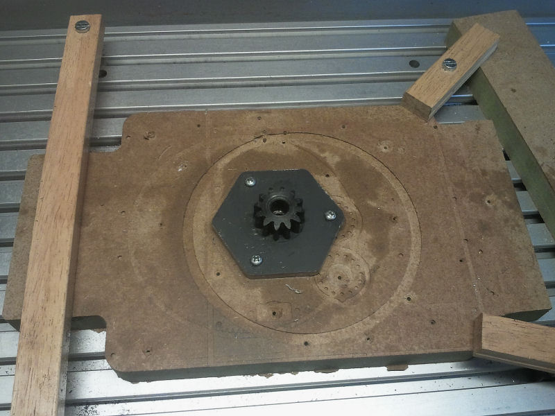

  18. tahustvedt
    tahustvedt Member
    Nov 23, 2011
    201
    62Coins
    +8 / 0 / -0
    Here's how I mounted it. I milled away the outer part of the original steel gear, and made it fit inside the delrin gear. I'm gonna order a lot more Delrin, because this is some fantastic stuff.

  20. tahustvedt
    tahustvedt Member
    Nov 23, 2011
    201
    62Coins
    +8 / 0 / -0
    I use a software called Vectric Aspire (http://www.vectric.com)to prepare the parts for routing, and move the files to the CNC computer with a USB memory stick. I draw the parts in either 3D Studio Max, or Aspire if it's simple, but any CAD software will do. The router can be controlled by a PC running Windows or Linux. I'm running Windows and am using something called Mach3 by Artsoft: http://www.machsupport.com/
    The machine was made with manual tools, for the most part a bandsaw, circular saw, pillar drill, and threading tools, and is made from aluminum profiles and sandwiched aluminum/MDF/aluminum. The rails and screws are high quality linear rails and bal screws that I bought used on Ebay. The CNC controller is a G540 stepper controller from http://www.geckodrive.com, and the spindle is a Kress FME 1050 10.000-30.000 rpm spindle.
    Everyone should have a CNC router in the workshop. :)
