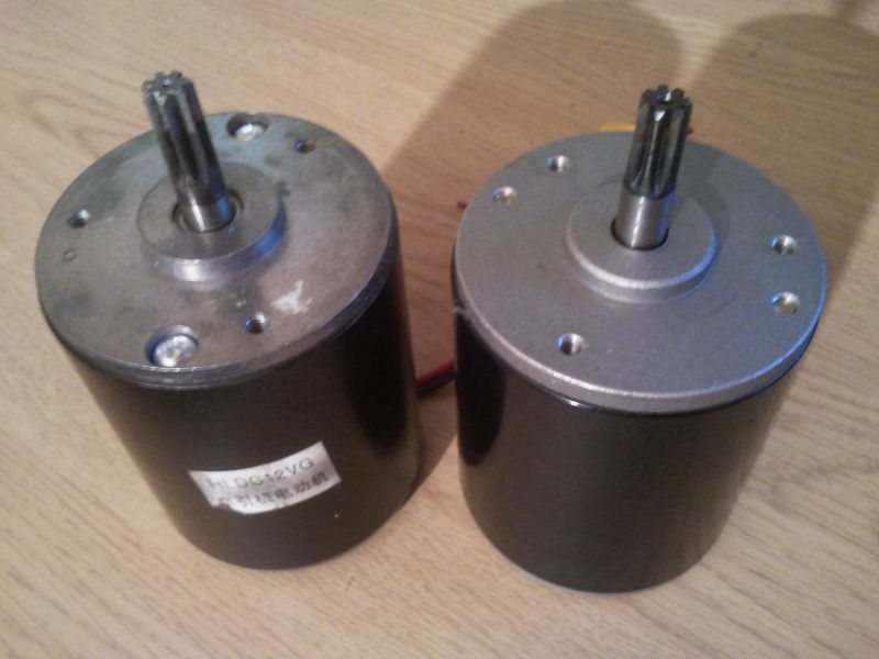

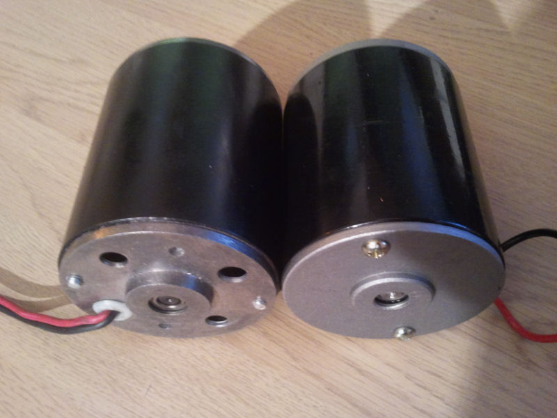

    I fixed the broken wire now. It had rubbed against a gear earlier, and I thought I had caught it before anything was damaged, but before I test, I'm gonna replace the noisy roll motor and see if it makes any difference. I got another winch today, and luckilly it had the same kind of motor that the pitch servo has. The old roll servo motor has a little different looking motor, with slightly different shaft diameter, play in the shaft, and visibly different gear teeth. The new motor is the same type as the one II have in the more quiet pitch servo.

    Awesome! That did the trick. The new motor is quiet like the pitch servo.
    It behaves like the pitch servo as well, meaning the PID values for the old motor caused it to oscilate. I like that!
