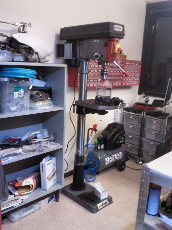

    A new tool.

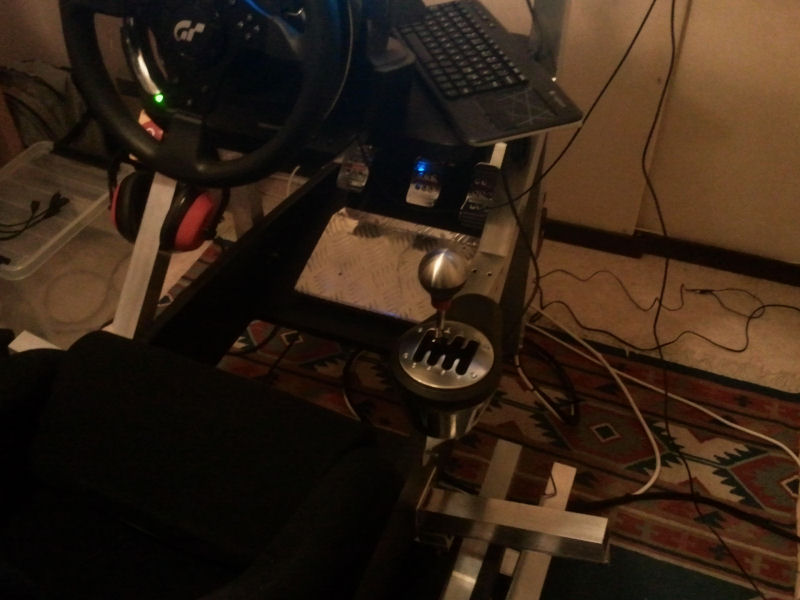

    The shifter arrived today. I went outside and measured where the shifter on my car sits, and made an arm with a hard mount for it using my bandsaw and new pillar drill (I gave away my old bench drill yesterday). It's very rigid and won't budge at all . The shifter is a disappointment, though. It doesn't feel anything like shifting a real car, and shifting down from right to left is weird and dirfficult. It's way too smooth to feel realistic, and feels too light. It's sturdy though, and looks like it can take a lot of abuse.

    I think that there is a screw for adjusting the shaft strength (I saw it on product presentation video). Maybe you could try to get more feedback with it :?
  10. tahustvedt
    tahustvedt Member
    Nov 23, 2011
    201
    62Coins
    +8 / 0 / -0
    Yeah, I tightened it as far as it would go yesterday, and it's still a little light to my liking, and I'm worried that it will wear prematurely due to being at the maximum tightness. I'm probably being a little too strict with it though, but I think it's just too smooth. I think the notches are a little too soft. I haven't tried any other PC shifters.

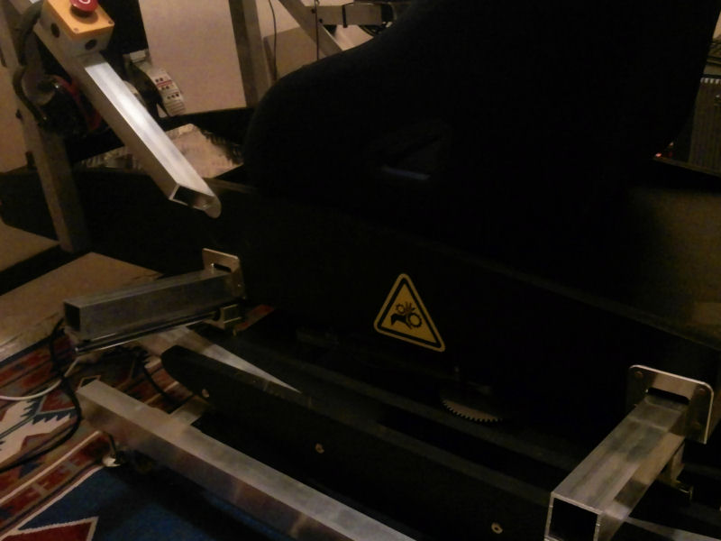

    I got the new bearings I need for the servos in the mail yesterday, so hopefully I'll find the time to make the new parts I need this weekend. I made some pinch hazard warning signs out of plastic this morning. One for each side of the sim above the servo gears.

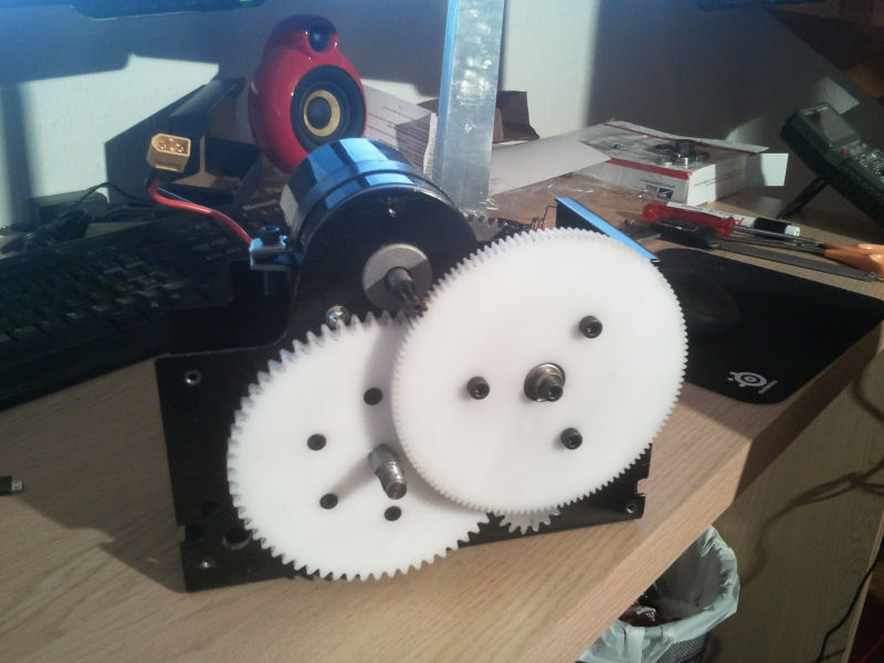

    I finished modifying one servo now. It's as good as slop free. Before there was 20 mm of slop at the end of the arm I'm using, because the slop in the gear train is amplified by the 270 mm long arm. Now there's about 1 mm of slop in the end of arm. :D It can't get much better than that without binding. I also made a delrin gear for the second stage, and will test to see how long it lasts. I made an aluminium hub with a clamping mechanism to absorb any play in the shaft intersection.
    You can also see in the picture that there is no wear on the first stage delrin gear I made earlier.

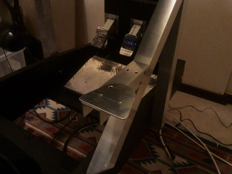

    I installed the pneumatic cylinder and made some connections to make a working air system. It needs 3 bar to cancel the front heavyness, which translates to 24 kg of force. I have made it so that the cylinder is compressing, so there's no chance of it buckling under the pressure at any time. Cool stuff! It's also air tight. After half an hour the pressure has not dropped at all. I'll leave it pressurized over night.

    The pitch axis is so much better than the roll axis now. Awesome! The spring is invisible to the movement.
