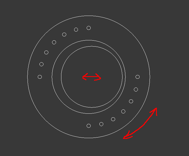

    Good to hear! How did you modify and improve the gear? By replacing the bearings? Most of my backlash is coming from the gear too and I'm thinking of replacing the bearings with proper ball bearings or so. I would be interested to hear how exactly you reduced your backlash.

    I replaced the sloppy bearings with new ones that have a slightly smaller outer diameter. Then I made eccentric bearing cups for them so that I could adjust the gear mesh by rotating the cups, and lock in place with a screw. I also made a clamping hub for the shaft flange to eliminate play there.

    Here's a drawing showing the principle of the eccentric bearing cups. As I rotate it, the shaft is moved left or right (and up and down, but that doesn't matter). Smaller holes around the flange let you lock it down in steps with a couple of screws. To adjust, remove the two screws and rotate until the next hole to bring the gears closer together or farther apart.

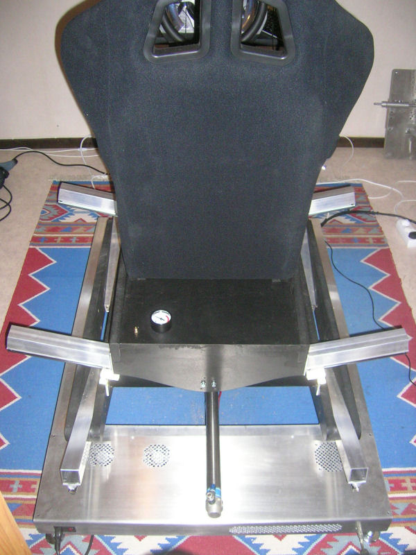

    Here's a view of the rear. The cylinder housing is sticking out. It moves with the pitch axis. I will remove the connector on the end as I don't need it. The soda bottles sit just under the seat plate, in front of the pressure gauge. In the top right corner of the picture you can see my home made helicopter pedals, modeled after our Westland Lynx pedals, with a hydraulic damper for smooth resistance. I can't wait to try them in X-plane with the stick I plan to make.
    I have pressurized a lot of soda bottles to over 9 bar lots of times before without a single failure back when I made a bottle rocket launcher. They can handle a lot of pressure before they burst. Next to the pressure gauge is the connector for filling with a regular tire filling gun.

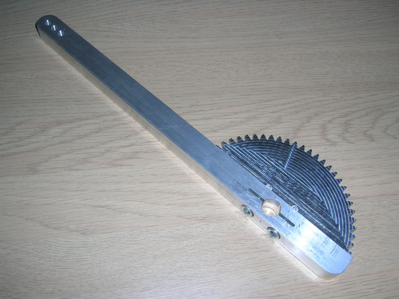

    Here's what I made today. It's a new output arm with an integrated gear. The gear teeth are 8 mm thick, and much smoother than the steel gears. Hopefully it will last. I found some bearings I can use and will make a new shaft. I needed something that is stiffer than the stock gear setup as it was working itself loose. The shiny surface pattern you see on the gear part is actually smooth despite the look. This is what it looks like straight after machining. The reason CNC-machined parts that you can buy don't have these patterns is because of post processing/polishing that is done. I had to mill down that surface so that the small tools I use to make the gear teeth can reach. They are just 9 mm long, and will crash if I don't think out the 15 mm slab first.
    Do I have the longest servo arms in the sim community? :D

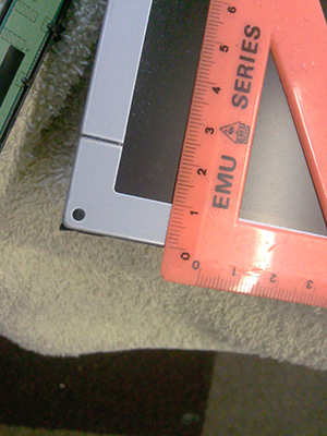

  20. BartS
    BartS Member
    Oct 10, 2010
    156
    417Coins
    +5 / 1 / -0

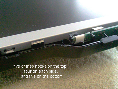

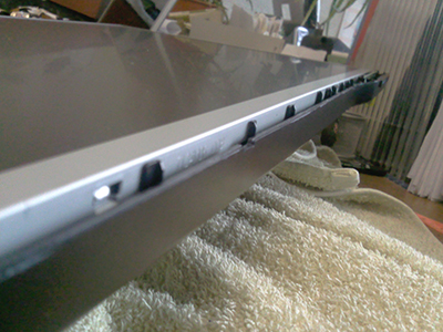

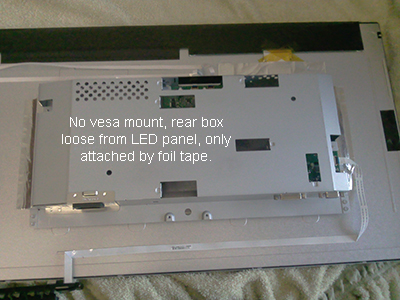

    tahustvedt what kind of monitors? ] I dont know if you may be comfortable with doing this but I recent test debezeled mine and found it very easy altho I found theres no vesa mount on the internals means Im going to have to build a custom support casing. With my Benq LEDs all I had to do was prise away very carefully to remove the front bezel. Heres some pics
