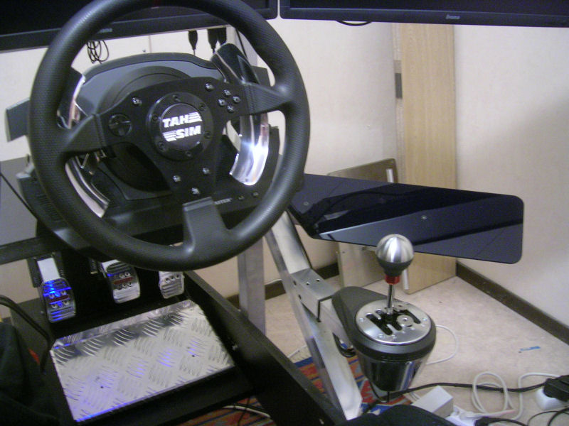

    I added a personalised center knob to replace the original Gran Turismo logo on the steering wheel. Turned out better than I had hoped.
    EVERYONE SHOULD OWN A CNC ROUTER!

    Today I made a keyboard mount out of some waste profile and a little plexiglass which I painted black on the back.
    Next up is to make a better shifter gate and maybe a custom shifter knob.

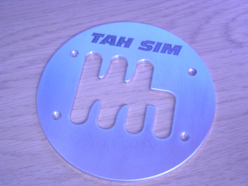

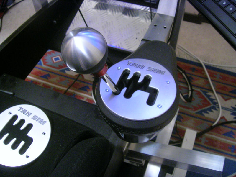

  9. tahustvedt
    tahustvedt Member
    Nov 23, 2011
    201
    62Coins
    +8 / 0 / -0
    I made a couple of shifter gates, painted the letters gunmetal grey, and polished the surface slightly. Turned out great, and operates better than the original gate.
