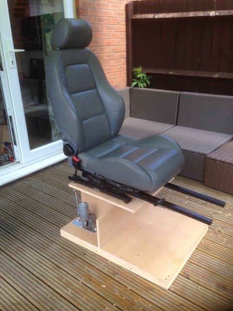

    Lots done today :thumbs

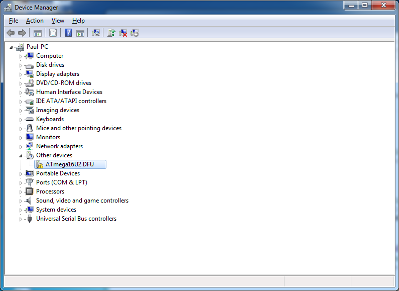

    Struggling today, presume this ATmega16U2 DFU driver problem could be at the heart of my troubles. Any ideas where I get an updated driver from or if I need to?
    Have read soooo many articles on this today!

    +300 / 2 / -0
    Did you install the latest version of Arduino software?

    What operating system and arduino board u using ?

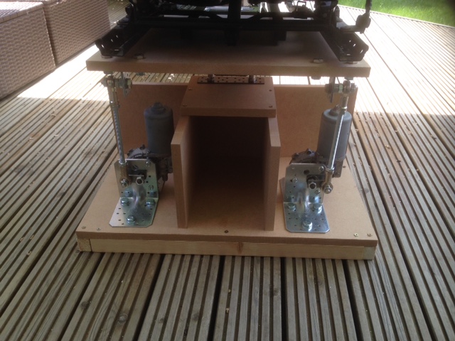

    Final update of the day.
    Seems I had not connected to and amended the sabertooth board code. That is now done.
    Now both motors have power and if I use the output test they both move randomly but this does vary when I move the sliders. This is whichever way round I connect the pots.
    No idea how to progress from here but I have spent the whole weekend working on it and need a break.
    Any ideas gratefully received for what to try next, thank you all!

    Sounds like you're very close. If you can move the motors in output testing you are nearly there.
    Check the virtual output with game data as well. Make sure it's recieving telemetry.

    Decided to set up iracing and connect the two PCs tonight. All has gone ok and the virtual output is correct :thumbs
    Still have motor issues though, they keep rotating 2 or 3 x 360 degrees. Have set the roll and pitch to 20% each but still the rotating. The pots are connected to the right motors and the polarity seems ok too for the 24v to them.
