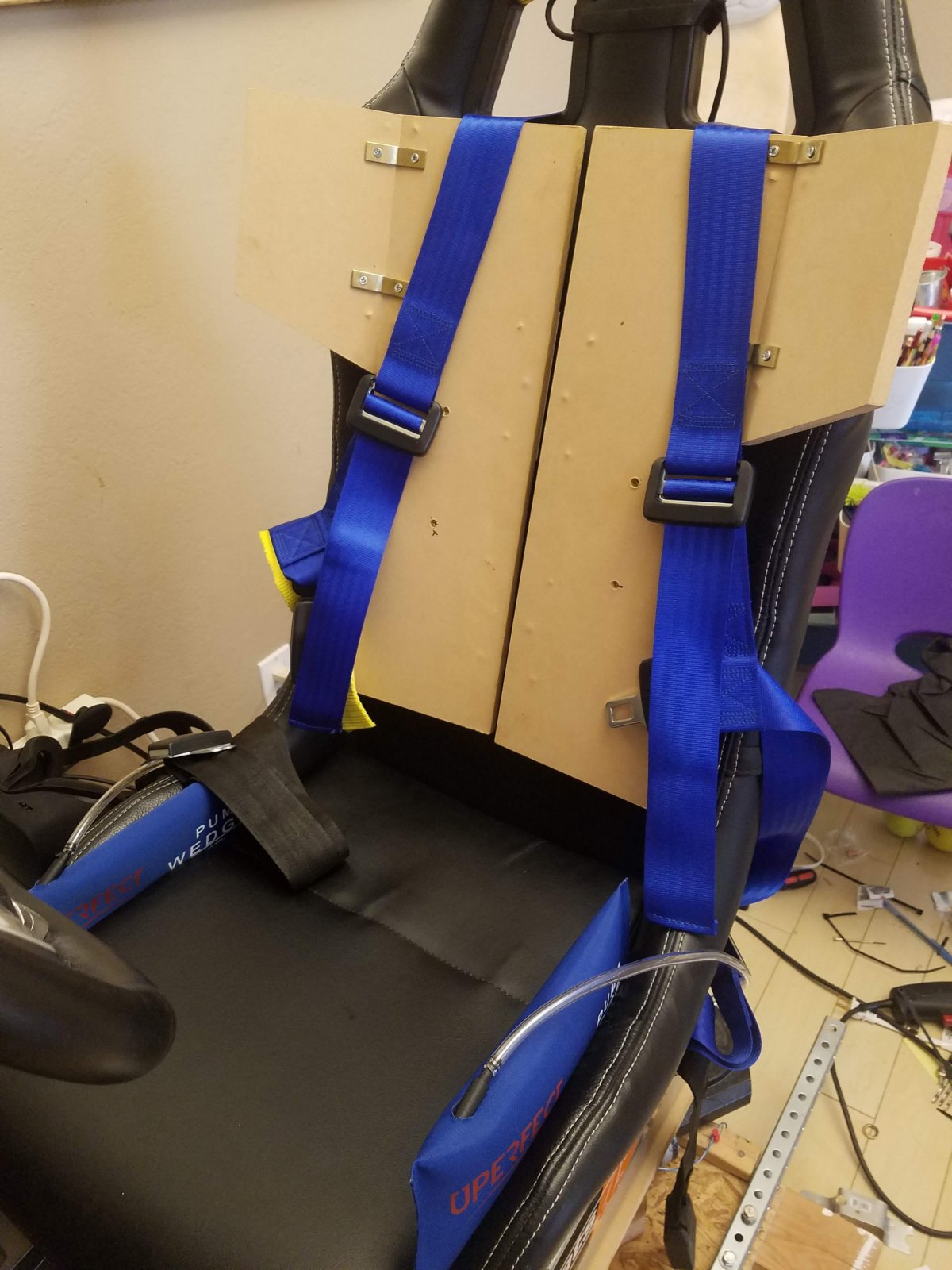

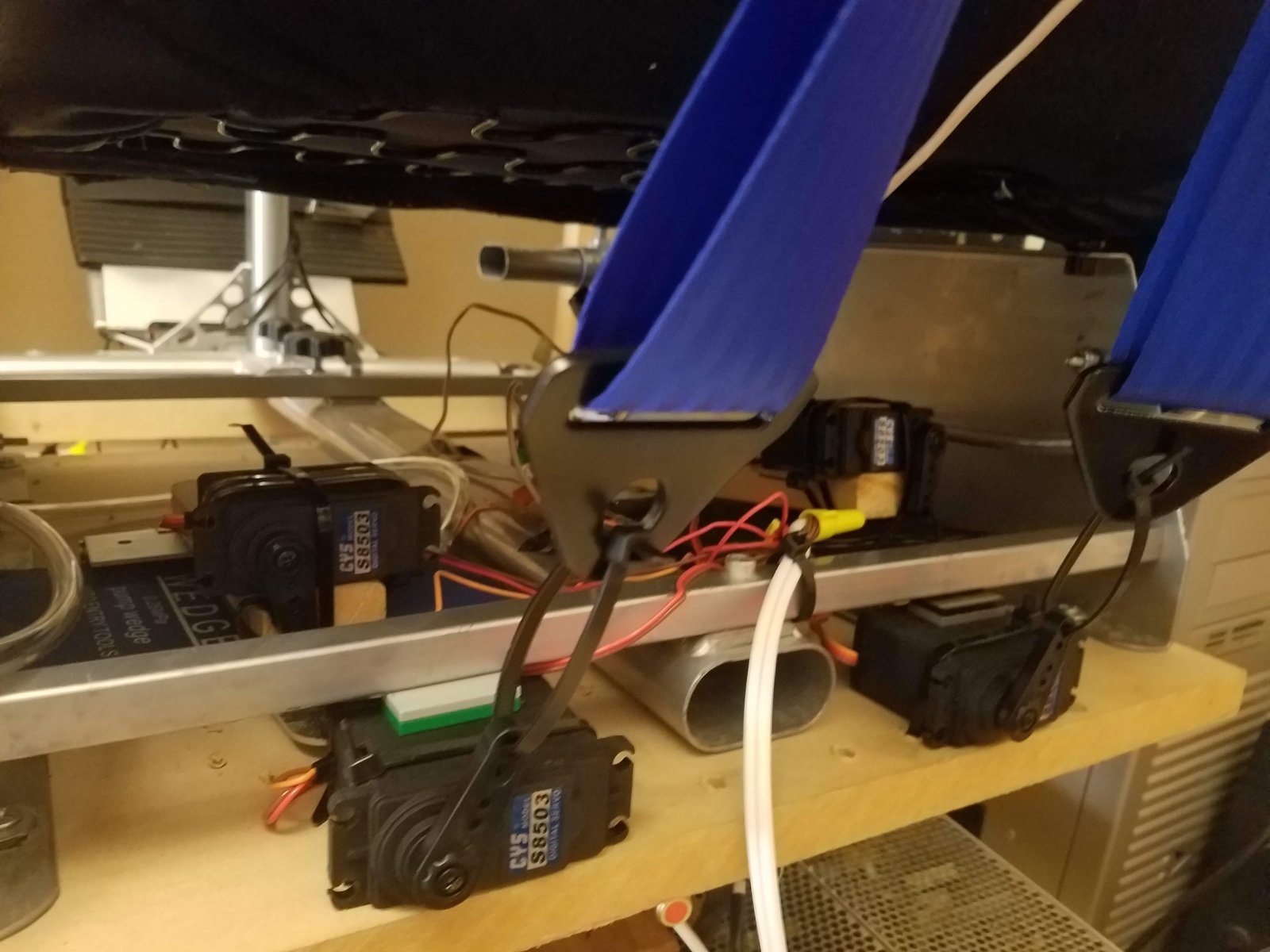

    It's been a while. I recently built a G-seat for my 2dof + traction loss. At first, I started with 2 motors for the seat-belt (the picture shows the final product). It made a huge difference in the immersion for at least 2 reasons. 1) It glued me to the seat (as I wasn't really using the seat-belts before), and 2) the pull from the back felt compelling because of the force it applied on my body. Because it was compelling, I decided to do additional upgrades to make a semi-full G-seat. Here is a picture of the belt harness tensioners on the back of my seat:
