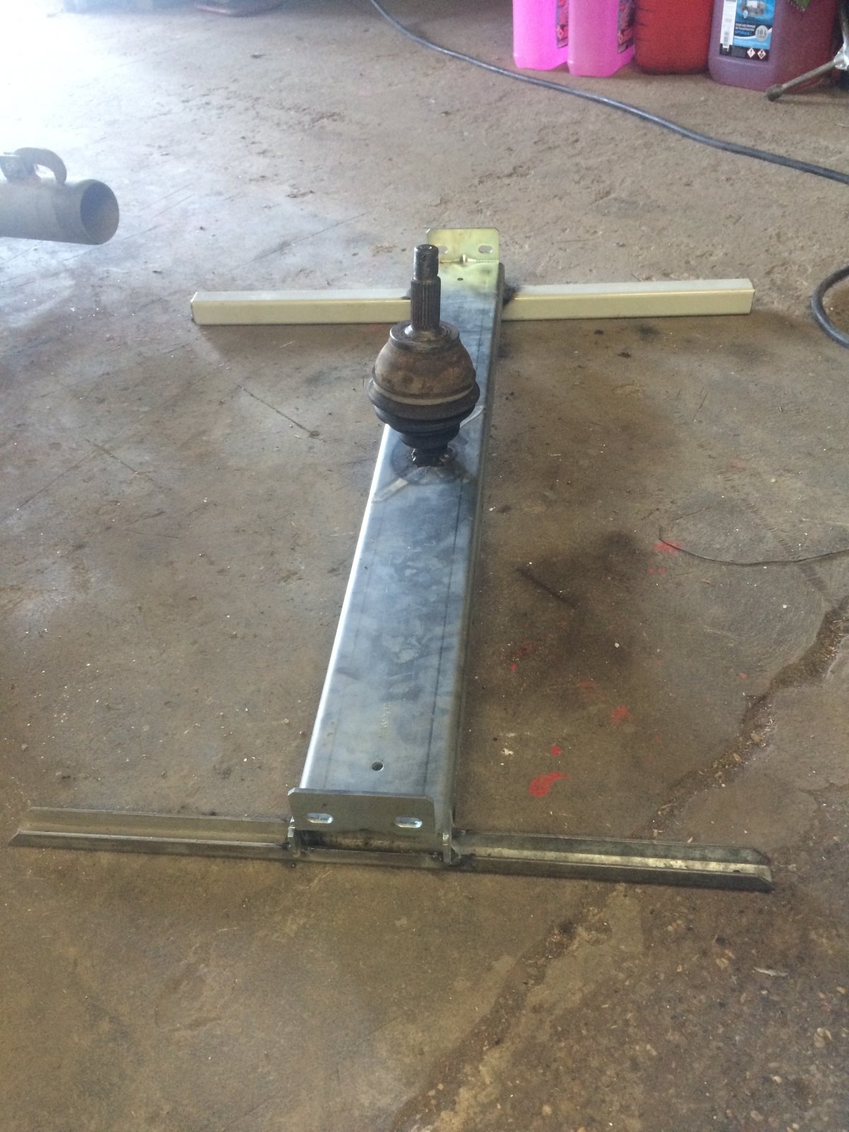

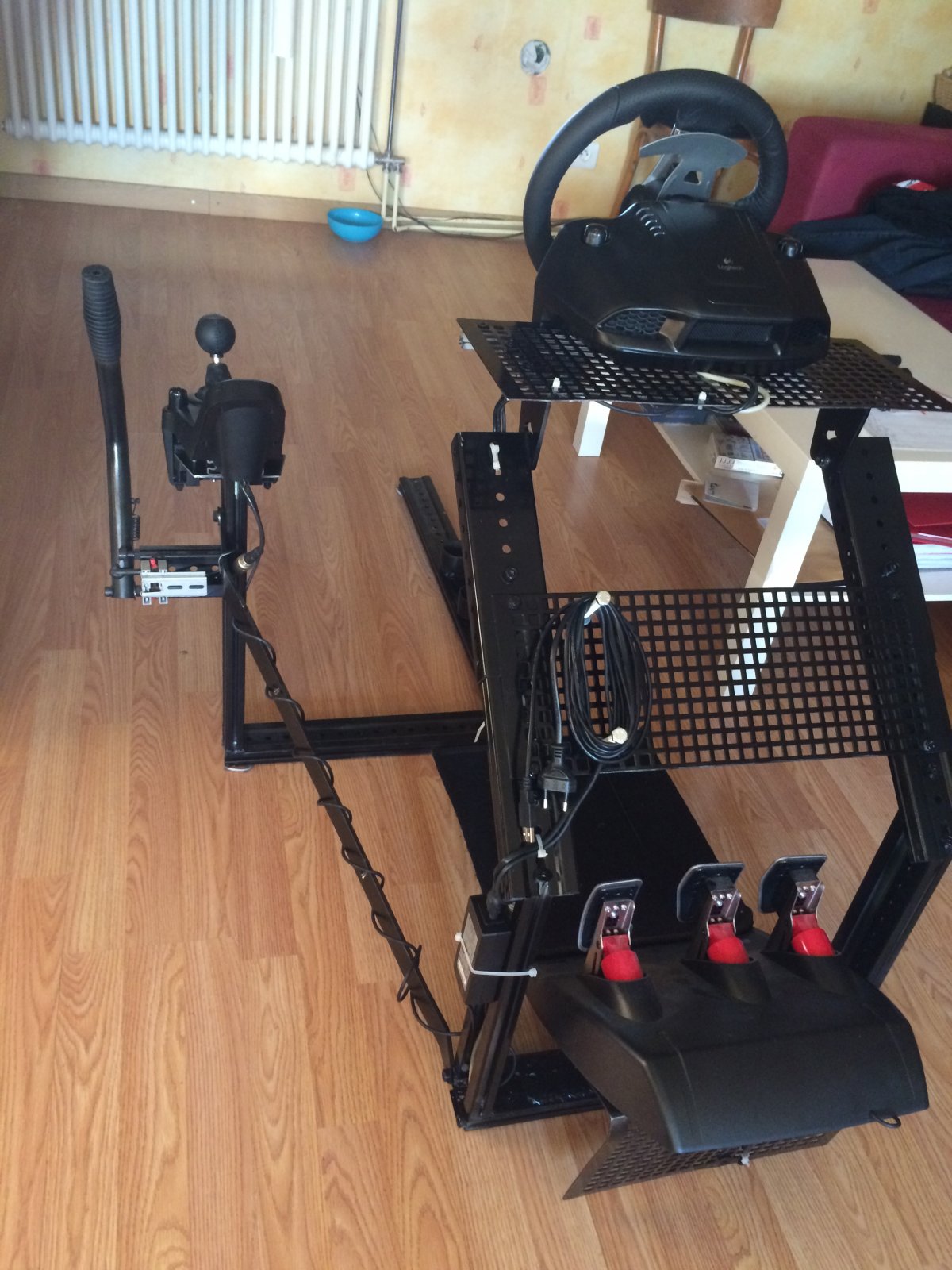

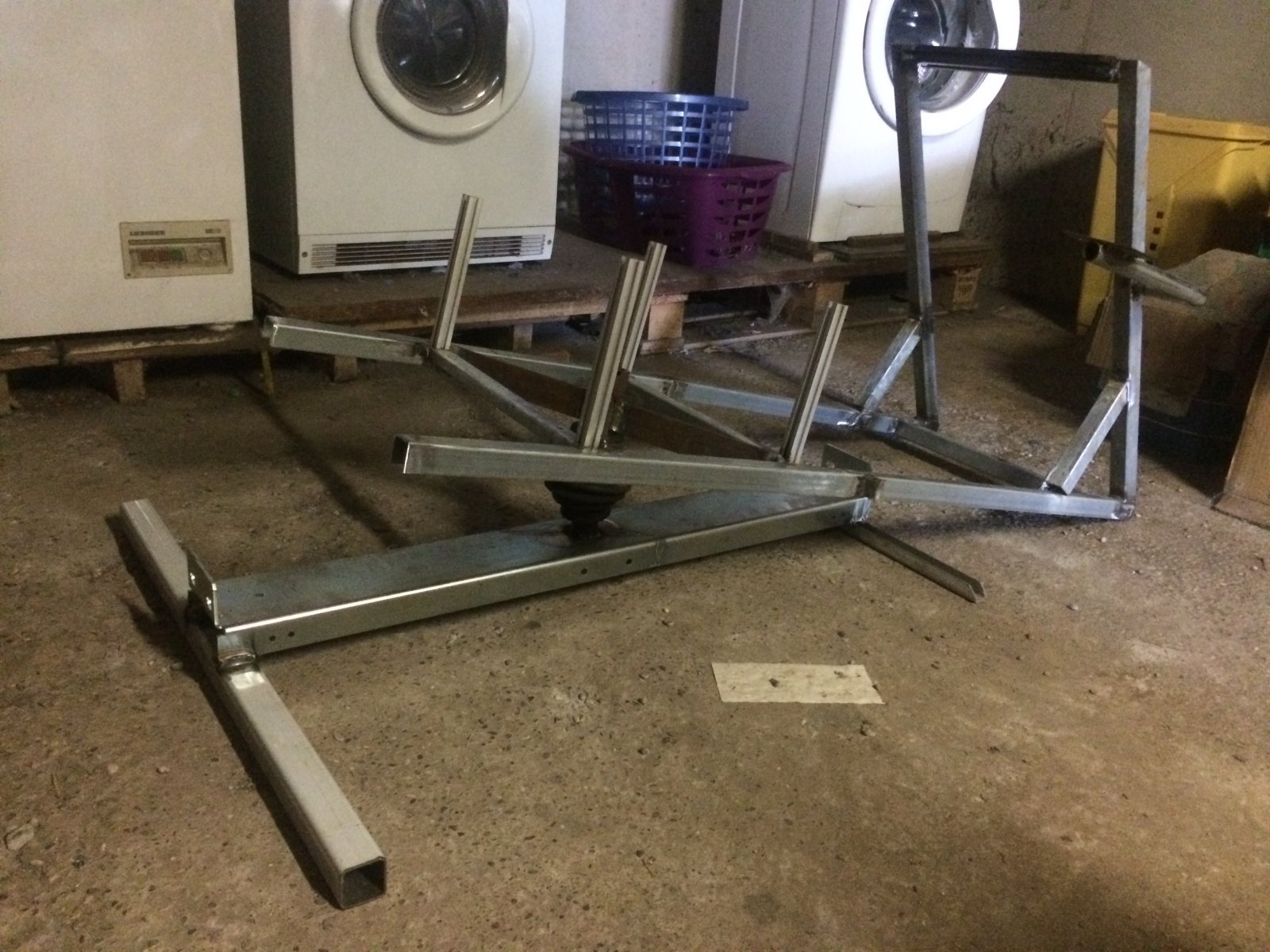

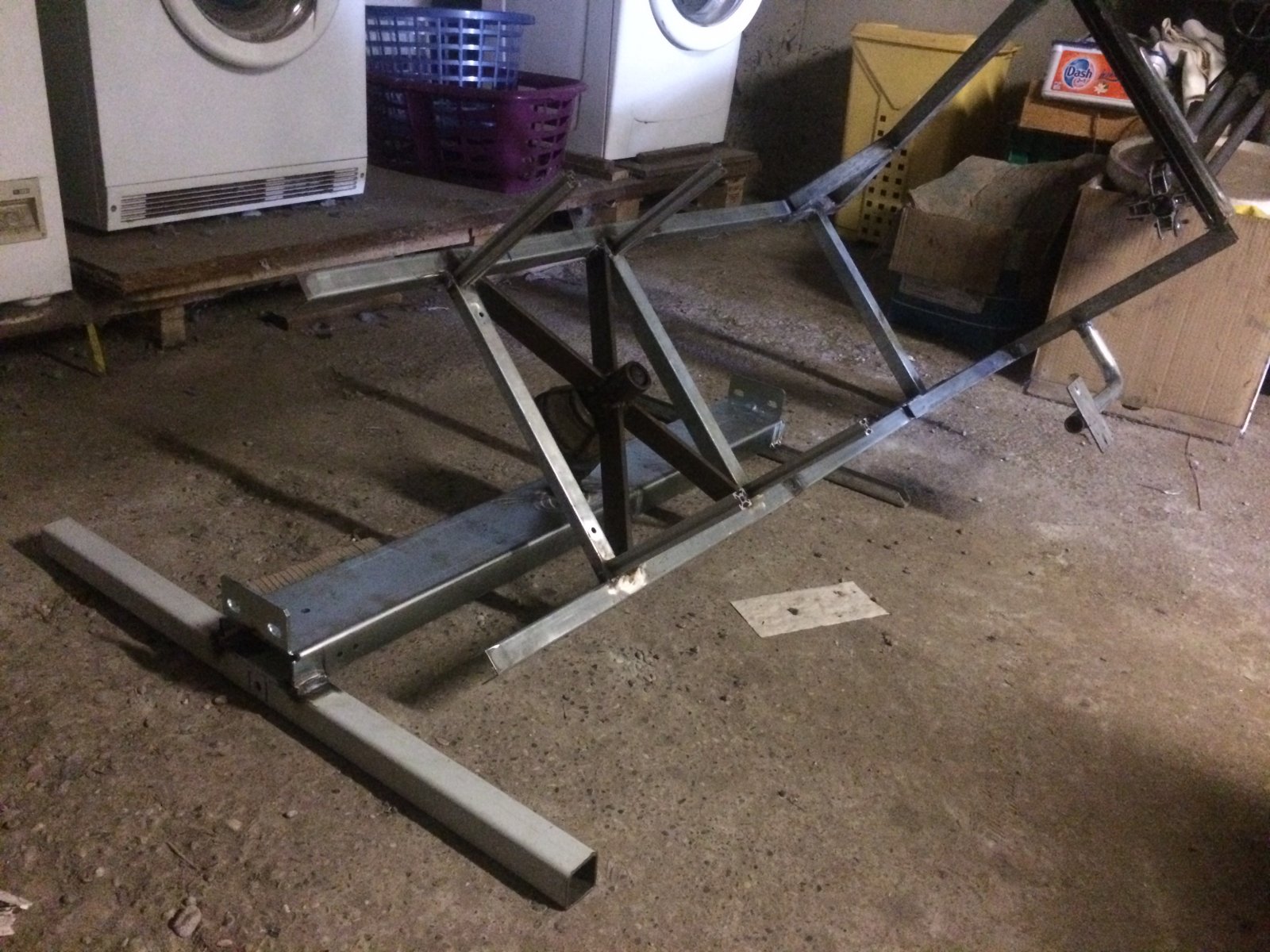

    I have order the motor. I first try it with 12v when is not good i buy a sabertooth shield.
    Yesterday i have build the base and put the moving part on it.
    J'ai commander le moteue 24v jessayerai en 12v et si c'est mauvais je prendrais une sabertooth pour passer en 24v
    Jai fabriquer la base du chassis et monter la partie mobile dessus
    base :
    braking max angle :
    steering angle ( not reel )
    22,208
    154,711Coins
    +11,212 / 57 / -2
    Nice work there @alexis67.
    With a CV joint if there is any unwanted lateral twist you can add a control bar between the top and bottom frame.

    2DOF, SCN6
    its moving fast
    sa avance vite
