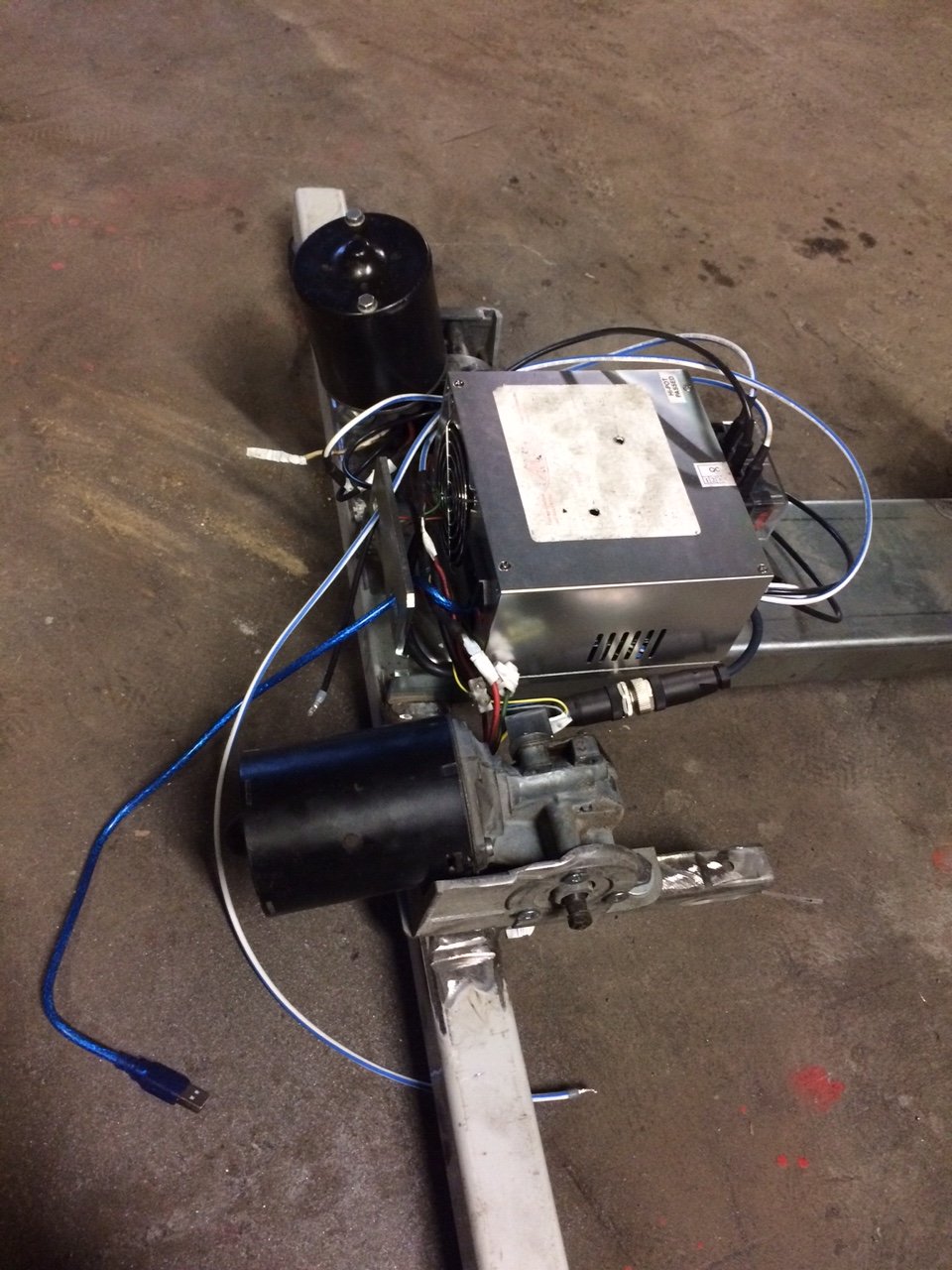

    i have found a motor and it look have power !
    ground isolated and mounted for somes test

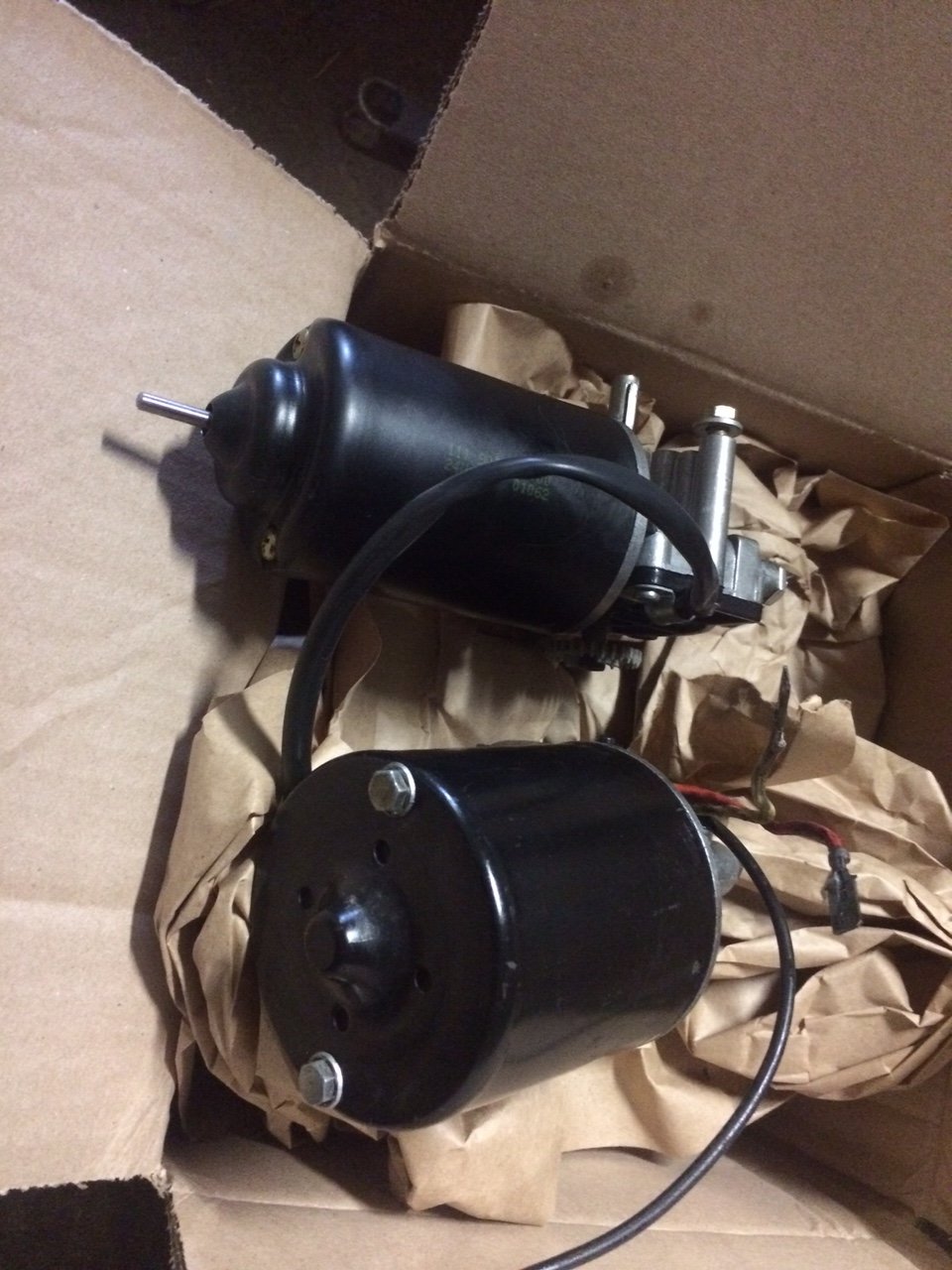

    i have found this motor at my uncle's house , i think it came from a Old Citroen CX . Tommorow i will go again and show on the old car if it the same i take it out .
    Je l'ai trouver chez mon oncle je crois qu'il viens d'une citroen CX , demain j'y retourne et je regarde sur sa vielle voiture si c'est le meme je le démonte

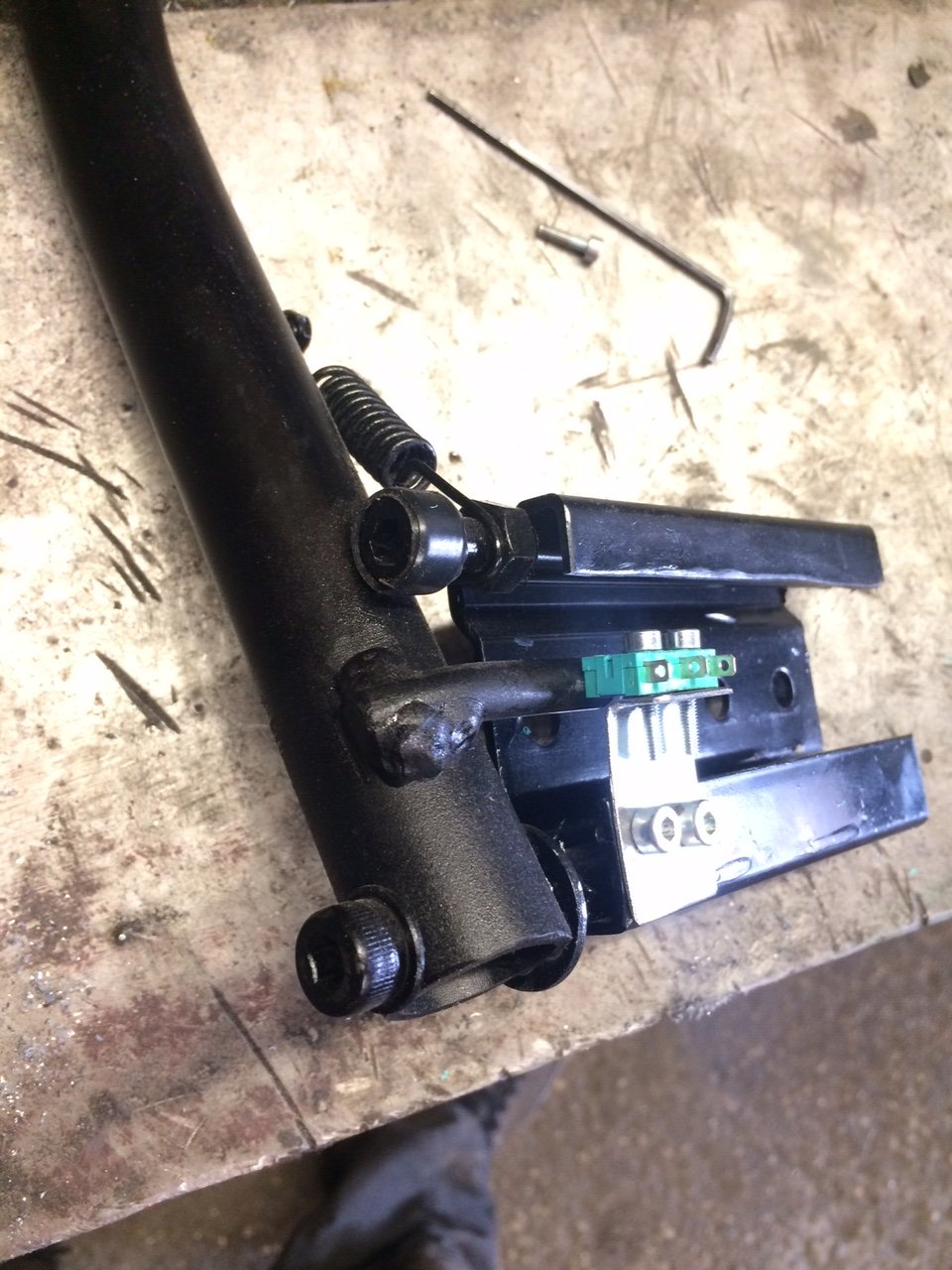

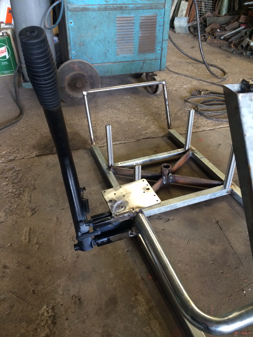

    Super le frein à main :) Tu va utiliser une manette pour l'émuler ?
    Super handbrake :) You will use a joystick to emulate ?

    Beancher en parallele d'un bouton

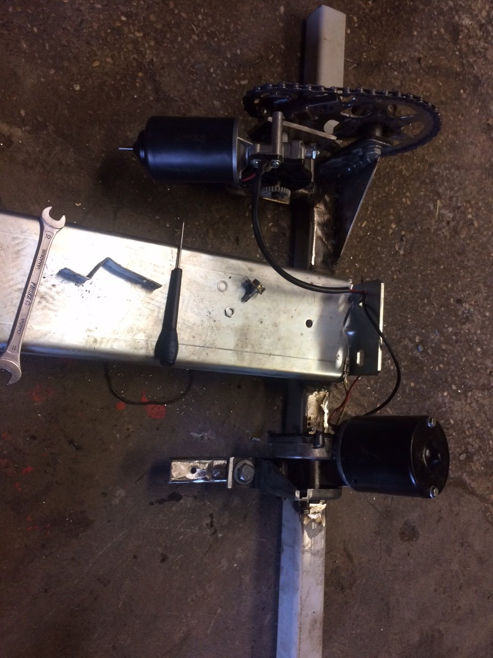

    after 3 weekns work it's funktionnal !

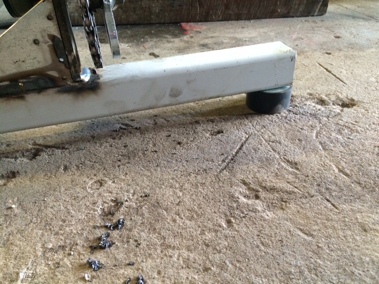

    Congratulations @alexis67, it is a moment of excitement and relief when you first get your sim moving. Then comes plenty of tweaking and refinement of motions profiles.
    The back of your sim is moving off the floor at times, which you may want to have a look at.
  14. alexis67
    alexis67 Member
    May 10, 2015
    56
    288Coins
    +38 / 1 / -0
    Its going out from the floor but only 10mm is not a problem

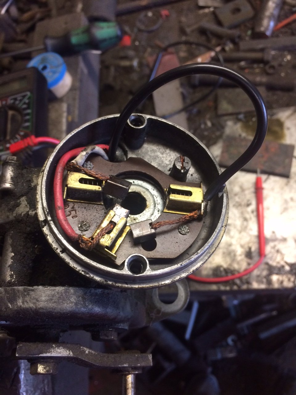

    so after 45min playing
    one moteur is going very hot and one moteur make abnormal mechanical noise

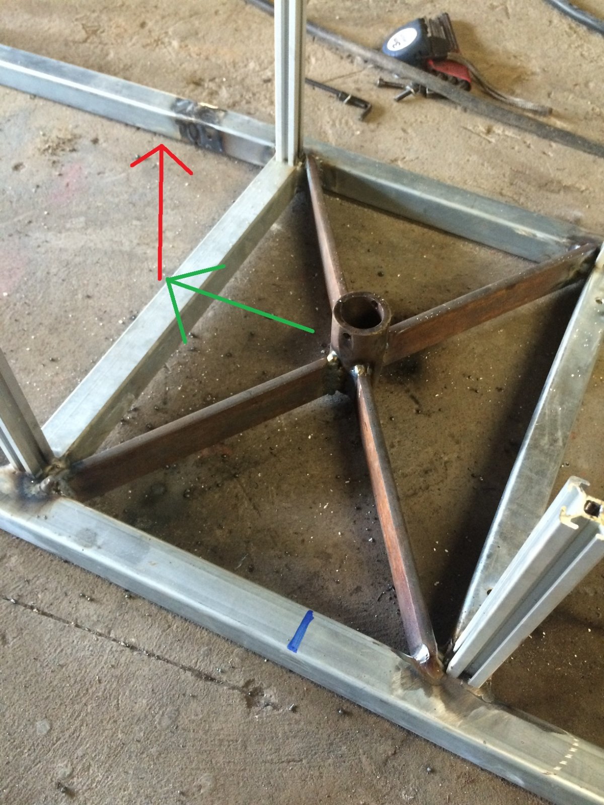

    In your design the pivot point is low and I am guessing there is a great deal of load on the engines when your weight and that of the peripherals is anywhere forward of perpendicular.

    yes this is little to much in the back , i will modify it

    Being a full frame it is important you ensure the COG is correct, including yourself and peripherals, and the pivot point should be as close to the seat base as possible. That way the COG only moves slightly around the pivot point, compared to how it is now where the distance from the pivot to the seat is a lever pushing the COG well out from the perpendicular.

    ok , i will modifi it next week
    move forward ( green )
    and lower the chassis/COG (red )

    One other thing you can do is to make it a shoulder mount.
    Motors will work with less stress .My thoughts is that you have to do it if you move pivot point close to the seat base
