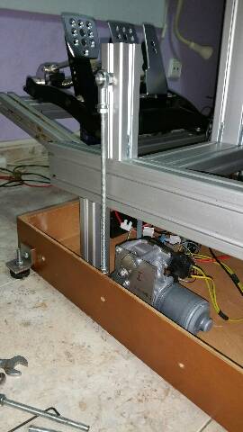

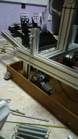

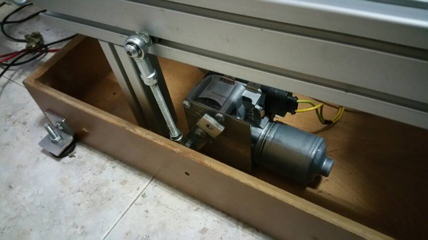

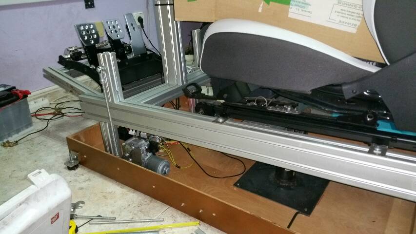

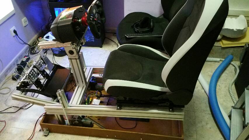

    That small change to the mount design on the frame will make a big difference and should be easy to implement as you are using profile aluminum.
  2. Chumet1
    Chumet1 Member
    May 10, 2014
    59
    - 2Coins
    +16 / 1 / -0
    2DOF, JRK
    This modification will I be easy. I have more aluminum profile and I can also lengthen the threaded rod ball joints. I already want to put it into practice but I need time and these days I am busy with family
  3. Chumet1
    Chumet1 Member
    May 10, 2014
    59
    - 2Coins
    +16 / 1 / -0
    2DOF, JRK
    Before
    20141220_182141_resize_20141220_183245.jpg 20141220_182552_resize_20141220_183242.jpg
    After
    20141223_185536_resize_20141223_204943.jpg 20141223_185526_resize_20141223_204942.jpg

    looks good, now to test it
    21,788
    152,541Coins
    +11,086 / 56 / -2
    Much better @Chumet1, I am looking forward to your tests. It would be great if you can do a little video.

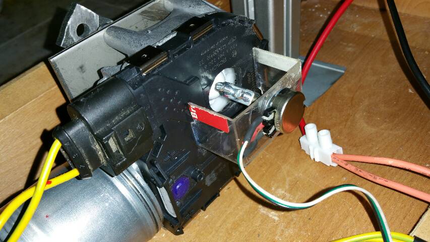

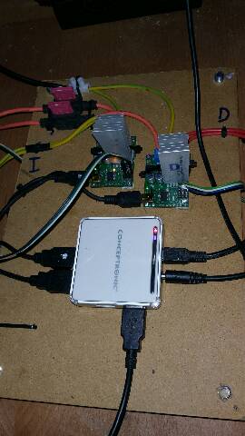

    As I can make a video with improvements. Actually improved the feedbag. But I have a problem with the left engine, you do not get rebounds and adjust the PID. I have to do tests to see if the motor potentiometer and pololu. The left and the right are identical and the right engine performs very well.
  7. bsft
    I found something interesting.
    With the motors, even though they may come from the same supplier , one gearbox moves easier by hand than the other, then requiring different PID and motor power settings.
    My dual racers, even though they are the same, the red one has gearboxes that move more freely than the yellow, hence I had to spend more time on the red racer getting the settings right.
    Another situation, I put together motors and pots for @Rastus and one gearbox moves more freely that the other. Weird, but he sorted it with PID and motor power settings.
  8. Chumet1
    Chumet1 Member
    May 10, 2014
    59
    - 2Coins
    +16 / 1 / -0
    2DOF, JRK
    I have solved my problem rebounds in the left engine. It was unsoldered connector poplolu and to end contact with the motherboard. It took me quite repair and re-run the pololu. Now both engines work just as well. A big step to adjust them properly. I'm happy.

    Another problem I have encountered is that the potentiometers are degraded and give false feedback signals, the cause is not well aligned with the motor shaft and being fixed to the base, sometimes the motor bracket gives a little and force to the shaft of the potentiometer.
    yesterday put the potentiometers on the same engine and well aligned with respect to its axis and at the moment give a very good answer.
    And a question, I see that many use quality and multiturn potentiometers, which recomentarian me ?? I have some very basic 10K, as I show in priemras photos.
    I have found that good either alienated than a very accurate feedback of the actual motor position potentiometer is essential.
  15. noorbeast
    21,788
    152,541Coins
    +11,086 / 56 / -2
  16. Nick Moxley
    17,057Coins
    +2,506 / 30 / -2
    +1 Hall effect's are where its at. And Do yourself a favor and use some flex couplers. Takes the guess work out.
  17. noorbeast
    21,788
    152,541Coins
    +11,086 / 56 / -2
  18. Chumet1
    Chumet1 Member
    May 10, 2014
    59
    - 2Coins
    +16 / 1 / -0
    2DOF, JRK
    Thanks for the infofmacion. I'll buy them as simply having properly secured my current cheap potentiometers movement improved a lot. With these potentiometers you say me and those pieces to protect their axes have to do better still my project.

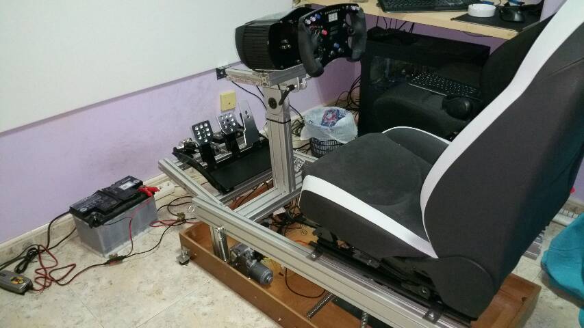

    20150114_234732_resize_20150115_002526.jpg 20150114_234758_resize_20150115_002525.jpg 20150114_234745_resize_20150115_002525.jpg 20150115_001154_resize_20150115_002524.jpg
  20. Chumet1
    Chumet1 Member
    May 10, 2014
    59
    - 2Coins
    +16 / 1 / -0
    2DOF, JRK
    New video with alls updates...
