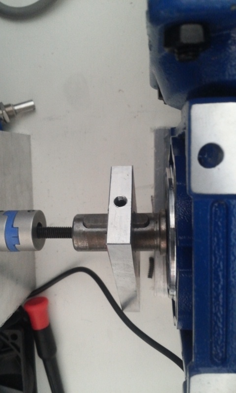

  4. bsft

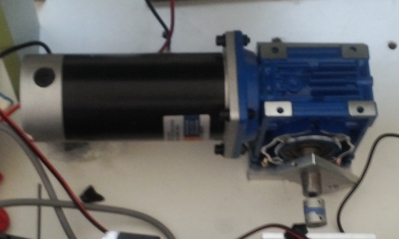

    yes its a fuzzy picture of a motor, so what do you need me to say?

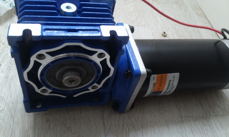

  5. hunijjang
    hunijjang She is my wife :) Gold Contributor
    Jan 30, 2015
    90
    Operator
    Seoul, Korea
    1,164Coins
    +17 / 0 / -0
    Hello. @bsft :)
    You can read that aboves for my question.
    but I will try of here. ;)
    in the your guidences, below...
    with setting the feedback, once I fitted a lever, I unscrewed the gearbox from the motor and turned it but hand to the most level position I could. Then I screwed it back on.
    and my question...
    - but I don't understand for what turned. It is from worm geared head of shaft or just motor of shaft? because as you know is not move by hand. so you mean is the motor of direct conneted shaft? your guidences will be apply for this motor?
    the specs 12v 250w motors 60:1 gears ratio and 50rpm with worm geared head.
    I needs your help... :(
  6. bsft
    the worm gear head, take it off and turn it by hand so the lever you fitted is in a level spot, then once the pot is fixed to it, you can set feedback withe adjusting the actual pot.

  8. hunijjang
    Jan 30, 2015
    90
    Operator
    Seoul, Korea
    1,164Coins
    +17 / 0 / -0
    @bsft I think of the my worm geared head with motors some differences... or I am short in understanding to easily... I am still thinking about your by means... :(
    and worm geared head take off from motor but as far as I remember or know that is not move to shaft by hand so same take off it or not... :(
    yes I am a idiot... so Help me please.:sos
  9. JRoque
    JRoque New Member SimAxe Beta Tester Gold Contributor
    Jun 5, 2014
    21
    Miami, FL USA
    282Coins
    +20 / 1 / -1
    Hi. Your question was for @bsft and I'm not sure I even understand the question all that well but, let me try to guess an answer:
    1. Adjust your lever so it's a center position (ie: seat and gearbox are at middle point of travel)
    2. Set your potentiometer to its middle point (half travel) and connect it to the output of your gearbox
    3. If for some reason you can't turn the gearbox to set it to the middle point, remove the motor and turn the gearbox input shaft by hand until it's set correctly.
    I can't tell from the pictures but if your motors have dual shafts, no need to remove it from the gearbox - if that wasn't already obvious.
    Did I get what you're trying to ask right?
    JR

  11. JRoque
    Jun 5, 2014
    21
    Miami, FL USA
    282Coins
    +20 / 1 / -1
    I ordered a couple of those a few months back. They were shipped very quickly directly from the manufacturer out of Ali Express.
    They have good cosmetic terminations and come with the shaft keys. There's a huge variety of models with different input shaft/bores, output shaft diameters and motor flanges. Very flexible with mounting holes on nearly every corner.
    Internally, they come quite a bit too tight and hard to turn. You will need to change your oil after about an hour run. The problem is that they use open bearings everywhere that share the same oil bath so bits of bronze will travel to the ball bearings and kill them. They also picked a very inefficient input shaft seal. It takes twice the input power to start moving these versus my other gearboxes. After about an hour running, the gearboxes were burning hot. I used ISO-32 oil which is especially designed for this application. Even after some break-in runs, these units are still a lot noisier than my other gearboxes.
    The only reason I'm using these is because they have dual shafts. Otherwise, I would have to hang a pot at the end of the single shaft boxes I have and risk constantly tripping on them or worse. But if they annoy me too much, I'm going back to those other gearboxes that are far more efficient, smooth and quiet.
    JR
