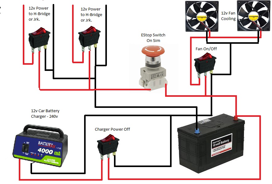

    After giving it some thought I think I am going to down the PSU + battery path. @eaorobbie Can you post me a link to how you did your PSU + Battery?
    All switches have internal leds too hence a third connection per switch.
    Cut off switch only kills JRK's.
    I like to have my fans on separate switch to allow cooling after a long event.
    plus charger can be turned off if battery is full, now use a trickle charger so it cuts in and out when it see's fit, good motor home unit, nice and safe charging.
    Hope that helps.

    Awesome. That is really helpful. I like the idea of all the switches.
    How well does that battery last out if you are racing for extended periods, like a few hours?
  18. eaorobbie
    20,491Coins
    +1,687 / 23 / -2
    Without charger running about 4 hours notice a very slight slow about 6 hrs its noticeable.
    With charger running - unlimited, runs all day.
    To be safe place battery in a proper battery box and makes no sparks or open flames are near it if you may be using it for extended periods, beware over charging a battery is not good if need to charge overnight take the battery outside to charge.

    I will run the battery in a battery box like I do in my road car. What size charger do you use?
