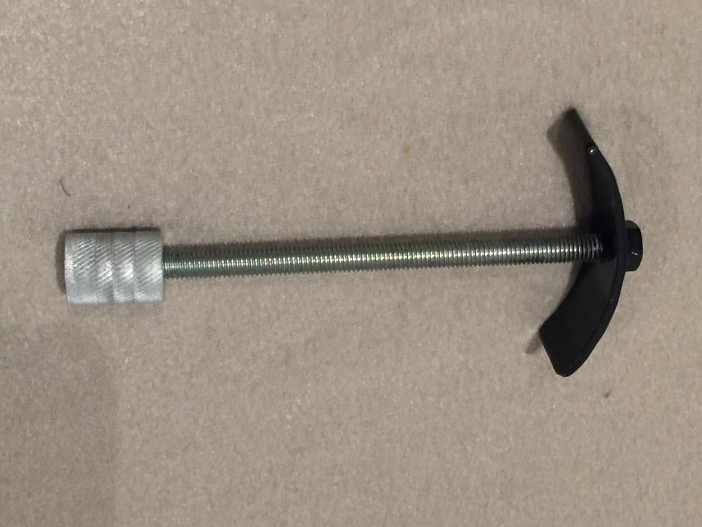

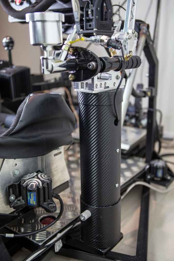

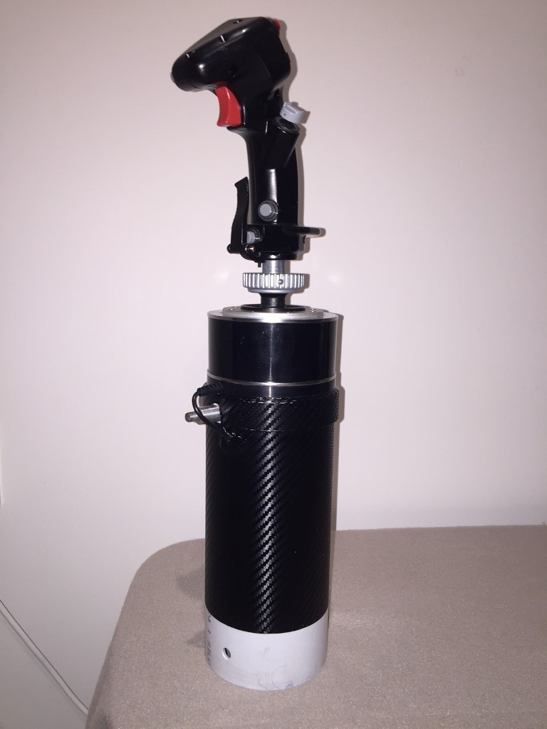

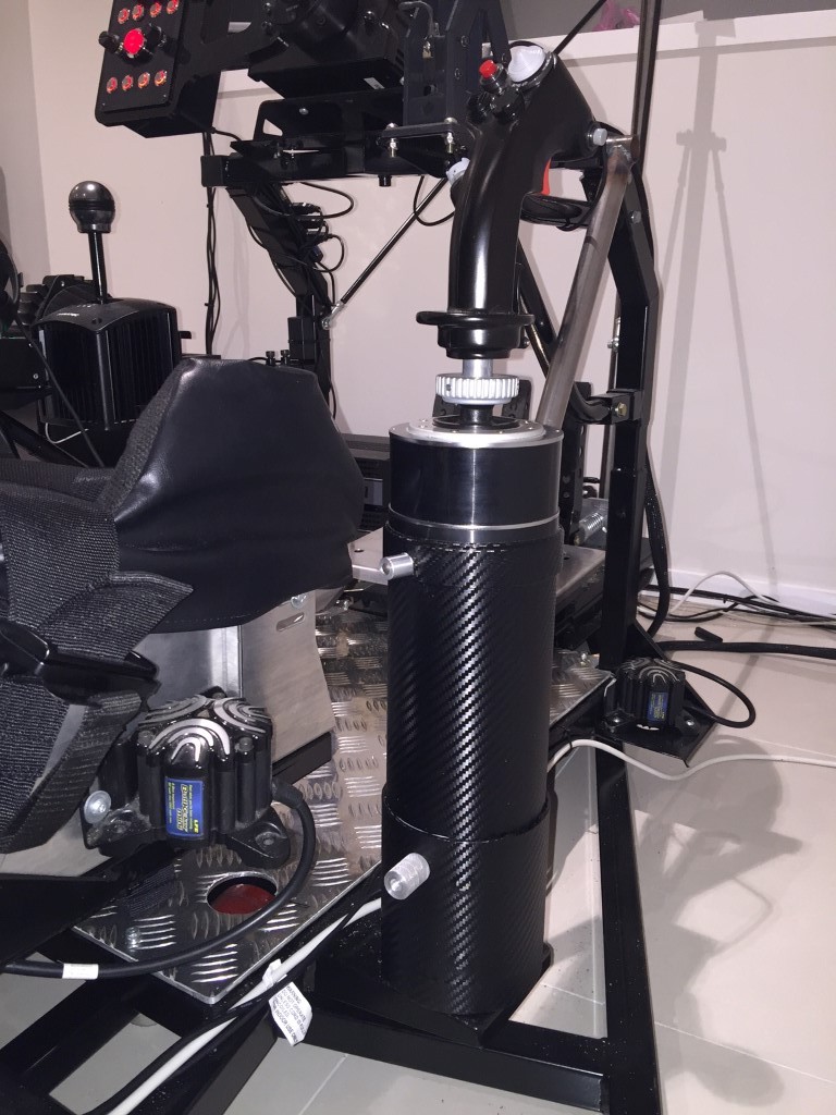

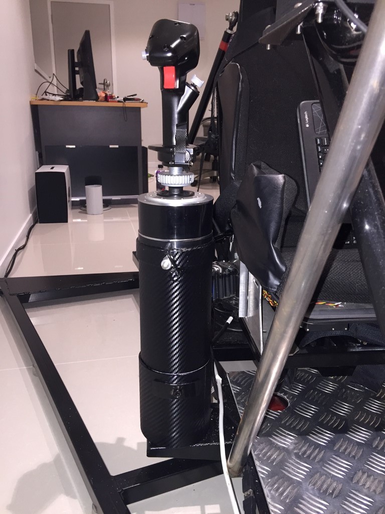

    I finished my handbrake/flight stick mount. It works really well, I just need to undo the one bolt and slide the pin out then swap over the flight stick and handbrake. Takes less than 30 seconds.
    I'll start with the flight stick.
    I wrapped the PVC in vinyl carbon fibre wrap, I need to leave the bottom bare so it will slide in to the PVC coupler on my rig.
    Here is the flight stick installed on the rig, you will see the silver turned metal knob near the bottom, that is the quick release bolt.
    On the front side I have made a little support bracket for the quick release bolt.
    Here is the quick release bolt when taken out of the rig, the support bracket on the right hand side of the bolt is welded on so it won't move while I am tightening it, I don't need any tools, just do it up by hand because the turned metal knob is really grippy.

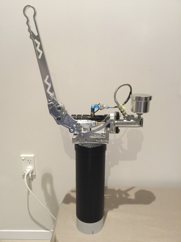

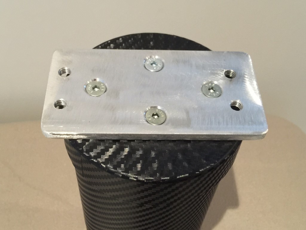

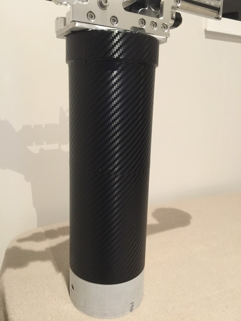

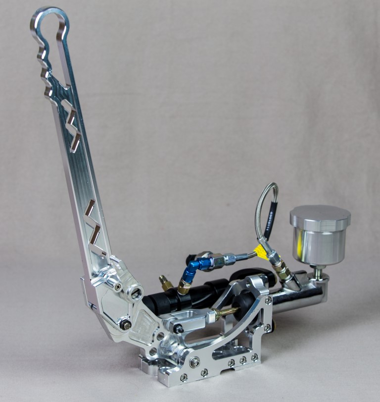

    Next up is my new DSD type 3 handbrake. I was lucky enough to be able to test the first one off the assembly line. The handbrake is massive. You can see it in action and a review of it in the above post.
    I had to make a mounting plate for the top of my PVC so I could bolt up my handbrake.
    I finished the carbon wrap the same as the flight stick.
    It looks pretty nice close up.

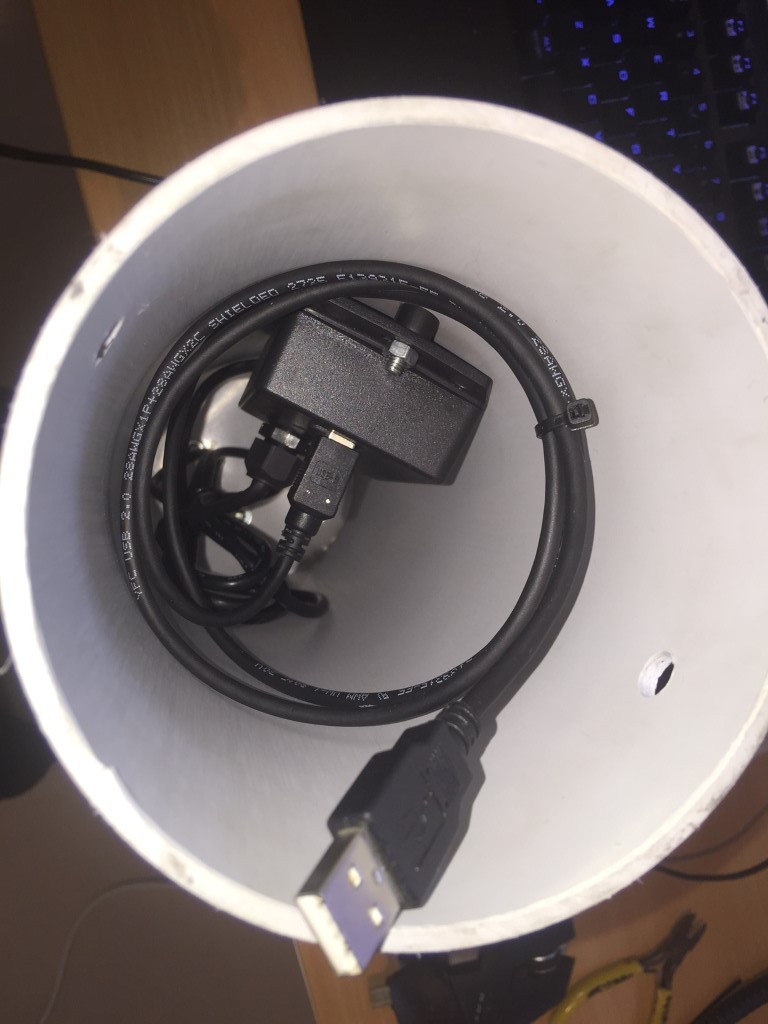

    Here is the handbrake installed, you can see the two bolts on the side, that is where the controller box is mounted inside the PVC tube.
    Here is the controller box. I just mounted it on some rubber standoffs, the USB just plugs in to the USB extension lead I have in the base of the quick release.

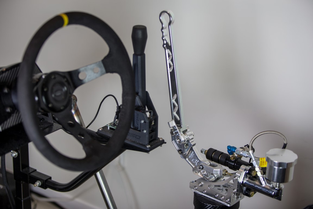

    Handbrake in relation to the shifter and wheel

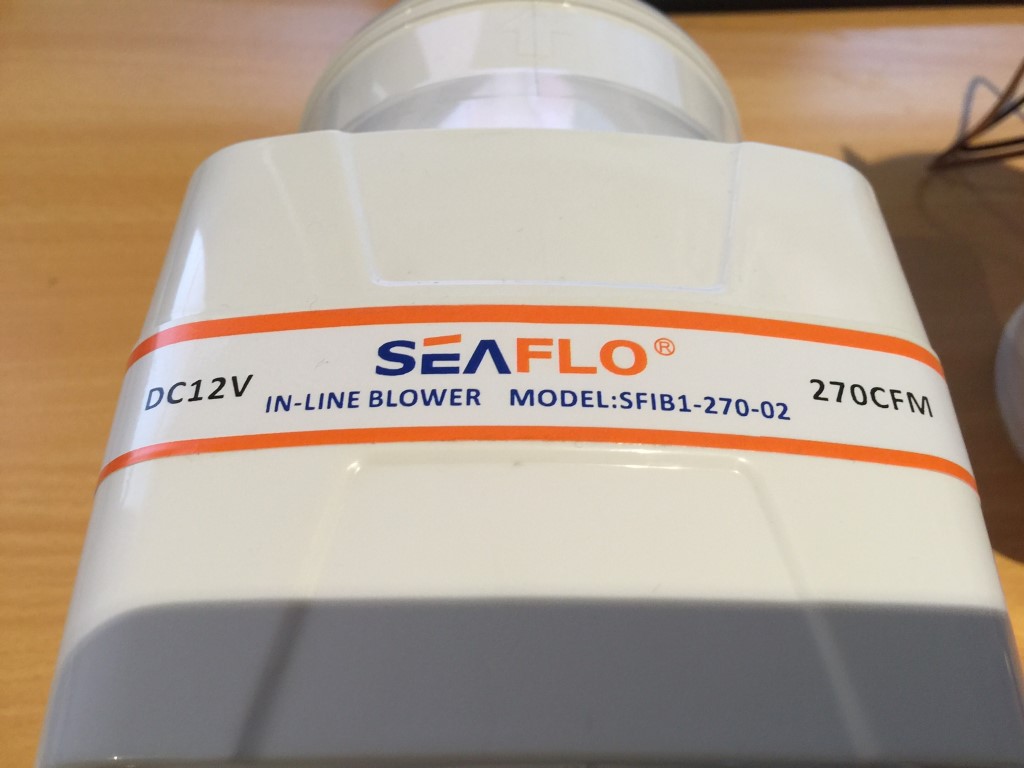

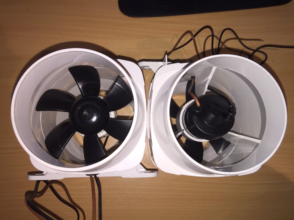

    Another little update. I have got the first parts for my next project. A speed sensitive wind generator.
    I will be running them off SimTools using an Arduino and a Monster Moto driver based off of code that @SilentChill and other had made.
    I have the electronics on order, I ordered them off ebay so they will take a while to get here. I was able to order my fans locally so they came today. I am using two 4" inline blowers. They are 270CFM so hopefully that should be enough, if not I can add some more. They were only $40NZD each ($28 USD) so they are cheap as. I hooked them up to my batteries on my simulator and they put out a ton of air.
    These will serve a dual purpose, firstly immersion for wheel wheel cars and secondly for cooling because my motion simulator and the rift gets pretty warm.
    Here are some photos of the blowers.
    The one on the left is the intake side and the one on the right is the exhaust side.
    They are 12V Seaflo in-line blowers, they are designed as a bilge blower for boats. It will be interesting to see if they work well for my project.
    They put out 270CFM each and draw 6A, that is no problem for me because I will be running them off my batteries on my motion simulator
    Here is the little blurb on the box

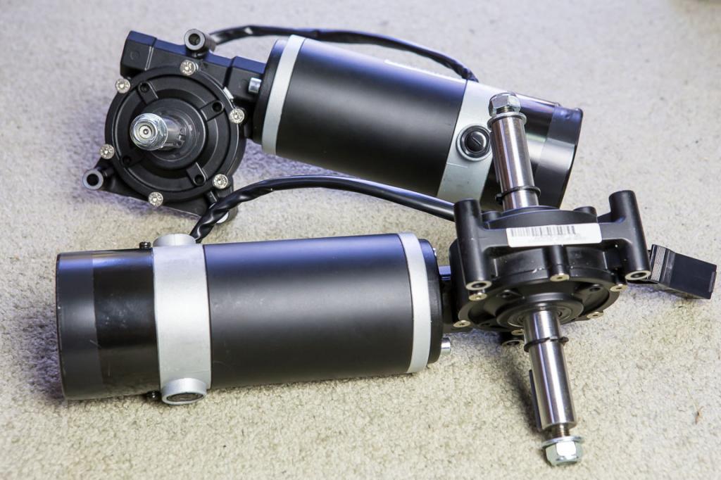

    Thanks.

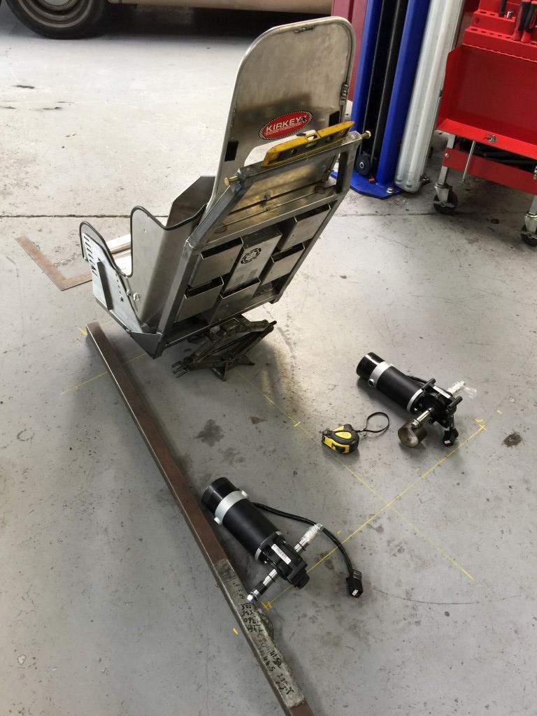

    It does make it a lot easier having skilled people to help and the right tools, I love the water jet cutter, by far my favourite tool. And you are right, the photos probably make it look easier than it really is, but once you get stuck in to it then it isn't that bad. When you look at all the other cool projects on this site there is no end of creatively and ideas.
    To answer your questions.
    I get my motors from a local distributor here in New Zealand http://www.bgts.co.nz/styled-2/styled-10/index.html
    He has the bigger 5300 ones listed but the 4300RPM ones were some that he got in specially for me. It would probably be a lot easier for you to find a distributor from Europe.

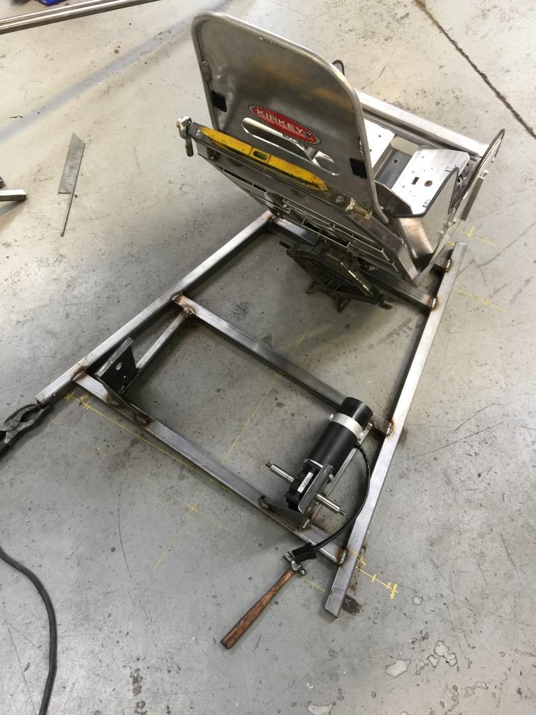

    I never really did any diagrams, I just drew it all on paper then we just marked it all out on the floor then built it off that.
