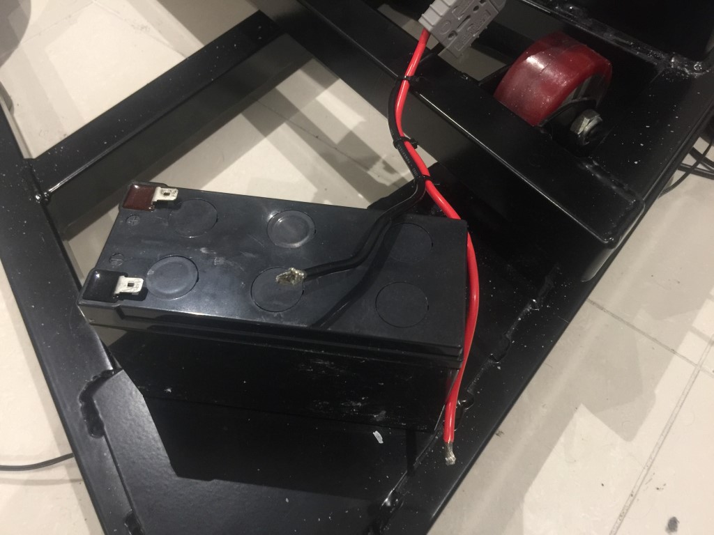

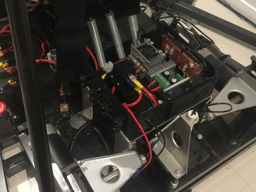

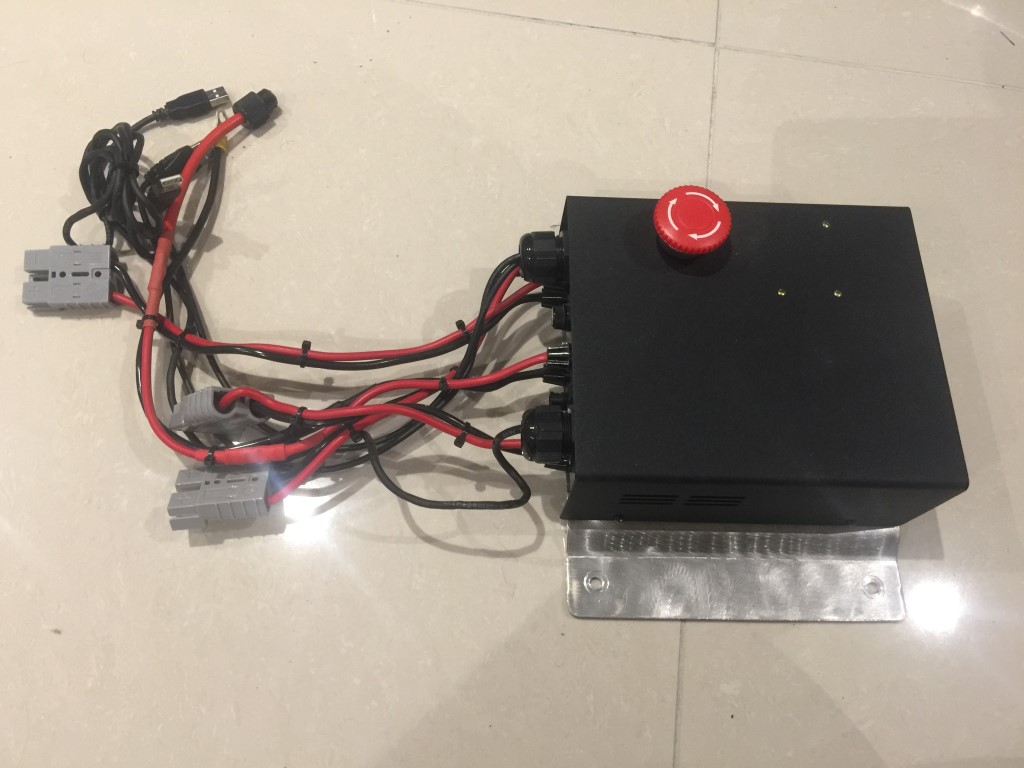

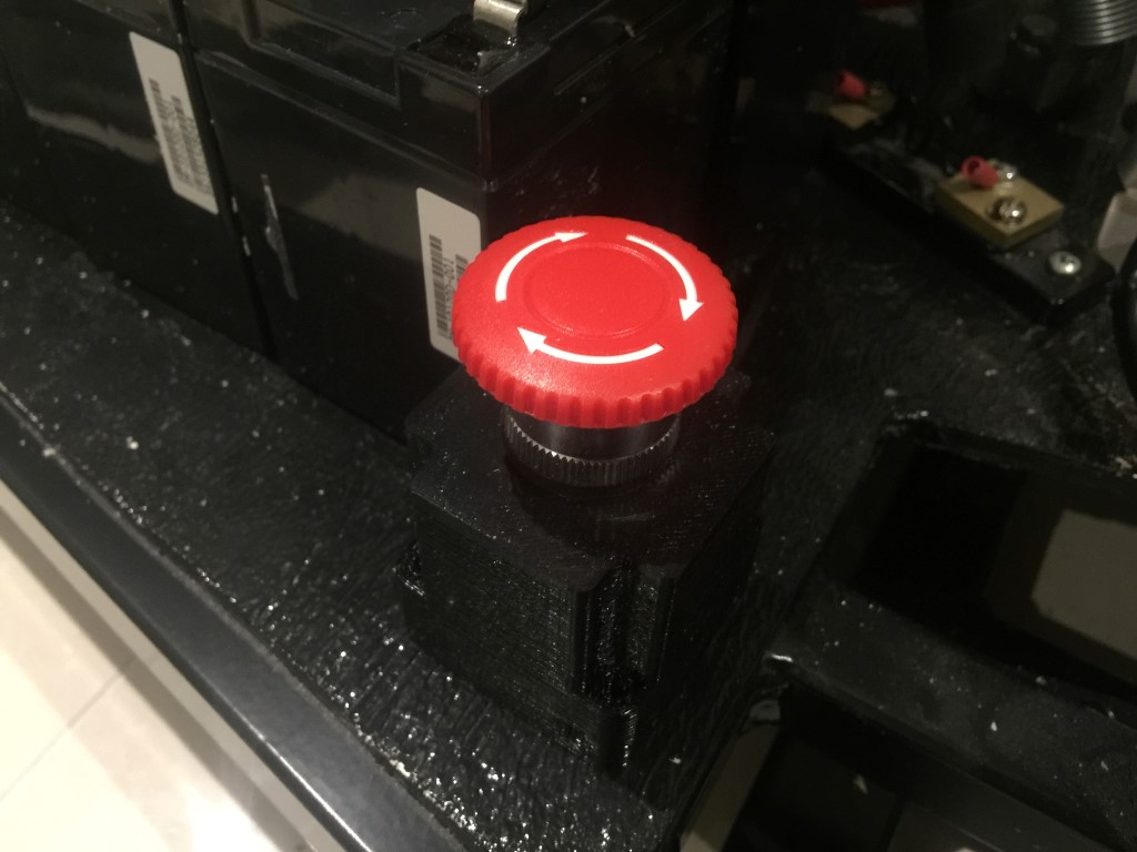

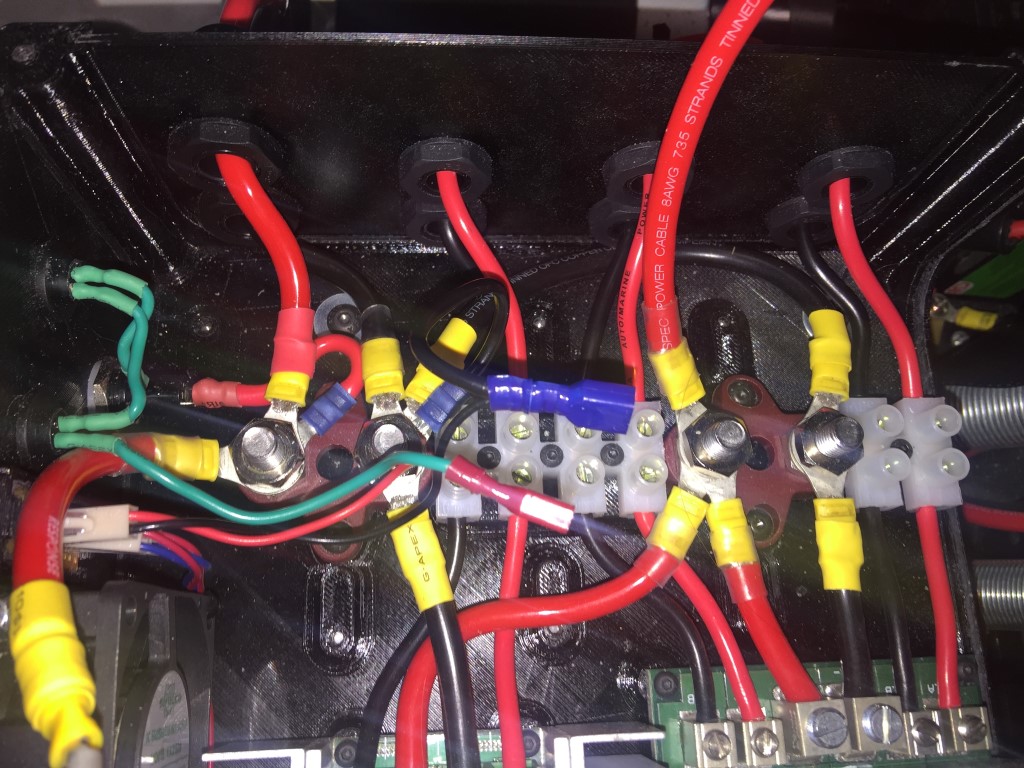

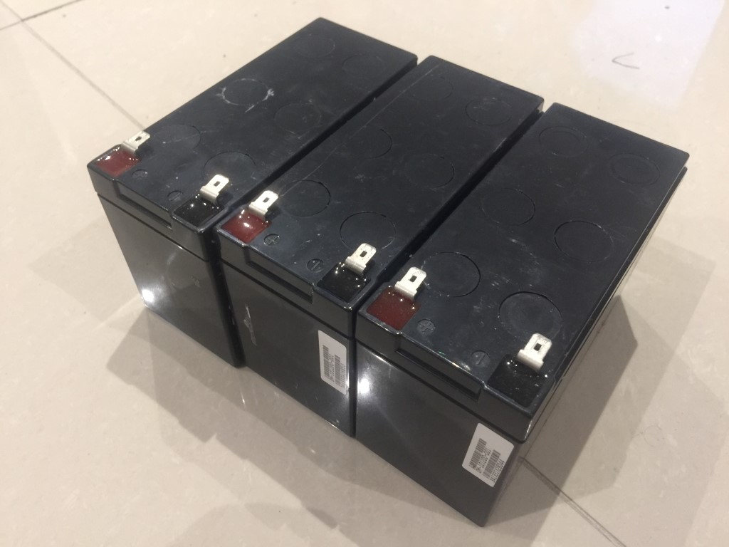

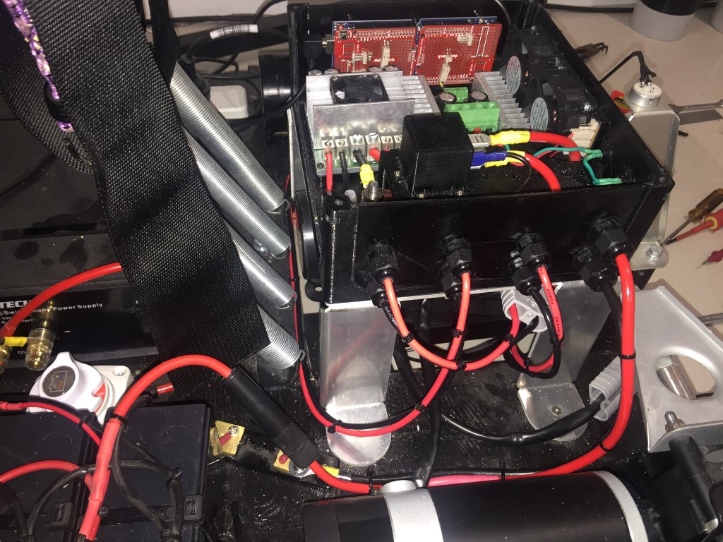

    Got back from my road trip around the South Island, 3,000km in 8 days.
    Some more progress on my motion simulator.
    Invisible batteries!!!!
    New batteries from a UPS upgrade that we did at work

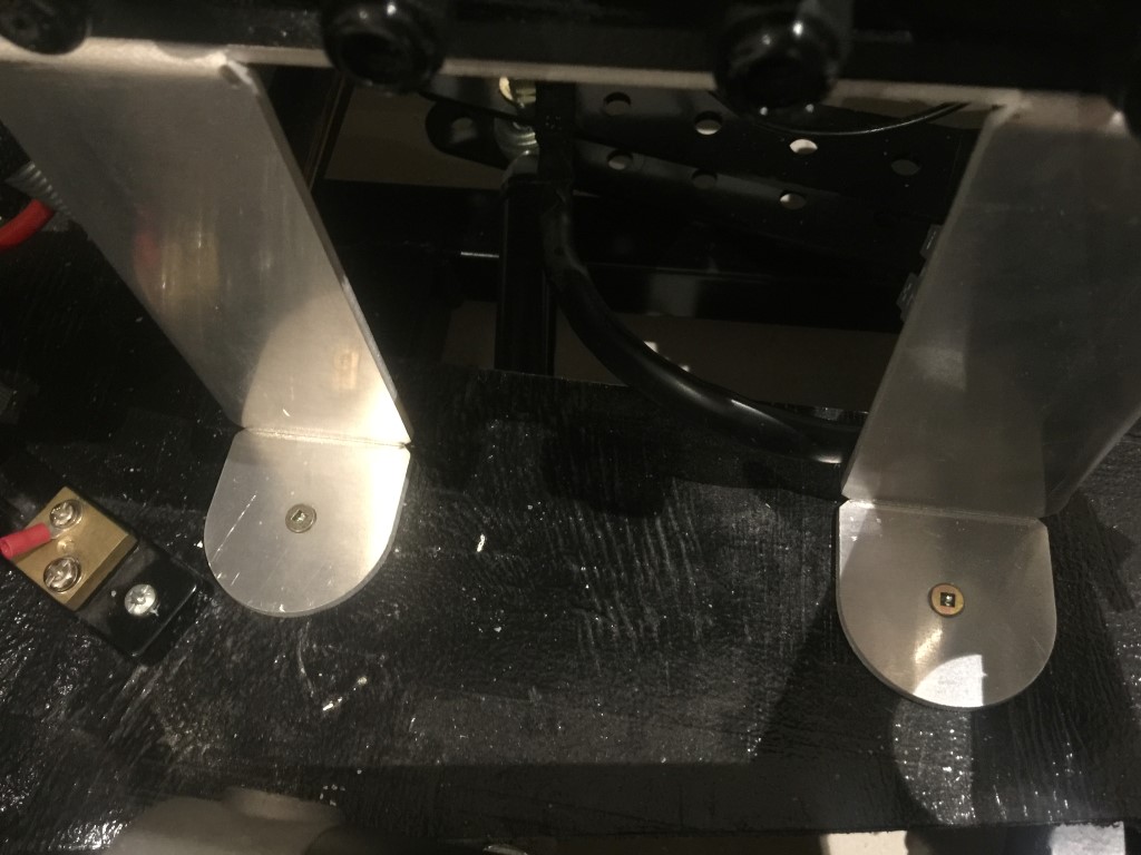

    Removed the old motion controller box
    Installed the base for one of the killswithes
    Installed the top of the killswitch

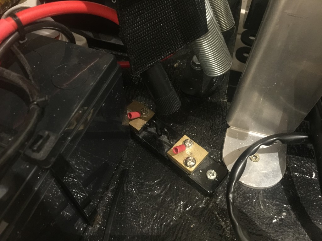

    Had to move the shunt a little bit to fit the new controller box

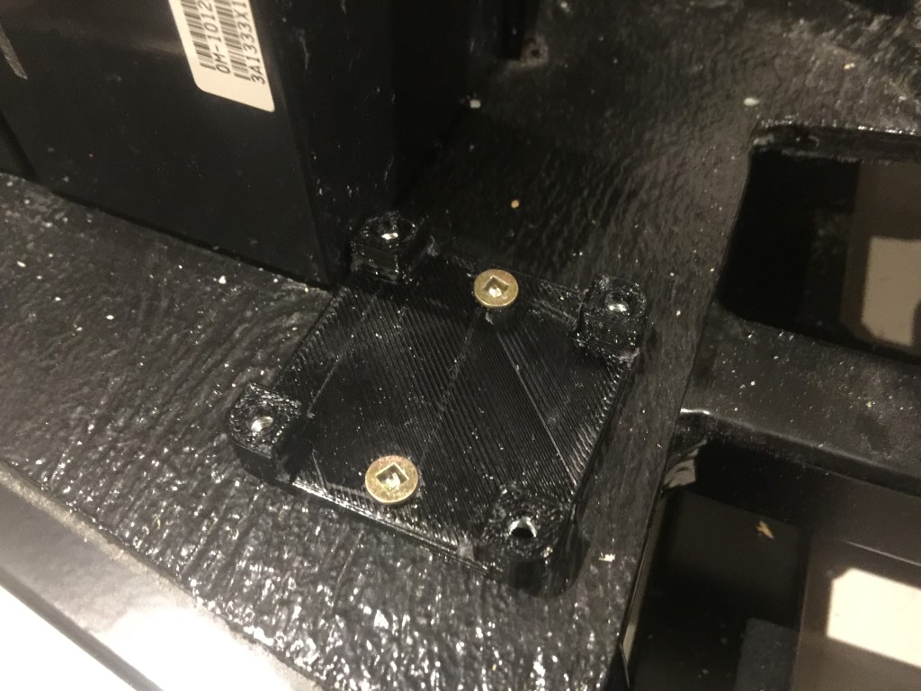

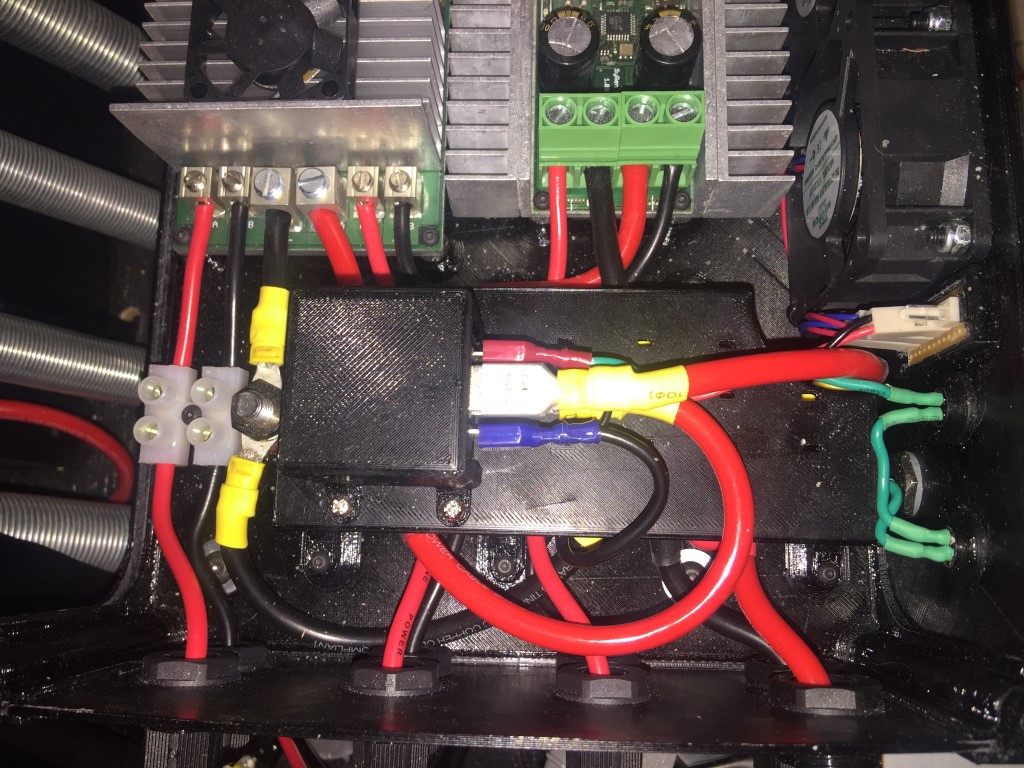

    Controller box in its final location
    Drilled and screwed in the base for the motion controller
  5. Avenga76
    Avenga76 Well-Known Member
    Jun 29, 2014
    518
    Network Engineer
    Auckland, New Zealand
    3,261Coins
    +858 / 6 / -0

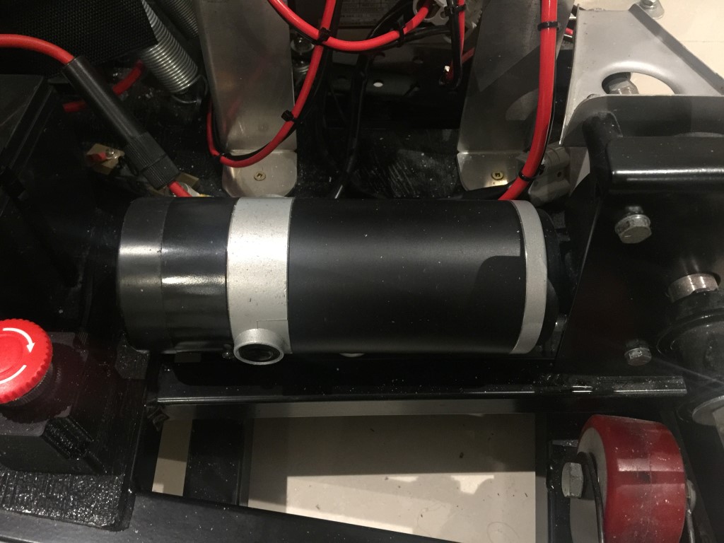

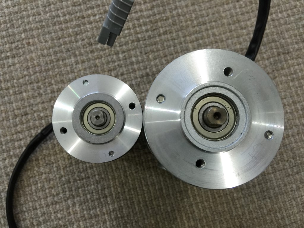

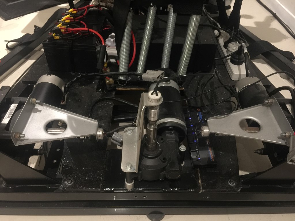

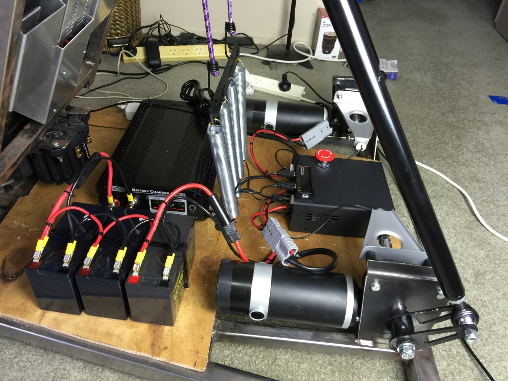

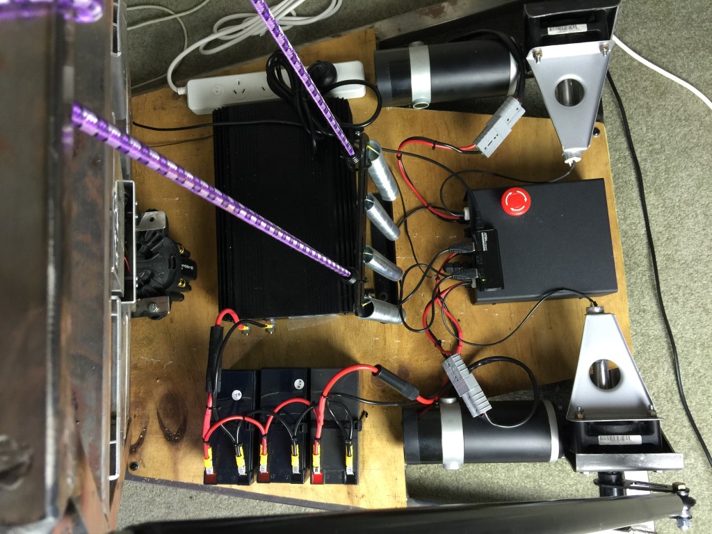

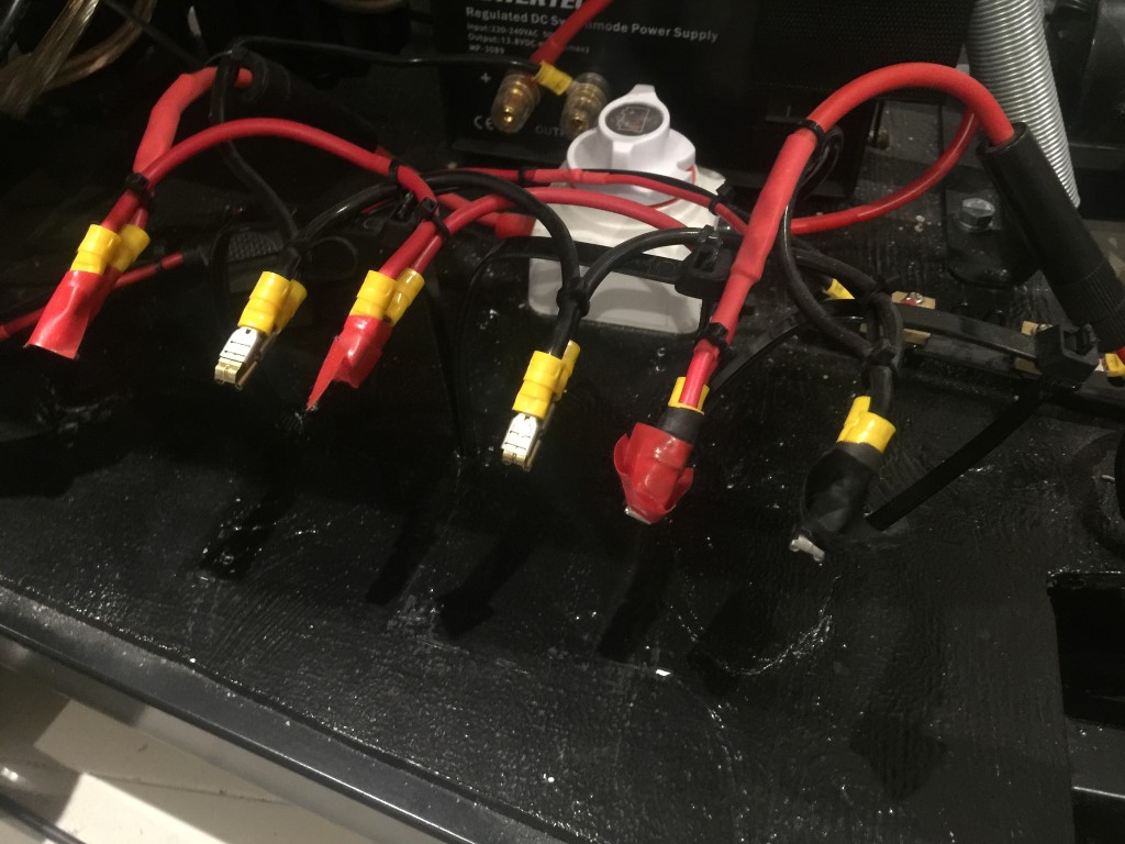

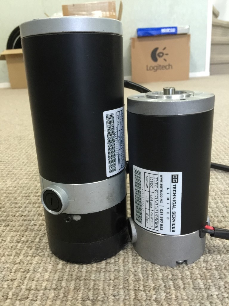

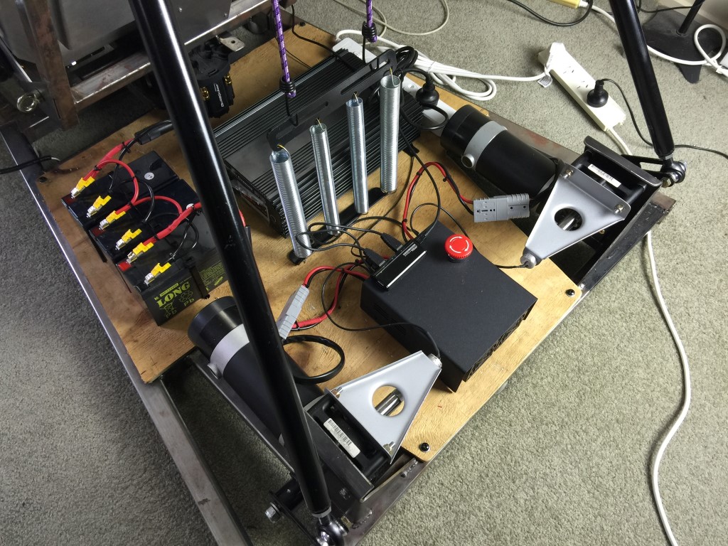

    Replaced my little 4,300 RPM motors for my much bigger 5,300 RPM motors, I also brought another one so I use the 5,300 RPM motor for all 3
    Here are some old photos of the size difference

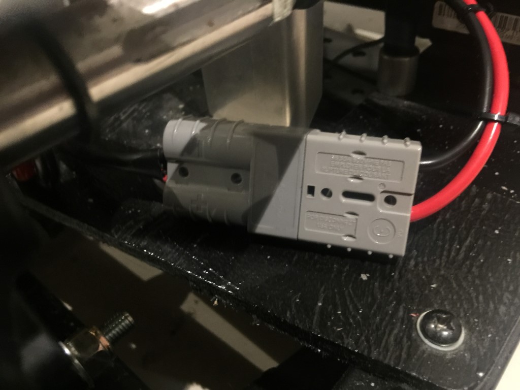

    Connected all of my motor cables and battery cables, it looks a little messy with the relay wires in the way but it looks better once the upper platform is installed.
    Installed the upper level and relay. Tested the relay and everything powered up okay

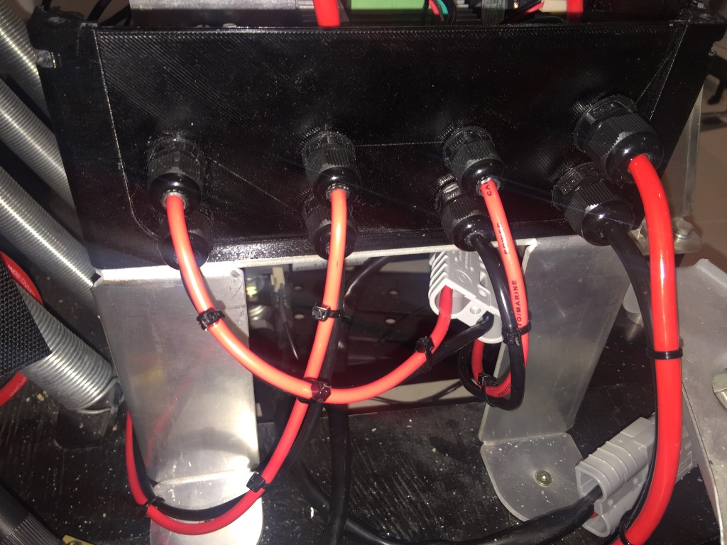

    Installed all the cable glands, the battery cables are to the right, and the rest are the motor cables.
    Installed all my Anderson connectors for all the motors

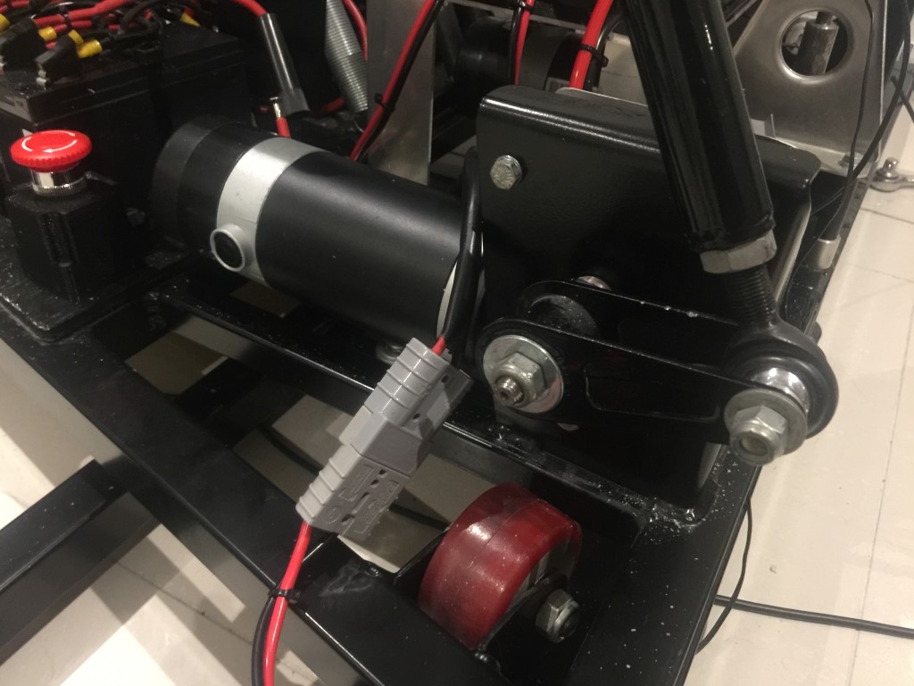

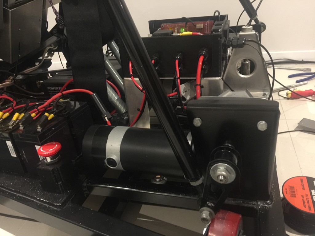

    So I got it all up and running but something went really wrong in my first testing in game.
    I set my upper limit to this angle
    And it all looked fine in the SMC3 software, but then in game something went really wrong.
    It way overshot the limits and went all the way around and wedged the lever arm in to the wheel of my rear traction loss.
    Not sure why it didn't obey the limits that I set but the motor was still pushing hard because it wedged itself hard in to the wheel

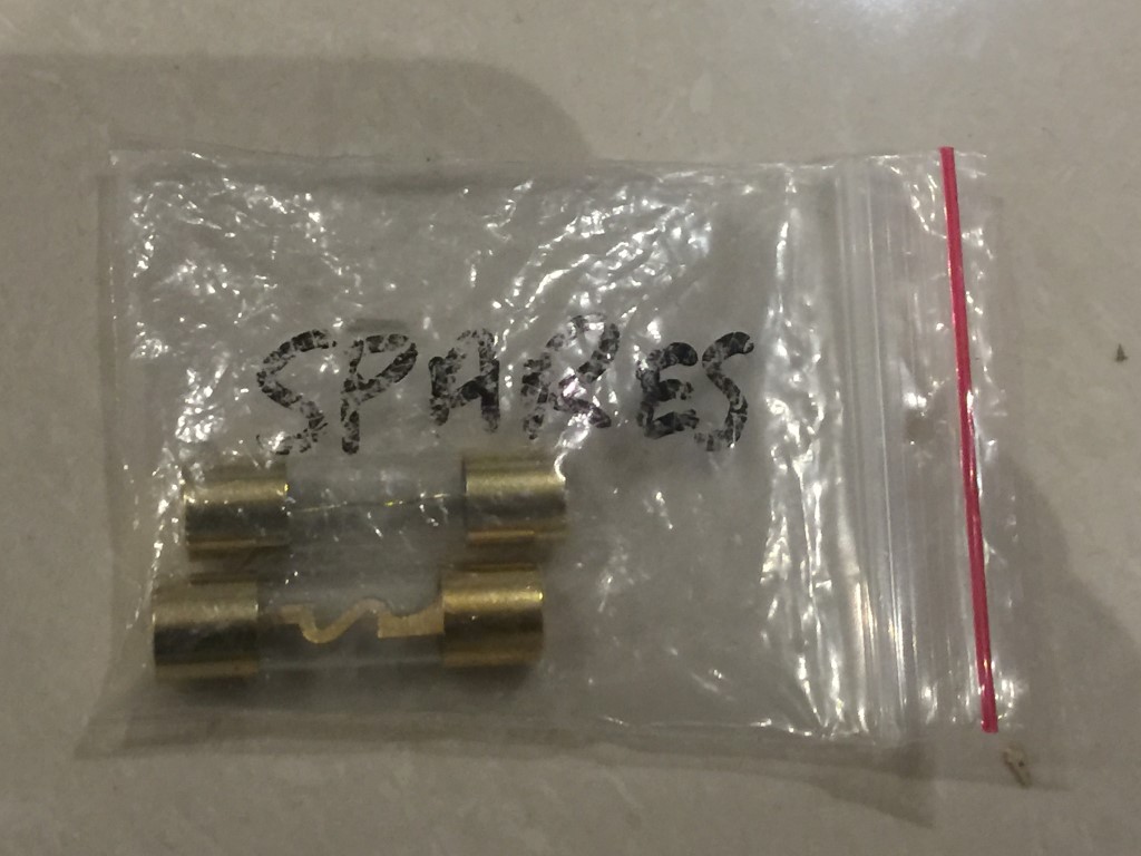

    The stall current then blew my main fuse between my batteries and the controller box, good thing I keep everything well protected so everything except the fuse was fine.
    Disconnected the motor cables from the controller box and used a spare battery to spin the motor back to the normal position.
    Lucky I still had some spare fuses so I popped them back in and the simulator is back up and running, just need to figure out what went wrong before I try it in game again.
