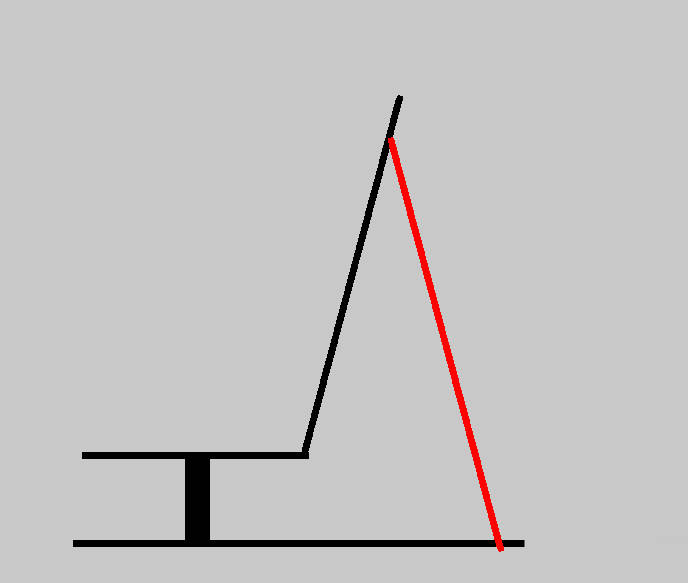

    Just trying to do some maths. Dave, earlier in the thread you said 15 degrees would be enough.
    I was thinking of having the shoulder mounts about here which is 950mm high.
    So that at 15 degrees that would work out to 250mm behind the shoulder mounts. Is that correct? Something like this (Not to scale)

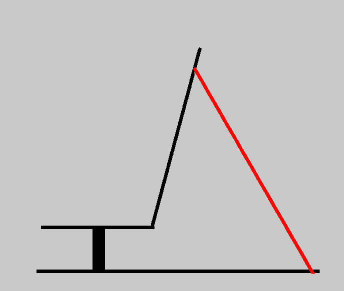

    I also did the maths on 30 degrees and it would work out to 550mm behind the seat which is pushing my space limits to the max. Realistically I could probably do around 20 degrees.
    This is it at 30 degrees.

    I use the prime position at 30 deg suits the end movement better, being Im only moving a persons weight off balance as the pivot supports most of that weight the 25:1 boxes are fine, for the extra weight your pushing they would be a lot slower at 15-20 deg to get over this I would use 50:1 boxes and use a lever length near 85mm c/c. Then use about 80-90 deg of the arm movement to produce the motion from, allowing for a faster end speed of the rig.

    Awesome. The motors I am using have 50:1 boxes. So if I go something like 20 degrees with a 85mm CTC arm and 80-90 degrees of rotation.
    That would put the bottom of the arms 350mm behind the shoulder mounts.
    Another question, does the outward angle need to be the same as the backwards angle? so do they need to be 20 degrees out and 20 degrees back or can it be 15 degrees out and 20 degrees back?

    You will find that the rods only allow a maximum offset of 15 deg and will bind up, so I like to set mine between 5-7 deg leaning towards the centre , this also aids in the stability of the platform too and if too vertical will allow and encourage radial twist at the pivot point.
    So depending on the range of freedom of the rod end will depend on how far you can spread the motors.
    Leaning in at 5 deg would be a good place to start.
