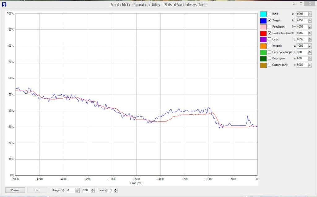

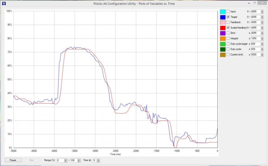

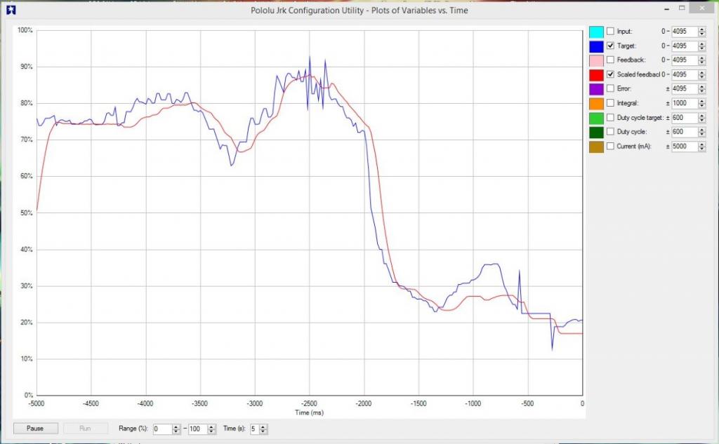

    Okay I did some testing on the PID Period Exceeded. It is not because I am running my JRK's too quick.
    It was because of a setting that Dave told me to change yesterday.
    The manual says. The indicator labeled “PID period exceeded” at the top of the window is provided as a warning for when the analog sampling takes more time than the specified PID period.
    I lower that back down to 512 and that PID Period Exceeded error goes away but it doesn't change anything.
    When I first got my rig running used that article and I spent a day testing this and posted my results above with tons of screenshots and I listed my methodology on how I came to those numbers. So if you all think I have it wrong then please tell me what I did wrong.
    I have recreated that test using the JRK graph and I am very happy with how to PID is looking what I am driving. This is using my original PID setting which I think are pretty good. As I said I spent a full day testing this and this is the best I could come up with.
    This is with a pretty extreme motion profile. The scale is of 0-100% of my motor position and the time span is 5 seconds so it is probably more zoomed in the @RufusDufus test (I can't tell what time scale his is so mine might look worse if it is more zoomed in)
    This is a braking zone followed by a sharp hair pin corner. this is using 70% of my travel so it is a pretty extreme movement but the motors are following the movement very nicely
    A right then left chicane
    A gentle sweeper
    I have recorded a video of the graph while the AI races with me in the seat. I am very happy with how quickly the simulator responds. It is capable of this kind of motion with out any motor errors, It is only when I go off track.
    Please watch it and give me your feedback
