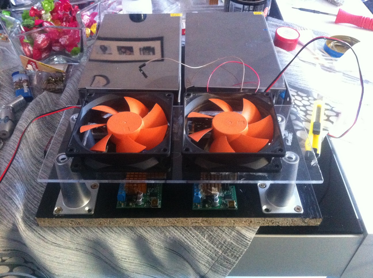

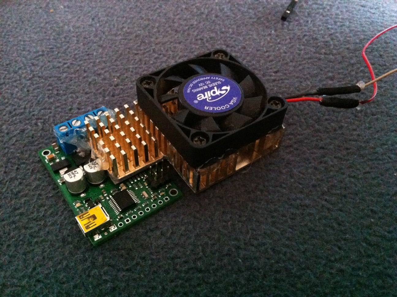

    The JRK's are very well cooled. They have huge heatsinks and 2 fans blowing at full speed. It it is really loud but I went totally overkill on the cooling.
    I will do some videos of it tonight.

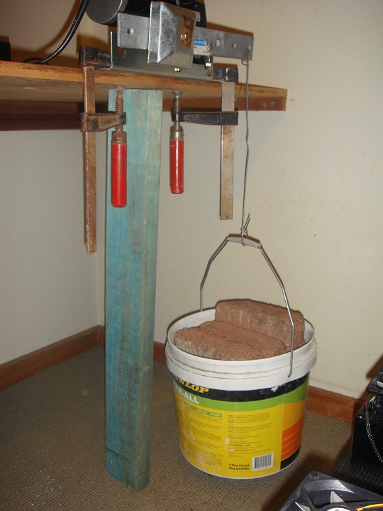

    For comparison, below is the type of weight (approx 18Kg) that I was able to reliably drive with a 200w motor with a 60:1 gear box. So you have something very wrong going on with those motors/gearbox.
  13. SeatTime
    2,572
    Nice, Yea, I know overkill..:)

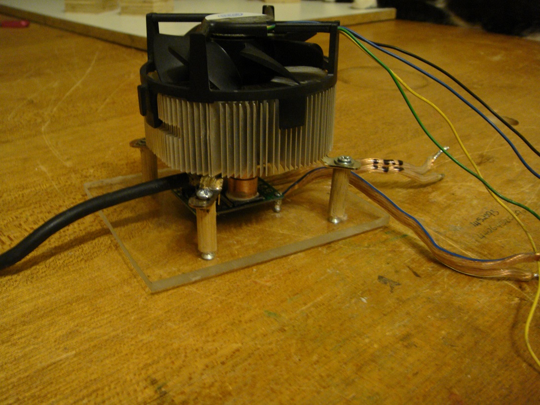

    Since you people are showing cooling overkills, this was mine back when I was building my sim. I was scared of JRK's overheating with big motors so I've cranked it up a notch :)
    Fan inside the fan - Fanception :)

    Maybe they do just get that hot that quickly.
