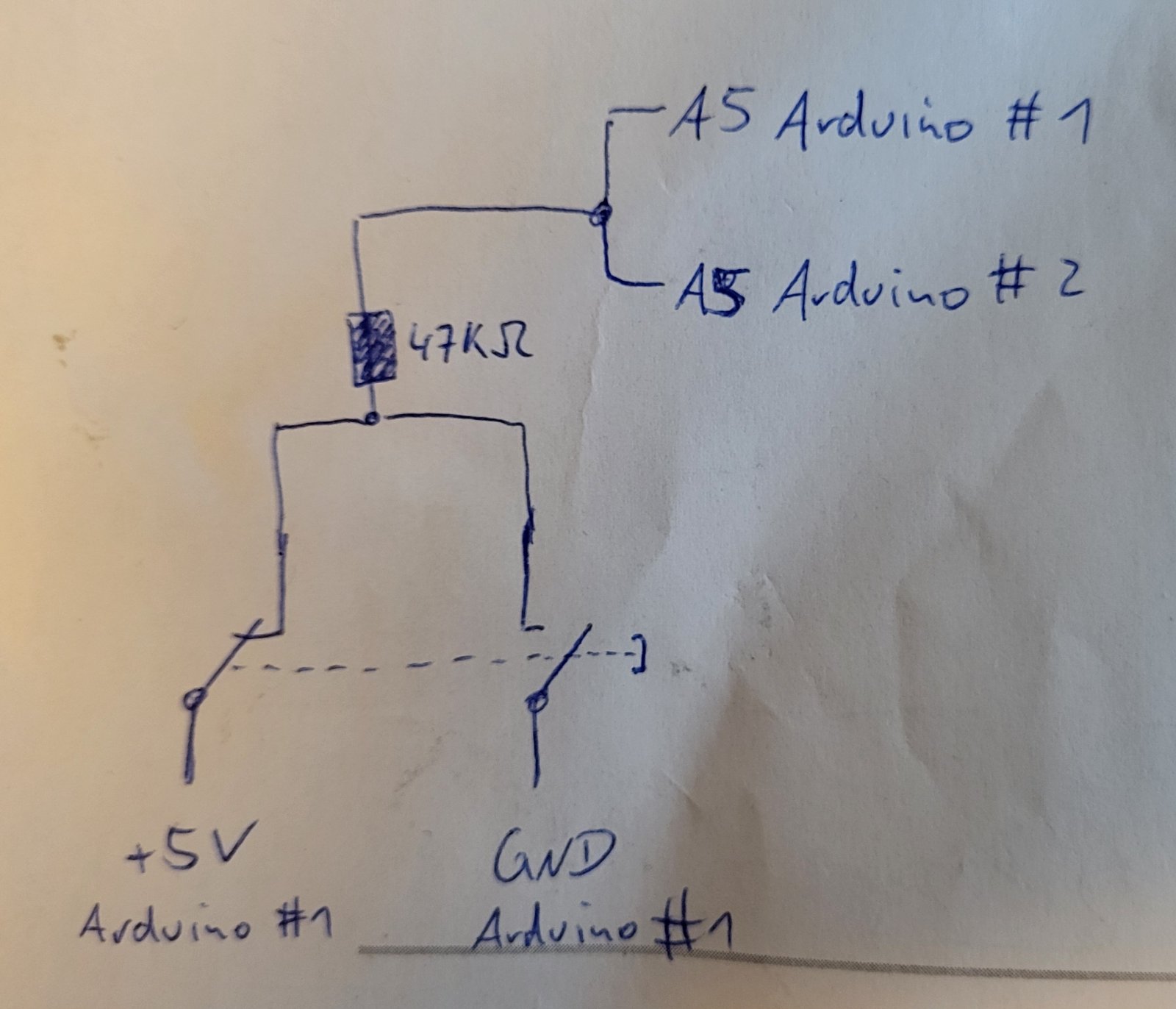

    I also want to tell y'all about the new feature I recently added. I call it "(emergency) soft off". I already had an emergency shutoff switch (that goes by "hard off" from now on). If I punch the hard of button, the power to the drivers (and thus the motors) is cut. This is the button to press if smoke comes out of the electronics box.
    The downside of this button is that, well, the seat goes down when its pressed. My weight is able to back drive those 60:1 worm drive gearboxes. The motors stop in a position thats way out of the max limit range set in SMC3utils. So SMC3 thinks there is an error and the motors stay shut down. I'll have to switch the jumpers on the drivers so I can use their buttons to bring the motors back to a working positon... thats quite some effort and takes about 15 minutes. If something goes sideways in a game, I usually don't want to press the hard off button, because the recovery takes so long.
    So I added the soft off. For that, I basically repurposed the pot scaling function of SMC3. If I punch this button, the arduinos ignore anything coming from the PC and try to recenter the seat. This is the button I press if a game glitches on me (looking at you, MSFS!). When the game issue is fixed, I can just reset the soft off button and the fun can go on.
    I attached a wiring diagram for the soft off function. Keep in mind you need a emergency shut off switch that has both, a normally open as well as a normally closed switch inside. You also need a resistor - I tested 1 kOhm and 47 kOhm, both worked fine. And last but not least: activate pot scaling the SMC3 arduino code.
    Oh, and both arduinos need to have the same GND level for this wiring diagram to work. Mine are powered from the same USB-hub, so this was not an issue.

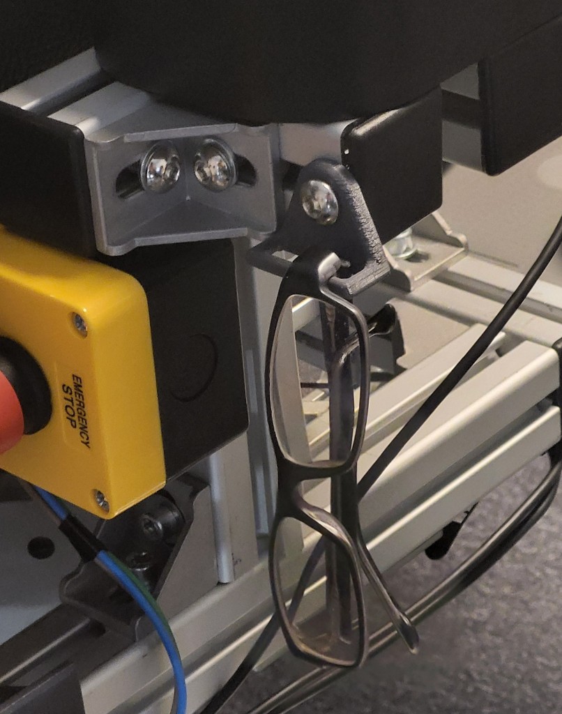

    As requested, I uploaded a zip file containing all the STLs I used for my rig. Most of them I've created myself, with the exception being the valve index controller mounts (i got it from thingiverse).
    https://drive.google.com/file/d/1UNzt1k7-XdfXjzRCJlHEc_JUxJ4Bgfjc/view?usp=drivesdk

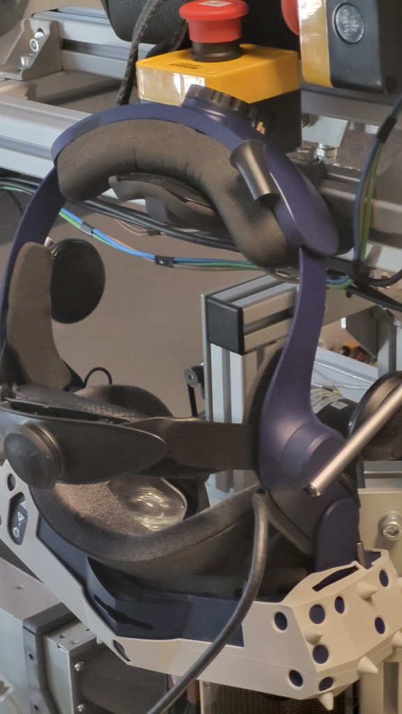

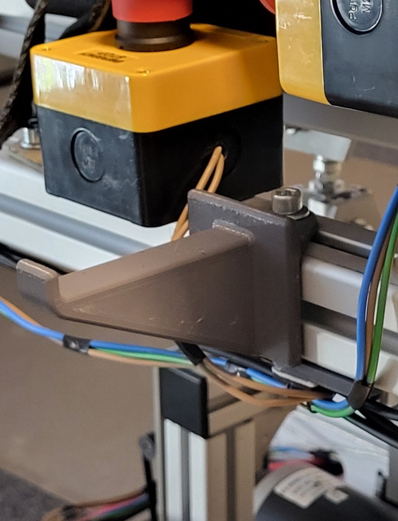

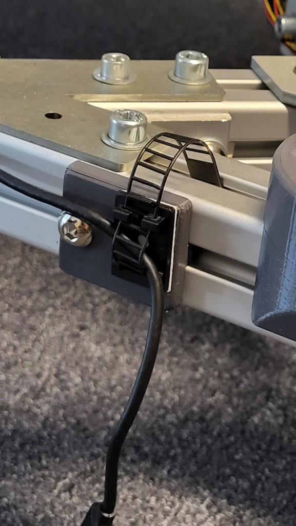

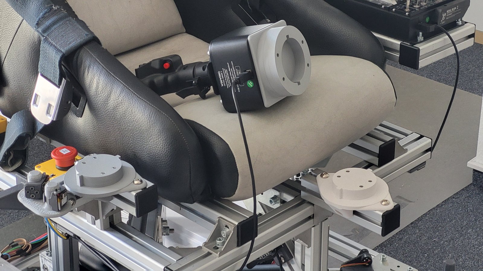

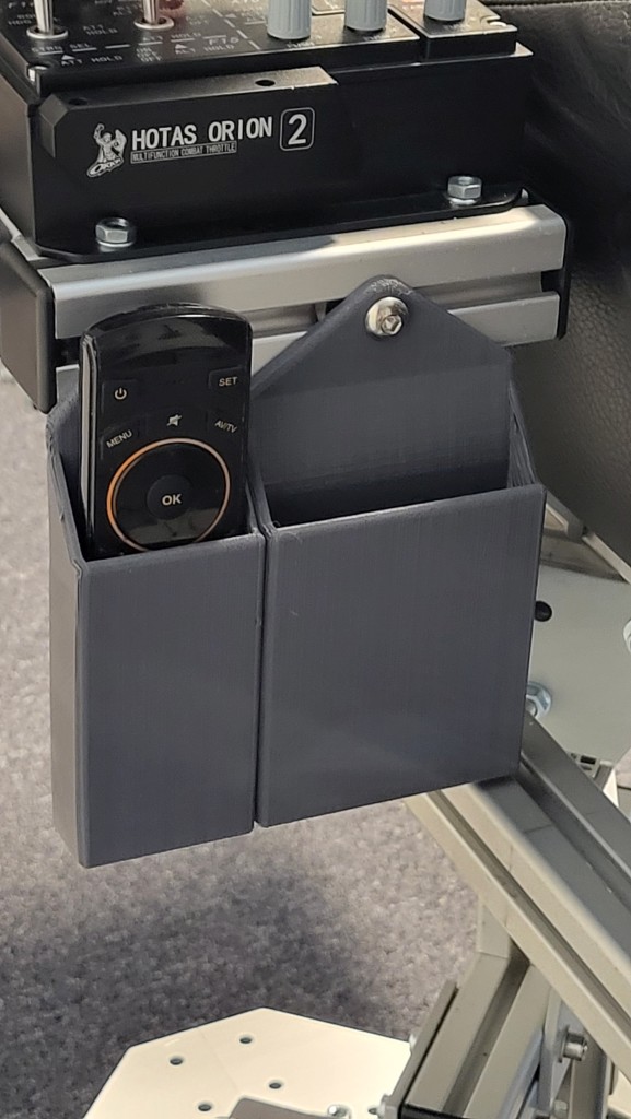

    I also uploaded pictures at the end of this post, showing the 3D printed parts in use. That way, it should get easier for y'all to check if there is something you could use for your own project.
    As it's often the case with custom 3D printed stuff, it was made to fit exactly the needs of the author. So it might not be optimal for your use case and you might need some modifications. I used Solidworks to design those parts and can provide you the original files. Just send me a PM and tell me what you need.
    A lot of these parts are made for easy mounting to 4040 aluminium extrusion profiles with M8 screws with cylindrical heads or pan heads (check the parts, some fit just one head type). Like I said, most of the parts were designed with specific components in mind.

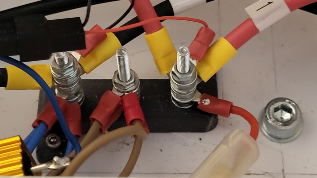

    Distributors.
    Use M4 screws with hex head. Lenght as needed for the number of cables you need to attach. I used 40 mm.

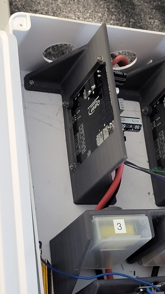

    Driver mount
    For Cytron MD30C motor driver. Mounts to a surface using M3 screws.
    Fuse mount (mount)
    For use with these fuse mounts:
    https://www.reichelt.de/kfz-sicheru...8-v-schraubanschluss-imaxx-h9120-p229122.html
    and these caps
    https://www.reichelt.de/deckel-fuer-kfz-sicherungshalter-h9120-maxioto-imaxx-h9105-p229121.html
    and these fuses
    https://www.reichelt.de/kfz-sicheru...ansor-340631-p337706.html?&trstct=pos_0&nbc=1

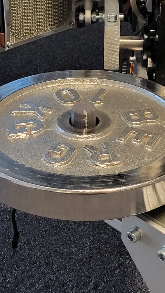

    Weight Mount
    For weight plates with 25mm/1inch hole diameter. For added lateral stability, a M5 screw with cylindric head and hex drive can be inserted into the pin that holds the plate centered. I think I used 40 or 50 mm lenght.

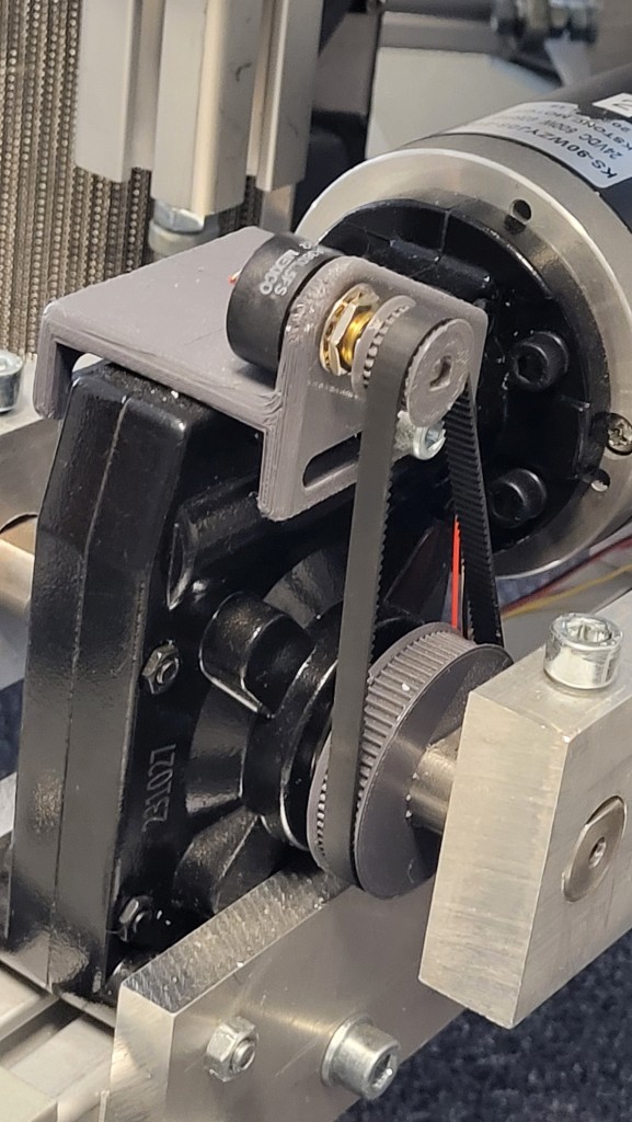

    Pulleys
    The small one fits the TT electronics 6127V1A360L.5FS hall pot I used. The tolerances produced by my printer resulted in a tight fit.
    The big one fits a 20 mm motor shaft with 18 mm D-cut. Again, the tolerances were tweaked to give tight fit on my printer.

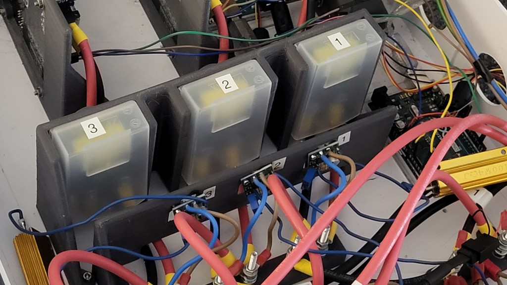

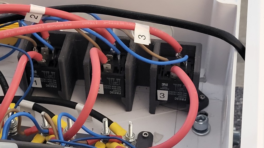

    Relay mount
    For 3 relais of this type
    https://www.reichelt.de/50a-hochstromrelais-frc2-24v-1-wechsler-frc2-c-24-p79402.html
    Shunt mount
    For 3 pololu shunt regulators. Mounts to a surface using M3 screws. M2 screws needed to mount the shunts.
    Tracker mount

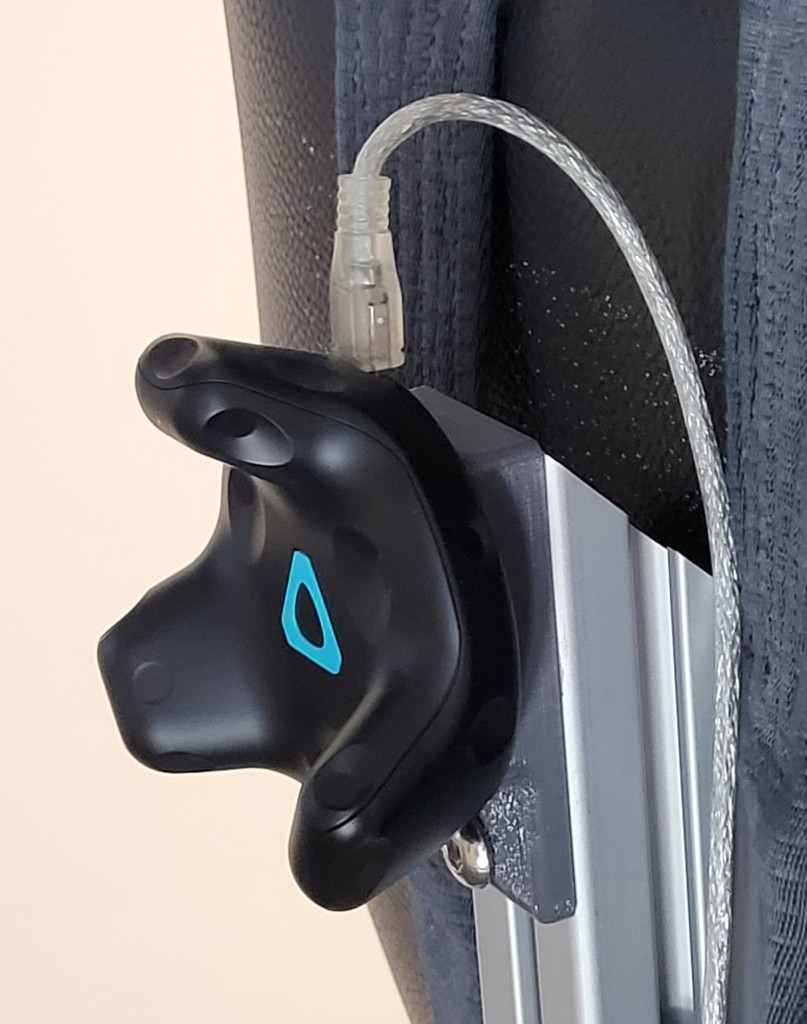

    I use a Valve Tracker Gen2, but I guess Gen1 and Gen3 should work, too.

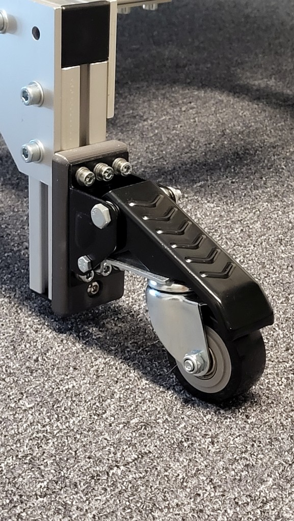

    Wheel adapter plate
    For workbench wheels of this type
    https://www.amazon.de/gp/aw/d/B0CJ2LP9BH

    On my rig, the pulley on the motor has 75 teeth, while the pulley on the pot has 25 teeth. So the ratio is 75/25=3. I use about +/-45 degrees of motor shaft rotation, so the pot rotates +/- 135 degrees.
    In theory, a higher ratio increases precision for the measurement of motor shaft position. But I don't think this is of practical relevance for any DIY rig.
    The real reason I chose to connect motor shaft and pot via pulley was that it seemed easier to do it this way on my rig. The end of my motor shaft is blocked by the motor levers. So it would have been hard to connect the pot directly.
    I assume ratio 1:1 would have worked equally well. It seems like many people do it this way.

    I noticed that sometimes slip occured between the belt and the pulley on the motorshaft. This means that the motor turned farther than the sensor would notice, which is obviously a bad thing.
    I disassebled the pulley and belt and noticed that indeed it didn't take much torque to make the belt slip on the pulley. It seemded like the geometry of the teeth on the pulley didn't exactly match the geometry of the teeth on the belt.
    Thinking about it, I noticed that it might have been a bad idea to 3D print teeth with 2 mm spacing using a 0,4 mm standard nozzle. That's simply to coarse for a geometry with such fine details. I switched to a 0,2 mm nozzle and printed the pulleys again.
    Testing it manually showed great improvement. I was able to apply a lot more torque to the belt before it would start to slip. Had no such issues since then.

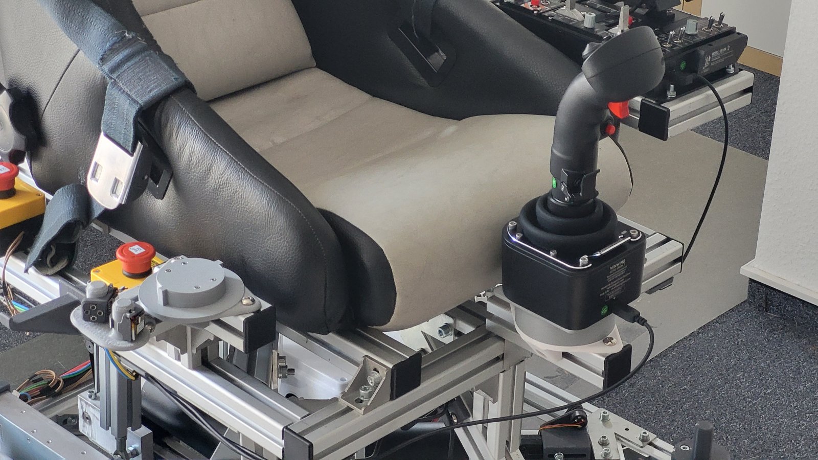

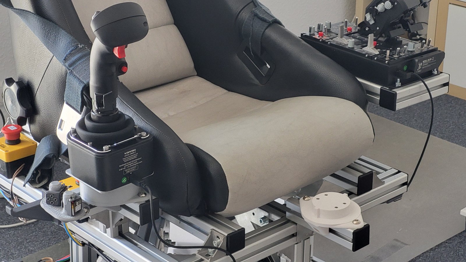

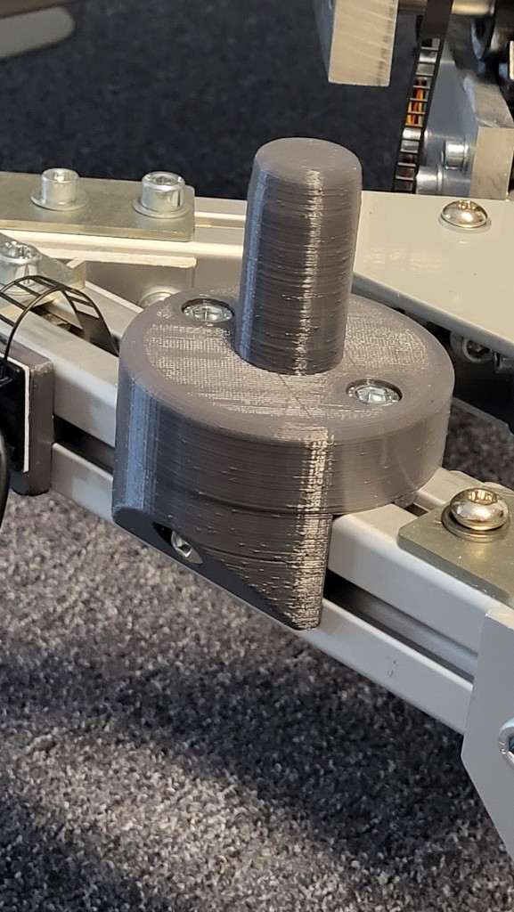

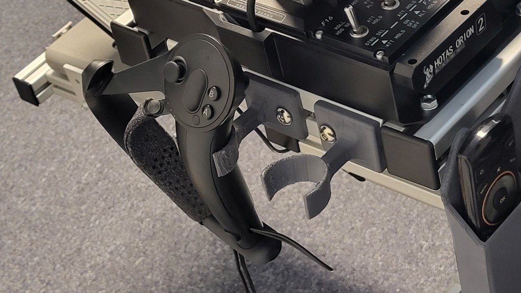

    I also came up with an idea to be able to quickly change between center stick and side stick. Thats because I wanted to try center stick but worried about how I would get into the seat. This seems to be way easier with side stick.
    My contraption is based on strong neodymium magnets of cylindrical shape (30 mm diameter, 10 mm height, N48, 34 kg force) and some 3D printed parts I designed. See attached pictures.
    Did I re-invent the wheel here? Are there other solutions out there that allow quickly switching between stick positions?
    The magnets are completely encapsulated by the 3D printed parts, to avoid accidents where the magnets get into direct contact with each other or get loose and smash against other magnetic objects.
    To seperate the joystick from its current mounting position, I need to pull it vertically with deliberate force (equivalent to lift something with a weight of between 5 and 10 kg I'd say). In normal use (moving the stick sideways) the base stays firmly in place. Tight tolerances and a good fit between the 3d printed cylindrical geometries on both stick and mounting base are important for that.
    At first, the hall sensors in the stick were confused by the presence of the mounting magnets. Recalibration solved that issue. As the magnets don't move relative to the stick, I assume no further recalibration will be needed (unless I put away my contraption entirely).
