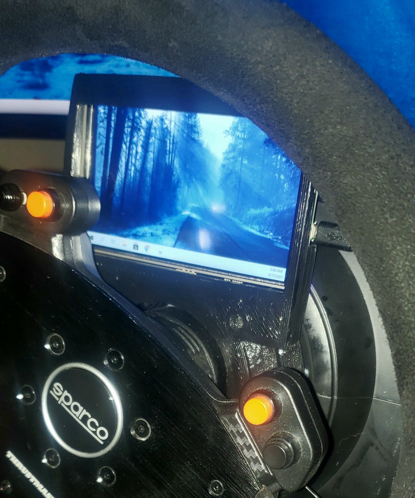

    Awesome thanks for the clarification. I need to make a few sizing tweaks then I'll post them. I also made a custom lcd screen wheelbase mount that will work on any t series thrustmaster base that i will post as well.
