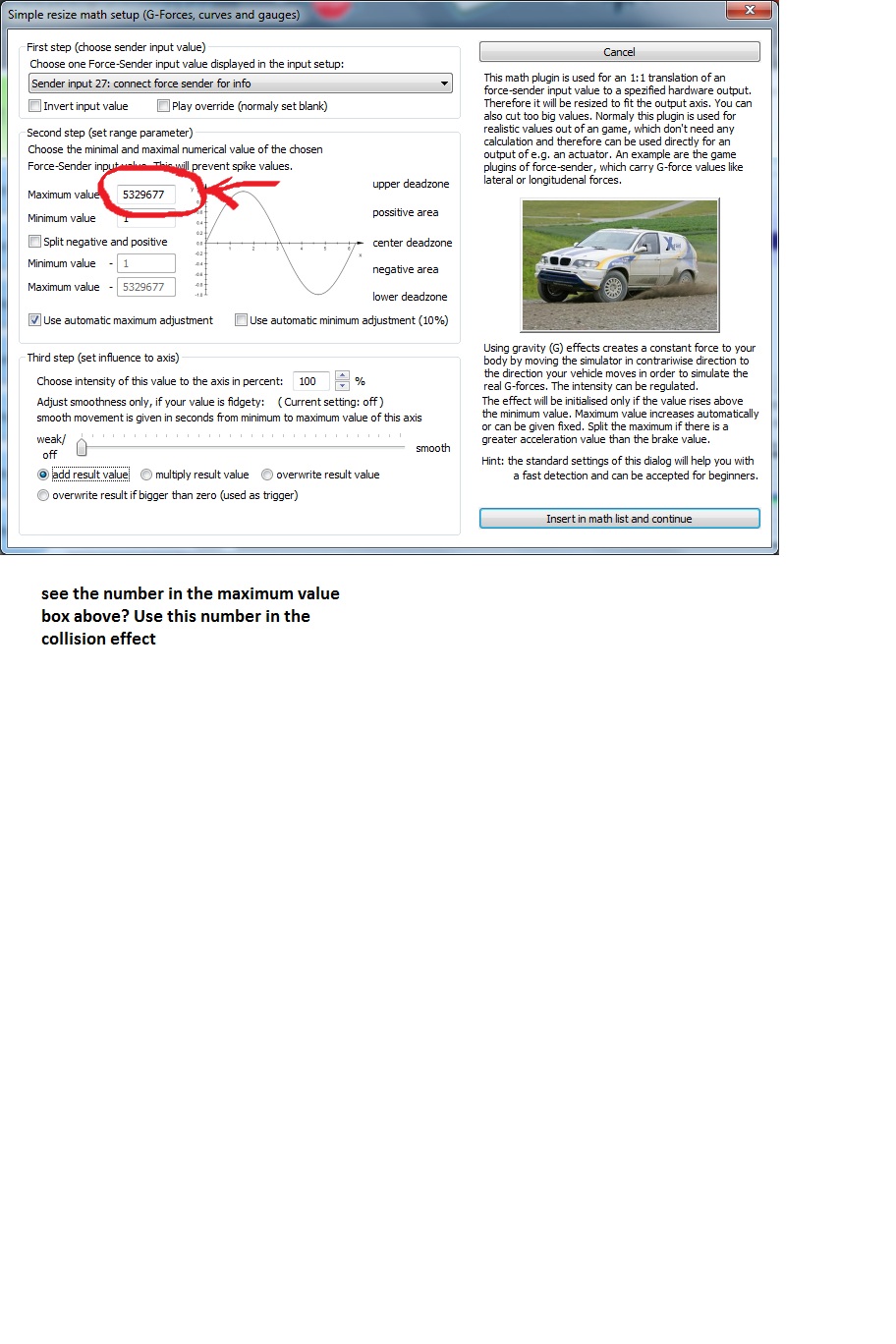

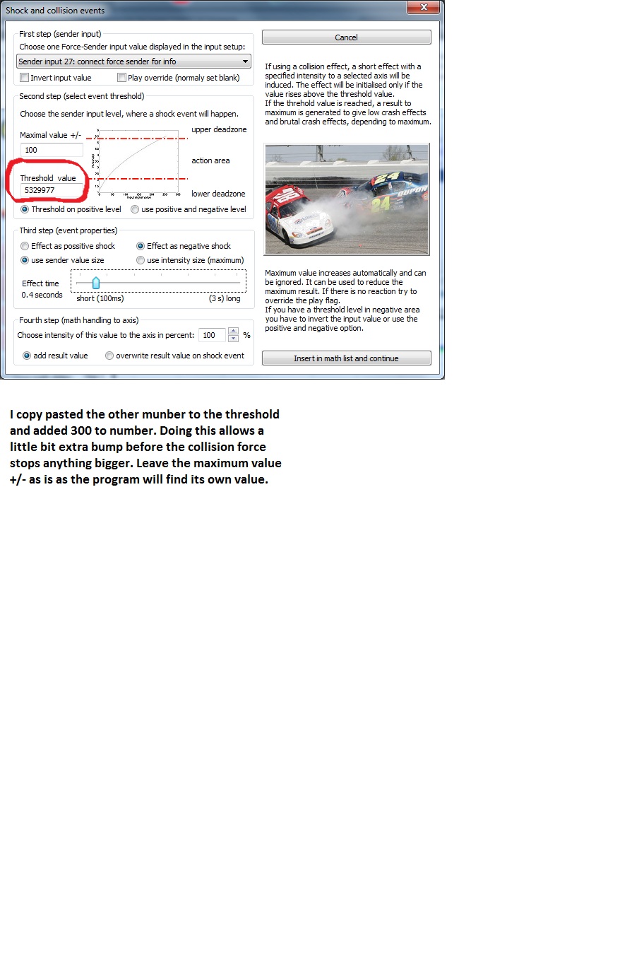

  8. bsft
    I will take a screen shot or two later and post them to explain
    Ok here it is...
    The bottom pic is the force and I have circled the number I use. ( you use whatever number you have ).
    I copy - pasted that number into the collision effect and selected the same force and put in the threshold value and I added, in this case 300 to the overall number. Adding a bit allows you to get that slight extra bump before the collision effect takes over. I left the maximum value alone as the program finds its own number. The I adjust time of effect ( 0.1 - 1 second) . I did this under instruction from Eaorobbie for all my forces on all axis.

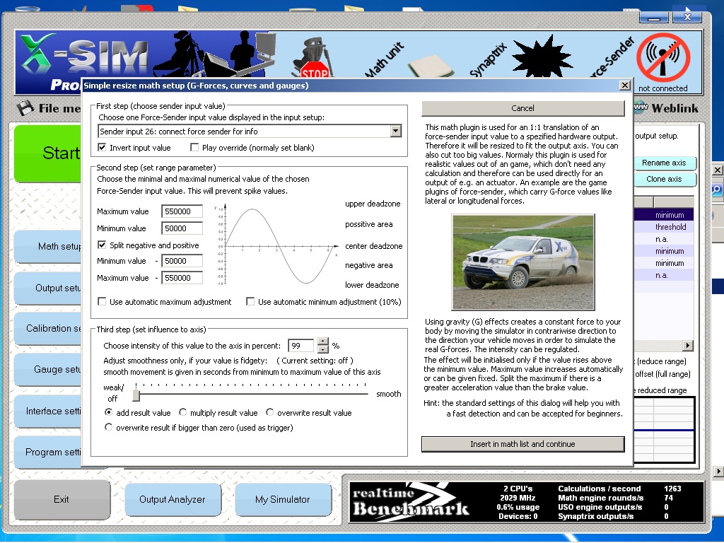

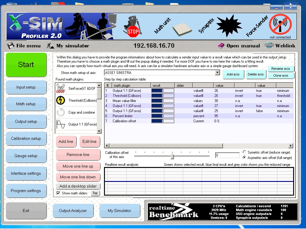

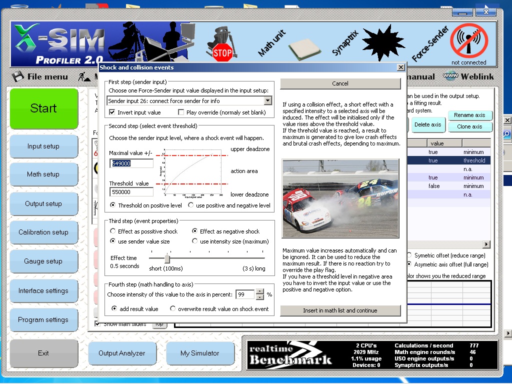

    Hi again bsft and hi all,
    please take a look on these pics about my threshold collision effect solution to avoid the overshoot of my motors on the 26 effect / vertical force :
    You can notice that:
    1) I put the threshold math plugin line just below the 26 effect line and not as the last line of the axis.
    2) I am using 550000 as maximum gForce math value and I am using this same value for the threshold value in the threshold collision math plugin
    3) So when the value will reach the 550000 value so the collision event will start.
    4) In the threshold collision math plugin page I put 549000 as the maximal value +/-.
    My idea to avoid the motor overshot is : When the 550000 value is reached and the collision event start so immediately later I will obtain a value that forces the motor to stop his run to the over limit position because the new collision event order is that the motor have to change is direction.
    I hope you can understand what I mean!
    5) I am using inverted input value and effect as negative shock in the threshold collision math plugin page to obtain the collision effect start ONLY when I reach a -550000 value (negative value).
    So I don't want to obtain the collision effect start when I get positive 550000 value. The collision event must start ONLY when I get a negative value of 550000.
    6) After these 5 point I ask to you : Are we sure that the maximal value +/- on the threshold collision math plugin is the value that the motor MUST reach when the collision event will start??.. right?? :blush:
    It's all correct ?

  11. bsft
    Add 200-500 to threshold value, leave max value alone, it will always update its own number , try that

    Sorry bsft if I repeat question, but I would to get perfectly the situation challenging my evil english.. :(
    When you write max value alone so are you meaning to check the automatic maximum adjustment on the gForce 1:1 plugin?
    or you mean just to leave the MAXIMAL VALUE +/- from threshold collision math plugin without modifications?
    If you mean the one from gForce 1:1 plugin so I noticed that checking the automatic maximum adjustment then I obtain an automatic value in the maximal value +/- in the threshold collision math plugin. So probably you mean this..
  13. bsft
    That is what I mean. You have got it.

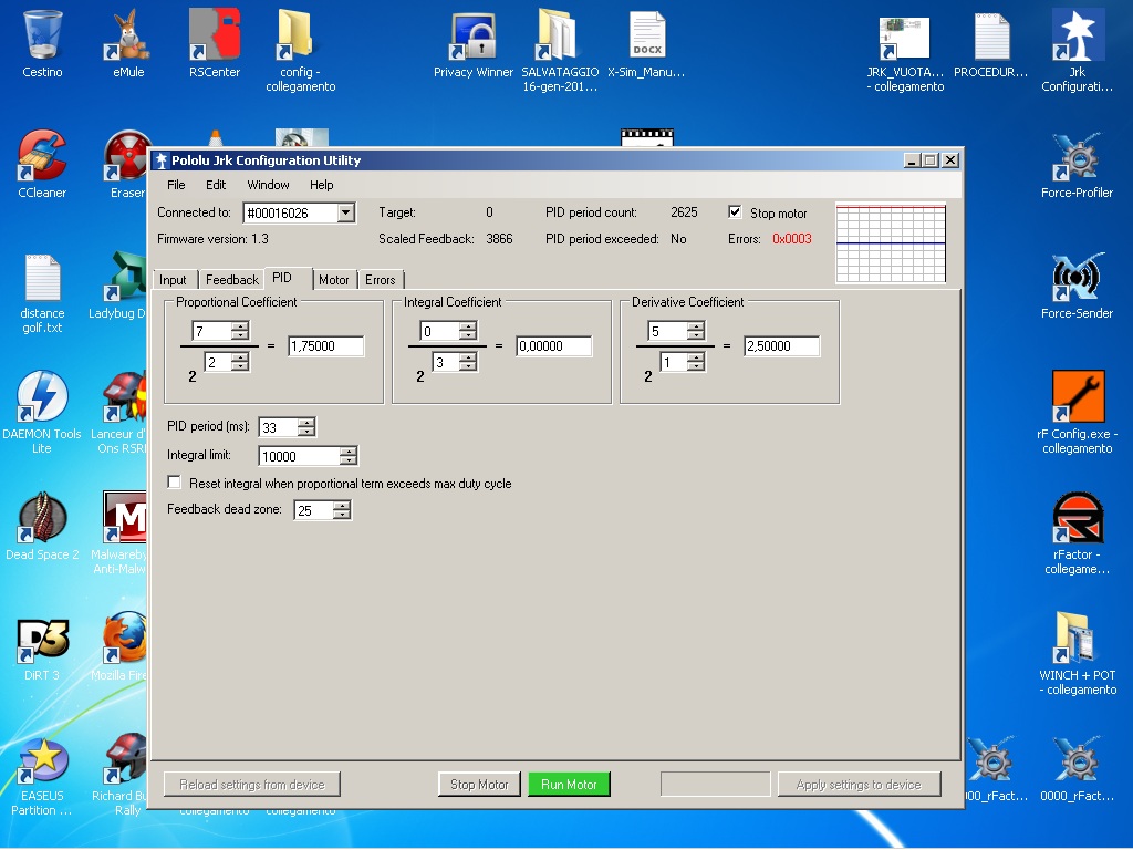

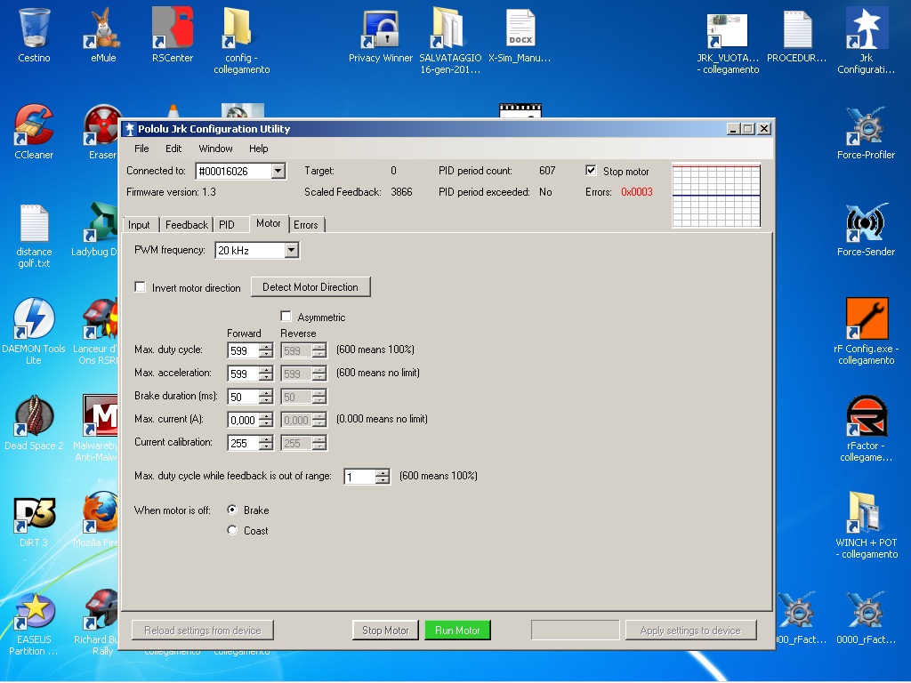

    Jrk config setup:
    PWM frequency 20Khz
    Actual duty cycle = 599/600
    Actual accelleration = 599/600
    Brake duration = 50
    Max current = 0 (no limits)
    Current calibration = 255
    PID configuration = 4/2 - 0/3 - 0/0 (I think not my best PID setting and sure this one don't push the motors to their max speed.. next tests will use a best PID!)
    PID period = 33ms
    Integral limit = 10000
    Feedback dead zone = 25
    Abs Max = 4013
    Max = 3693
    Min = 400
    Abs Min = 80

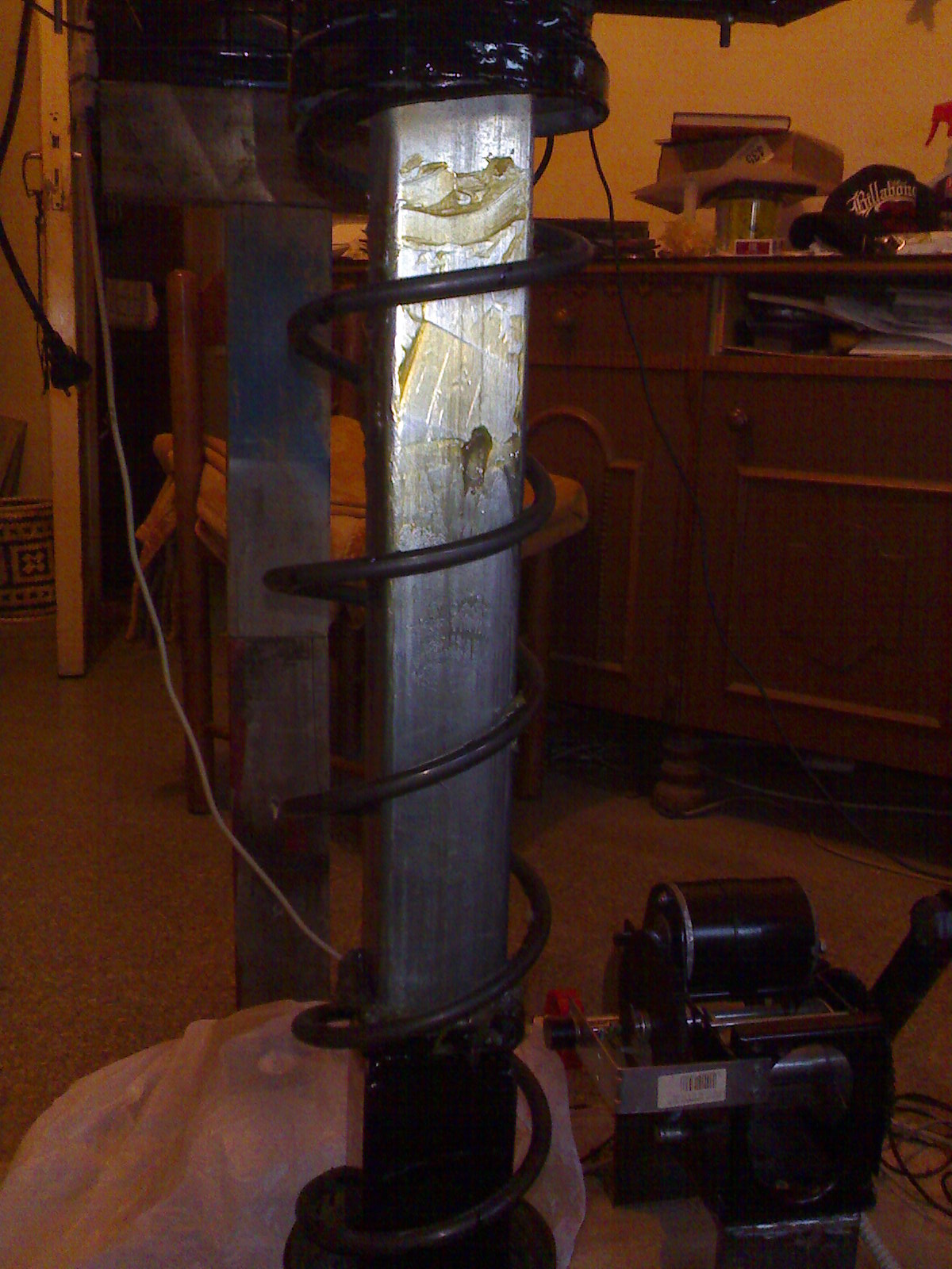

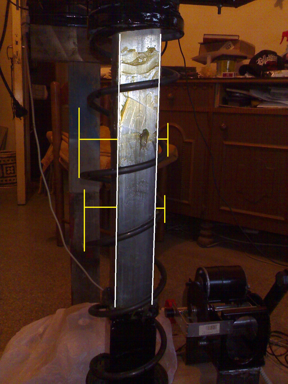

    Please take a look to my spring after a total of 3 or 4 test days:
    For this new spring, I avoided to put the welding to block the spring in the up and down attachment points. This mean that using my platform I obtained the spring rotate in his attachment point producing this bad situation!.
    I notice in the last test that on coil touching the cylinder blocking for some moments the motor and giving an amps peak to my jrk.
    Today I will work to repositioning the spring to avoid this bad situation and probably I will to put 2 welding points.
