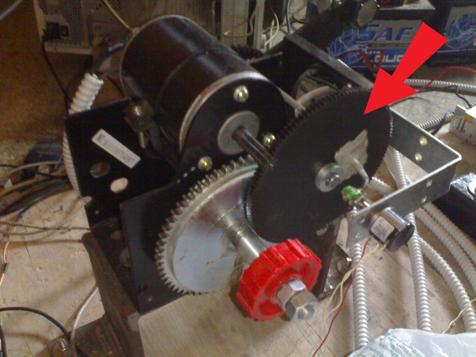

    Ok, I made the tests and I feel a mix between joy about performances and sadness about a bad mechanical problem I got..
    When I finished the test showed in this video so I made another one test and I get my left motor crazy and it went really over the minimum position, the ABS MIN and the FEEDBACK DISCONNECT security system did not work as if there was no security system... So the motor stirrup going down it's finished to push a winch bolt trying to continue the crazy motion.... I got my pot gear with 2 or 3 broken theet..
    I notice too that X-SIM made an automatic STOP of the simulator but the motor continue to want to go... then I stop the problem only when I cut the current..
    So tests stopped and I need another winch :(( (In fact I need just another iron gear but the only way I know to obtain a gear as this is to buy another winch...
    I tried to use aggressive profile (very reduced mean value filter so a lot of peak movements and little bumps too) and aggressive PID (I think the PID is the cause of the bad problem):

    Hey dude you would save me!!! I need just the gear attached to the motor shaft, not all the winch!
    Please tahustvedt, make me know (with a private message)how can you send me the gear and how many money the shipping need!
    You should can really save me 'cause at the moment I have really overtake the budget and I can't buy another one winch.... ... .. .
  8. tahustvedt
    tahustvedt Member
    Nov 23, 2011
    201
    62Coins
    +8 / 0 / -0
    Can you post a picture of the gear you need?

    Here the pic showing the gear. In my system this is the gear where the pot is mounted!
  10. tahustvedt
    tahustvedt Member
    Nov 23, 2011
    201
    62Coins
    +8 / 0 / -0
    I have an unused gear like that here. We can swap. You send me your broken gear and I send you my new one. I need it to make a hub for my plastic gear later out of the broken gear. :)
    Send me your address in a PM.

    But today something strange has happened.
    For the first time I notice the follow:
    1) The feedback disconnected secure system when the pot reached the Abs Max value was as non-existent... as it did not exist..
    When the motor exceeded the abs max value so it continue his run since it touch a bolt of the winch...
    I obtained the pot damaged too because the motor run turning the pot on his limit turn breaking it.
    Then first time I see my feedback disconnect emergency stop not working..
    2) X-SIM realize that there was a problem and automatically has STOPPED the comunication (as if I had pressed the x-sim stop button) but for the very first time this was not enough to exit the emergency... in fact the motor continue his run to the destruction...
    3) I get the problem WHEN I done 2 consecutive drifting corners... In the very last moment of the drift I notice my platform behaviour strange.. and some moment later I listened a bad crack crack crack sound.. (the motor stirrup trying to move throught a winch bolt...)
    All this is very bad because make me really confused about a solution...
    as jimakosgr2002 told I think I will to use 2 turn/off buttons for each motor..
    If the motor stirrup goes crazy and without control so it will finish to touch a MAX or MIN stop current button...
    at least I will to avoid to get again a problem bad as the one of today..

    Guys, in first I am really happy about your interest and help.
    I very carefully read the last BartS and bsft messages and I taked a lot of points of interest.
    But unfortunately I find the problem.. and yes, it's my fault. :(
    Just all these months of work and my attention slowly fall and I forget to set ON in the input disconnected and feedback disconnected error page of the jrk config utility precisely for the motor that went mad.
    (I modified to OFF these options, one week ago for some tests and never forget to re enable...)
    Each other 2 motors have these options enabled but just now I noticed that the left motor jrk have these 2 options disabled. :(
    I think if these options are disabled then is normal that If the motor exceeds the pot abs max level nothing will brake it..
    I do not know how I could forget this fundamental security step.. I know just this has happened.
    if I had enabled these securities options from jrk config utility so I have gotten just the motor position over the abs max then the motor stirrup stopped before to make damage.
    But both the security options was not enabled.. and bye bye.
    Probably I need a bit of time of relax and shut-off from my project, or just to use more relax and operative way to continue to work.
    I can not really afford these expense damages.. :(
    From a side of this sad discover, this is a good thing too because now, probably, we know WHY this is happen and no more fear about strange jrk behaviour.
    Just a damn my error.
