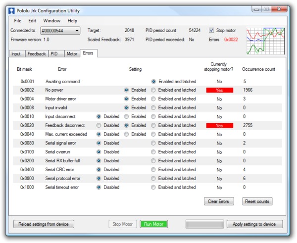

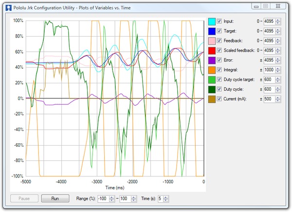

    Another thing,
    in the plot of variables window in the jrk config utility I can see the ERROR variable:
    It this variable referred to the accumulation of PID errors in the time?
    And if yes, what of the errors showed on the error tab is the same showed in the variables plot?:
    Or maybe the error variable in the plot of variables window is a total value of all possible errors?

    I havent looked that far, but feedback disconnect is exactly that, there is a good chance you may be over throwing your pots feedback settings to cause it to fly too far. I had the same problem, so I re-did feedback, adjusted PID to help stop overshoot and got results.
    Errors will always happen, its just the JRK handing them is the key, things like PID rate as well, I run mine at 25ms, 5ms caused too many errors.
    Maybe with your setup , it requires some more work on PID and stuff.

    The error graph looks like the difference between the target and feedback. Error in this case means the difference that you are trying to eliminate with PID adjustment.

    Ah, good confirmation. Probably the motor goes overshot when this graph become too distance from the feedback graph (or just I think..).
    Next tests I will try to watch this graph while someone driving my platform.
    Just to undertand how this graph work related to the feedback and target in the different driving style, profiler and PID..

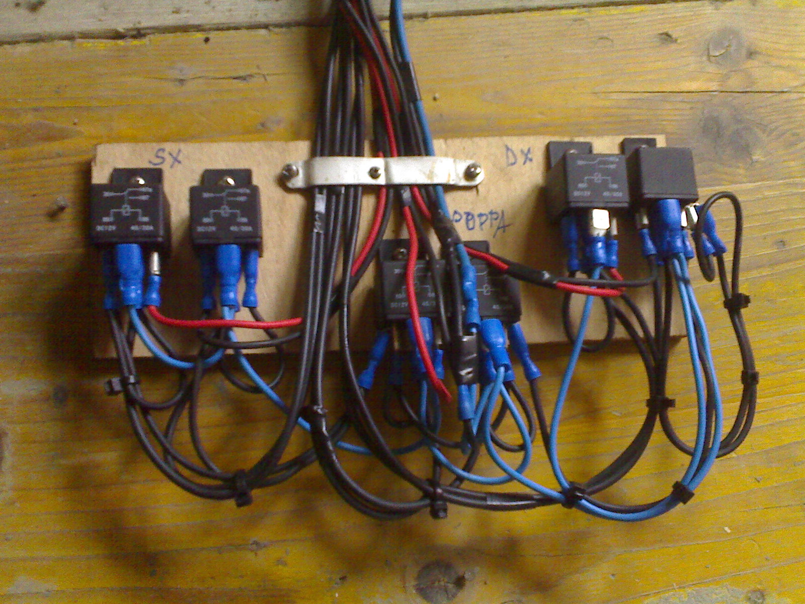

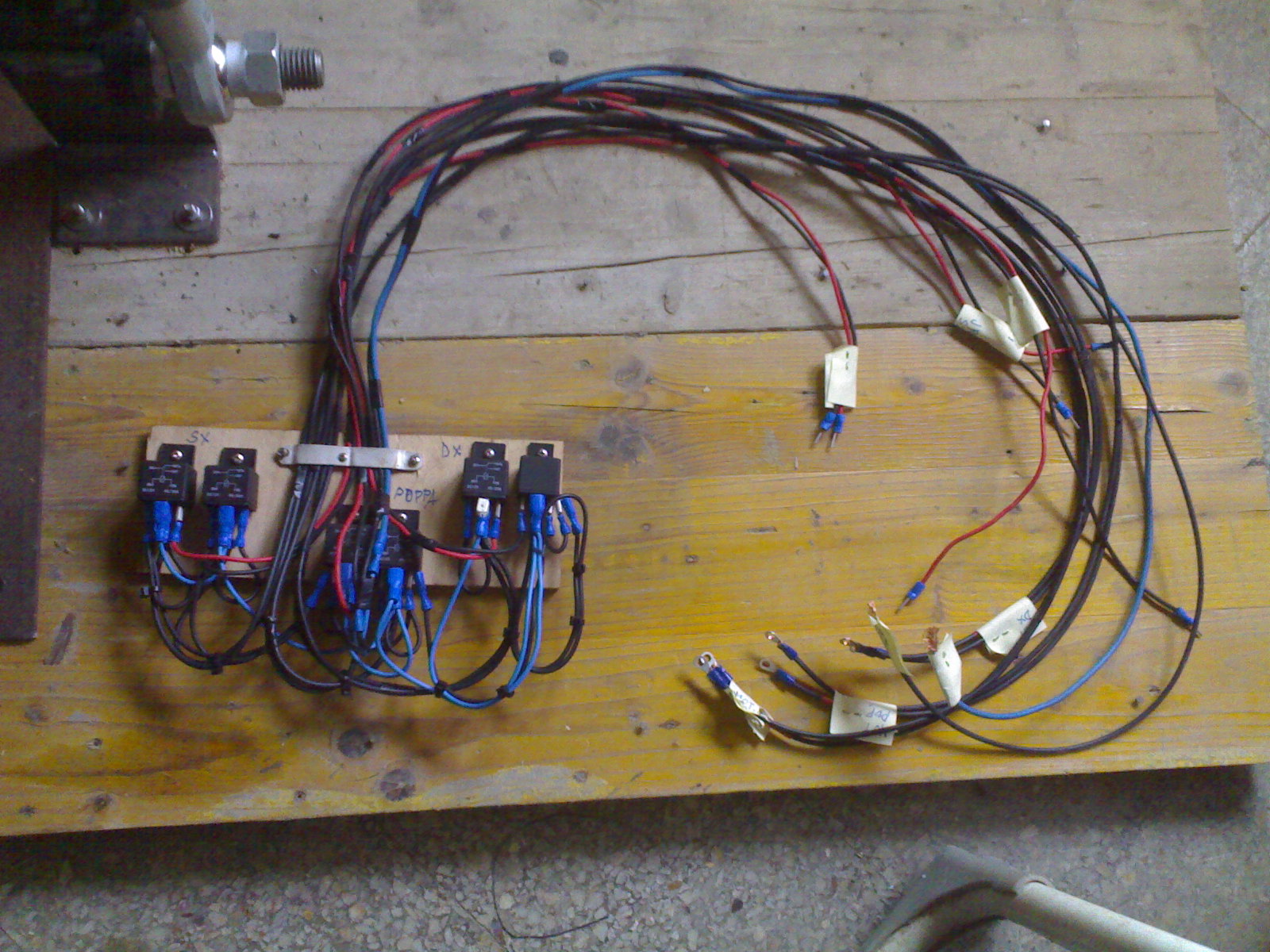

    Here the pics:
    I am really curious about. Finally I am near to test this POWER plug for my 3dof.. total power from the motor of the winch.
    IF you set the max current to infinite with cycle and accelleration to the max so you can't reach the power of the winch motor directly plugged to the batteries.
    The jrk make a GREAT work but can't handle all the real motor power.
    Using the relays system will be as the motors are directly plugged to the batteries.. really MAX power from these motors..

    Using realy system I get the same power of the motor directly plugged to the battery.
    So maybe tomorrow will be the right moment to plug my BOOST system! will see :)
