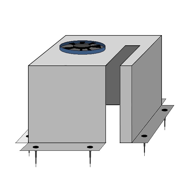

  6. AldoZ
    AldoZ Member
    Aug 26, 2010
    286
    Pc Shop
    366Coins
    +6 / 1 / -0
    Hi again, here the first prototype of the cap box made for cover my motors!
    This cap should to reduce the loud noises of the motor!
    I am working to know exactly what materials to use for the external and internal of the sides of this cap box.
    I think I will to use bronze or thick steel for the external of the sides and some sound absorber material (like the one used in the walls of the music record studios) for the internal sides.
    I hope that the 2 open areas of this box (one of these open areas is the zone in where the motor stirrup will slide and the second open area is where I will put a fan to freeze a bit the motor inside this cap box) can't ruin my plan to reduce the noises.. In fact the sound can flow to the external from these 2 open areas of the box..
    What do you think about?
