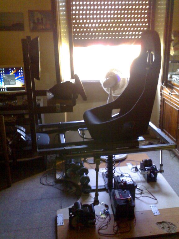

    Hello, here my new vids. These vids shows the last mechanical stress tests using X-SIM test plugin.
    this is the list of the changes of the platform since the last time.
    1) Damper and iron legs height reduced of 9cm (now the platform is lower, 9cm are not too many but for me it's really hard to cut over the damper for now. I have not in my home the right tools to cut Iron propely ( I will reduce again the height in these weeks)
    2) The spring was not cut because I wanted to get the spring more compressed (so dumper reduced using the same spring that obviously now is more compressed)
    3) Damper modified for avoid the oscillation (drift effect).
    4) Left and Right pots now are mounted in a different way. No more the pots are mounted with the rc hely gear. I lost 1 turn and over (so I lost some precision) but now the pots are mounted much safer than the other way.
    Before could happen that the rc hely gear came out from the junction with the motor gear with bad consequences. Using max duty cycle the rc hely gear turned very quickly and it could happen that the union lost the motor gear.
    However I am thinking to order some other rc hely gears and to use 2 of these joined together (2 hely gears that serve as one)and connected as now with the motor gear (sure I'll get less chanches to loose the connection between rc hely gearS and the motor gear.
    5) the stern pot is the same as before because the stern winch motor is different than the other two winches so I can't to mount the pot as the left and right pots method.
    6) No relay method used for this test. Using max duty cycle and half accelleration I get some times the over currency jrk error because I was more than 12 amperes draws (lucky the Jrk hold good with 30amps peaks!.
    7)I am studyng about the optimization about leg position so small changes have been made about.
    This last test result:
    Main mechanical movement can be done! Tomorrow I will mount the seat and I will start to use rFactor ingame variables to obtain my platform move.

    @eaorobbie :
    Please can you explain how you mounted the heatsink+fan above the Jrk? And how many temperature you can cut using these heatskin and fan?
    Until I don't to use the relay I would to avoid hot to my little Jrk!
  4. eaorobbie
    20,506Coins
    +1,687 / 23 / -2
    ah look alot better mate well done. Well i found a small heatsink at my local elec shop, measuring 20x20x6mm and stuck it to the md03a chip then housed both card in a 65mmx130mm enclosure with two little 12v fans from an old pc cpu cooler, now at 100% everything set in the jrk now then dont get any hotter than 40 deg C, before un heatsinked they use to reach 75 deg C therefore dropping in amps supplied to motor, and motion started to lag.
    Just keep in mind these cards were designed for battle robots and not what we are using them for, pololu says we are taking them to their extremes.
    At the moment building the h bridge featured on this site to do a comparitive test which will be run by my k8055 board which i already had running with a dual motor driver on and yes it work but nowhere as smooth as the jrks. If H bridge is no better than the dual carrier then time to suck it up and build the amc board. And see how much better or worse is it than the jrks.

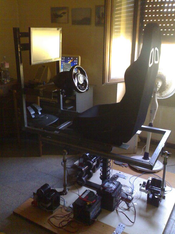

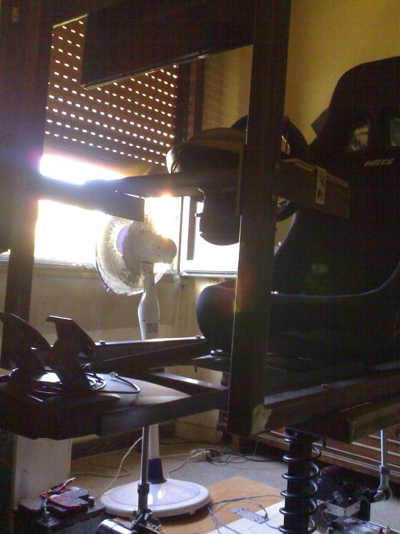

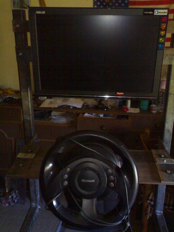

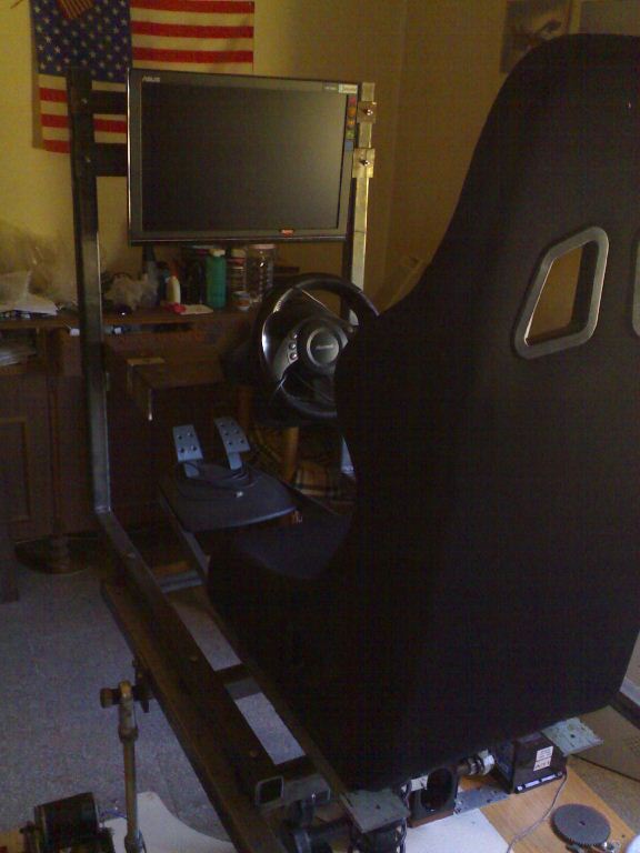

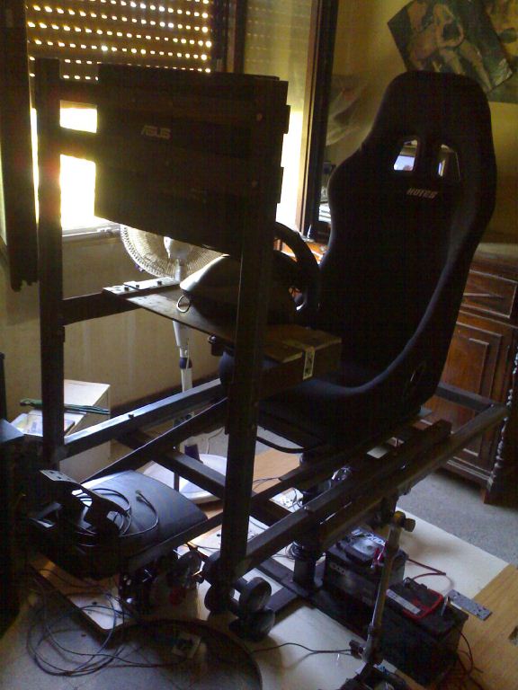

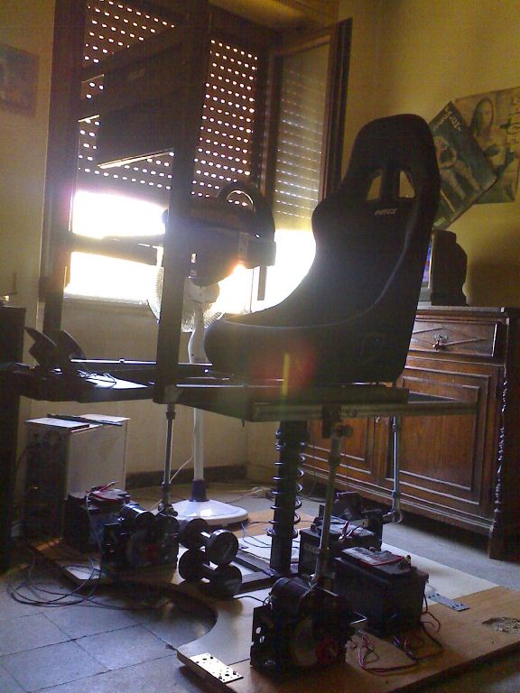

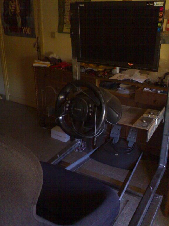

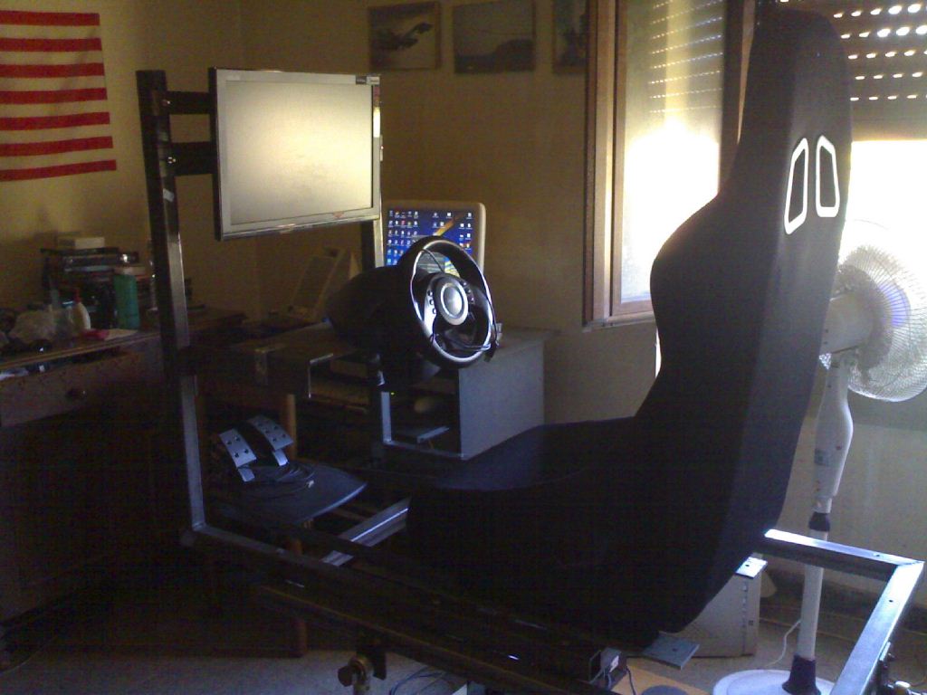

    Hello all!
    The work continue days after days and now I can show you the new pictures (really a lot of manual work.. really really.. I am near to become total mad.. :cnotb:
    Monitor mounted, wheels and pedal mounted, the 3 pots system is changed (no more the rc hely gears), center of mass changed and many little modifications from mechanical to force-profile configuration (rFactor)..
    Things to be done:
    1) Optimization of force profile
    2) Add 2cm of motor height
    3) Reduce the platform total height (4 cm)
    3) Reduce 2cm the legs lenght + 4 cm of reduced total height
    4) change the wood dais in an iron dais
    5) paint the platform
    6) make the envelope in which the pilot will stay indoors (no visual reference of the outside world)
    7) many little iron modifications
    8) Make a box in which the 3 jrk will stay whit heatskin and fans
    9) Make a decent wiring..
    10) tests tests tests...
    11) :toohot:
    Soon the in-game vids! ;D
