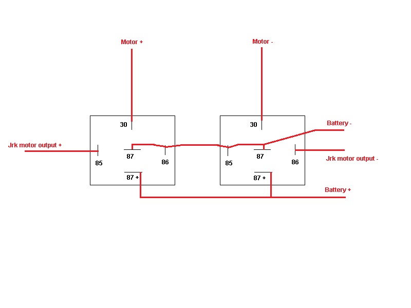

    And here finally the relay configuration! :) Tested and working!
    NEGATIVE POINTS :
    1) No more available the duty cycle, max currency, accelleration settings from Jrk config utility.
    2) The brutal force can be a problem when you need to move slow the motor for some tests. (I am thinking about using a potentiometer to reduce the power! So the negative point number 2 will be eliminated!
    POSITIVE POINTS :
    1) SUPER FORCE AND SPEED, over than the power and speed you can see on my last platform videos (the weight that can be lifted increase really more!)
    2) really less heat from Jrk!
    The motor will go at 25amps!!!!!.. brutal considering that for now my platform is already pretty brutal without using the relay configuration! (so 12amps max currency)
    This pic show the configuration for a single package jrk+motor+battery

  7. bsft
    Varooommm!!!!!
    I like the relay idea. I may use that on my own as I am running my jrks at 21.5amps. They have heatsinks on them and a fan though.
    :D
  8. AldoZ
    AldoZ Member
    Aug 26, 2010
    286
    Pc Shop
    366Coins
    +6 / 1 / -0
    If you use the relay method so not anymore the jrk providing currency to the motor!
    Without the relay method the jrk pick the currency from the battery and provide this currency to the motor.
    With the realy method the motor will take directly the currency from the battery (his max amps. For the winch will be 25amps), not anymore is the jrk making this work.
    So you could safely use the jrk without heatsink and fan because the jrk will stay fresh and happy! :)

  11. bsft
    as for the noisy motor, just turn the volume up!
    as for the relays, a thought, they are a on-off device, while the boards are more controlled. I think for myself, I may consider some extra motor driver boards connected to the jrk. This way I could get the actual motor control I prefer.

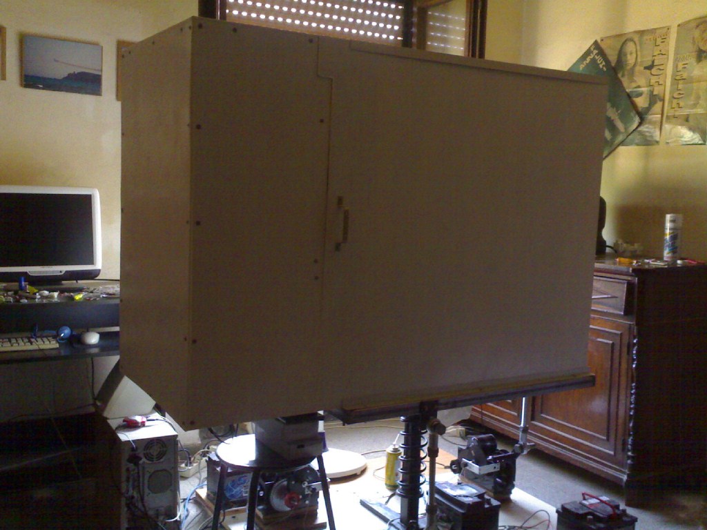

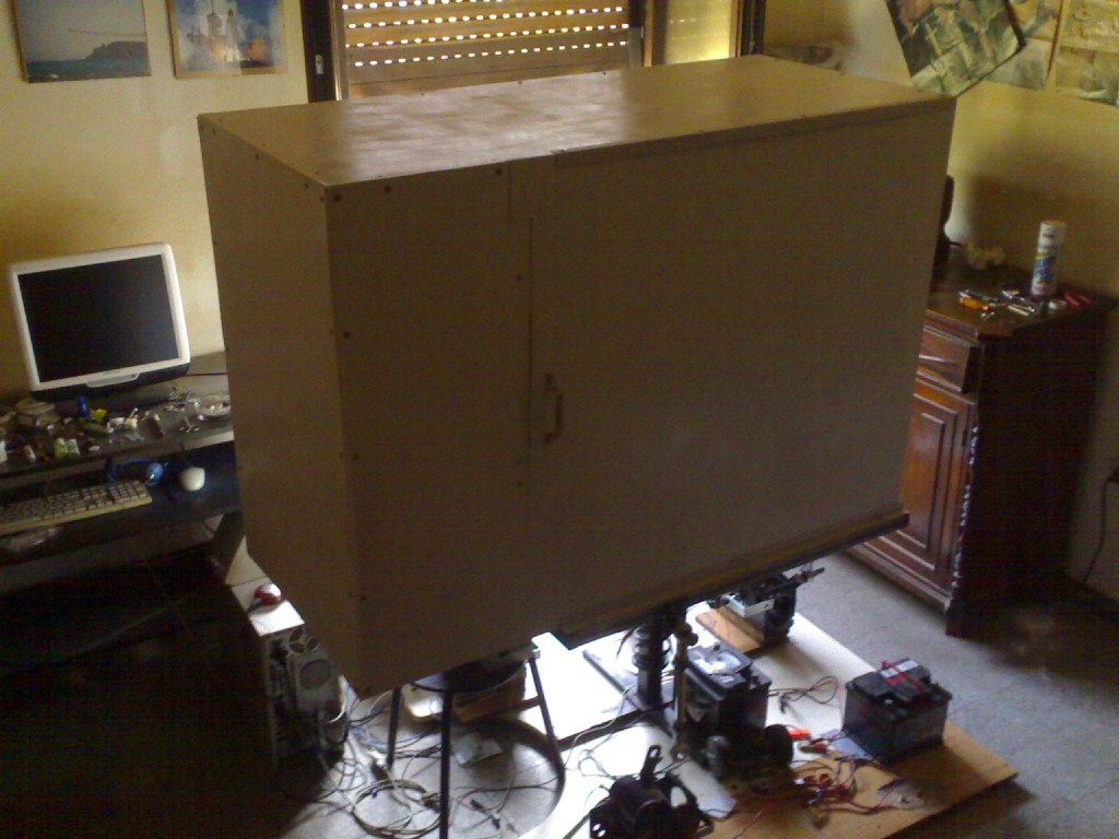

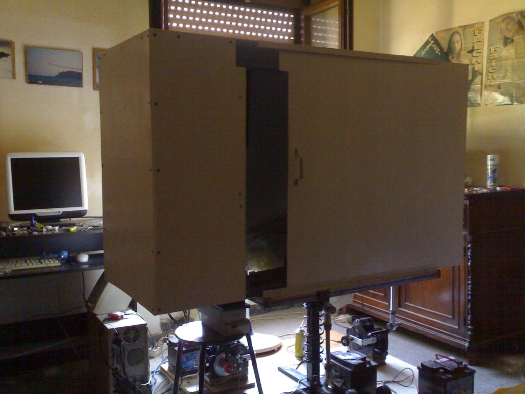

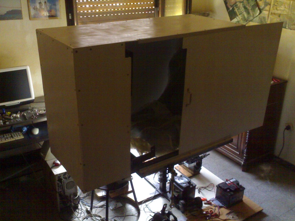

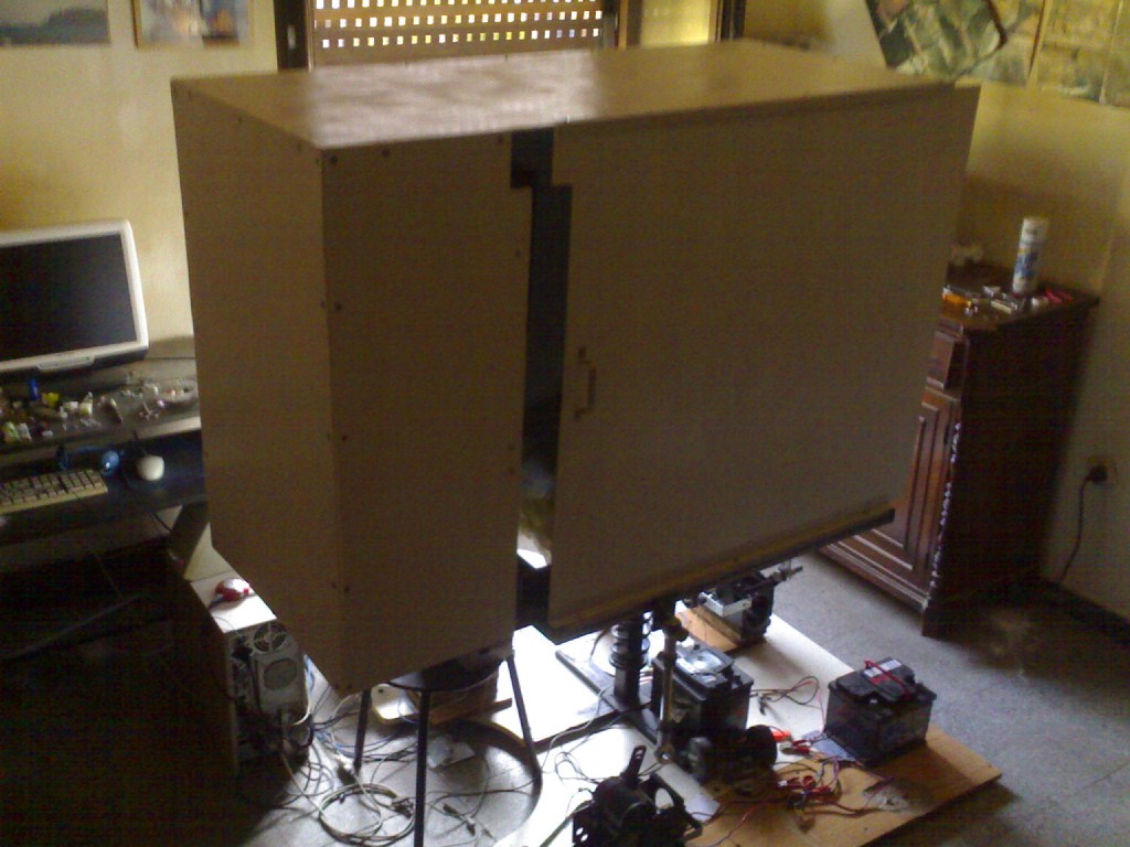

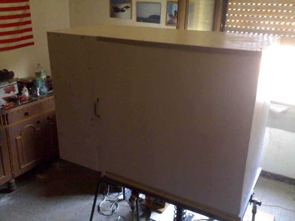

    Hi guys! here some news.
    I almost finished the envelope cabin. Really many manual works but the result it's not too bad!
    Almost finish to mount the slides to make the door scroll smoothly and the padlock to block the door.
    I am choosing between magnet or mechanical item to make the padlock.
    I use panels of light wood, using cement paint + white paint to make the cabin white.
    The structure is strong enough to receive the shaking movement of an hard driving style :thbup: (I hope..)
    The finishes and some little details are not quite ready or perfect but the way is signed.
    Over, I get the new jrk12v12 (after the boom of the other jrk :( ) and tomorrow I will mount it in the platform wires. Lucky in the accident in witch I burn my old jrk I check that the motor and battery are ok, I have left only to check the pot and If it will ok so tomorro my platform will back to life! :rofl:
    for now I put some pic, I hope to can show to you some in game vids soon!

  19. shannonb1
    shannonb1 Well-Known Member
    Mar 12, 2008
    1,107
    Sales Intelligence
    Virginia
    8,909Coins
    +598 / 5 / -0
    there is much lighter and thinner material that you could have used, plastic or black cloth from frabic store.
  20. AldoZ
    AldoZ Member
    Aug 26, 2010
    286
    Pc Shop
    366Coins
    +6 / 1 / -0
    the wood I am using is plywood, really lighter, not too flexible and is above all very cheap and easily findable. To find same dimension panels made by plastic it's really hard (in my city it's impossible to find someone working the plastic.. :no: ) and the price would be better much more(my budget in this moment is the highest priority :eek: )
    All the cabin, panels + alluminium brakets + cement paint + paint = so and so 75 €
