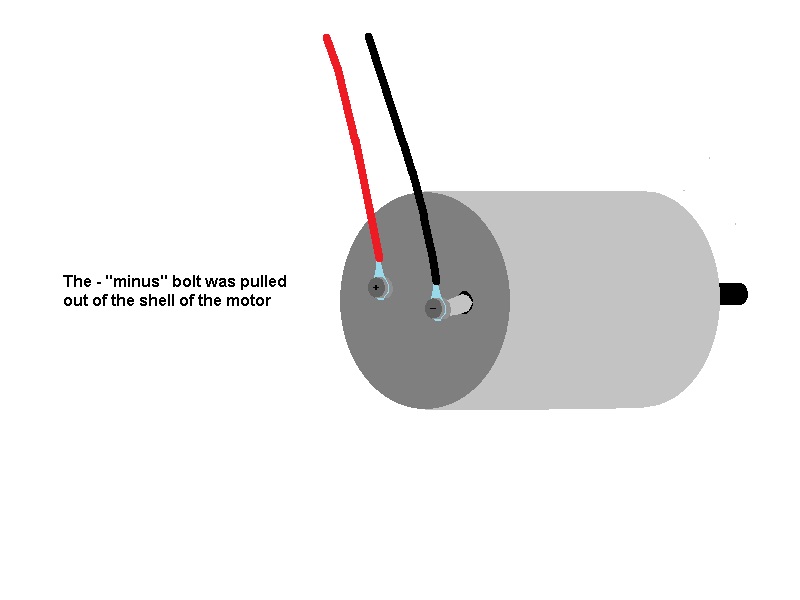

    1) Can be the bad motor isolation (earthing) after the accident of 2 weeks ago in witch the Iron bolt head of the bracket touched and ripped off the iron - minus thing in the motor. Maybe this mean that inside the motor something is touching the inside armature of the motor.

    Hi egoexpress, Yes seems something like a shortcut but the battery polarity was right as all wires.
    I tried to plug another one jrk (one working, the stern jrk) to the motor in witch I burn my other 2 jrk and I was near to destroy this jrk too...
    So this motor have some problem and probably this problem comes from the accident of 2 weeks ago when the iron - (minus) plug was ripped off the motor body.
    Probably (I hope, will mean that I know the problem!) inside the motor something is touching some other causing a bad earthing or something similar.
    PS. I try to connect my motor directly to battery and it works! This mean probably is not a shortcut but maybe a bad isolation (earthing)
    what do you think?

    Aldoz mate i would be taking the motor apart for a check, quiet a simple task with the winchs. 2 Screws. Sounds to me ya could have an issue with motor shorting and feeding power to the earth on the pot about the only thing the didnt protect on the jrk. Happened once to me with window winder motors but reckonized the sound and tripped me saftety switch which cuts power. Same earth problem took out my g25 pedals which were bolted to my steel frame. Make a post on Pololu forum or send them an email if ya dont get warrenty replacement they normally give ya a good discount on replacement. Mine blew the voltage regulator(5v) on the board i got 50% off a new one and bought the smd component to fix it, but new card turned up and i forgot about it.
    Not good wish ya the best.

    Thx for support guys! and thx eaorobbie! Yes I think that after the famous accident (the incident that happened two weeks ago) my motor have some serious bad isolation problem.
    Now I have not a camera so I post the paint of my damaged motor. I hope you can obtain more information from this pic.
    The incident:
    the head of the bolt that connects the bracket to the leg touched the - minus bolt (the bolt in witch I plug the cable minus from motor to jrk) ripping off it (as you can see in the pic) and causing the dead of the first destroyed jrk..
    I am pretty sure that after that incident so inside the motor something is touching the inside shell causing the bad isolation (bad isolation -earthing- of the motor OR the pot) that probably causing the dead of the new jrk (the one has replaced the first burned).
    When I plug my motor directly to the battery so the motor works without problems but If I plug the motor to the jrk and from jrk to battery so I obtain the bzzzz :(
    I will try to obtain to get the warranty since I'll have to buy another card.
    Today I will order a new one with my last money... meanwhile I hope I find the correct and final solution for this bad and ugly problem

    Today I discovered the reason (pot-motor joint system failure) of the accident happen to the motor 1 month ago where I loose the motor and 2 jrk.. so today I make a great step to obtain soon a really more stable and safety system!.
