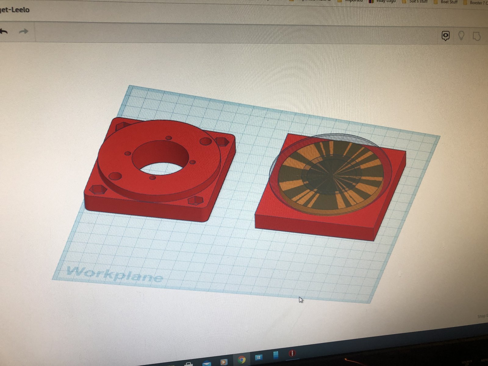

    What about using 80 x 80 for the housing ?

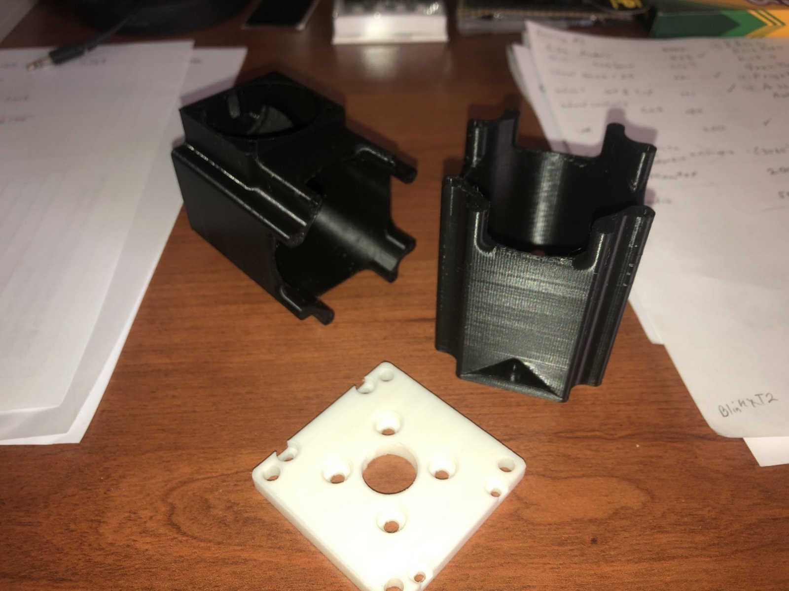

    Been playing with the printer. This thing is cool !

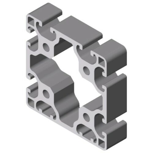

    There is a 8080 build somewhere on the internet. I thought about doing that myself. But I found an easy US vendor for 100100 including all the other hardware I needed for slot fixtures, etc.
    Be warned though, the price has shot up since I purchased from them a few months ago. And you will have to make your own design for the slider, etc as the insides do not match SFX-100 profiles.
