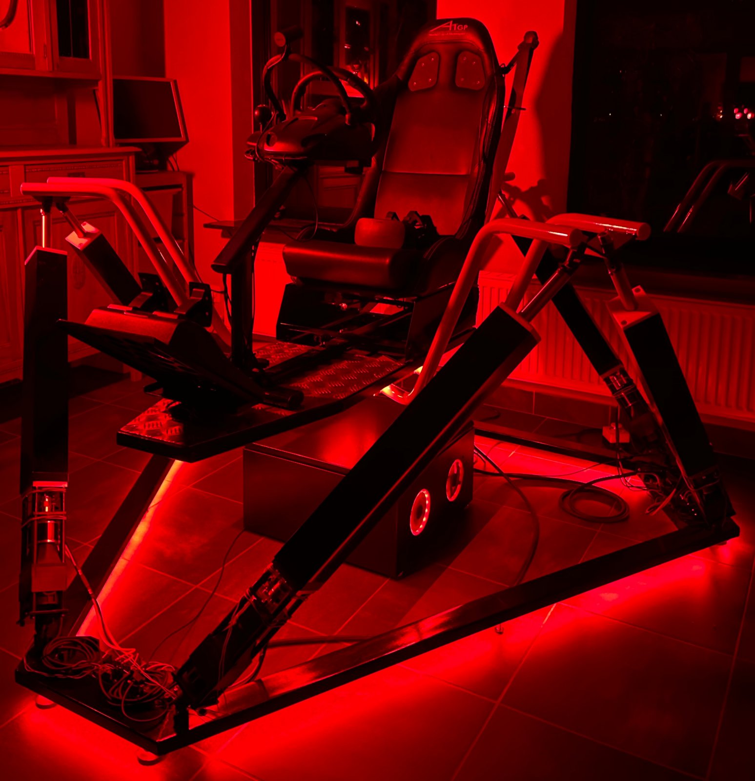

    Hi Stijn,
    Today I will start the second Odrive on my simulator and just ask myself the question how you connected your 3 Odrive to the PC so that all three are recognized independently.
    a) You have named each Odrive differently, e.g. odrv0, odrv1, odrv2
    b) you have used three USB ports and assigned each one to an Odrive.
    c) Somehow different :)
    Actually, I would like to run all three odrive via one USB hub, so that I only use one cable and one USB port.
    Hope you can answer me soon.
    Thanks!
    regards Wickie
    [edit: Solved: doesnt work with USB hub, but with seperat USB connections. In the mover interface erery USB has a separate output window.
    When using Odrivetool they are shown as odrv0 and odrv1.....
    Wickie]

    Hi
    My acuators are bldc driven with ODrive.
    They make noise but you can't hear it when playing because the noise of the game is louder.
    Cheers
    Carelsbergh Stijn

    Hi
    a) odrivetool does this automatically
    b, c) I used 3 usb ports but you can use a usb hub if you want, a friend of mine uses a hub, it works fine
    Cheers
    Carelsbergh Stijn
