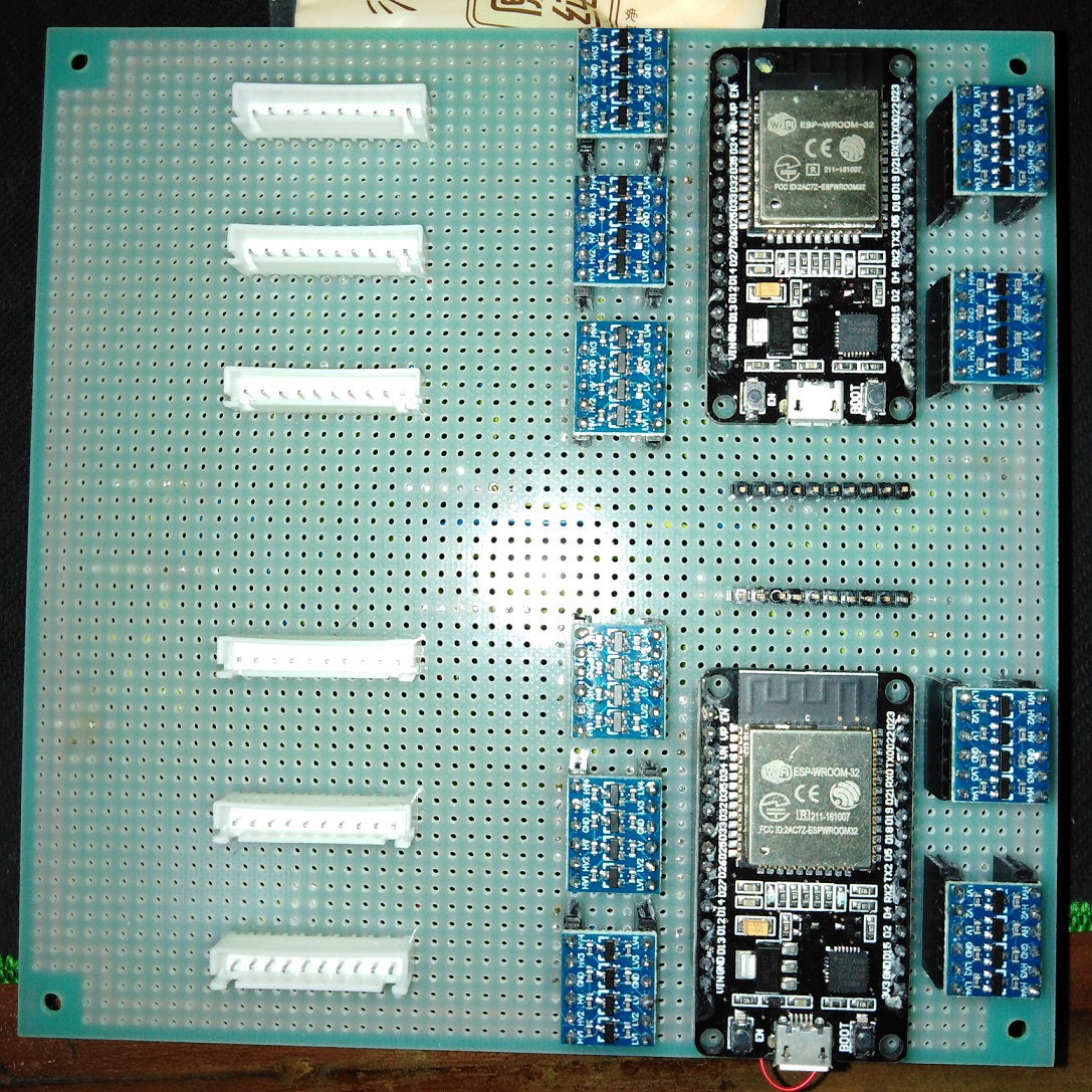

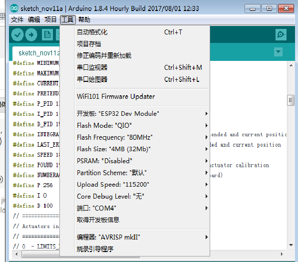

    Read, is the ESP32 library under that website, there are two folders in 31.7M are empty (AzureIoT BLE) After the above method is installed, open Arduino can see, it is prompted "find invalid library" The upload upload prompts the upload successfully.
    Put 5000 the 2000, put the latter updatePositions(1); (2) delete, upload,
    After the power is turned on, the motor turns very slowly. When the micro switch is pressed, it stops. Set SW2=off, sw1=on, and try several times. aa.png

    If I understand, it's working, but slow.
    Try to increase this value to 255 (maximum speed):
    Code:
    #define CALIBRATION_SPEED 50
    to
    Code:
    #define CALIBRATION_SPEED 255
    And see if it's faster (be careful)
    Calibration speed should be lower, maybe 128 is good.
    After pressing the minimum switch it should change direction and look for maximum switch.

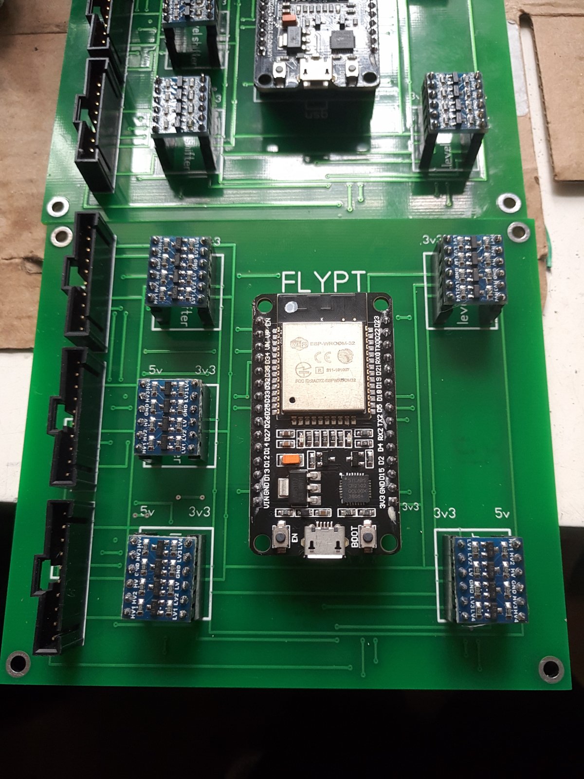

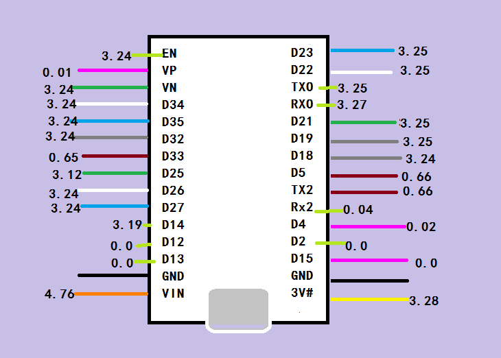

    Are you using a level shifter from 3.3V on ESP32 side to 5V for speed and direction on controller side?
    Did you change any internal switch on the controller?
  5. xiatian
    xiatian Member
    Sep 5, 2017
    78
    Xi'an, China
    262Coins
    +28 / 0 / -0
    Hello: pmvcda
    I tested the voltage of the ESP32, which is the voltage without the connection to the axis, (the code uses 3 actuators), with a 3.3-5 level shifter. xx.png

    3.3V to 5V, there is connection, now the voltage on the ESP32 board is also low. There are 3 lines with only 0.66V output. 2018111.jpg

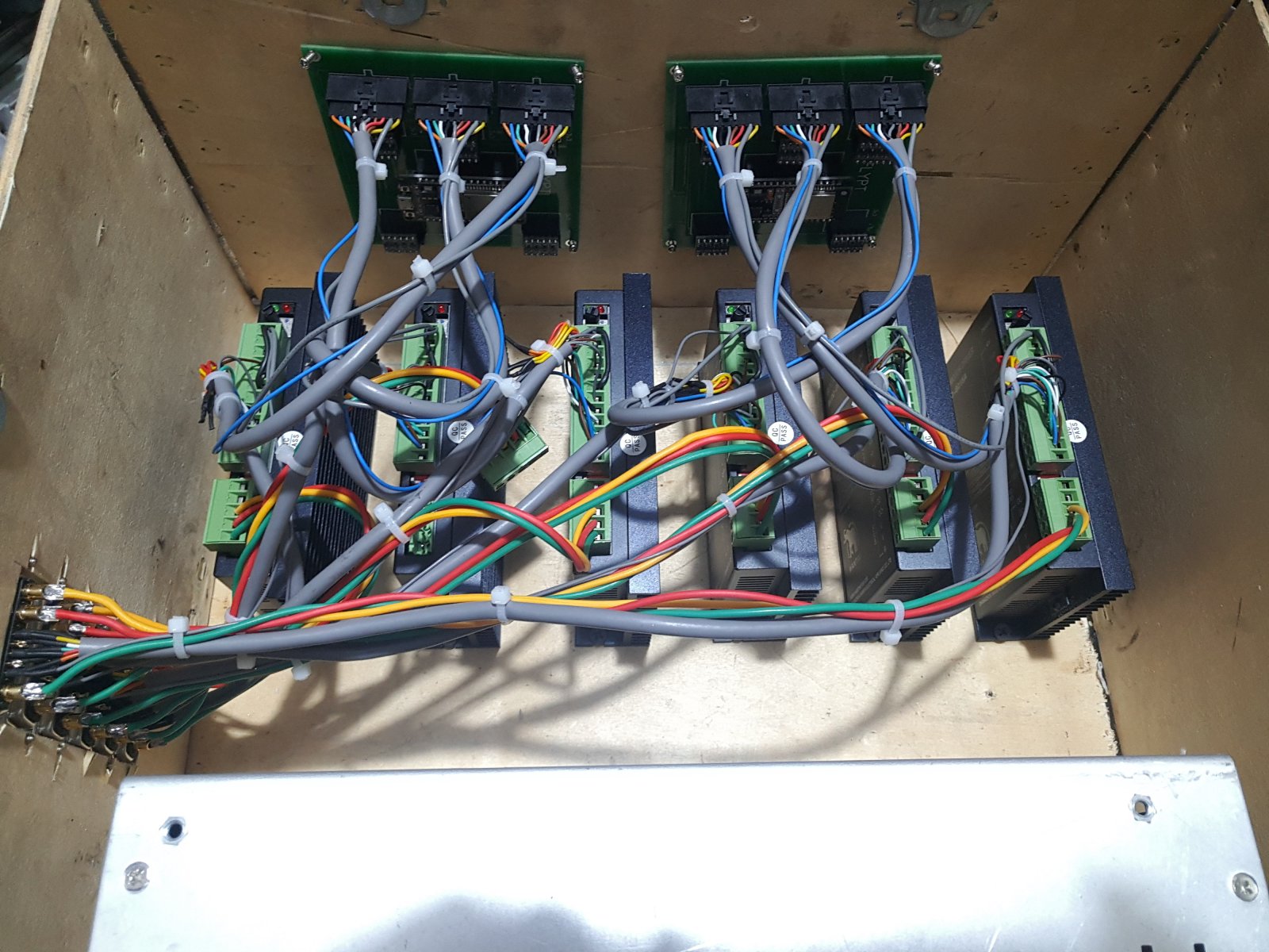

    Now every time the reset button is pressed, the motor rotates, and the minimum micro switch and the maximum jog do not respond. If the hand touches the wiring under the minimum switch, the motor stops, but does not reverse.
    No changes to the controller
  9. pmvcda
    pmvcda aka FlyPT
    Nov 3, 2010
    2,228
    Portugal
    15,647Coins
    +2,664 / 17 / -0
    Take a good look at the electronics, it's 2asy to loose something

    Hello: pmvcda
    I checked the wiring. Now I press the minimum switch, the motor reverses, press the maximum switch, the motor does not reverse, but rotates at high speed.

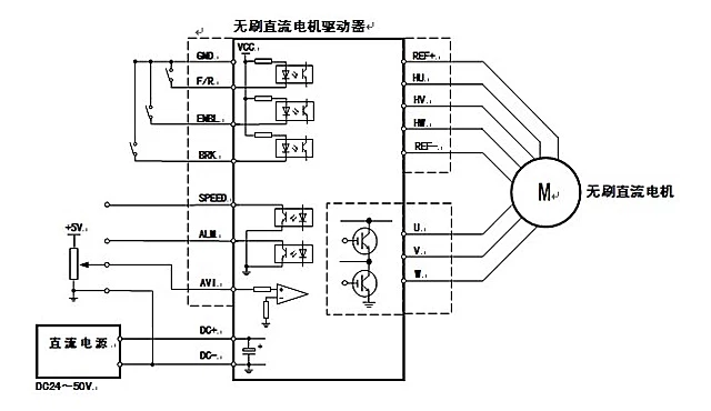

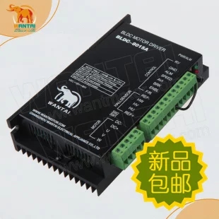

    The actuator and controller i used.

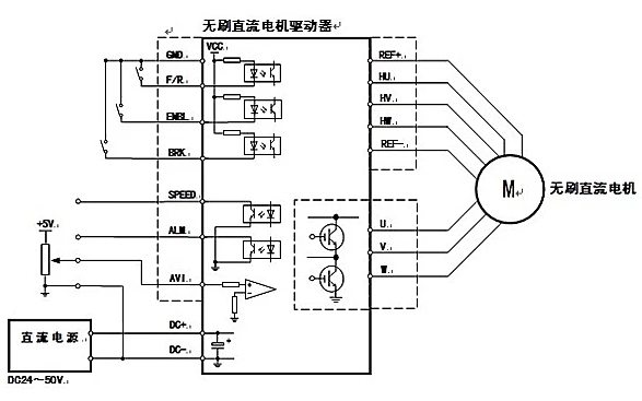

  14. jinyukang
    jinyukang New Member Gold Contributor
    Nov 13, 2017
    Jiaxing,Zhejiang,China
    - 224Coins
    SCN6
    Controller electrical wiring.

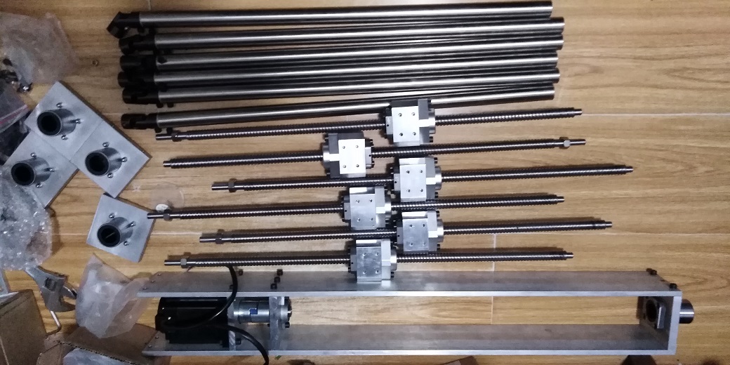

    Change plan,
    Processing parts again
  18. xiatian
    xiatian Member
    Sep 5, 2017
    78
    Xi'an, China
    262Coins
    +28 / 0 / -0

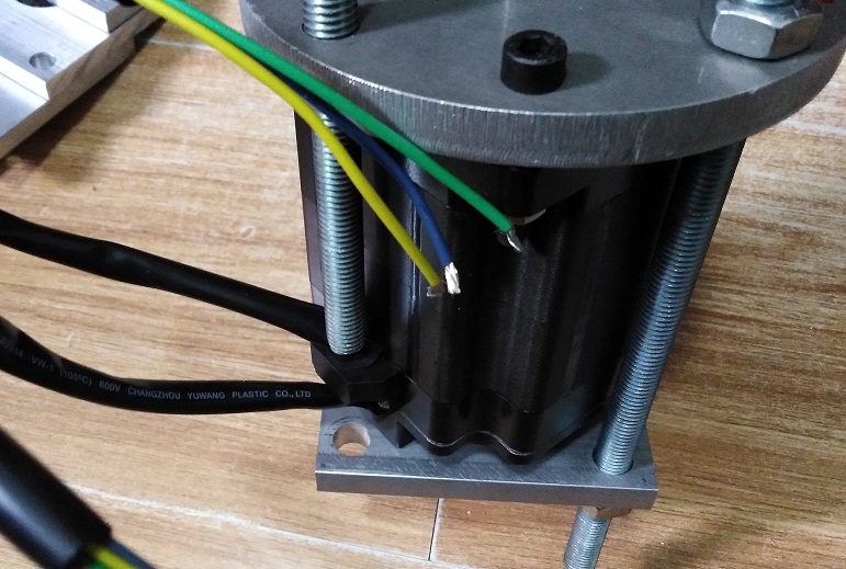

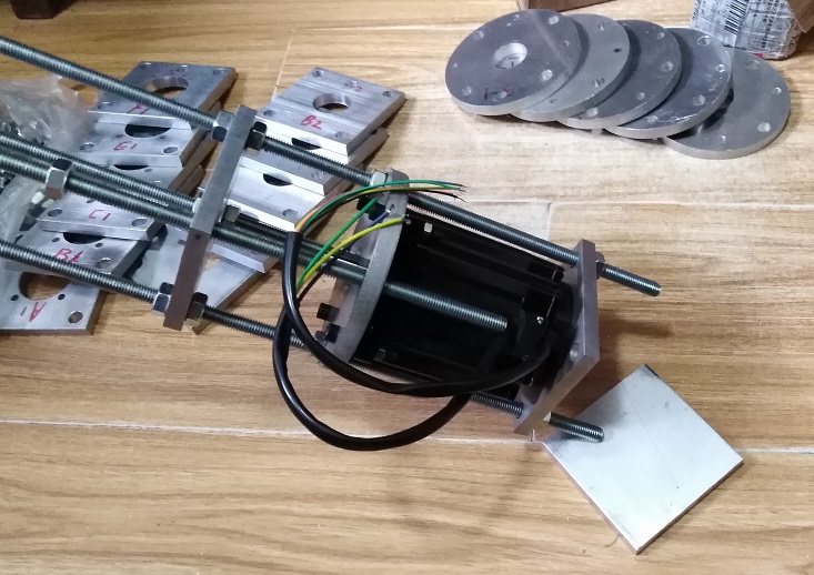

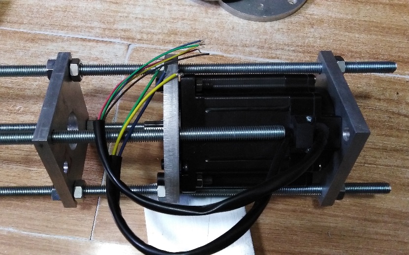

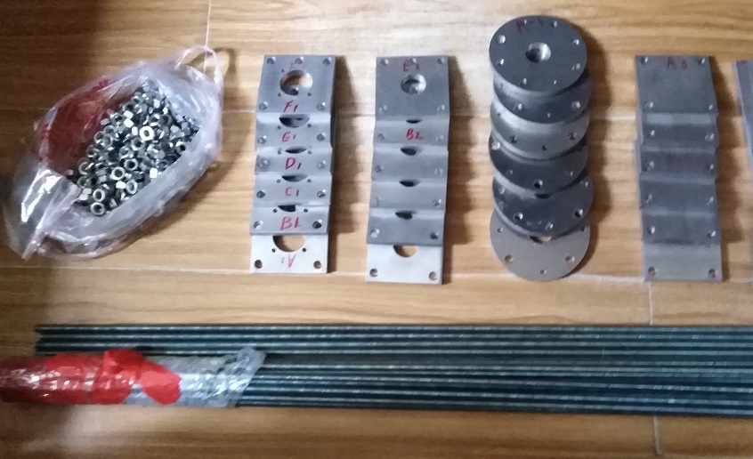

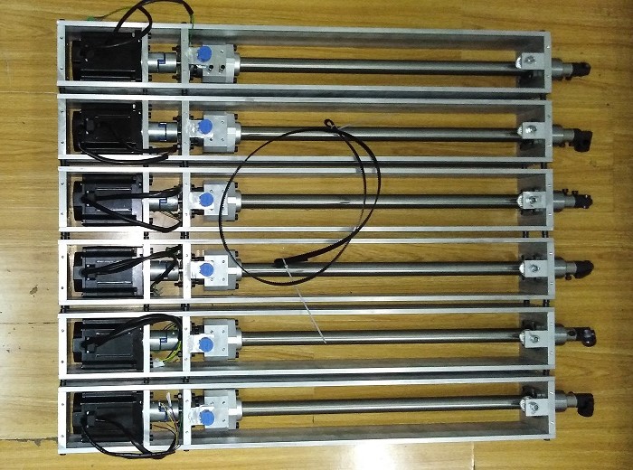

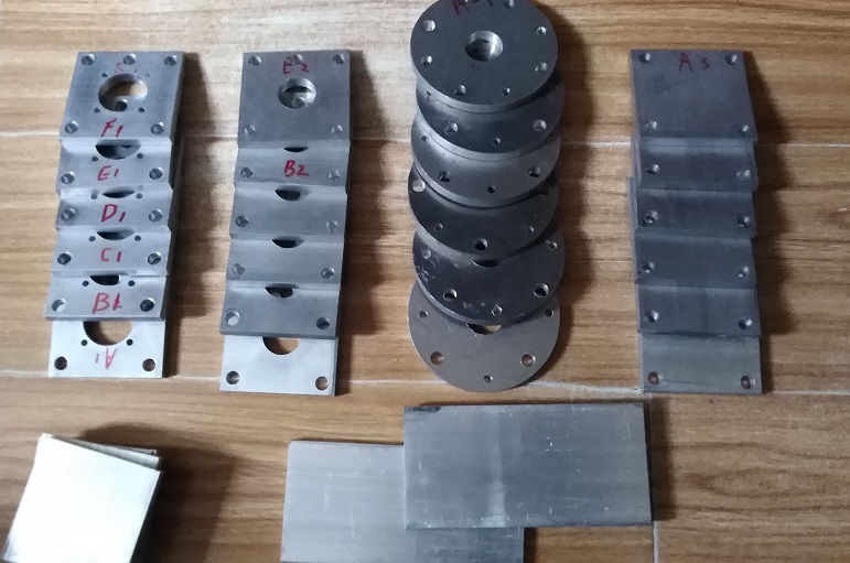

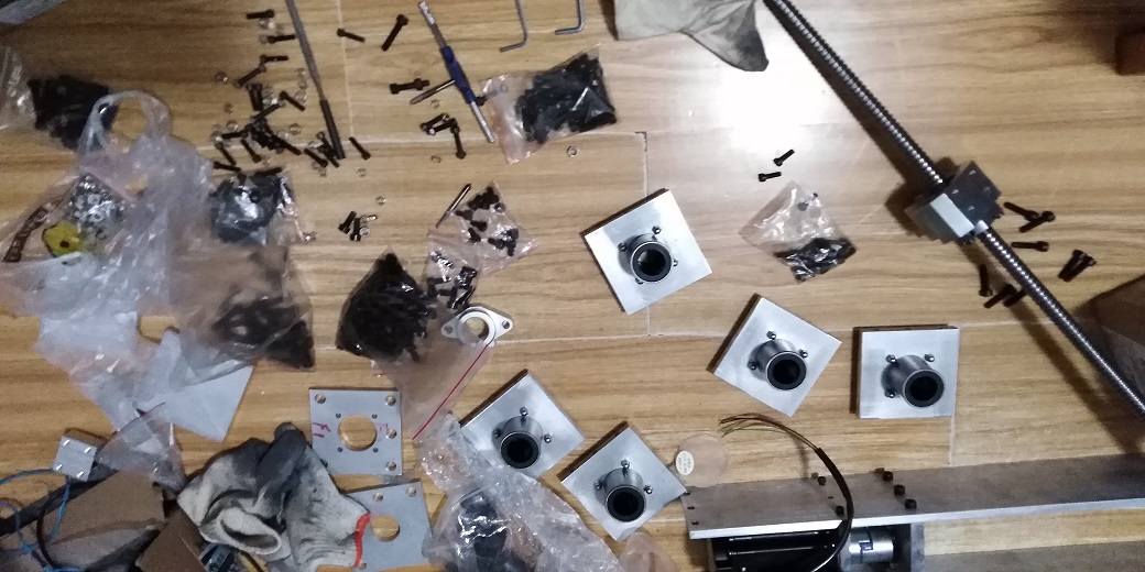

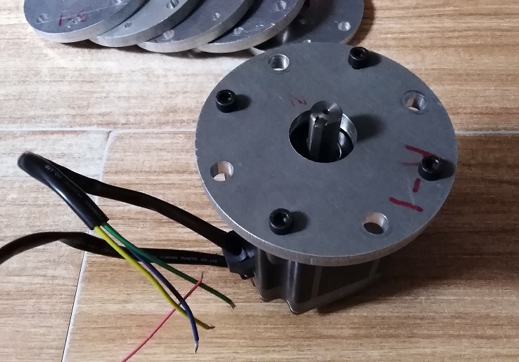

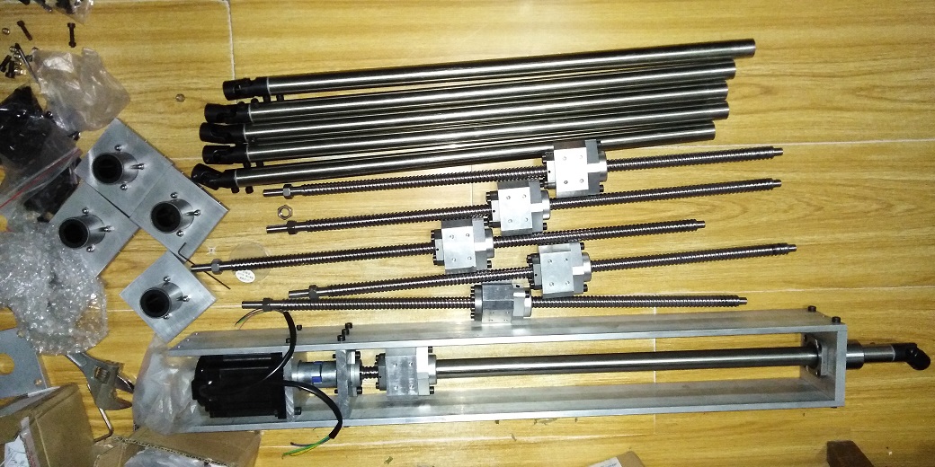

    Reworked accessories
