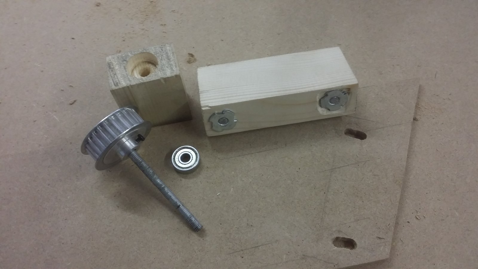

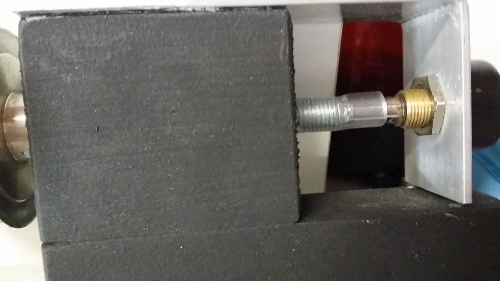

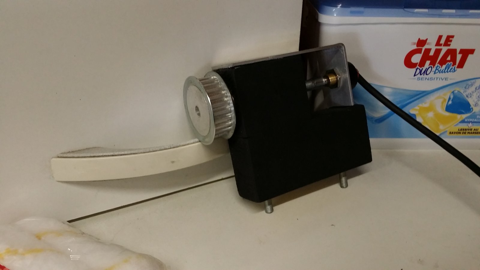

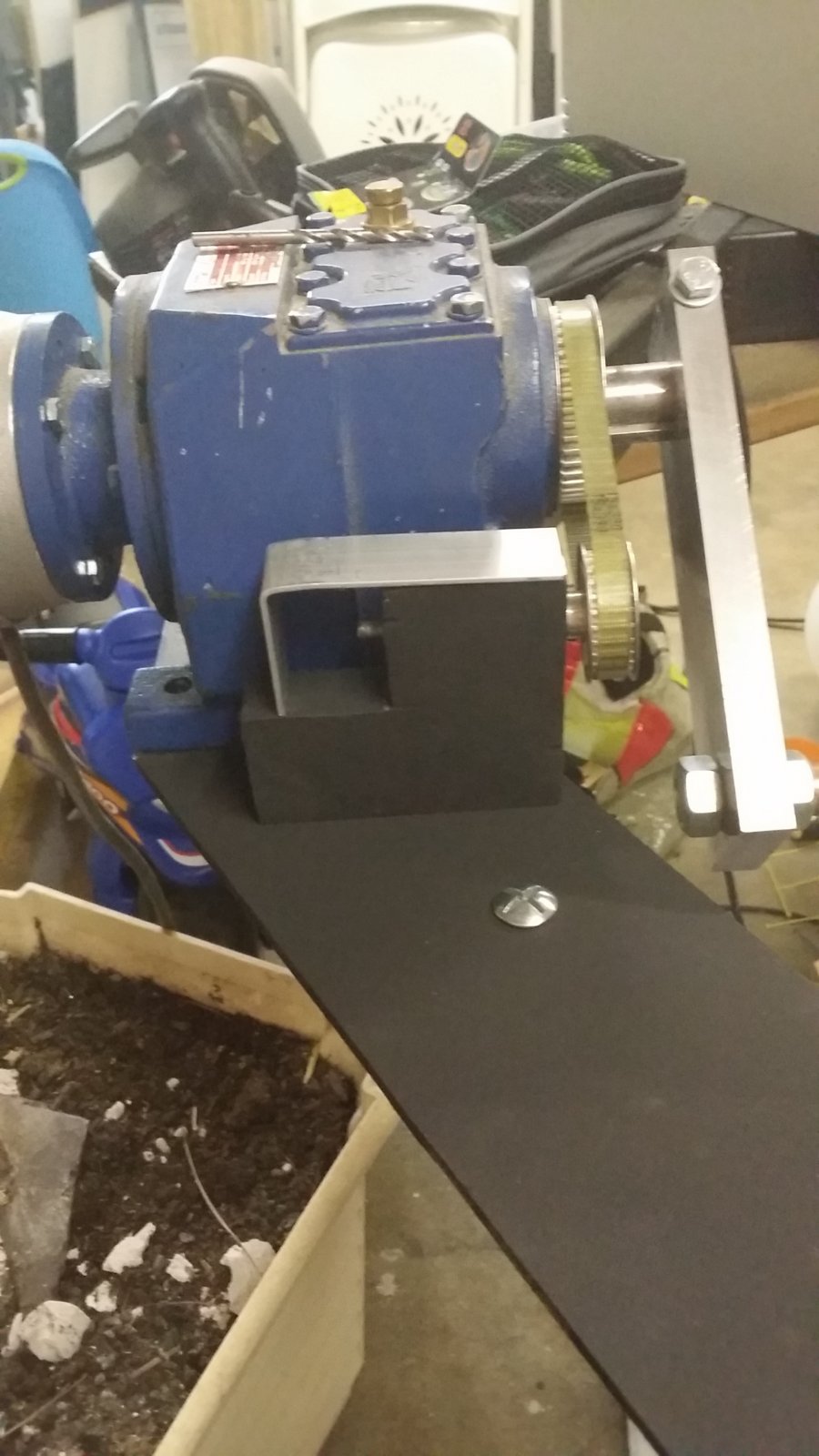

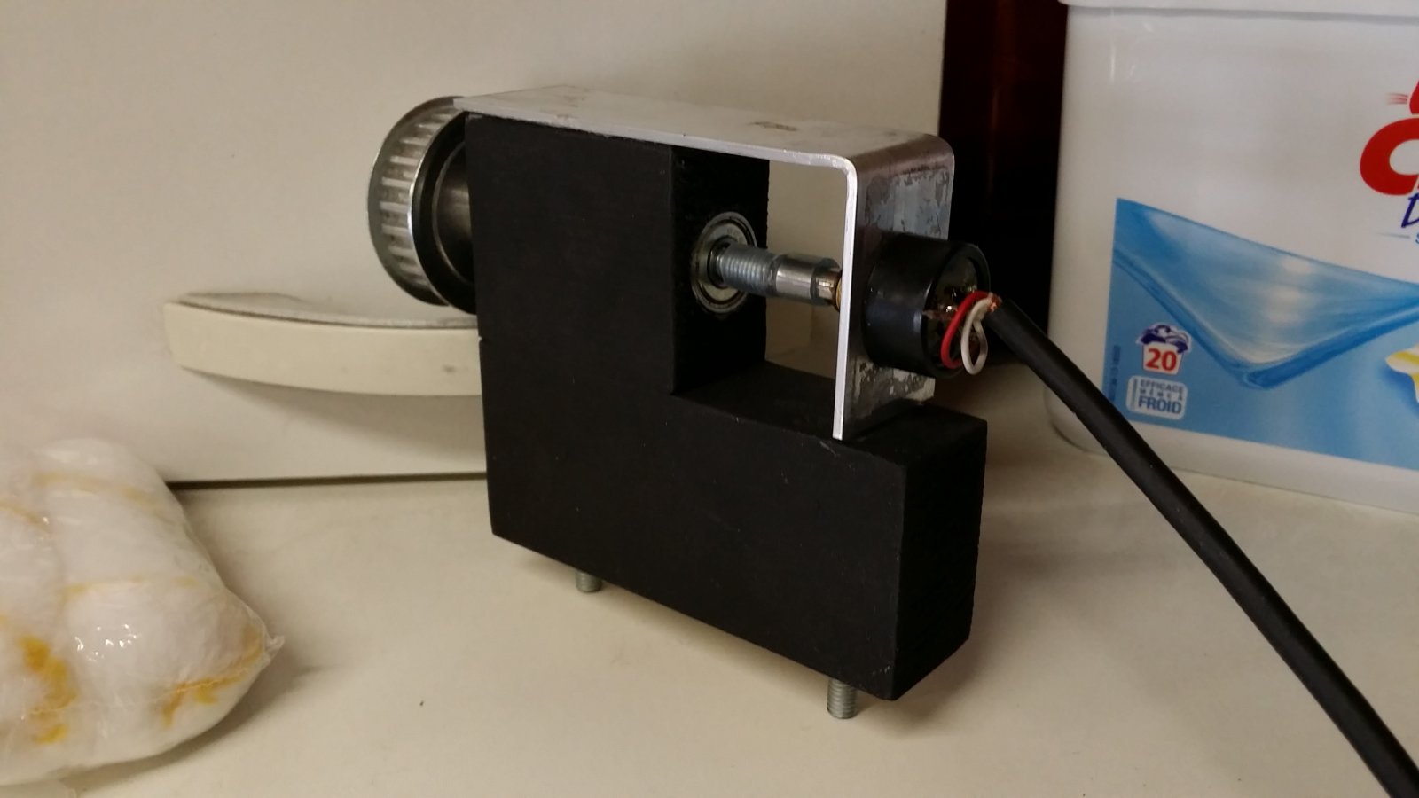

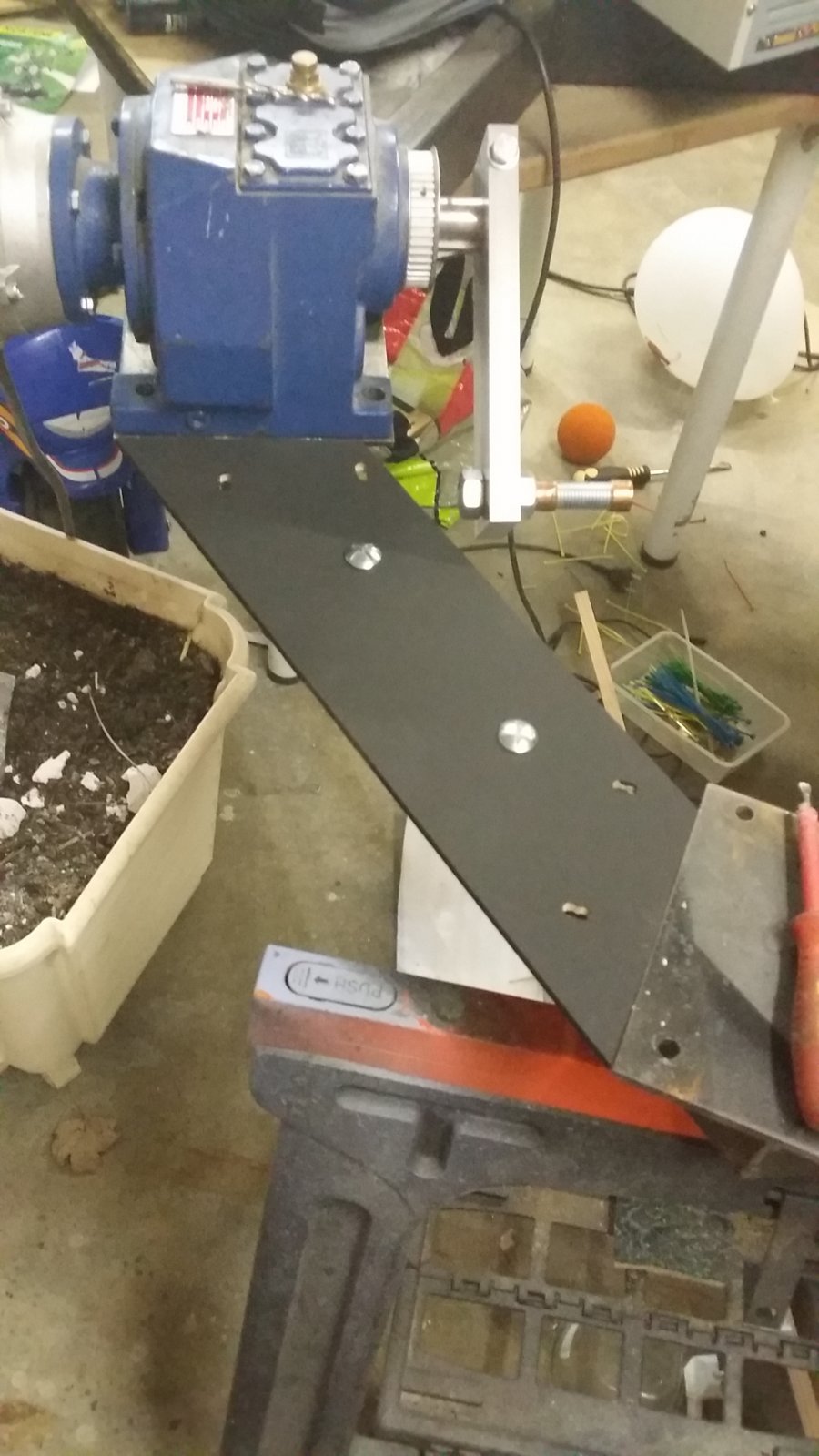

    supports of potentiometer
    20140701_182955.jpg 20140702_194110.jpg 20140702_194135.jpg 20140702_194319.jpg 20140702_194328.jpg

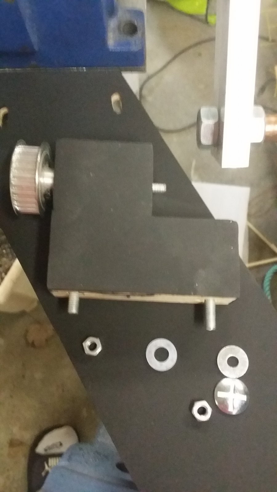

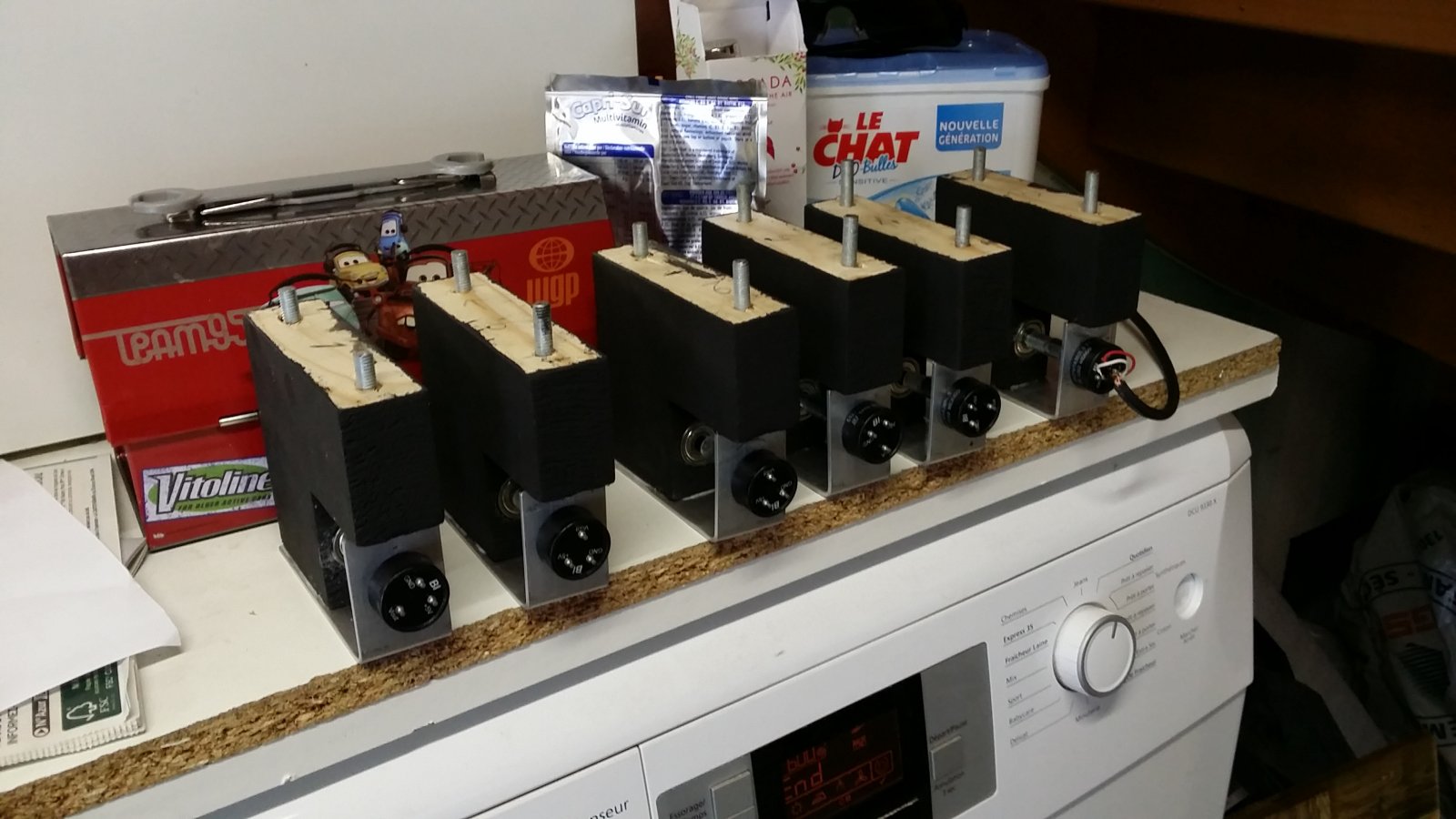

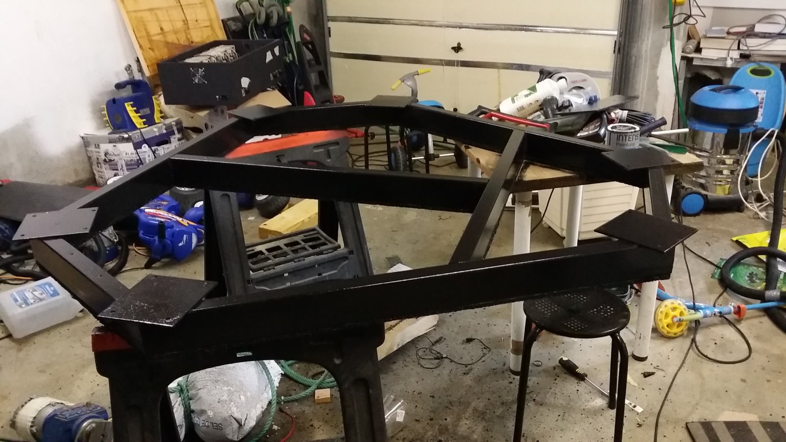

    six support potentiometers finish.
    20140704_152030.jpg 20140704_152041.jpg 20140704_152052.jpg 20140704_152103.jpg 20140704_173806.jpg
    painting.

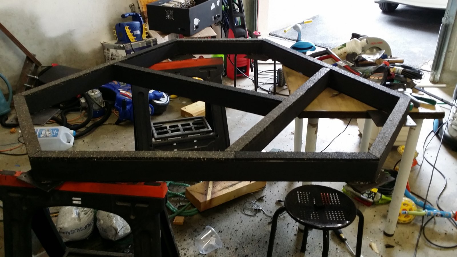

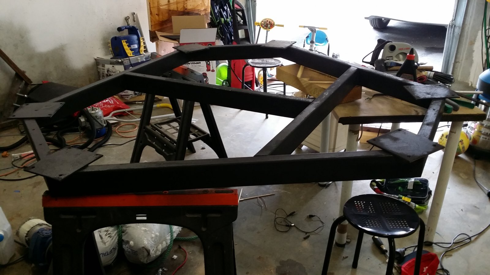

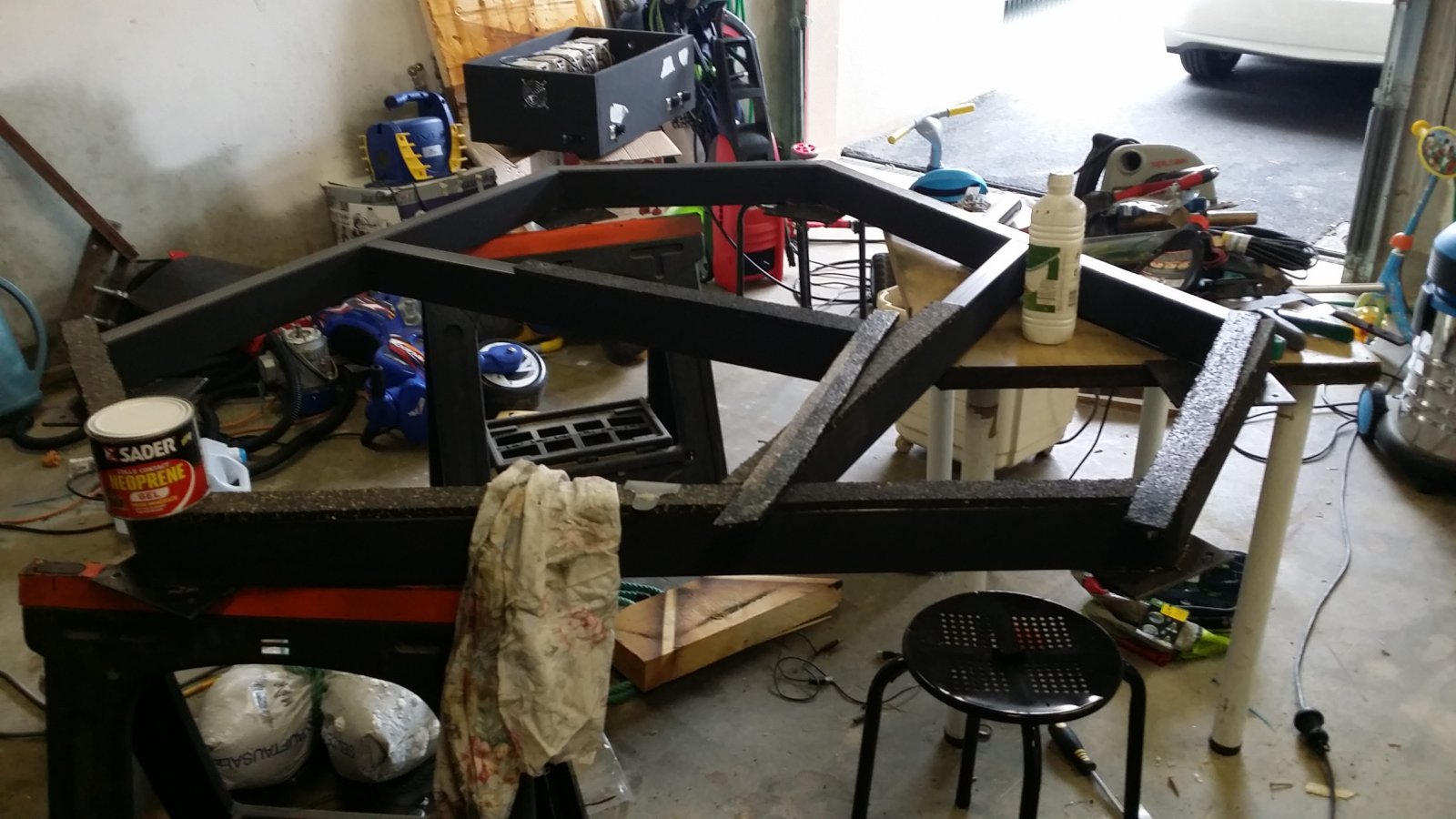

    I paste under simulator, mat anti vibration rubber
    sometimes my garage can be a flooded between 7 and 9mm, so it will avoid that the steel bar is in the water
    sticking to the neoprene,. damn I love the smell of the glue
    I spent a second coat of black paint matt

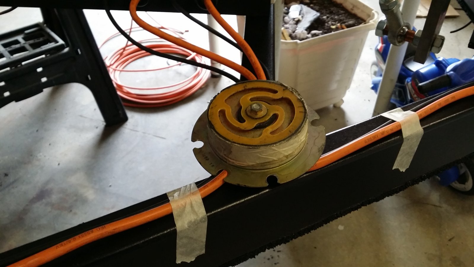

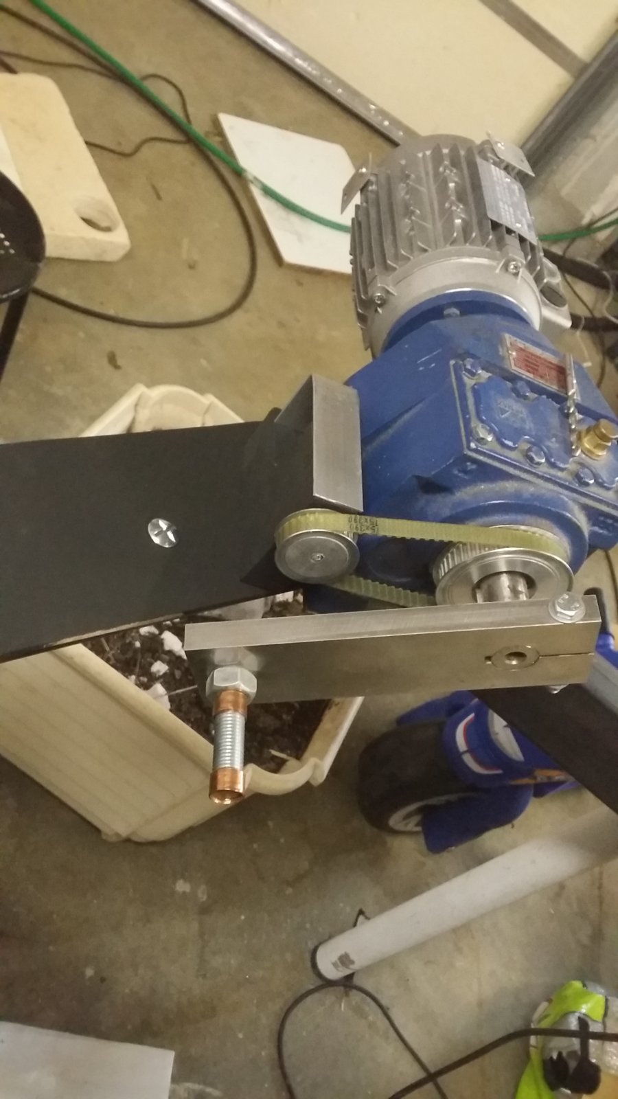

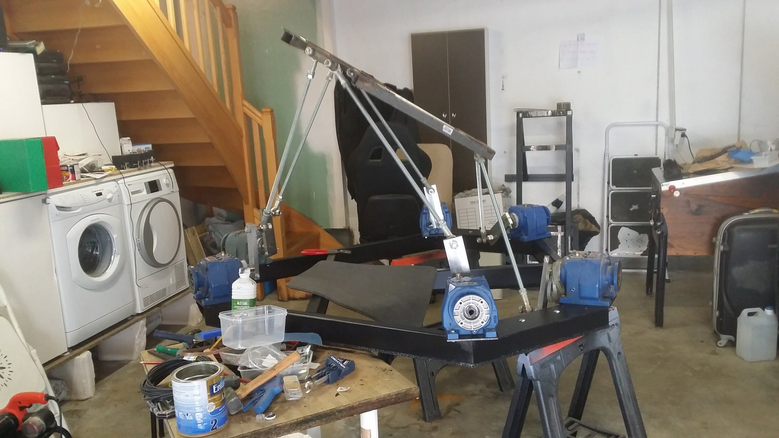

    I started tinkering,
    even with a 30 ° angle of the ball joints are not abutments
    to keep the cables I'll take that
    • Like Like x 7

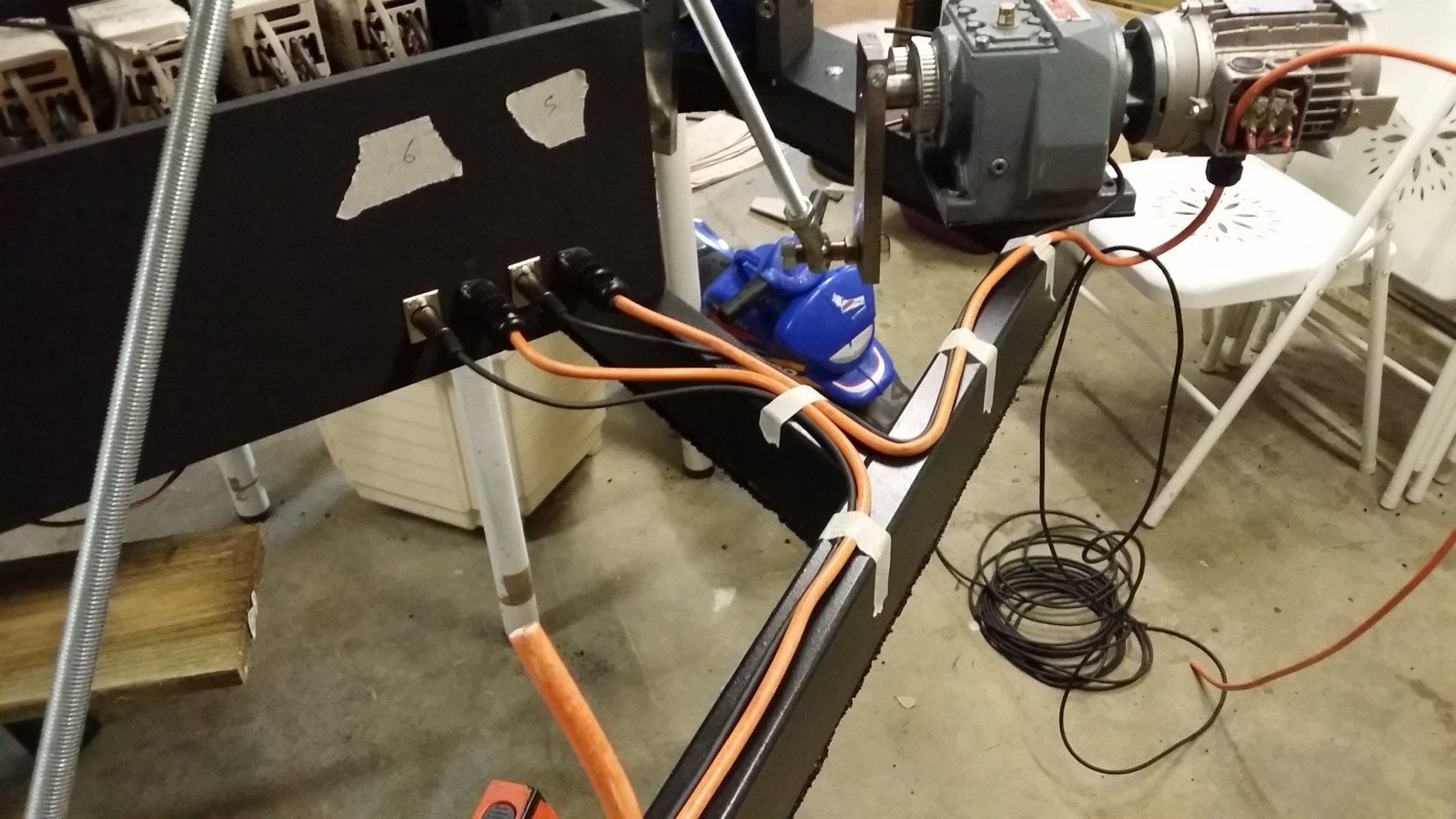

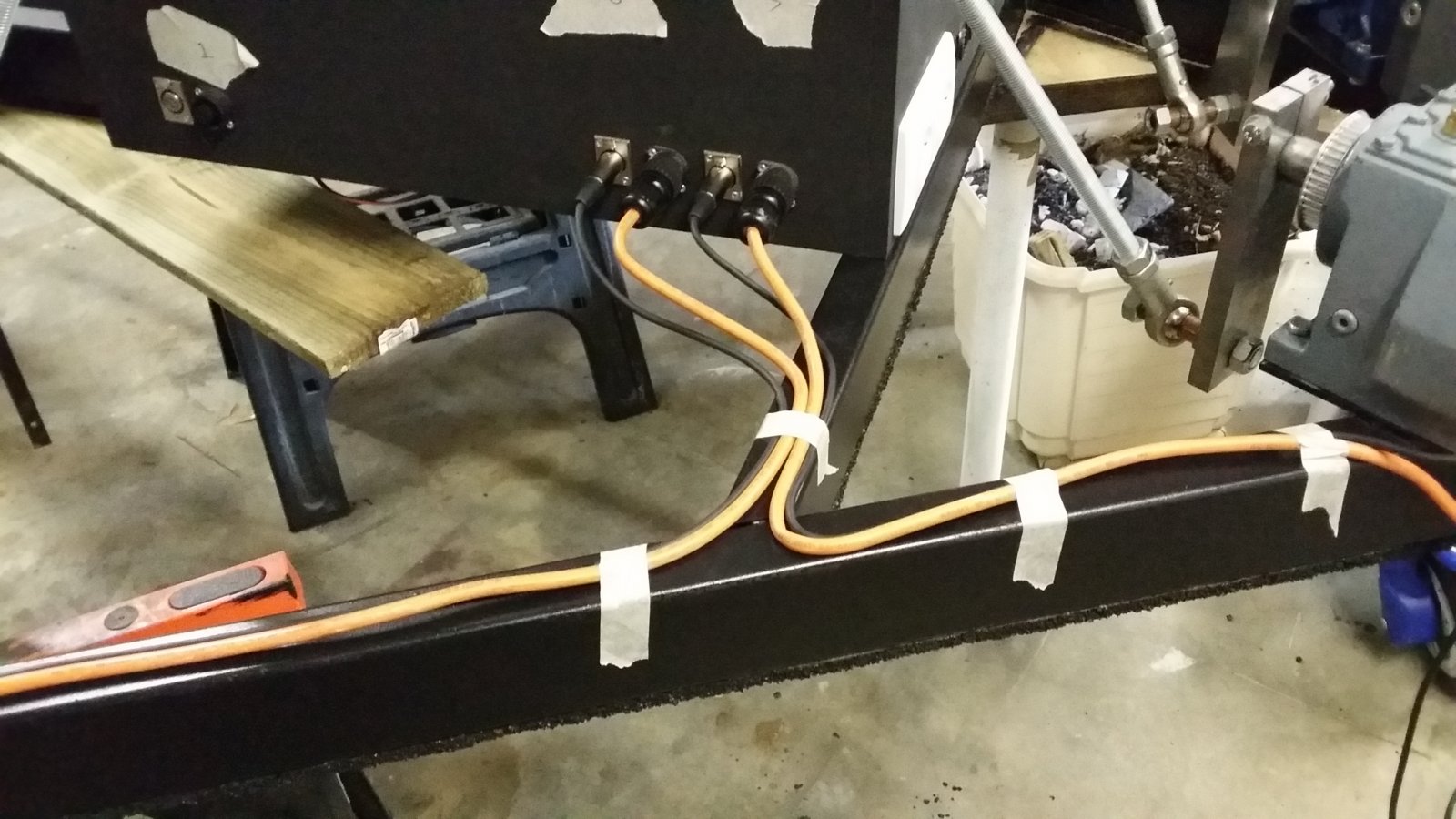

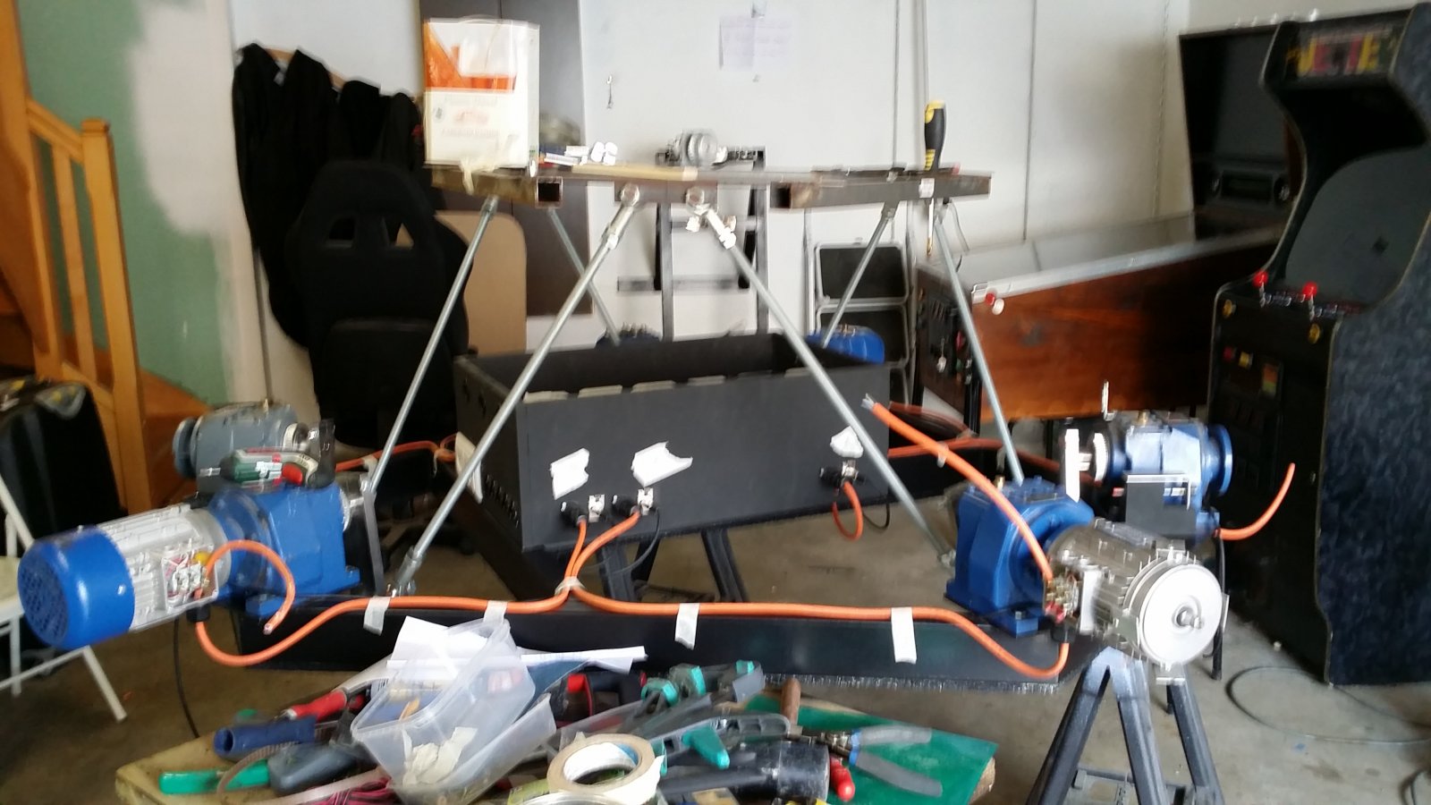

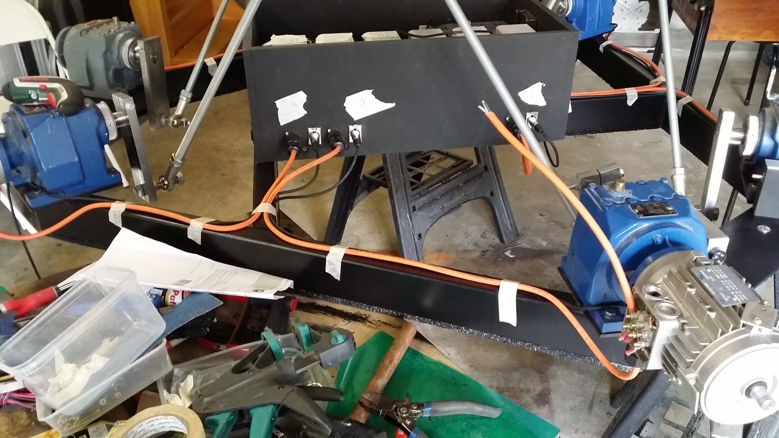

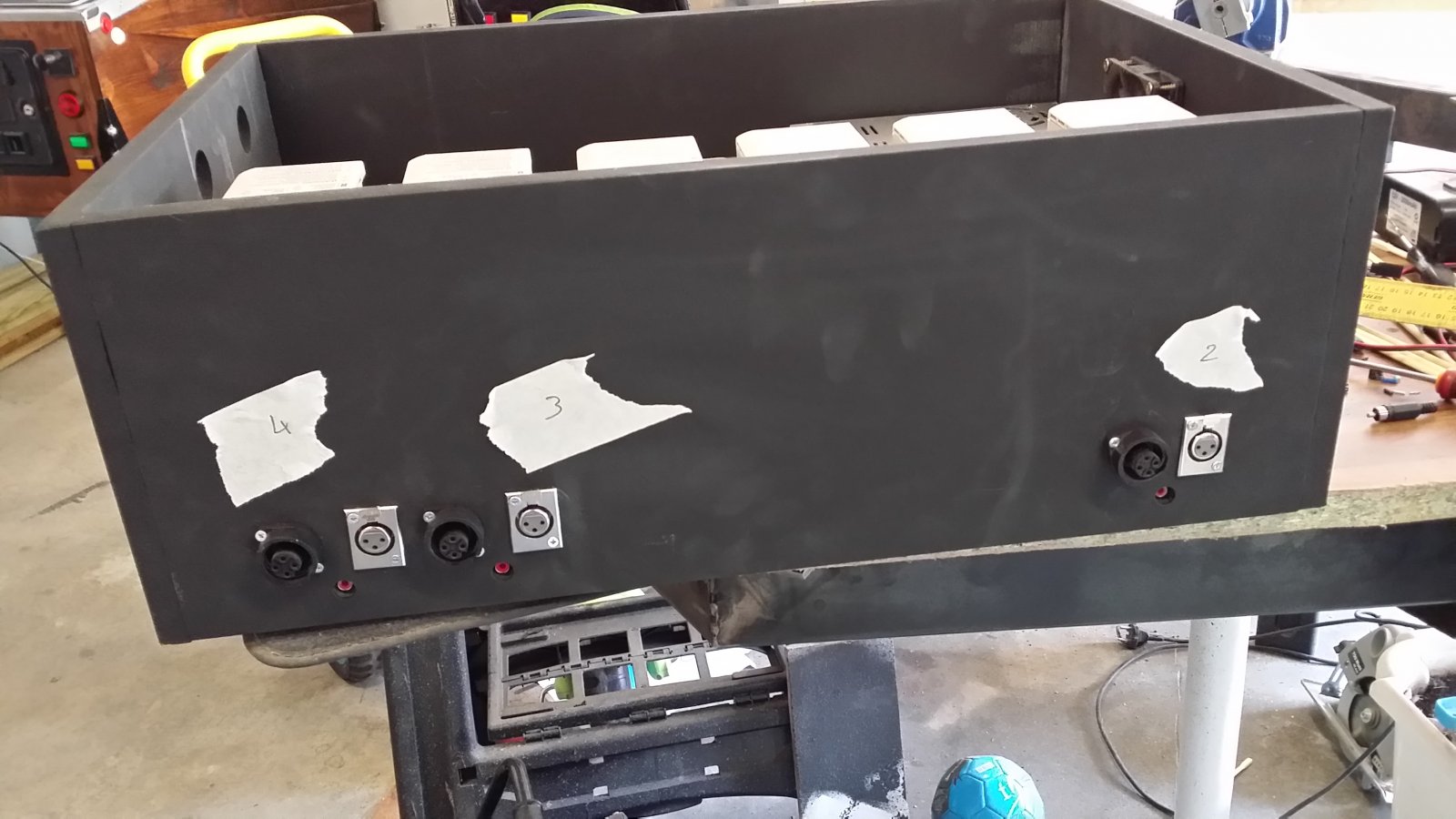

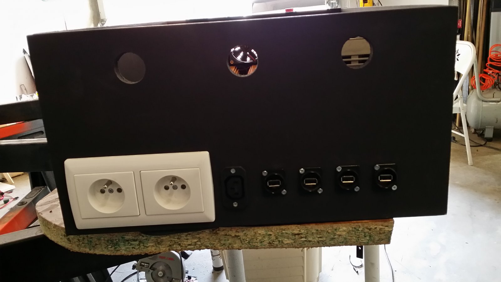

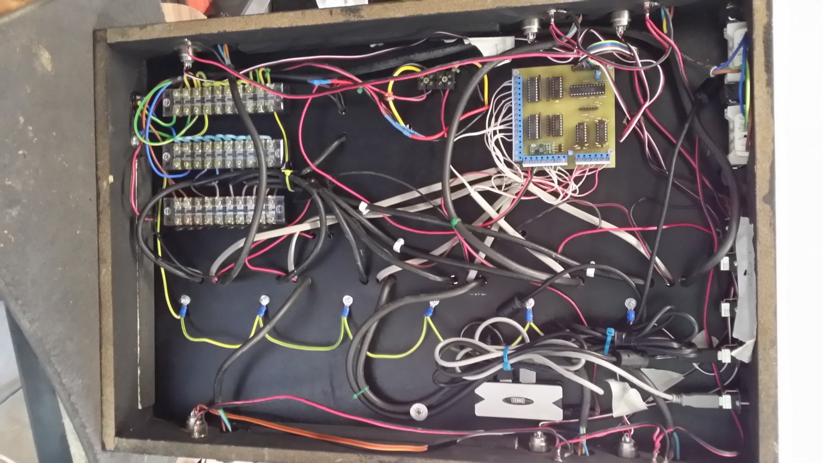

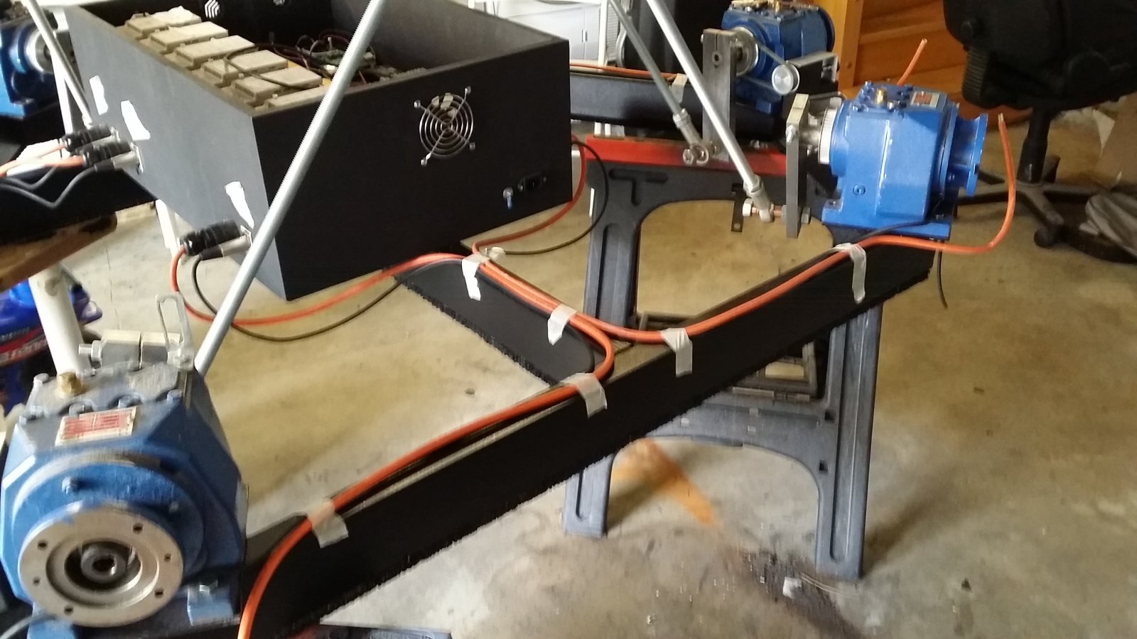

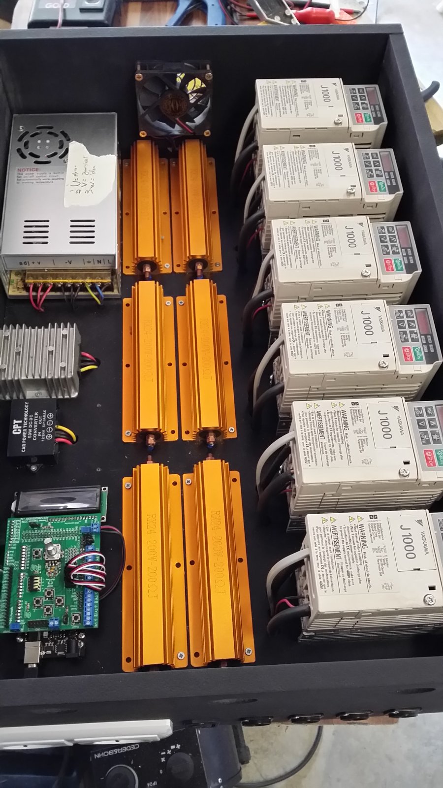

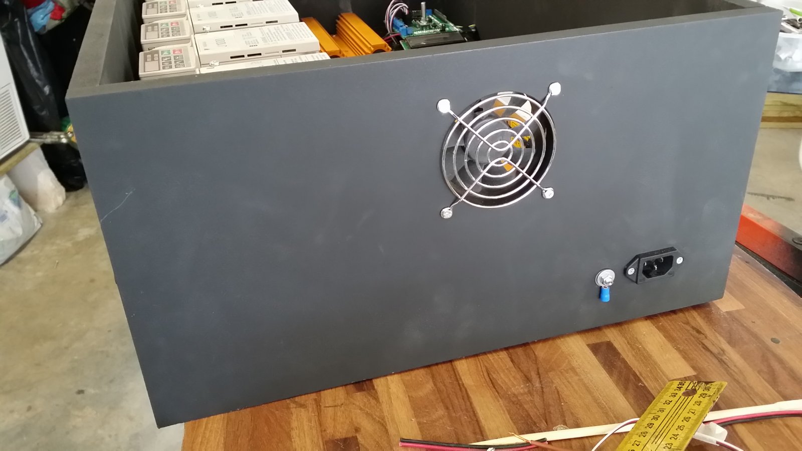

    I finished 50% of the wiring
    So it remains to solder cables on potentiometer. and put lugs on the motor cables.
    this picture we see that the electronic box goes without problem under the simulator
    I have two bass bump that date my age HT, they were on my couch and it worked really not bad, it was even surprising. I would put in the wooden plate I'll put on the platform above. we'll see what happens.
