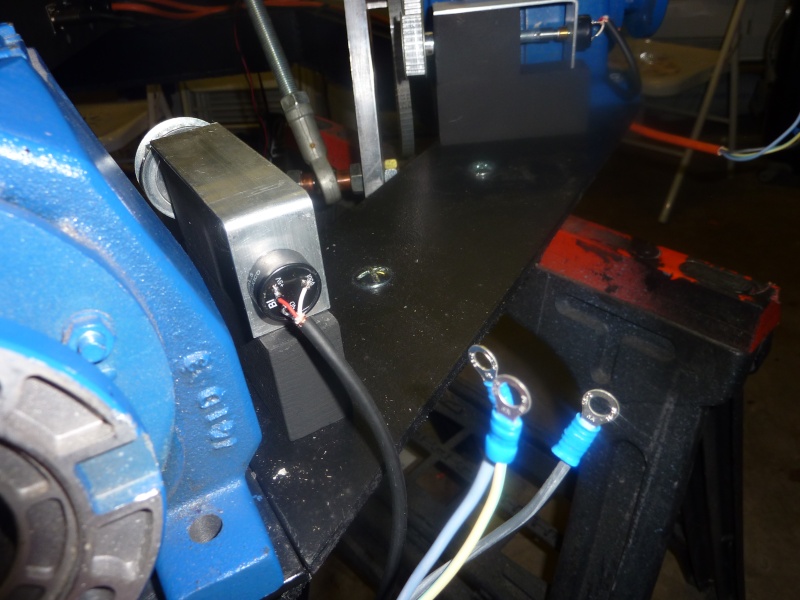

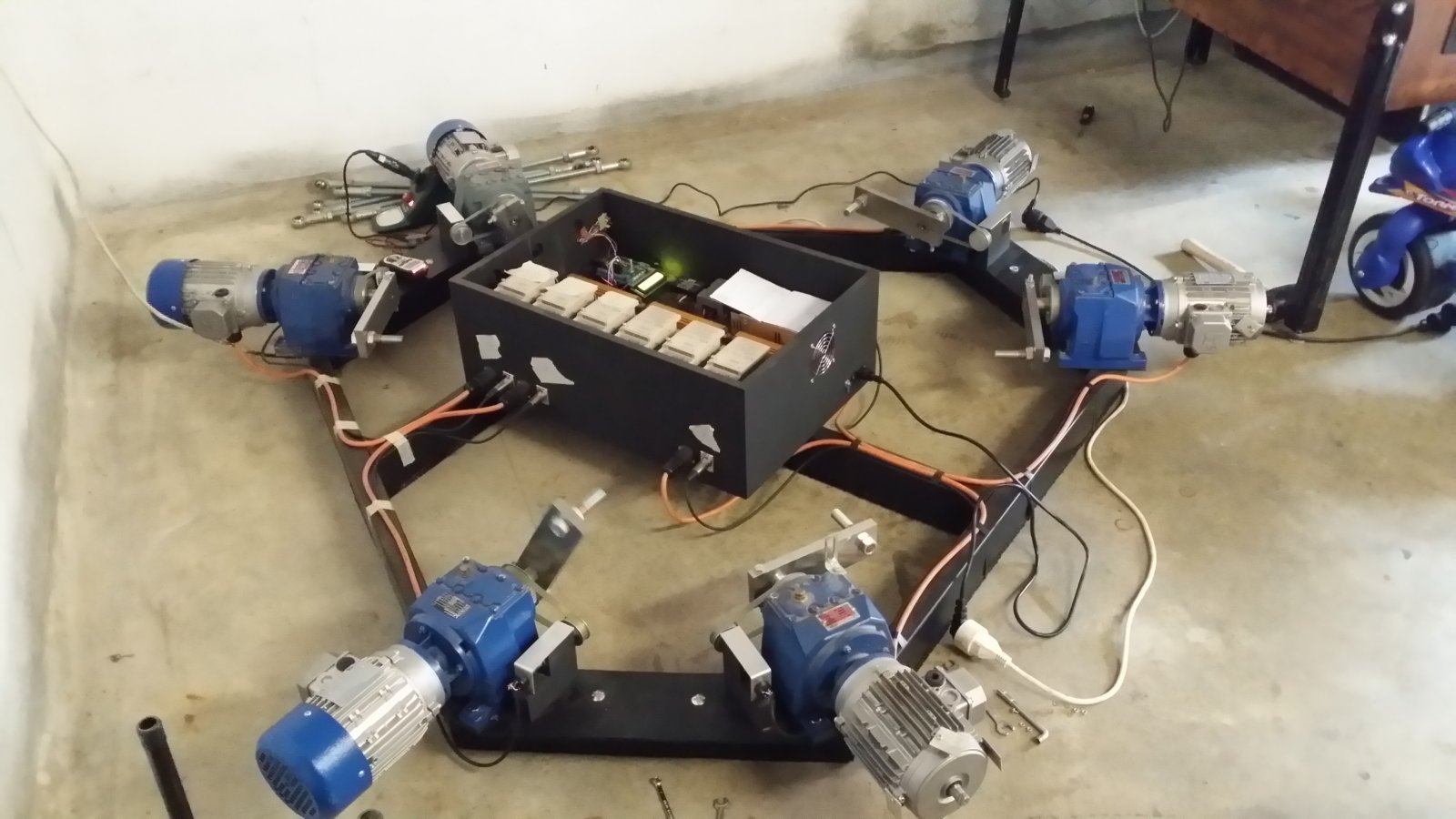

    I soldered the potentiometer and put the lugs on the motor wire. everything works impeccable yet.
    I think putting a small dot of hot glue on the seams to protect them
    until something better I put black tape to hold the cables.

  3. SeatTime
    2,572
    On my HE pots, I slide heat shrink over the cut insulation and solder joints. This give some strain relief to the solder joint, looks better and also give some protection from anything shorting across the open pins.
  4. vulbas

    yes it would have been better. but as the wires are very short it would have been difficult.
    this is why I put dots of hot glue. ;)

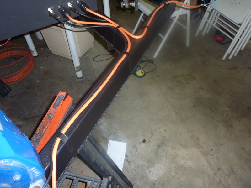

    Vulbas,
    FYI - Couple of items I'm using to secure wires to my frame...cheap and work well...
    Looking GOOD!

  7. eaorobbie
    20,491Coins
    +1,687 / 23 / -2
    I would be protecting the cabling quiet a bit more, looks like your only using extension lead cable, offers no protection from being crushed or cut, resulting in a bad brown out. Here in Australia big no no , all 240v exposed cables must be in cased in plastic conduit. Aussies Standards are the best in the world , but can be a pain in the bum too. I would not have steel fixings of 240v to a steel surface, not a safe practical fixing.
    • Agree Agree x 3
    • Optimistic Optimistic x 1
  8. cthiggin
    cthiggin Active Member
    Jul 1, 2012
    672
    Self-Employed
    Montgomery AL USA
    15,210Coins
    +435 / 0 / -0
    Never "caught" that eaorobbie. I've been so enthralled with the 6dof build.... I have my AC platform, 230v Cables inside flex conduit...it's very cheap at my local Lowes....
    Tom

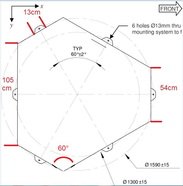

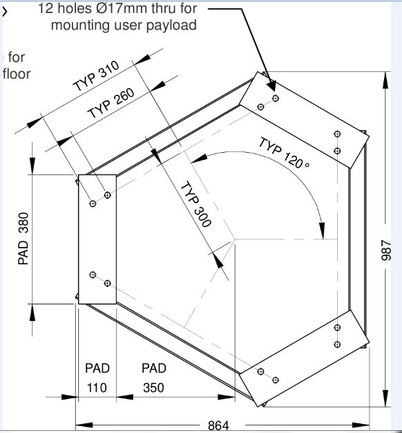

    Hi, can you tell me all measures used for your 6dof ? I'm doing similari work, but I have trouble making final connection . measures are (mm) : leg 150, rod 550 , servo distance to center of base 500, platform dist. to center 350, angle of servo couple 37.5 degree, angle of platform attachment couple 8 degree.
    Tank you
  11. vulbas
    vulbas Active Member
    Jul 28, 2009
    208
    france
    1,102Coins
    +216 / 0 / -0
    AC motor, 6DOF
    hello
    If you want the pdf. the scale 1 I items you

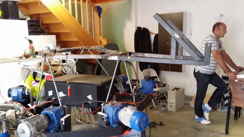

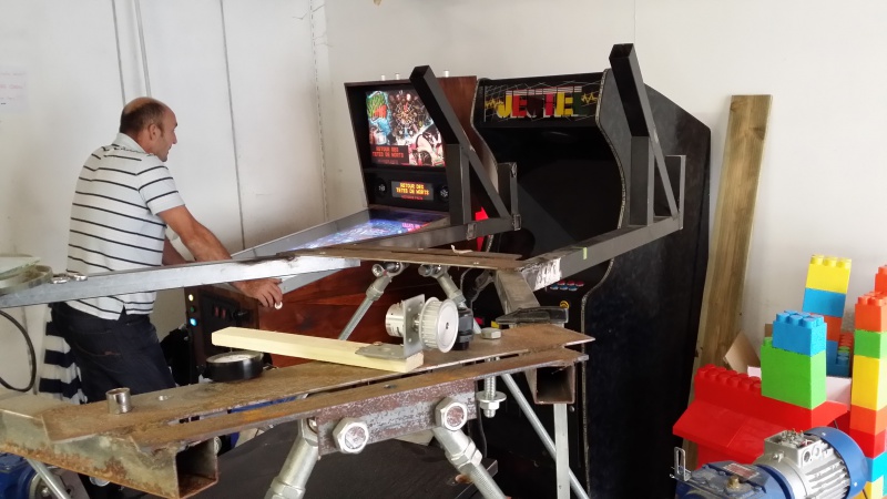

    20140816_195307.jpg soon finished :)
