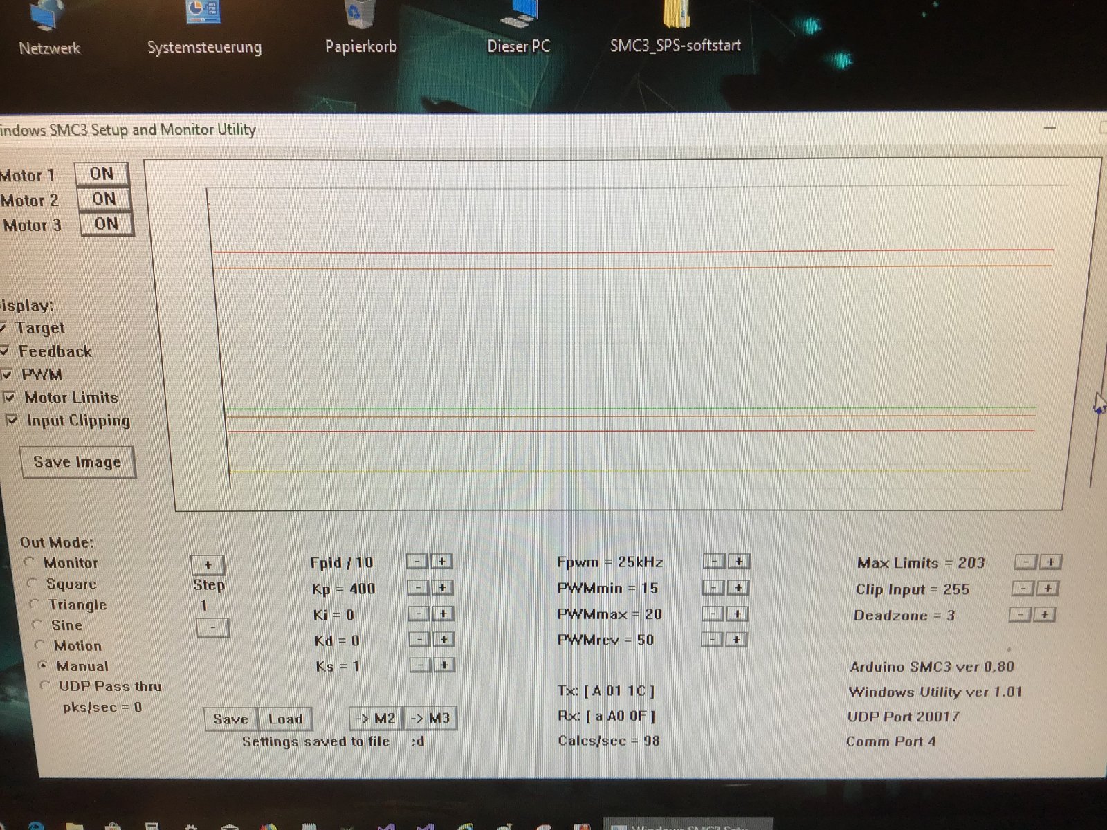

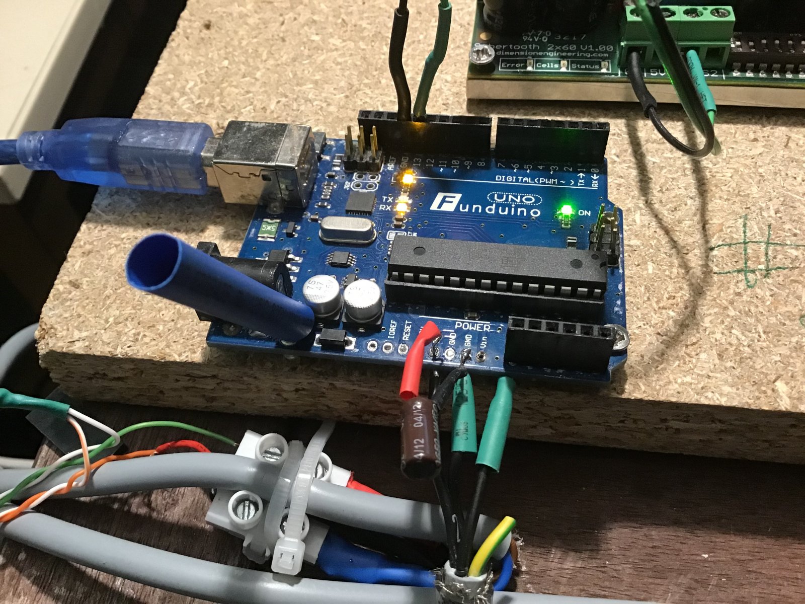

    Hi, finally I got there. But my engine has got twitches.
    I read about it here: https://www.xsimulator.net/communit...driver-and-windows-utilities.4957/#post-48121
    "FPID / Standardmäßig führt die PID - Schleife 4000 Berechnung Updates pro Sekunde. Dieser Teiler ermöglicht es Ihnen , die Anzahl der PID - Berechnungen pro Sekunde durch die geteilte Menge zu reduzieren. Manchmal kann dies helfen , wenn die Motorwicklungen hörbare Geräusche produzieren. Die Anzahl von ca. Calcs pro Sekunde ist in der Mitte der unteren SMC3 Utils Fenster angezeigt. (Dies kann ein wenig herum springen , da es nur ein Indikator ist)"
    Und auch hier: https://www.xsimulator.net/communit...ket-serial-pid-motor-driver-w-softstart.9277/
    "10.Set Fpid to / 1. (If you experience motor twitching or other issues then try increasing it)"
    I tried to increase fpid, it only got worse.
    Here is a video of it
    Has anyone an idea of the reasons why?
    Can this possibly be due to pot interference? Disorders?
    I soldered contacts from Poti to Arduino!

    I can't make out your deadzone setting. Have you tried increasing it?
  10. Vitalius
    Vitalius Active Member Gold Contributor
    Jul 2, 2018
    153
    Bonn
    540Coins
    +74 / 1 / -0
    Motion platform, 6DOF
    Deadzone Setting is currently stands at 1
    I try to increase this value tomorrow.

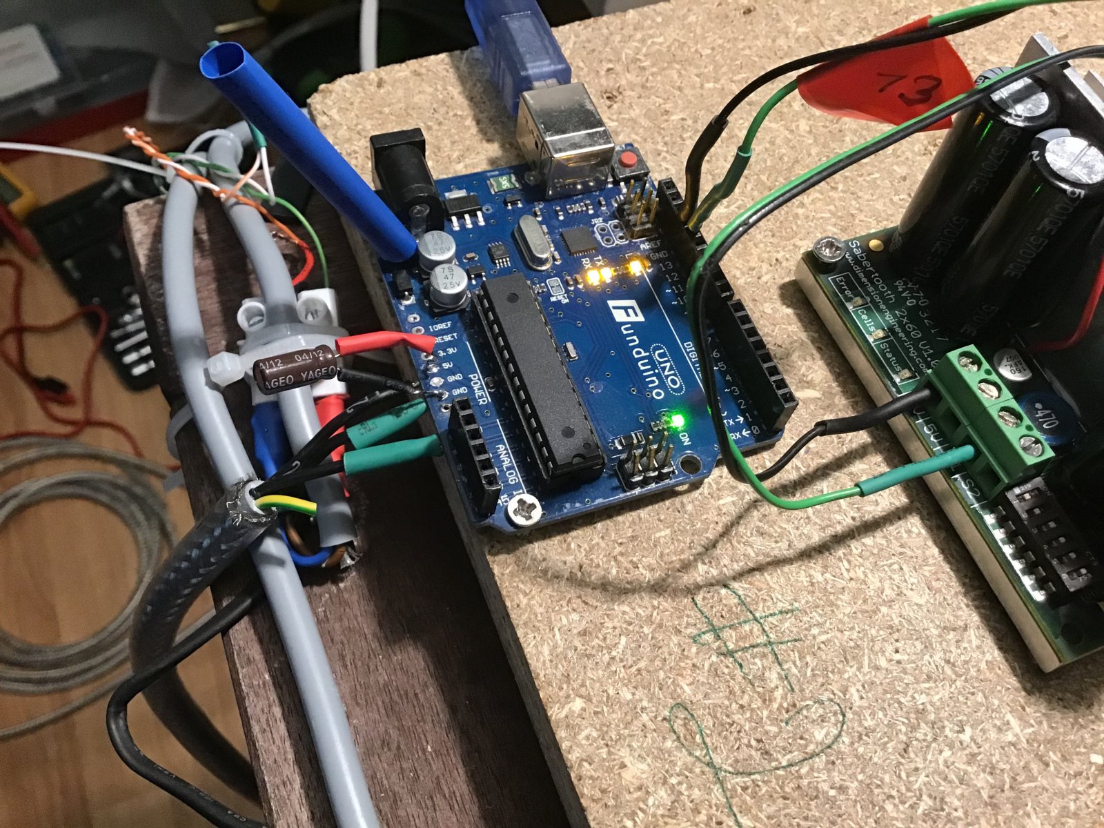

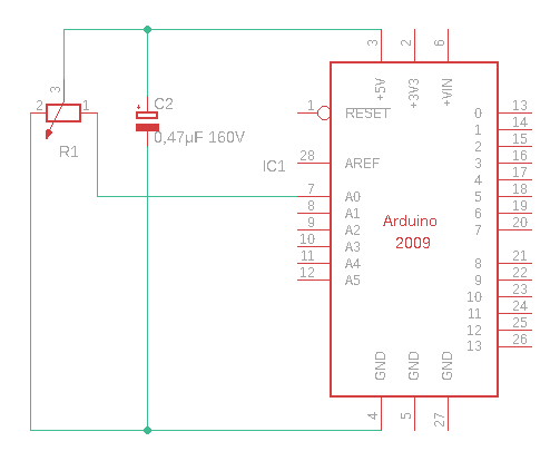

    I almost solved my problem.
    Potentiometer rewired with shielded cable and soldered. Also at the Arduino Uno I lost all contacts. In addition, an electrolytic capacitor 0,47 μF 160V between 5 volts and GND was attached. And here is the result:
    Potentiometer line has now become pretty straight

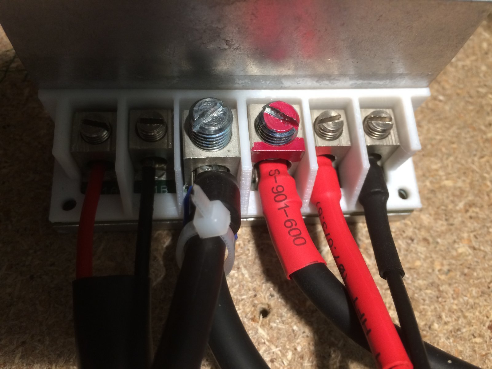

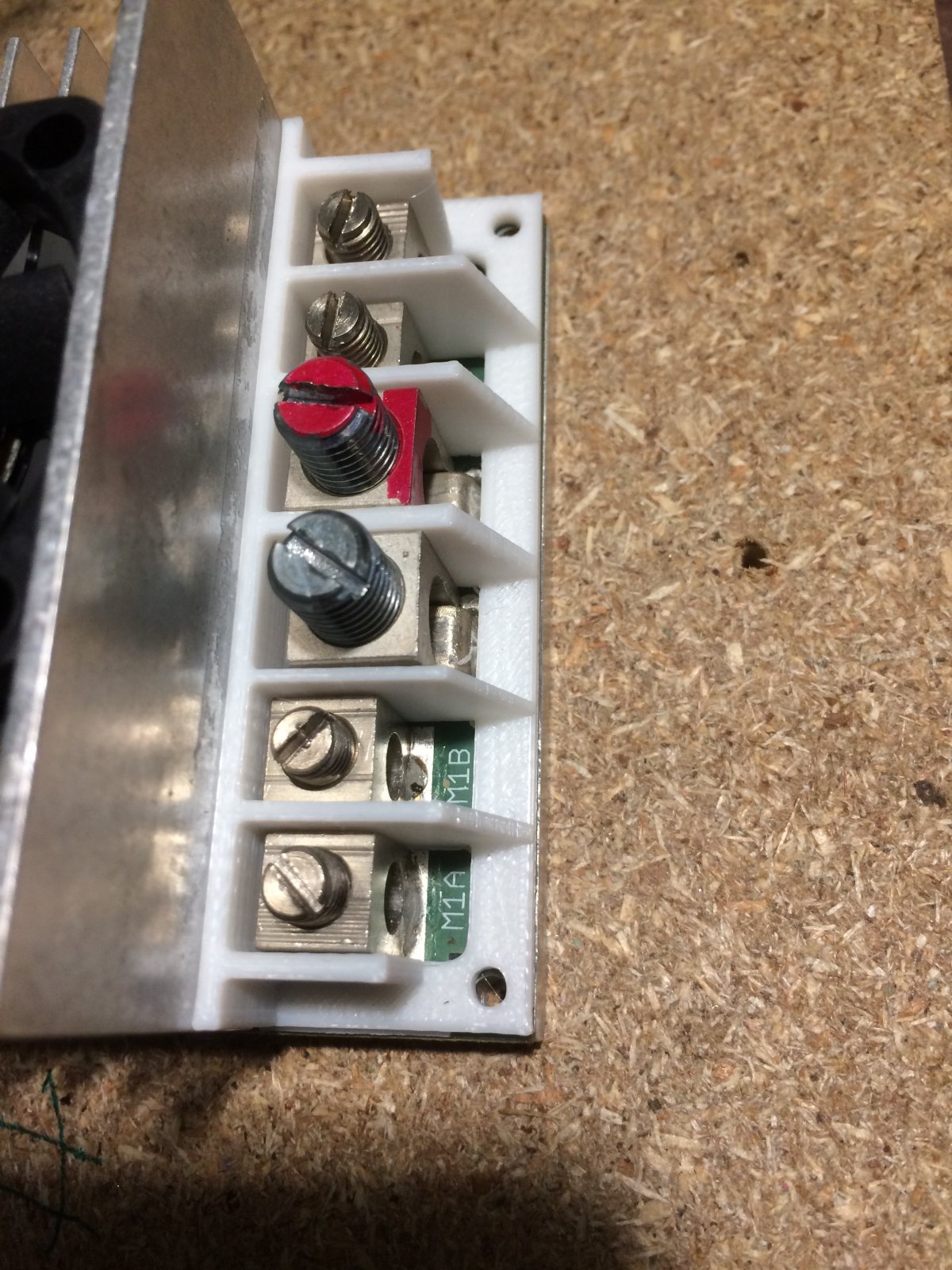

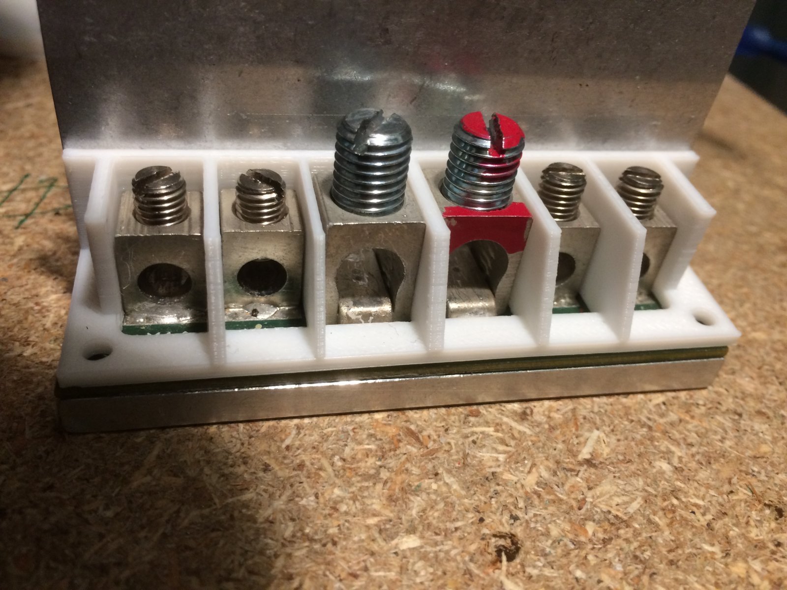

    Did something good yesterday for my Sabertooth 2x60 made.
    Now awful insulating tape can go away. Maybe someone will find the insulating protection useful.
    IsolierSchutz_skp.rar
  13. BlazinH
    BlazinH Well-Known Member
    Oct 19, 2013
    2,145
    Oklahoma City, USA
    16,689Coins
    +1,839 / 32 / -1
    Nice work. I've always thought it quite asinine that DE didn't do anything to keep wires from shorting out on the 2x60's heat sink if you insert them just a hair bit to far. :thumbs
