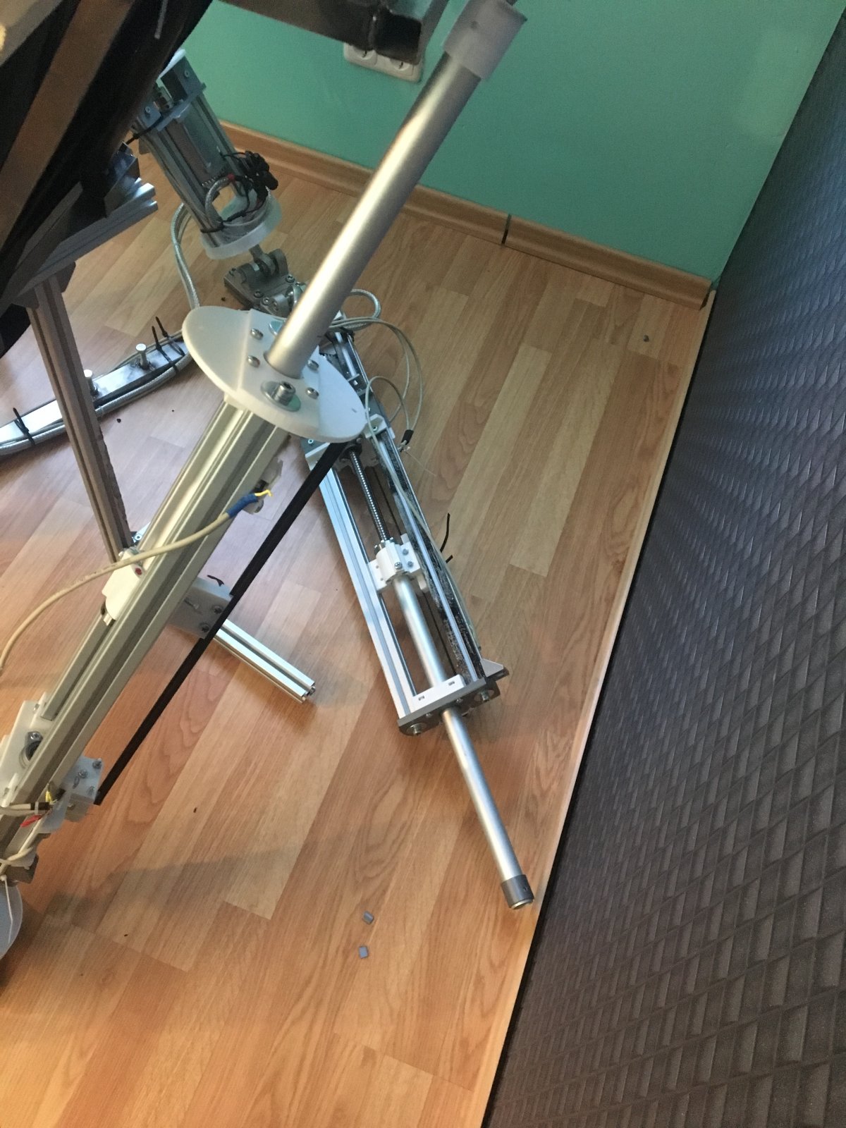

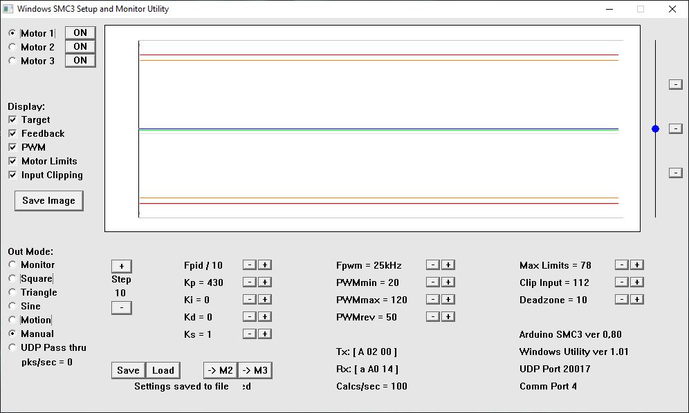

    Hello everybody.
    Can someone please help me with this problem?
    When I load my ring, he becomes restless and begins to tease.
    Here is a video of it:

  5. SilentChill
    2,645
    20,590Coins
    +3,567 / 34 / -0
    In SMC3 UTILITY set Fpid to 3 or 4 ;) hopefully that works if not post screen grabs of your settings

    Here are my set
    Already have FPID at 10.
    I had to set Deadzone to 5 to minimize engine additions. But I arrived today at 10. I probably have "slack" as described in SMC3 Windows Utilities.
    "Deadzone This creates a hysteresis zone for the engine feedback If you need more than 1, you probably have too much slack in your mechanical setup."
    Unfortunately, I do not miss a where to look for me.
    All my feedback pot are soldered firmly and I use shielded cables at motors and pots.

    Hello, try to upload the PWmin and PWMax values

    Hello I tried, unfortunately, the vibrations generated were even stronger.
    PWmin have already been at 60.

    "Its possible its the 50k pots. It's recommended to use 10k or less with arduino." from Link
    Which potis do you use?
    I use 50k pots

    You should have PWmin at Zero and no deadzone.
    Use hall sensor pots if you can they are far superior to normal pots for interference.
    I use cat5 cable for my HallEffect pots and never had a issue.
    And probably using 5k or 10k pots if not hall effect ones may help I dunno

    Those potentiometers are very difficult to tame, you should use 10k linear pots

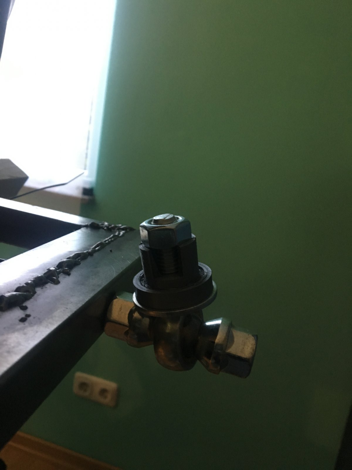

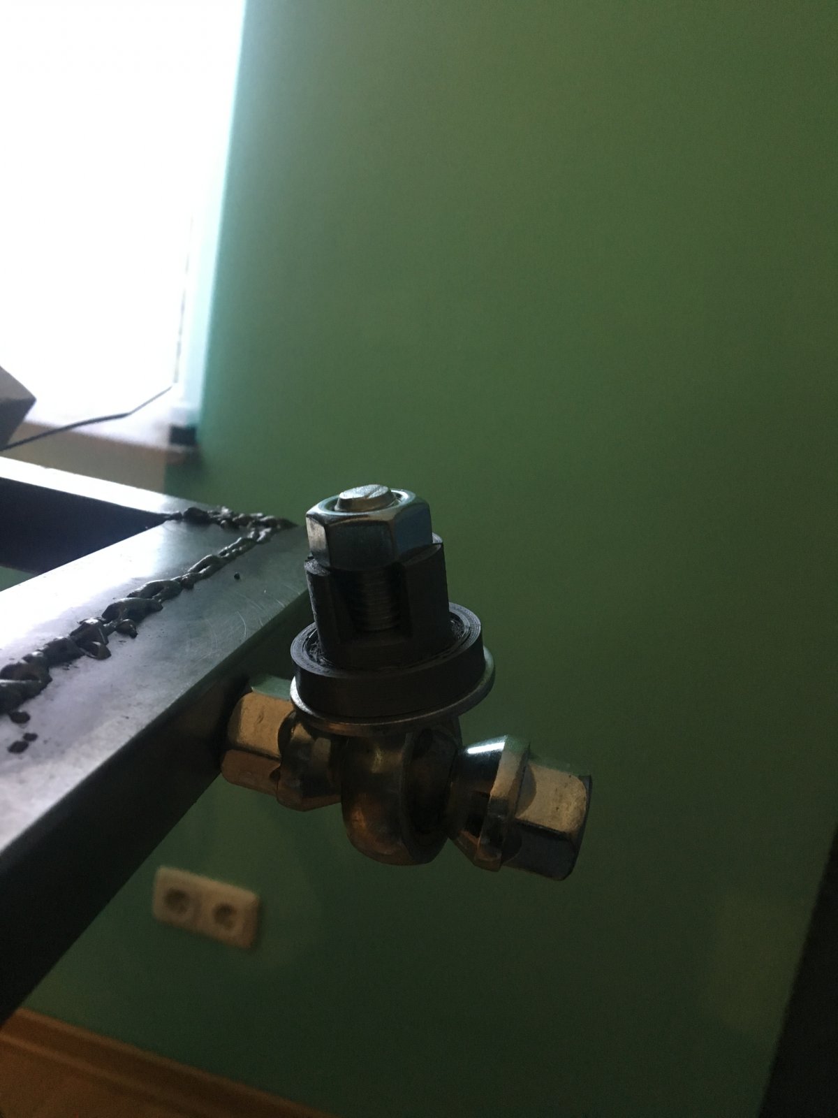

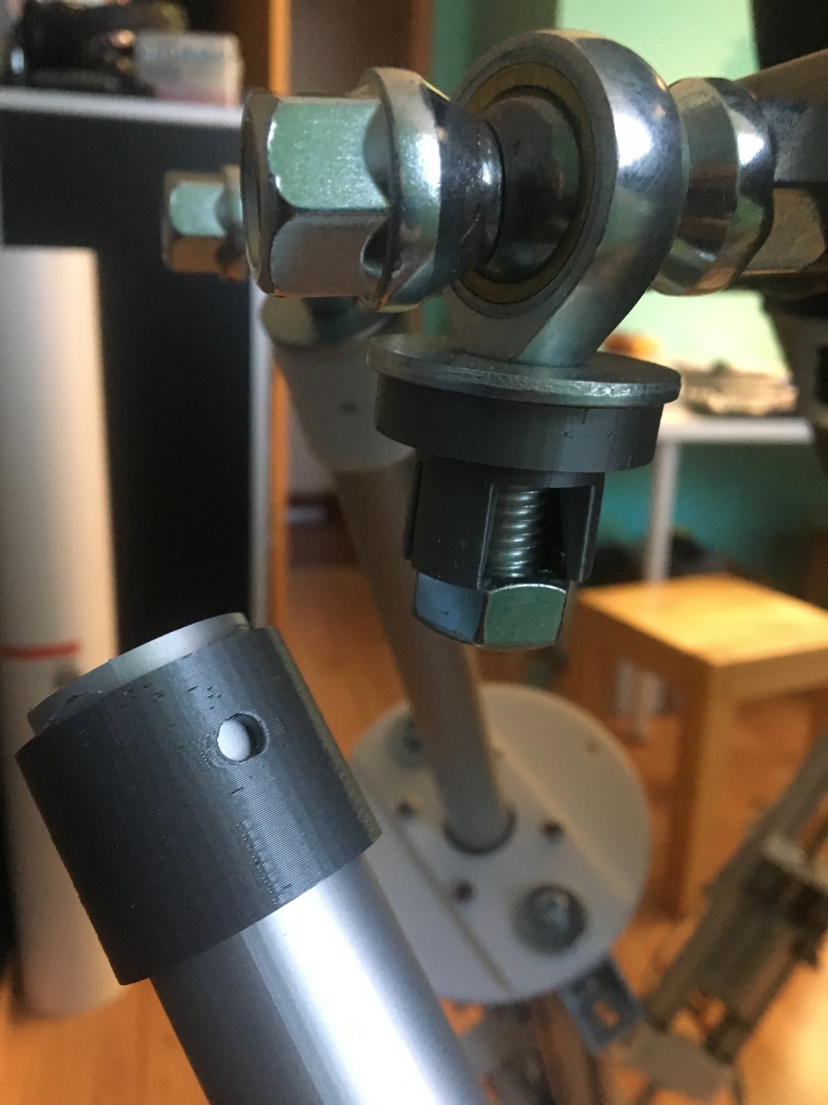

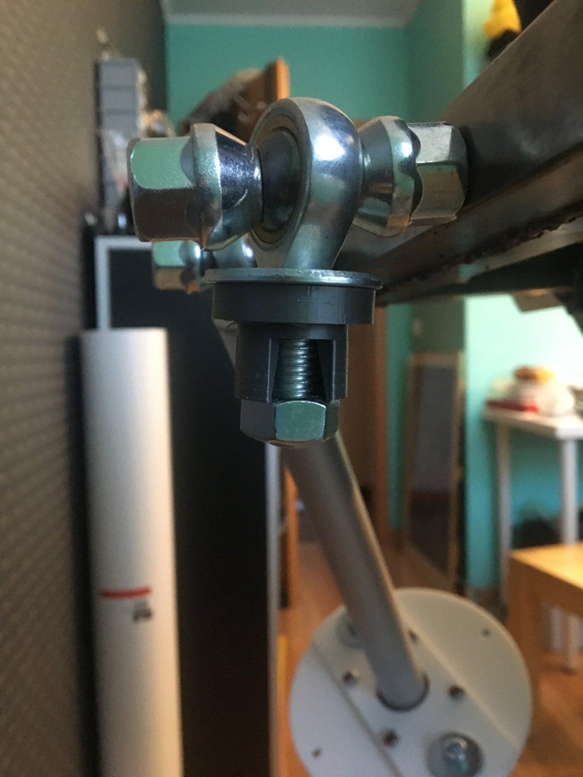

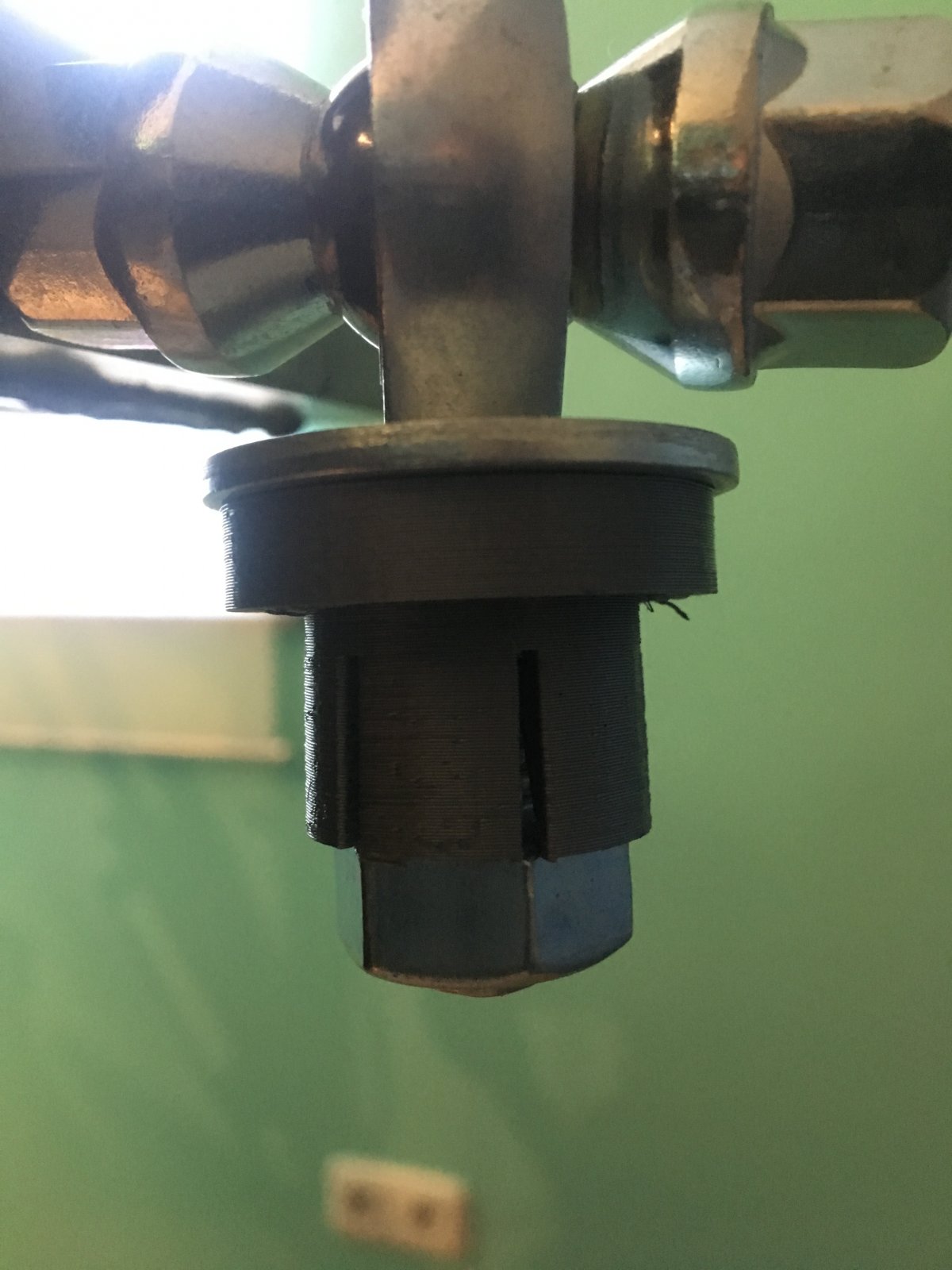

    At the moment I'm busy repairing the ball joint mount. The first parts I made from PLA. The new ones are currently being printed from PET-G.
