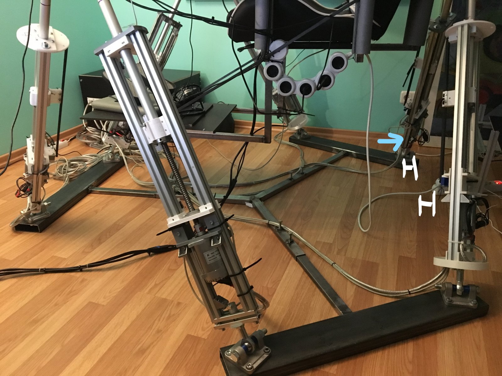

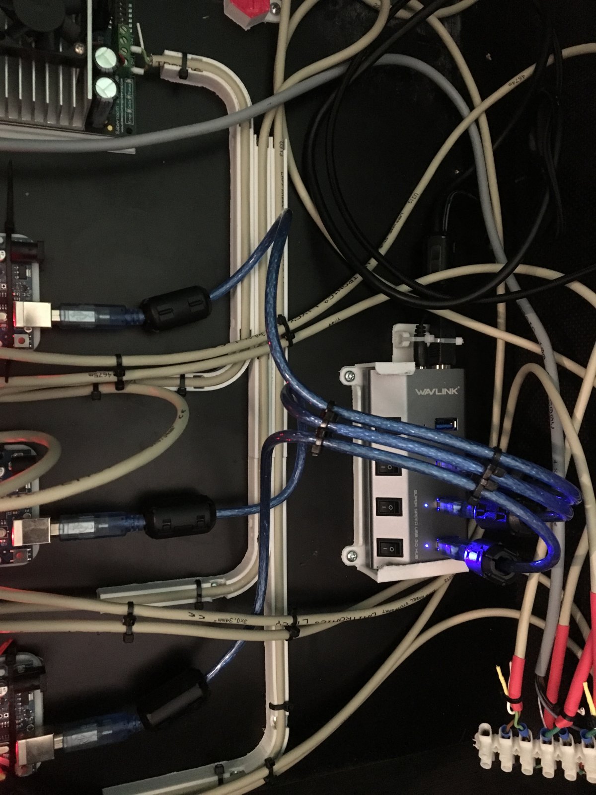

    Thanks for asking, I got my replacement Sabertooths 2x60 back and installed and actually everything is ok. Only I have a new little problem. A stöhr noise.A video recording is still under construction

    Hello. thanks for the feedback!

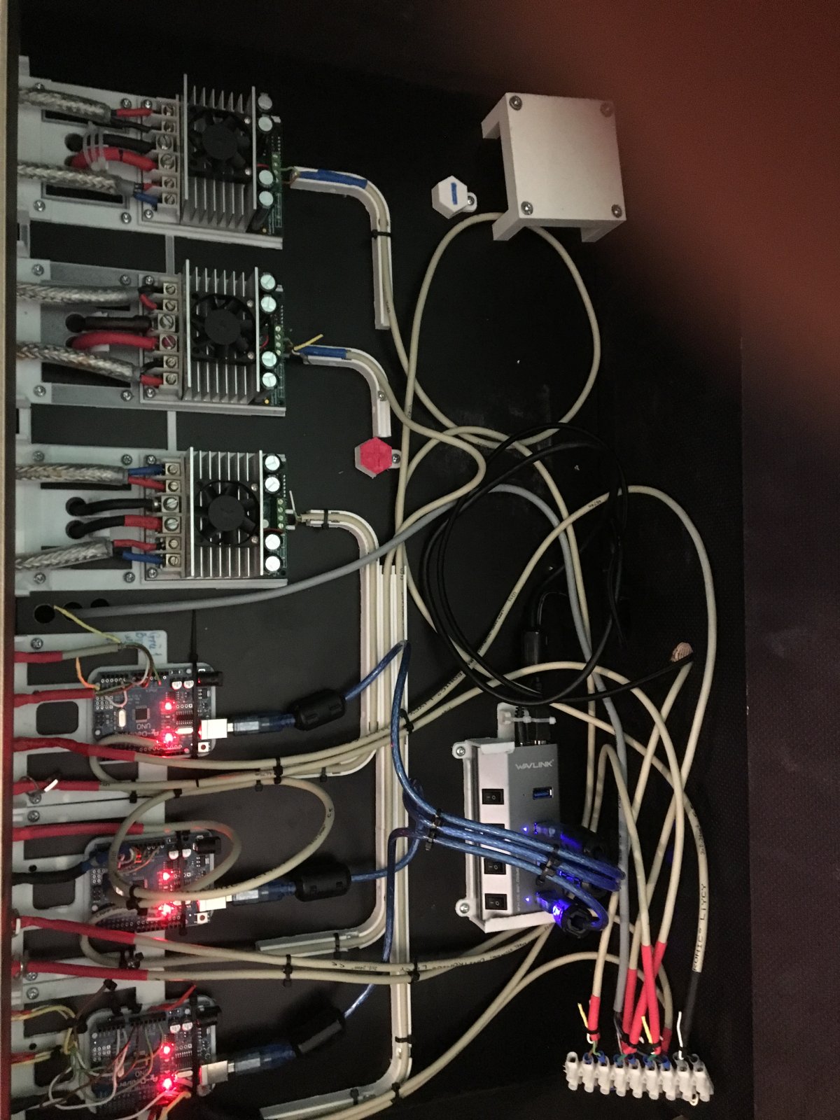

    So the noise comes from engine 2 in the photo with the arrow.
    Two motors run with the hall sensors marked H in the photo.

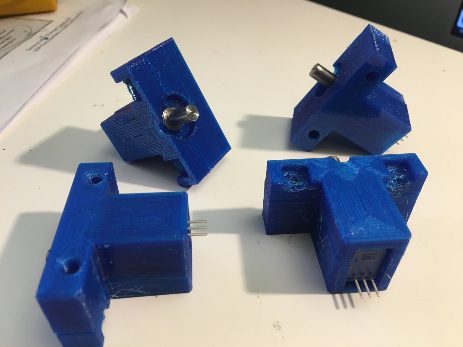

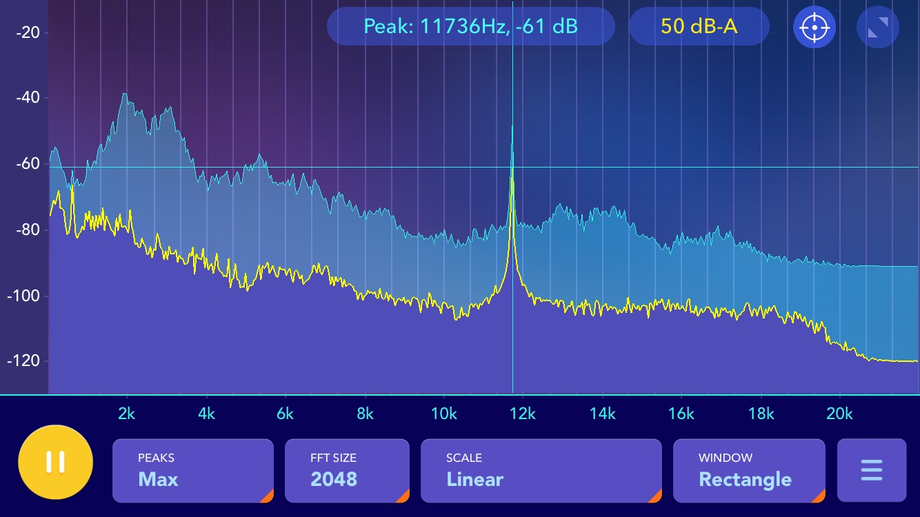

  6. Vitalius
    Vitalius Active Member Gold Contributor
    Jul 2, 2018
    153
    Bonn
    540Coins
    +74 / 1 / -0
    Motion platform, 6DOF

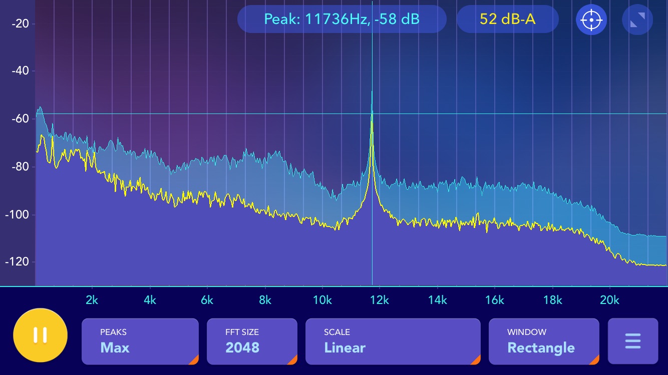

    Here is a video of Tonight or this morning.
  7. Vitalius
    Jul 2, 2018
    153
    Bonn
    540Coins
    +74 / 1 / -0

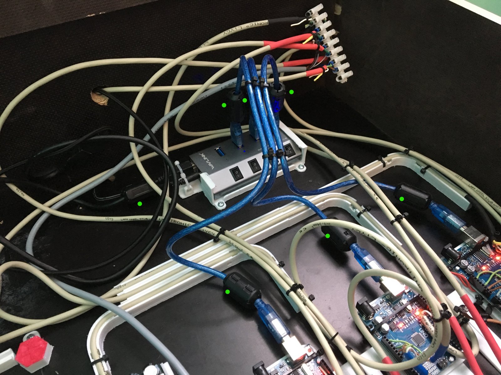

    Then I installed "Folding ferrite filter sheath current ferritic core suppression". Link
    Marked in the photo with green dots.
    And suddenly the 10-12K noise is gone!
    I have to test a lot! Wait, I hope that is not a random. By the way, I only use a shielded cable everywhere. He is not grounded!
  8. SilentChill
    2,645
    20,604Coins
    +3,570 / 34 / -0
    All I have ever used is Cat5 cable for my pots never ever had any issue with noise

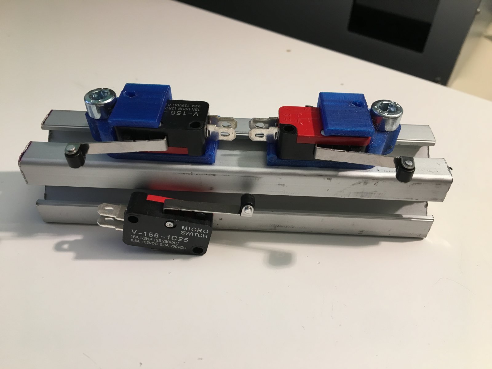

  13. Vitalius
    Jul 2, 2018
    153
    Bonn
    540Coins
    +74 / 1 / -0

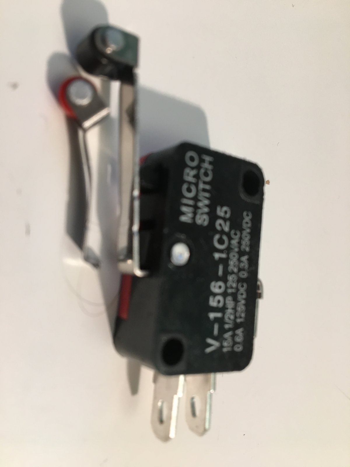

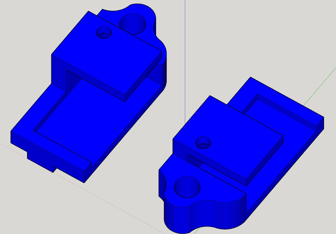

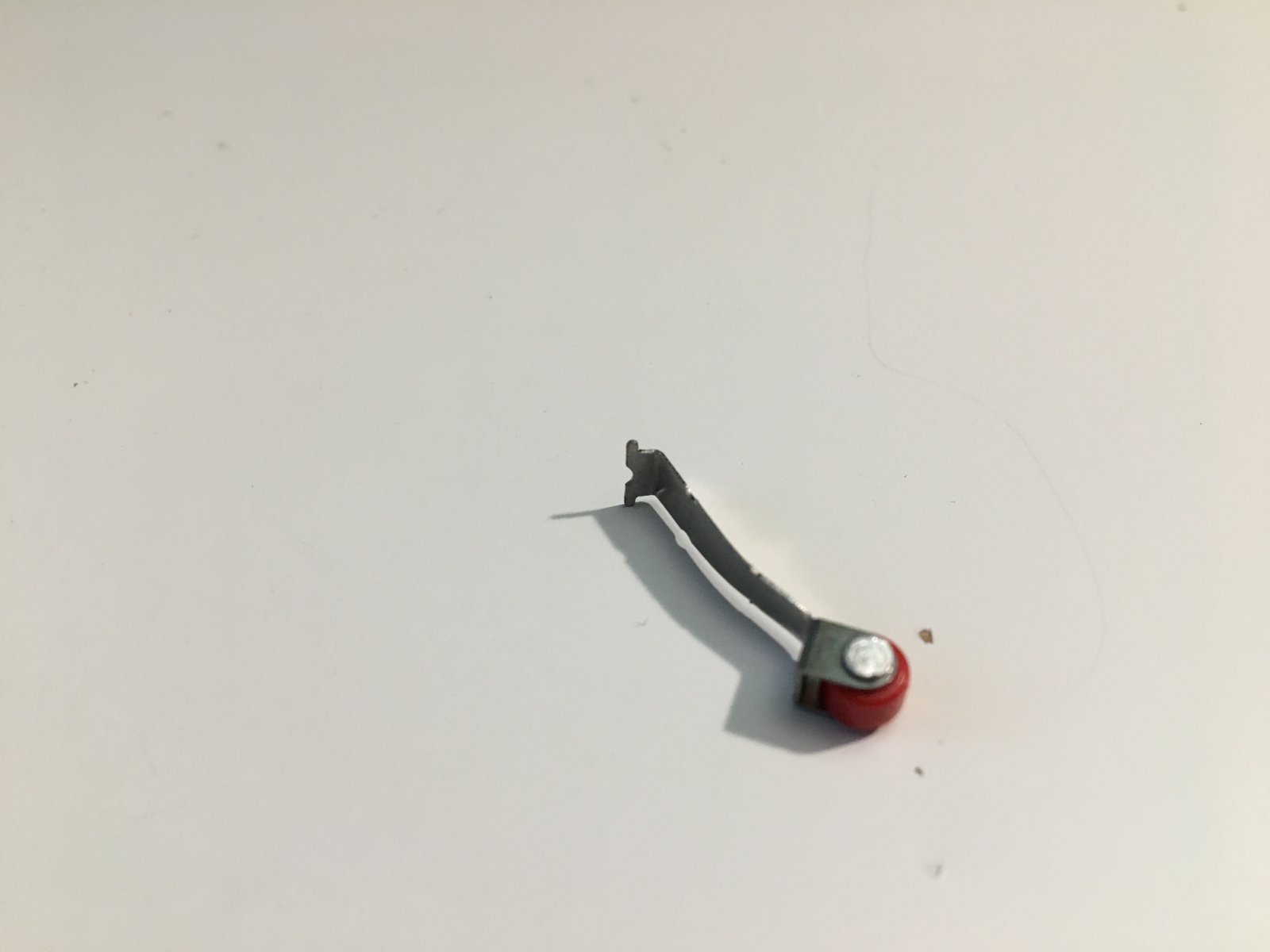

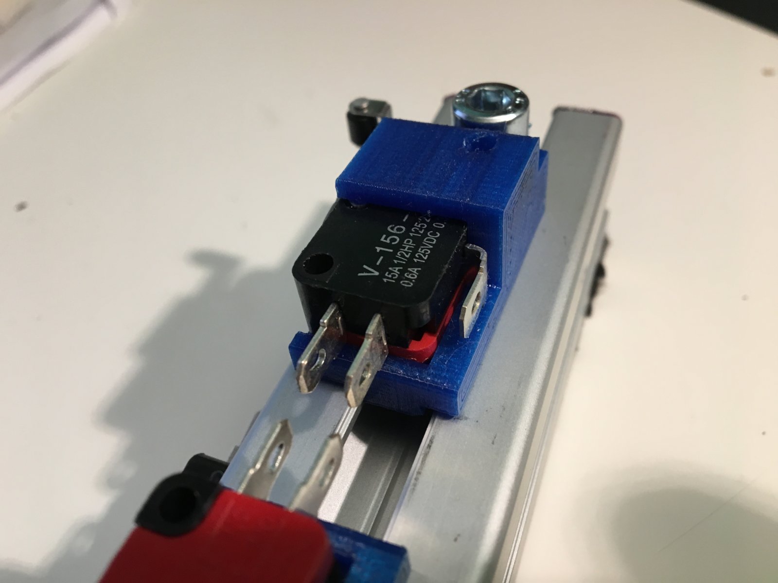

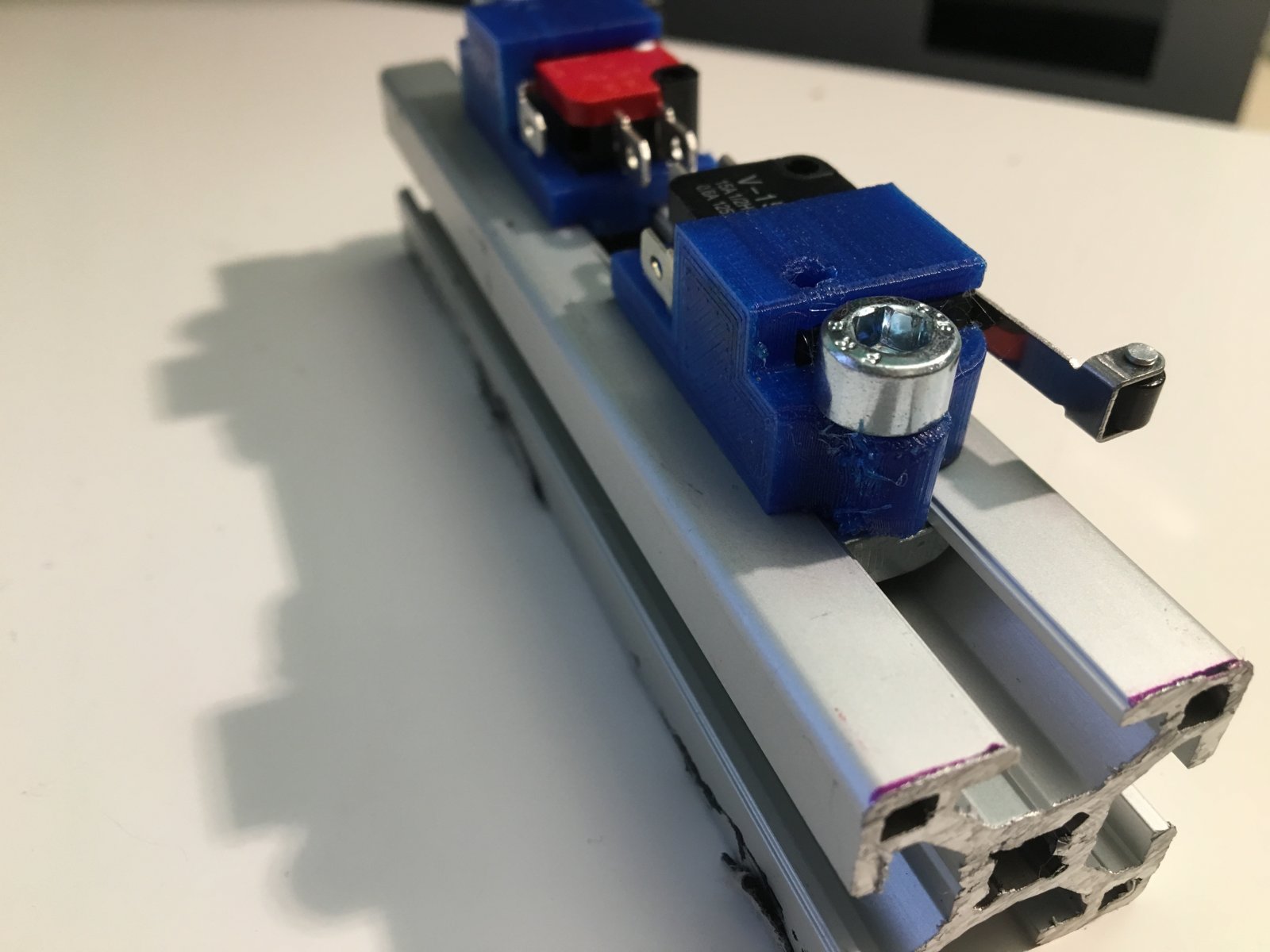

    Last change to my Actuators.
    I had to realize that my limit switches break out of each other.
    I bought new ones that are bit more robust and had to match the holders for new switches.

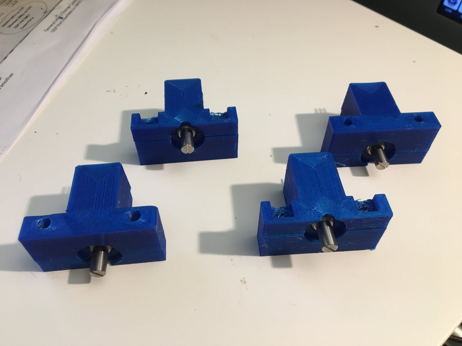

    Two out of four 360 degree Hall sensors have been installed for more than a month and run flawlessly.
    I still have to block it. A lot of work!

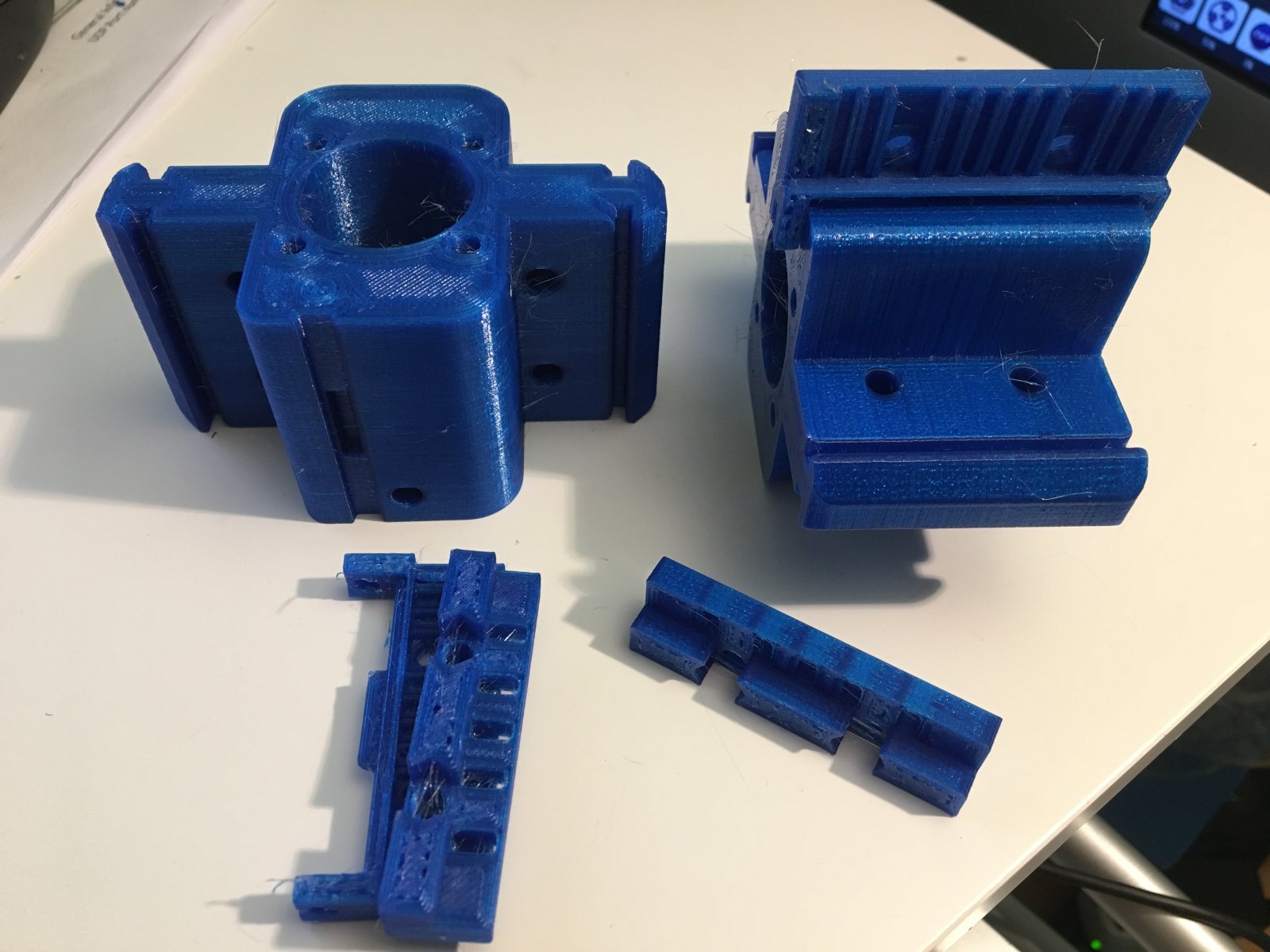

    And I will replace all sliders that are not so stable against new sliders printed with 100% feel
  16. hannibal
    hannibal Active Member
    Sep 29, 2018
    677
    4,492Coins
    +298 / 4 / -0

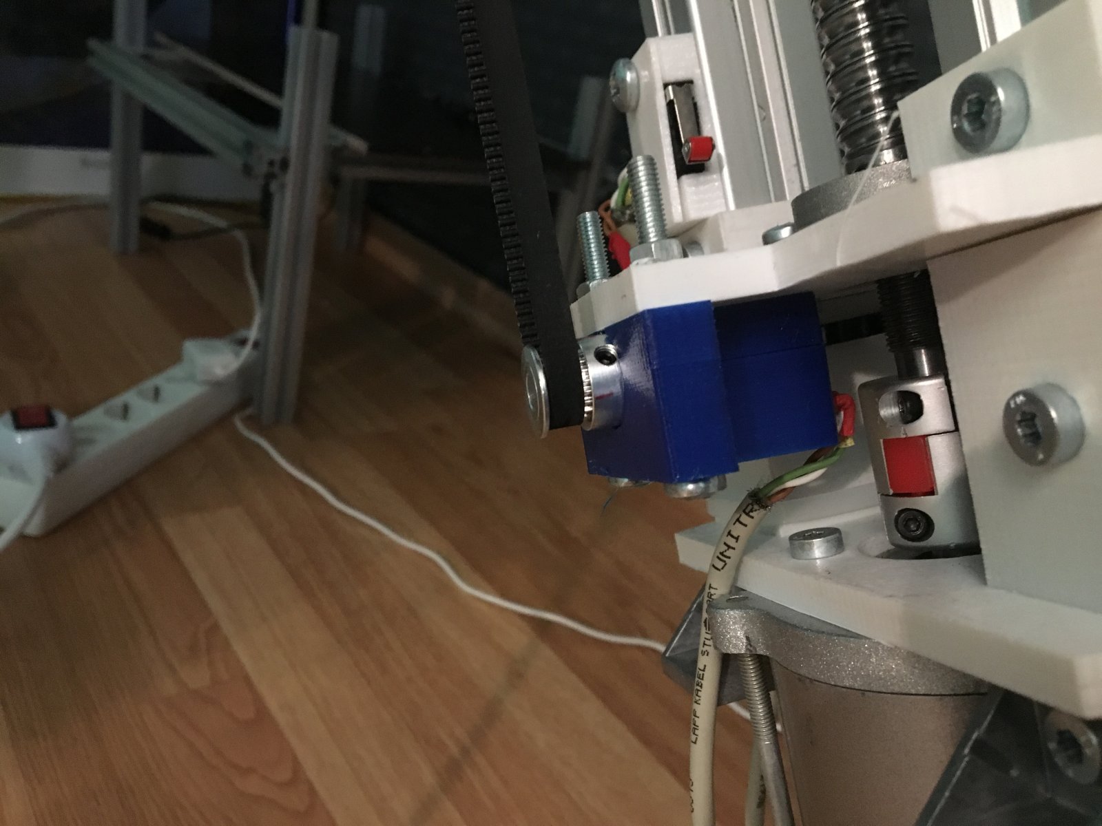

    keep going brotha! i am also back at building my pot assemblies!
    but my opinion is that i dont think having the tension on the pot is a good idea..
  17. Vitalius
    Jul 2, 2018
    153
    Bonn
    540Coins
    +74 / 1 / -0

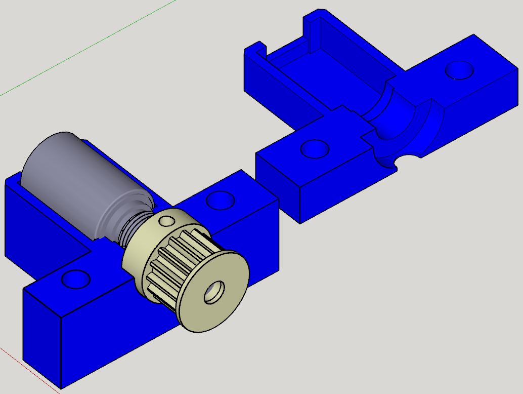

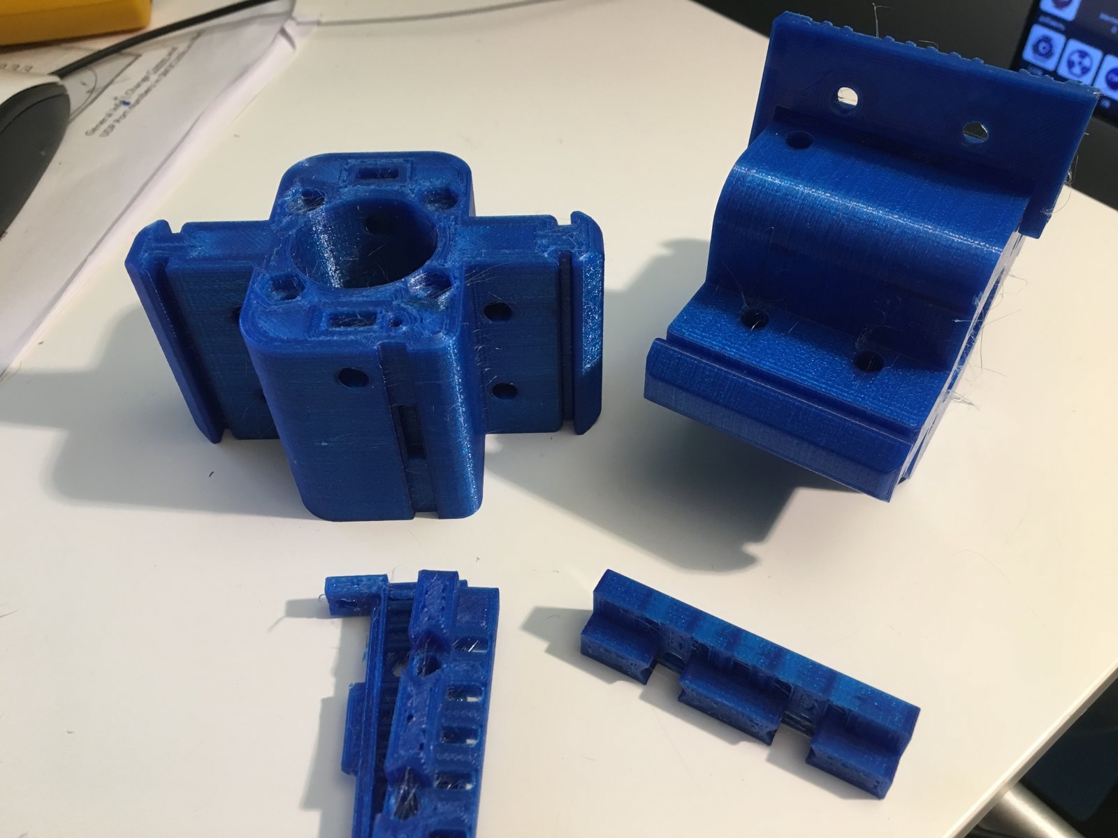

    The toothed belt wheel is immersed in the housing so that the tension of the toothed belt wheel is absorbed by the housing. This creates a bad ball bearing with a lot of friction. I will show the 3d drawing later. The normal cheap potis have been held for almost 6 months.
  18. Vitalius
    Jul 2, 2018
    153
    Bonn
    540Coins
    +74 / 1 / -0
    The Pulleyslides or lies on the housing.

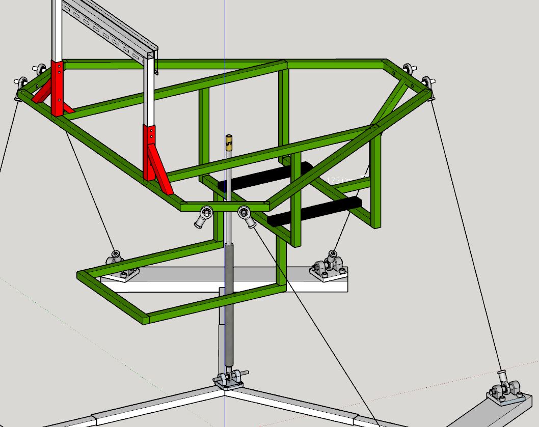

  19. Vitalius
    Jul 2, 2018
    153
    Bonn
    540Coins
    +74 / 1 / -0
    I still have so much work!

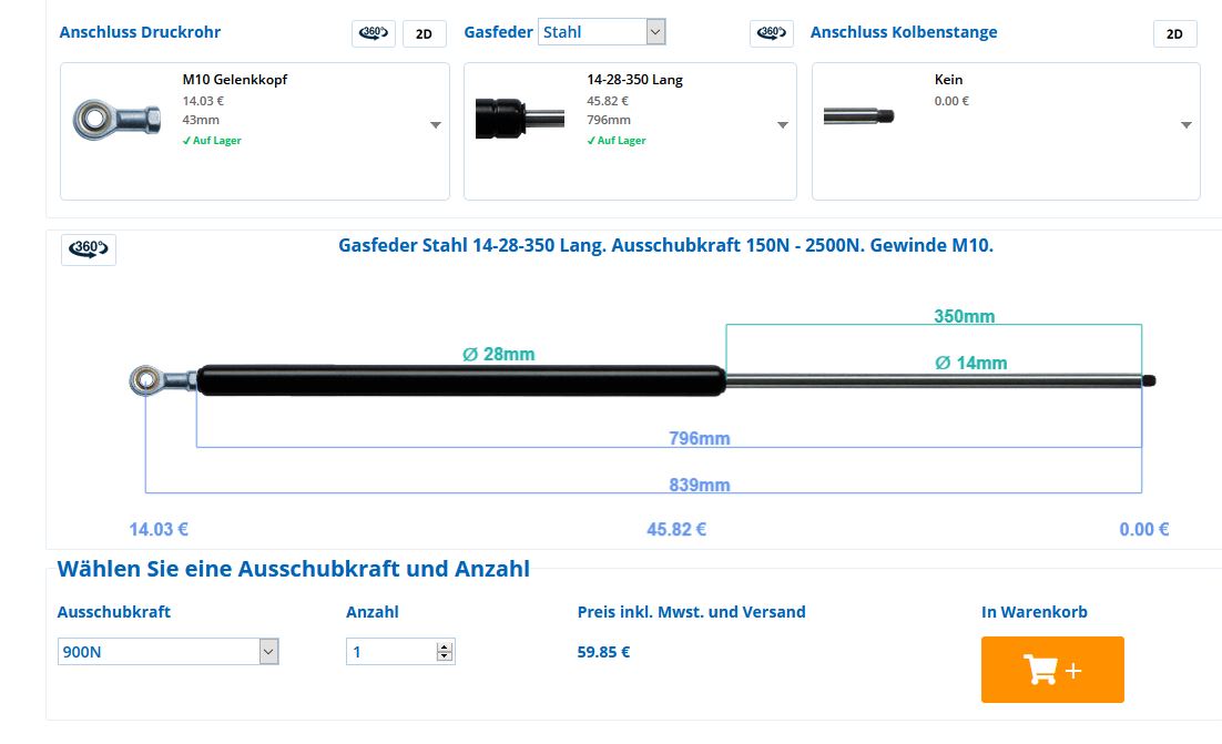

    The here with gas spring is also in planning.
    I am not sure yet how much pushing force should I take. And if that works
