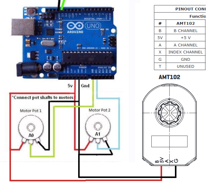

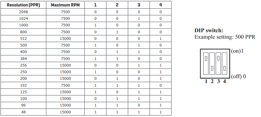

    Hello everybody.
    Has anyone already experience with the AMT102-V encoder?
    I would like to use an AMT encoder instead of a potentiometer.
  13. Gadget999
    1,977
    12,066Coins
    +488 / 10 / -0
    How many pulses per revolution does it have ?
    Are you using smc3 code ?

    you will need to convert the code to work with encoders instead of potentiometers

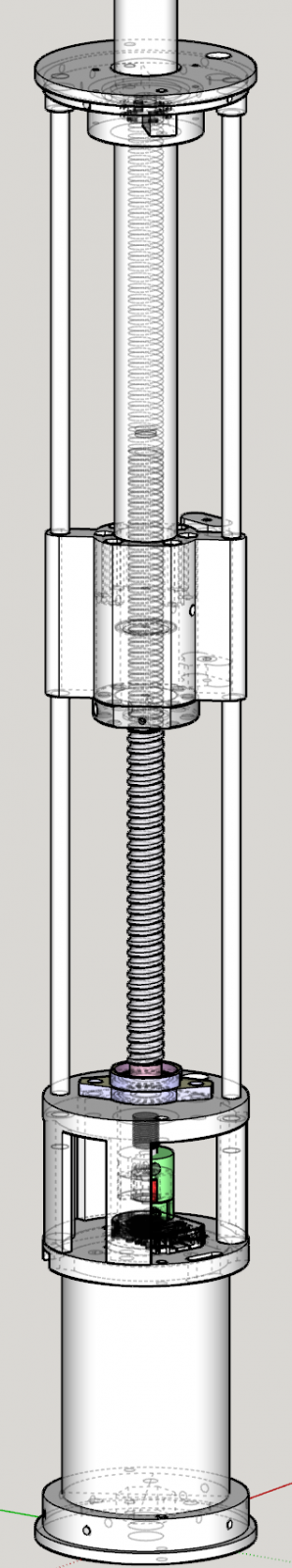

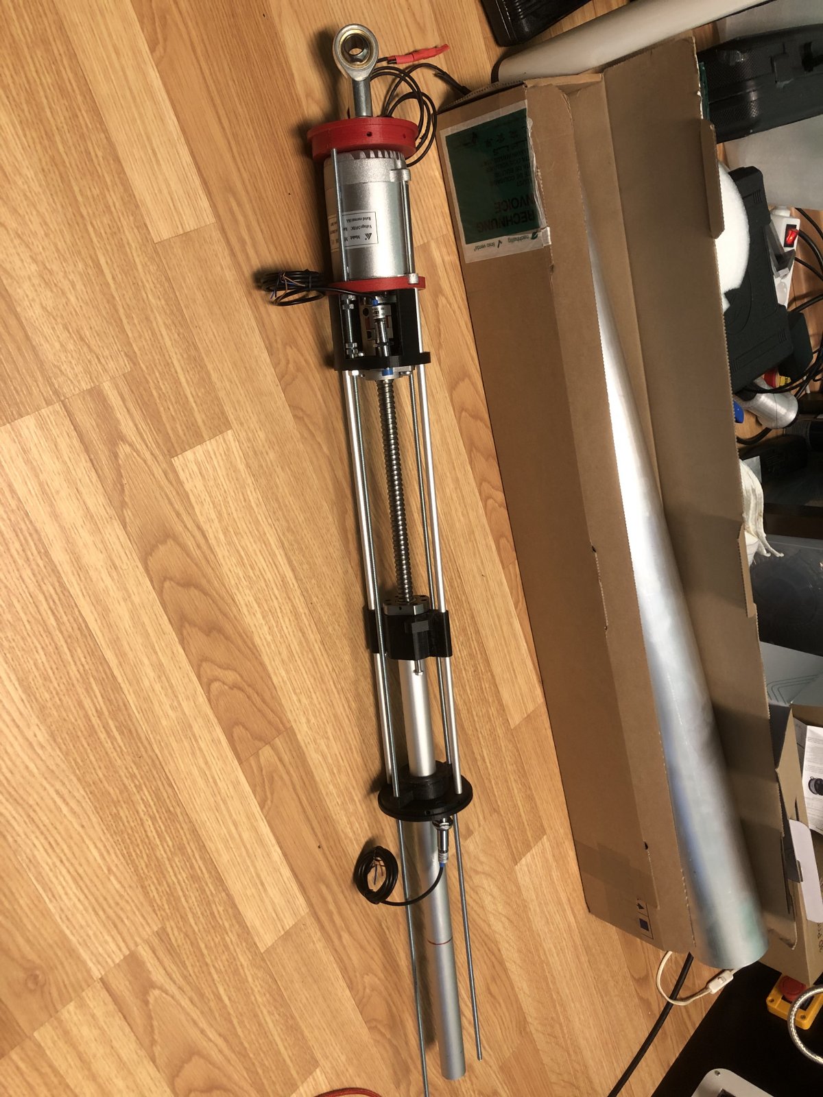

    Only 2 rods to support it all? You are a wild one.
  19. Vitalius
    Vitalius Active Member Gold Contributor
    Jul 2, 2018
    153
    Bonn
    540Coins
    +74 / 1 / -0
    Motion platform, 6DOF
    [QUOTE = "Pierre Lalancette, Post: 215910, Member: 23761"] Only 2 poles to support everything? You are a wild one. [/ QUOTE]
    Hello, actually the rods are supposed to avoid the rotation of 1605. The entire weight should be distributed over the motor to the 3 mm thick aluminum tube on top and the recirculating ball screw 1605.

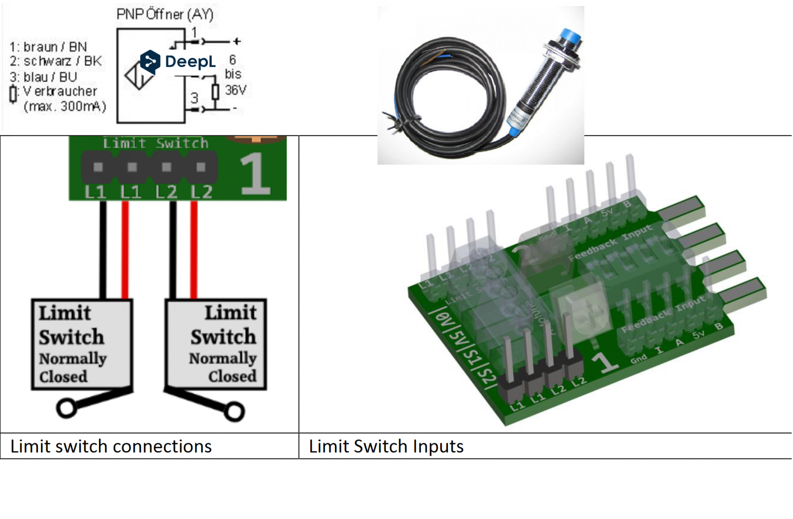

    Hello everyone, does anyone have experience with inductive proximity switches? I would like to connect inductive proximity switches to the Kangaroo x2 Motion Controller. Unfortunately I couldn't find any examples in google up to
    now, maybe a resistance has to be switched in front of it? I then search further :-(
    I am thankful for every help
