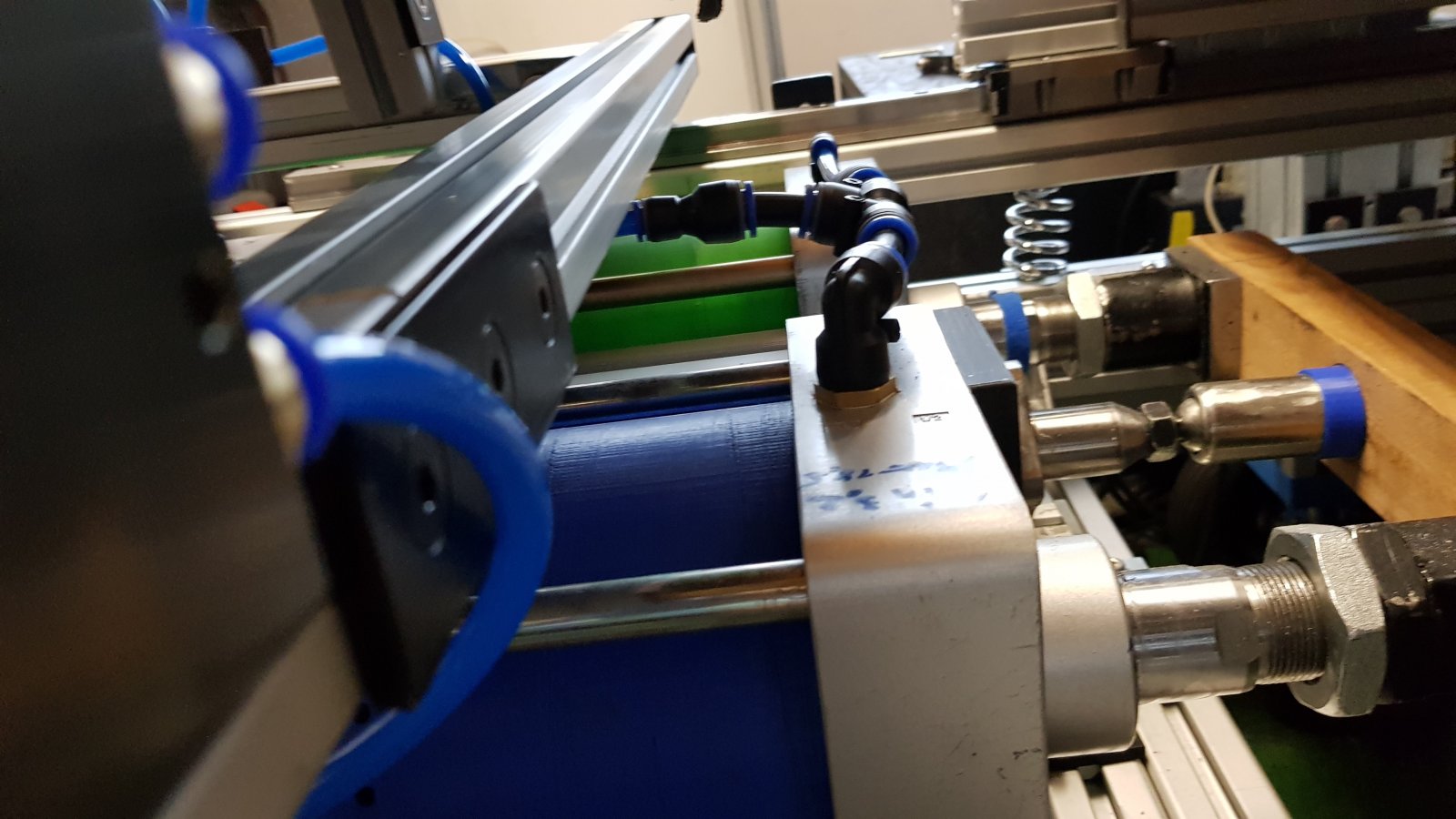

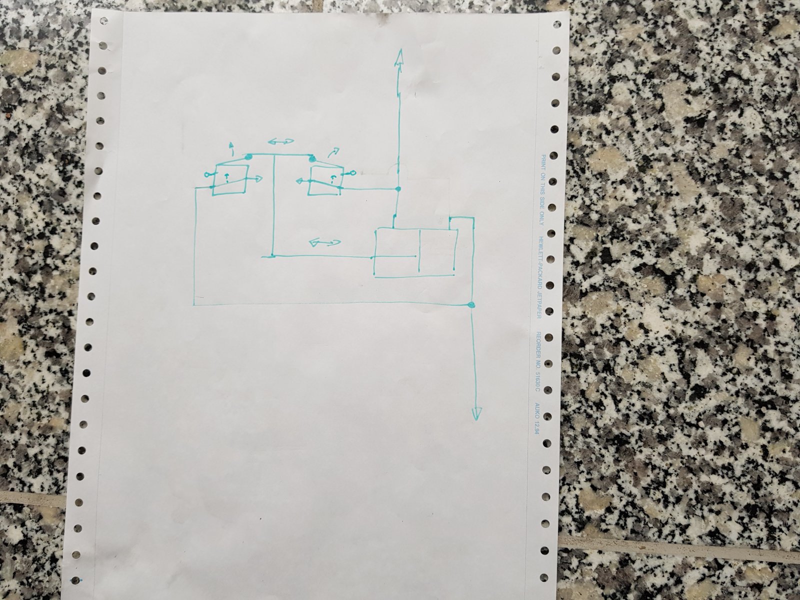

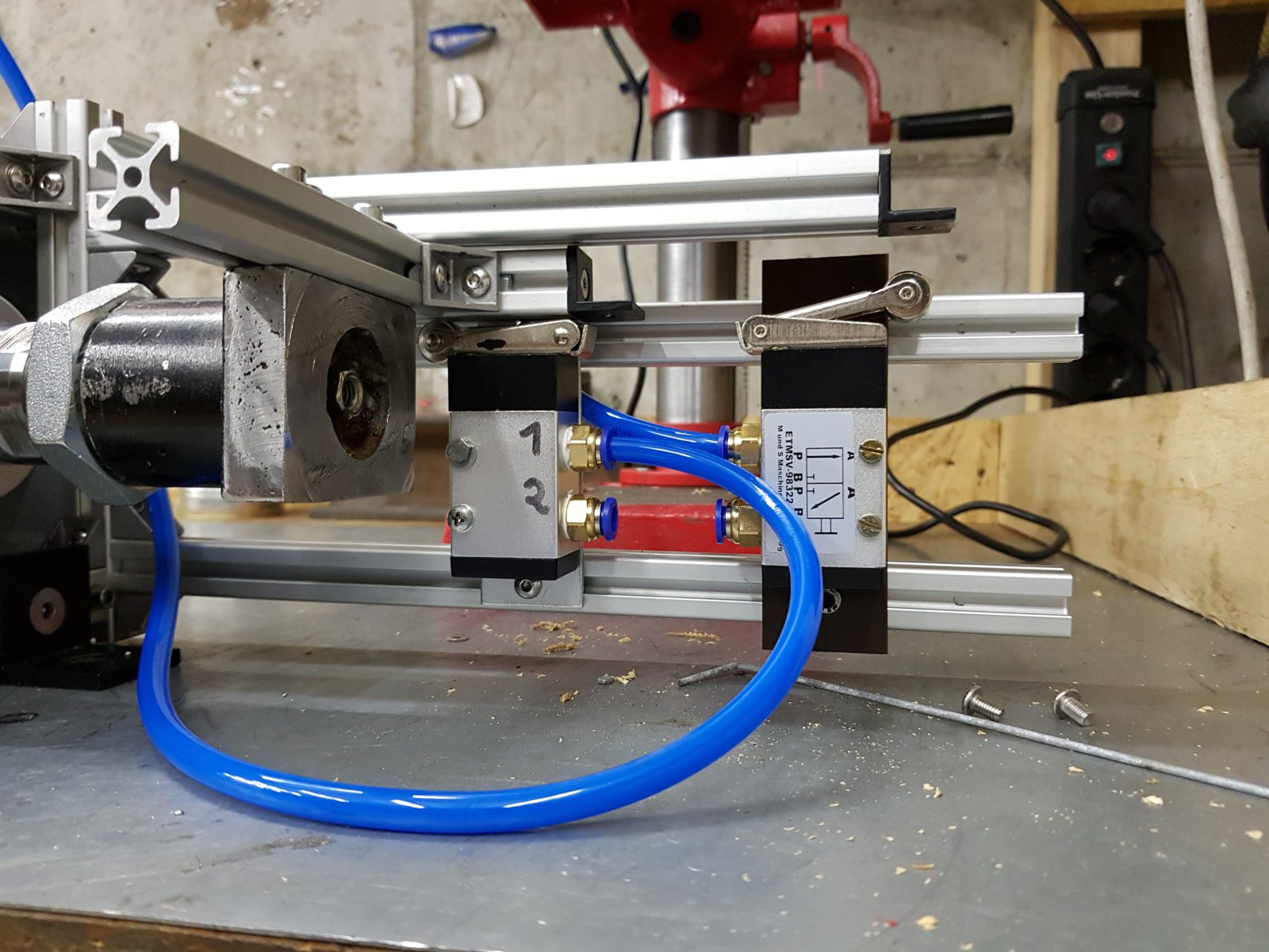

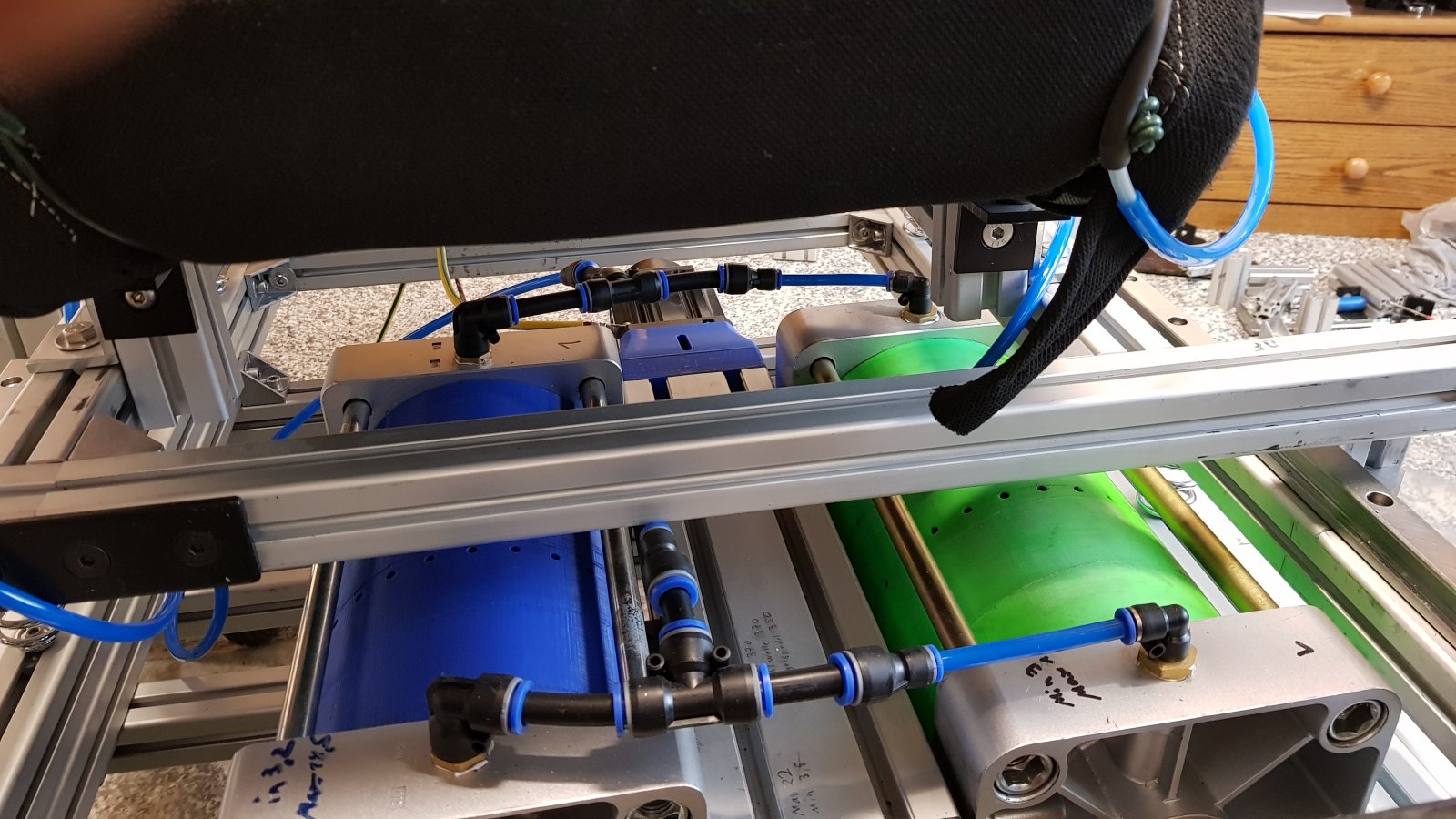

    have done modification with a second switched valve to vent bags faster, respectively to have in middle position both sides guaranteed vented.
  2. Gadget999
    2,020
    12,331Coins
    +497 / 11 / -0
    can we see vid of it all working pls

  4. Gadget999
    2,020
    12,331Coins
    +497 / 11 / -0
    ok i understand what is going here - the piston volume is greater than the bag volume
    looks like it works pretty good :)

    what hose diameter are you using? how about the Tube Fittings, any brand? I have a similar setup and my problem is air leaking.

    hose diameter is 8mm, ordinary fittings from ebay no special brand. This is a open system puts atmosphere pressure to each cylinder side, refill it, in every middle position.

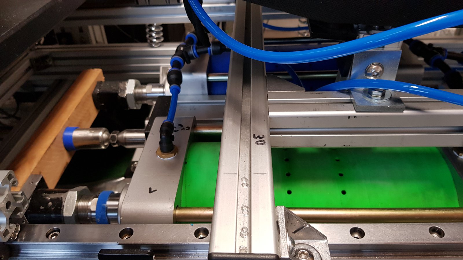

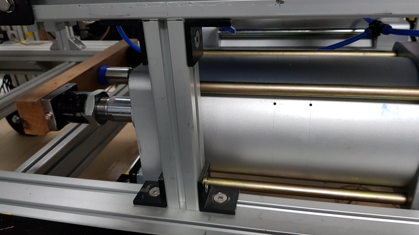

    have built a another version no external valves, using 3D printed tubes with venting holes in the middle.
    20211104_104345.jpg 20211104_104345.jpg 20211104_104305.jpg 20211104_104245.jpg

    did you make your own cylinders - did you use the old pistons ?

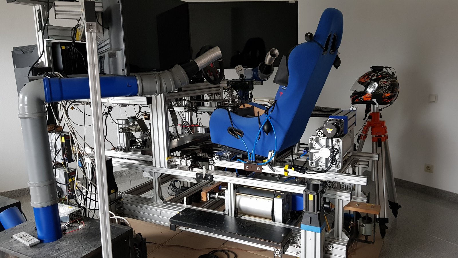

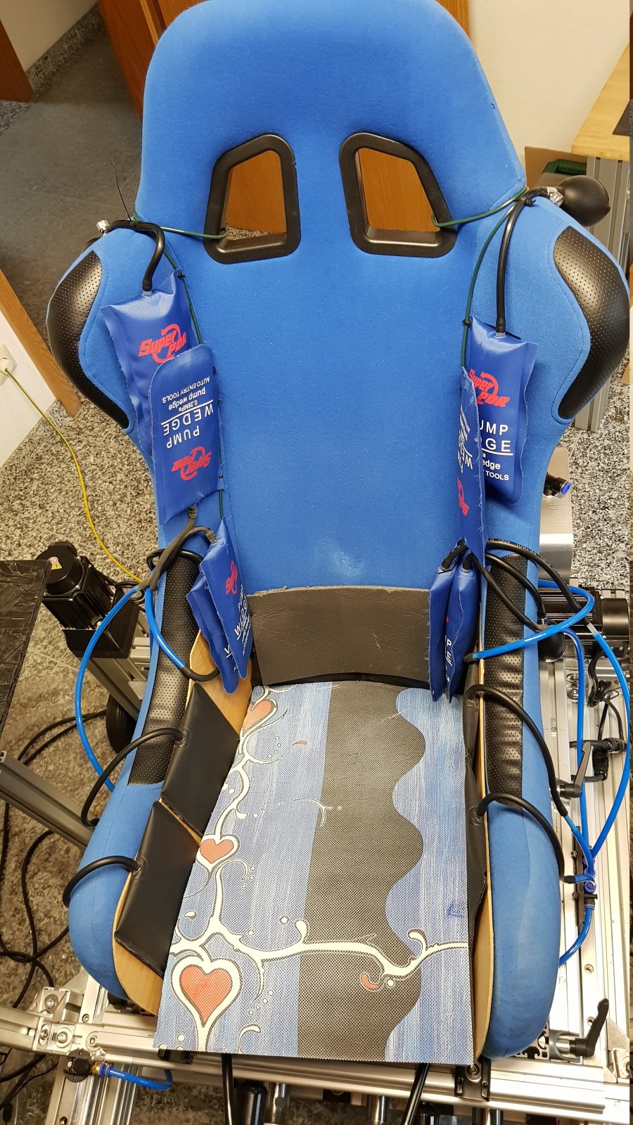

    I have expand it to simulate acceleration with 2 pads in backrest.

    just a seat update

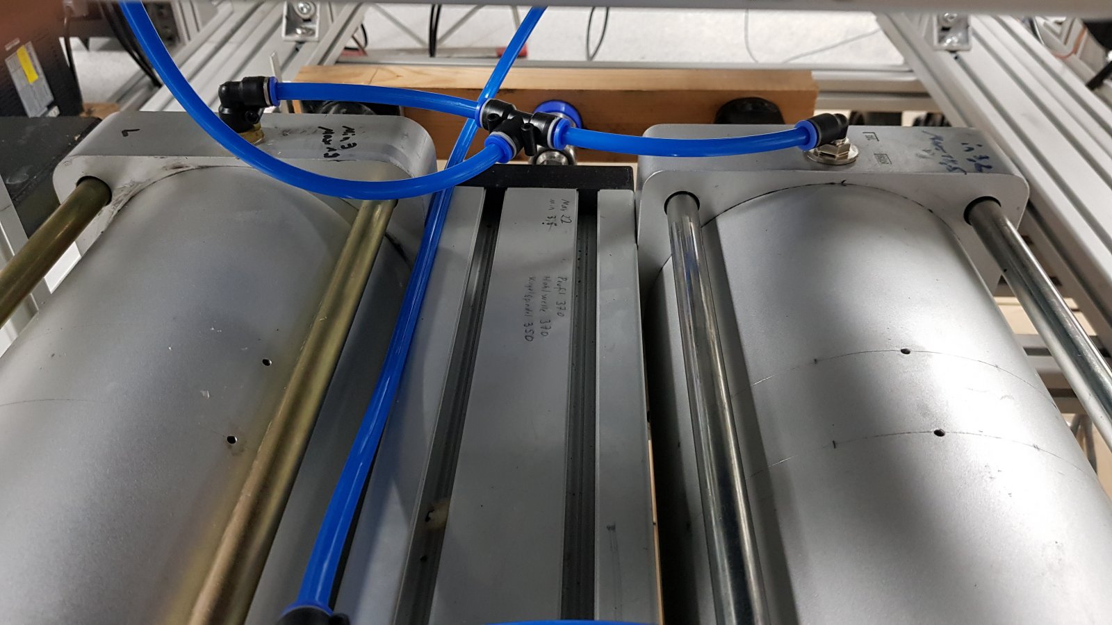

    after a long period of testing and a split in a 3D printed tube, replaced with original tubes with tiny holes (4x3mm), given more boost. lateral_tubes4.jpg lateral_tubes2.jpg

    Where did you get the cylinders from ? Are they pneumatic parts ?

  15. Terje Helle
    Terje Helle New Member Gold Contributor
    Mar 28, 2020
    11
    138Coins
    +7 / 0 / -0
    My mind just got a little bit blown when I saw this.
    How do you feel it works? Have you any other motion on your rig?
  16. wingert
    wingert Active Member
    Aug 10, 2020
    129
    738Coins
    +100 / 0 / -0
    4DOF
    it gives you a kind of pressure driving curves.
    Yes, a plattform mover SFX100 for suspension plus a front surge for braking, plus a airflow in back of seat for acceleration.Also for open cars a wind system for speed.

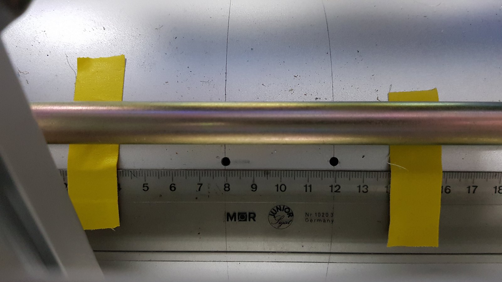

  17. Rainer Stehl
    Rainer Stehl New Member
    Feb 2, 2023
    38Coins
    I am trying to build one similar to yours, but only with 2 450ml pads per side.
    I don't know how thick is the piston of my 160x100mm cylinder.
    Could you please tell me where you exactly bore the 3mm holes from the middle.
    My thoughts:
    When I assume that the cylinder is 180mm wide and the hub is 99mm (that is what I am measuring at the end...theoretically it should be 100mm) the middle is at 90mm and the cylinder ends 40,5mm from the middle on both Sides.
    So I have to bore the 3mm holes at 40,5-1,5=39mm from the middle if I want to close the gap completely or 40,5-1,0=39,5mm if I want atmosphere pressure in the middle position.
    Am I right?

  19. wingert
    Aug 10, 2020
    129
    738Coins
    +100 / 0 / -0
    4DOF
    in my case the bores are 20 mm from the middle point, but this depends from thickness of the piston.
    The best method is disassemble the cylinder, measure the piston, so this is anyway necessary for burring the bores.
