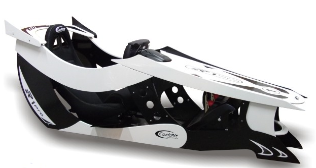

    I think that I'll make in this color

    Do you have plans of your cockpit ?
  6. stamer57
    stamer57 Member
    Jul 18, 2015
    33
    963Coins
    +27 / 0 / -0
    No, no plans. I built it according to my size.
