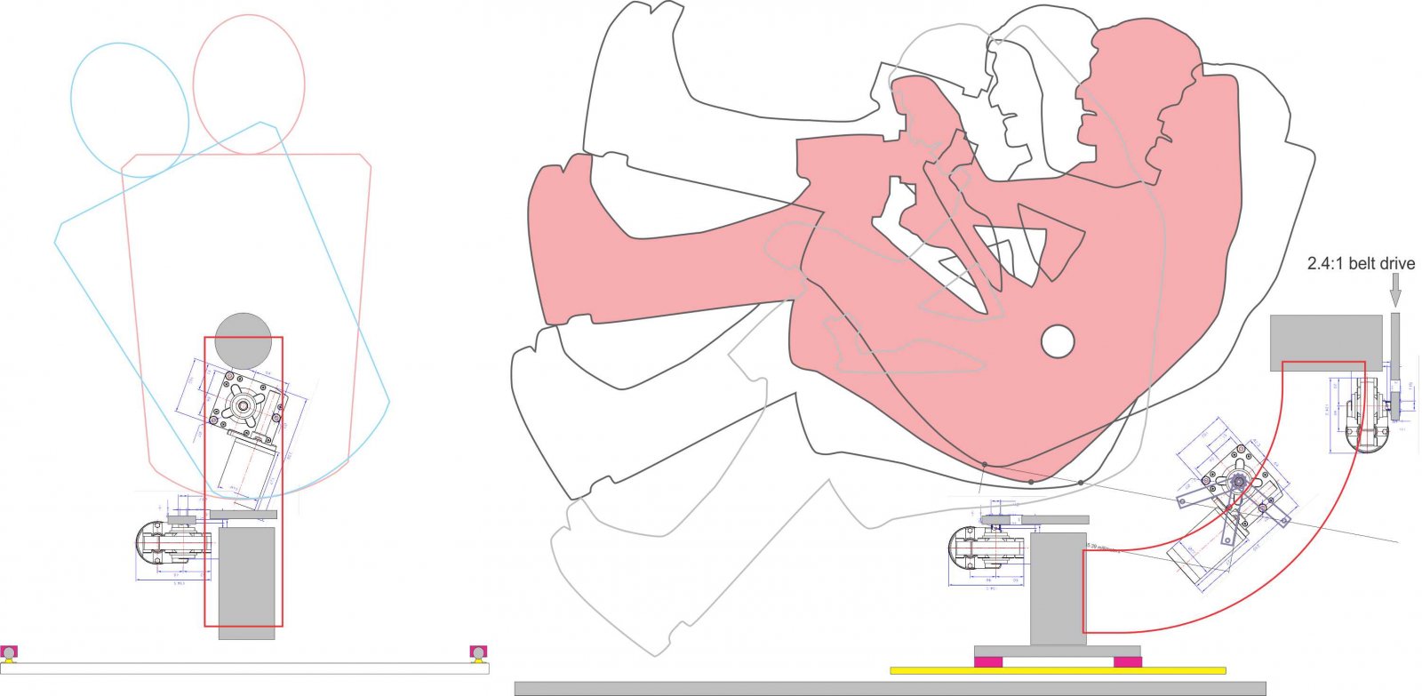

    Version 3 and more of my ramblings :p
    Really liking this one. Most likely change the pitch with levers to a belt drive mounted on the tuning fork, gets rid of the tie rods which, to me, are not very good. This gives me the ability to have 2 pots mounted so i can have one set up for the laid back F1 position and the other pot set for a more upright stance more suited to normal car and flight sim, just flick a switch to change. This version allows for a huge amount of yaw. It is also the most compact version except for a bit longer but the other advantages far outweigh that. Will need to get the shafts and bearing housings machined but that's a minor detail.
    Bugger i was planning a 2 or 3 DOF but now at 4 and traction loss will be 5 but it covers car and flight sims much better. :cool:

    having pivot above belly button would reduce it a bit, but thats where you would need more travel to overcome it
  3. bsft
    129 deg yes, but we are not moving as much weight as what that frame will need to have.
    Motion will vary from person to person, but even 60:1 boxes can give nasty motion as well.
    I am still conernd about the idea of using 25:1 boxes, you need more 60:1 or even 100:1 to move yours and I think you are going to use it for race.
    Our race sims have a smaller degree of angle of tilt, maybe 8-11 deg. I guess you are looking at 25-30 angle or more.
    You may not quite get the jittery motion us seat mover boys get because I think you plan to use a larger range of travel with the motors.
    Did I make sense at all?

    2.4:1 ratio with those motors would give about 50 degrees of motion with an input of 120 degrees. As it is I would most likely use 50 - 54 degrees for roll and about 40 for pitch with an offset of 20 degrees for the more upright setup.
    This thing won't have much weight. A carbon structure would weigh a lot less than steel and be stiffer, i will calculate the weight of it later. I know a composite construction engineer that has done a lot of work for the boat I am building, will see if he can plug the numbers into his F E A software and come up with some stresses.
    If i want less travel and more power i can always change the belt ratios so having 25: gearboxes shouldn't really matter. I could use 5:1 and only get 25 degrees total movement but i think, knowing me i would double up on motors, must be related to Tim the Tool Man - more power. :D

    ok, carbon structure, thats good.
    My concern is the power of the motor needed. If your mate can, get him to work out the power needed to swing a person from full tilt forward to full tilt back and also from side to side.
    As said, your design is similar in concept to a rock n ride, but if you can change the design somehow so it will swing a person around without much effort , you will be fine.
    http://www.acesim.com/main.html this sim doesnt need motors at all and once it is balanced right, you can move it with your own weight easily.
    If you can get your concept frame to move as well without motors, you will make the job a lot easier.
    Unfortunately, I am no engineer so I dunno anymore on how to do most of this.
    If you have a friend whom can work it out, for sure have them help.
    Ah, just one question though, what belt ratios are you talking about?

    I wouldn't call him a mate, he has done the design and engineering on the masts for the boat, and a few other bits and pieces, he comes from an aeronautical engineering background. I have helped him with some electronics problems when he was constructing his filament winding machine. I have also come up with a few ideas for design of machines and construction methods that he has adopted. Now we seem to have quite long chats about our toys and stuff. Biggest problem he is in South Aus and I'm in W.A. so not real close in more ways than one. Called him this morning and he is off over seas on a consulting job for 2 weeks so it will have to wait.
    When you say the seat shakers only have 8 -11 degrees of movement is this total or each side of the neutral position. This is why i was trying to find out typical angles before, this then becomes an easily comparable measure. Length of arms also depend on angles of movement of the motor shaft and the distance of the mounting point on the seat from the pivot point, gets a lot more complicated to compare rigs. If the typical shaker only has 10 degrees of movement then i will change my belt ratios to reflect that, i assumed it was a lot more and was aiming for about double.
    I would think power wise it should need substantially less than a seat shaker, for the same amount and speed of movement, as the pivot is a lot closer to the 3D CG. That last link shows how little power is needed when the cg is correct 3 dimensionally. At the moment i have no real idea as to where the CG would be when adding the wheel, pedals and seat, care to take a guess.
    The belt ratios i refer to are the gearing from the dc motor to the bearing shaft. I drew them as grey rectangles at the back end of the main bearing mounts. If I want a slower or reduced motion i can just change the pulleys to get anything i want, the ratios of the worm boxes becomes a little irrelevant although starting with a taller ratio makes it impossible to speed it up so 25:1 is probably ideal.

    Wow a huge thanks for that bsft
    so it seems top end movement is 20 degrees total then, I was a little worried about the possibility of falling out of the thing with 54 total for roll :D
    Bottom end 10 total or even a bit less.
    I think you use the Motion Dynamics 200W motors. How many degrees of the output shaft do you use, that tells me the speed.
    That would give me enough to finalize the ratios.
    At this point in time I will aim for 20 total over 120 degrees of the shaft for all the axis.
    Sounds like a plan

    Despite the intended carbon structure I would suggest going with the 50:1 or 60:1 gearboxes, as I found the additional weight of hefty controls made a significant difference and was more than the 25:1 could handle.

    A 150 rpm 25:1 box with 50mm of travel and 40mm CTC lever will move over about 80 degrees in .1 sec so top speed would be around 500mm/sec and you run it at a lower speed so i could probably use a bit more angle, back to 120 degrees this would be a time of .13 sec. I will set that as a data point.
    Now to angles of rotation -
    54 degrees of roll seems huge for a racing sim but not too sure about a flight sim, need more research, maybe 30 total. I think i may need a bit more than a seat shaker as i have reduced head movement with the shift in CG, huge assumption here :D.
    Was aiming for 40 degrees of pitch and the belt system would allow me to electrically move the center to a bit more upright for air and car syms, love that feature. Maybe reduce this to 30 total again plus 10 degrees of shift.
    120 degrees of motor to 30 for the victim gives a belt ratio of 4:1. Hopefully the angular velocity will come out similar to your usual settings. If i have stuffed up then i get to buy 2 more pulleys :oops:
    Would build it ready to take the yaw axis and set pulleys based on the result of the other 2 but probably the same. Really need yaw for landing approaches in cross wind.
    Surge could be 2 pulleys and a belt. Use the same times and motor angles with pulley sized for 300mm of movement. Too much?
    Traction loss comes later, brain tired :confused:.
    bsft and beast
    Will go for the 25:1 boxes as it is easy to change gearing to a higher value which would trade off motion or speed and give more torque if i need to. Starting with 50 or higher ratios i can't go back the other way without replacing the boxes.
    I am convinced that the higher CG will reduce the power needed to keep to my numbers but then i have been known to stuff up occasionally and i can always add more power if I have to.

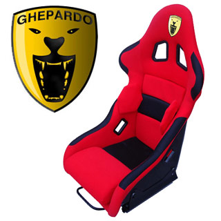

    baja buggy seats about 3KG I think
    I use a racingseat, bought cheap , weight 9kg.
  20. MikeG

    9Kg is not bad. They look a lot heavier than that.
    searched for the baja seats and i think 3kg is unpadded.
    Thanks for that. I can't use a commercial seat as it needs the reinforcements designed to carry the pitch pivots, but i was curious. Target at 5KG still then.
