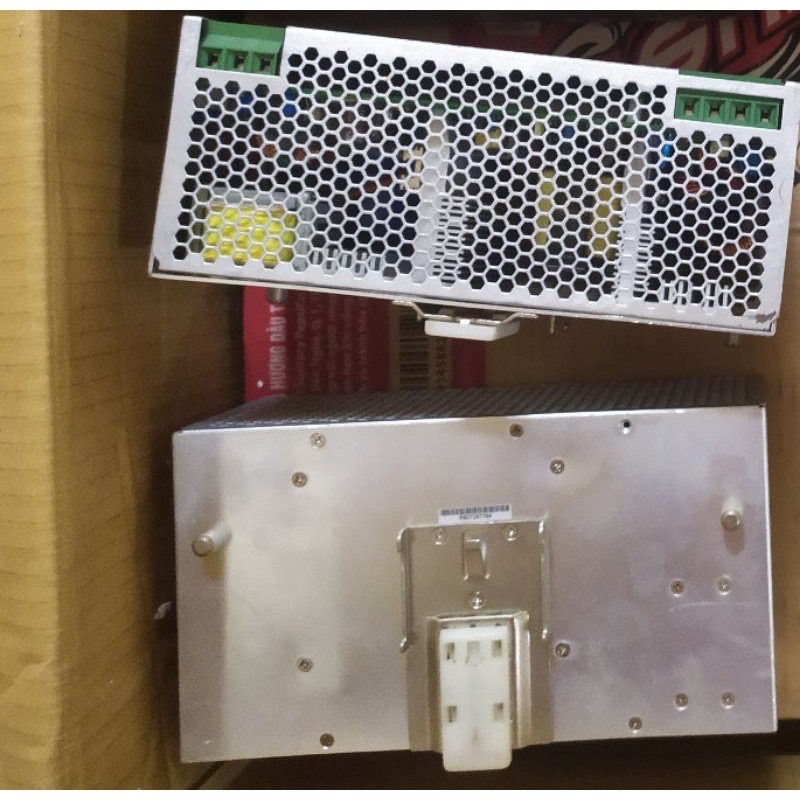

    Hello @scruck , I am started to build my own today and very interesting in your project. Just ordered the parts seem with you. I have a question about BTS7960, what is the voltage you use? Is it 24v, if that do you have any solution to protect the feedback current going to burn the BTS? I have read the thread you have mention, He supplies power just 18.5v but my power supply does not support adjusting the volt, it fixed at 24v. Thanks.

    There is no reason, to protect the source of the feedback you can put some diodes, on the modification of the source, which source do you use? PC ATX? to send you a video to modify ... you can even put a potentiometer and make it adjustable ... a greeting

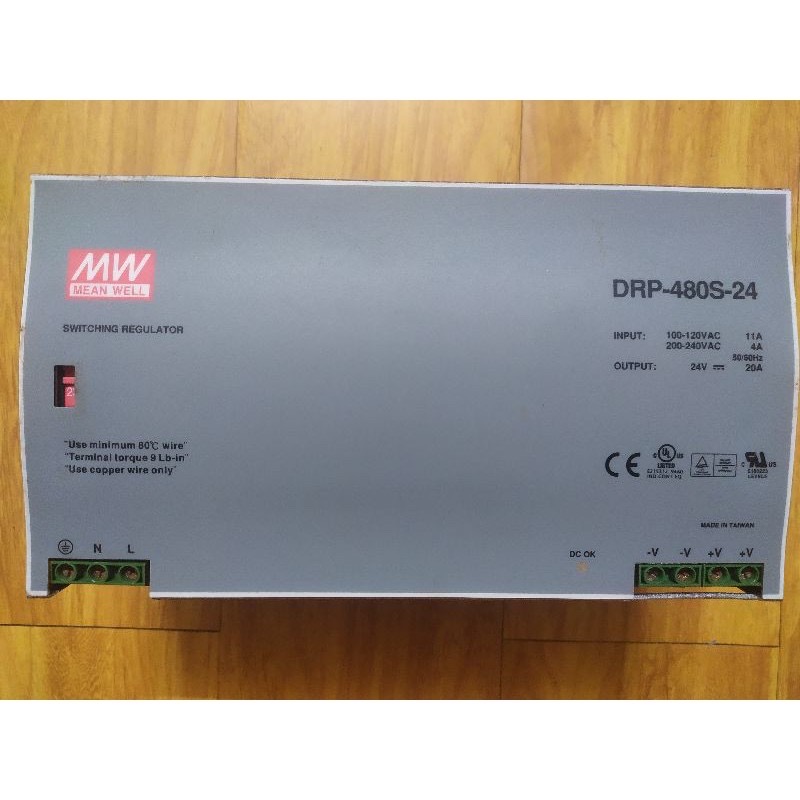

    Hi, I am ordered Mean Well DRP-480S-24 (2nd) on the local shop in my country. So is the modification required? Thanks.

    I fixed the images.
