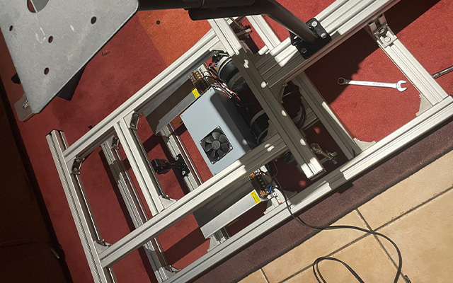

  14. Quang Thuy
    Quang Thuy New Member
    Nov 30, 2021
    14
    87Coins
    Thank you very much for the detailed instructions. I'm trying to do it your way. Hope to be successful.

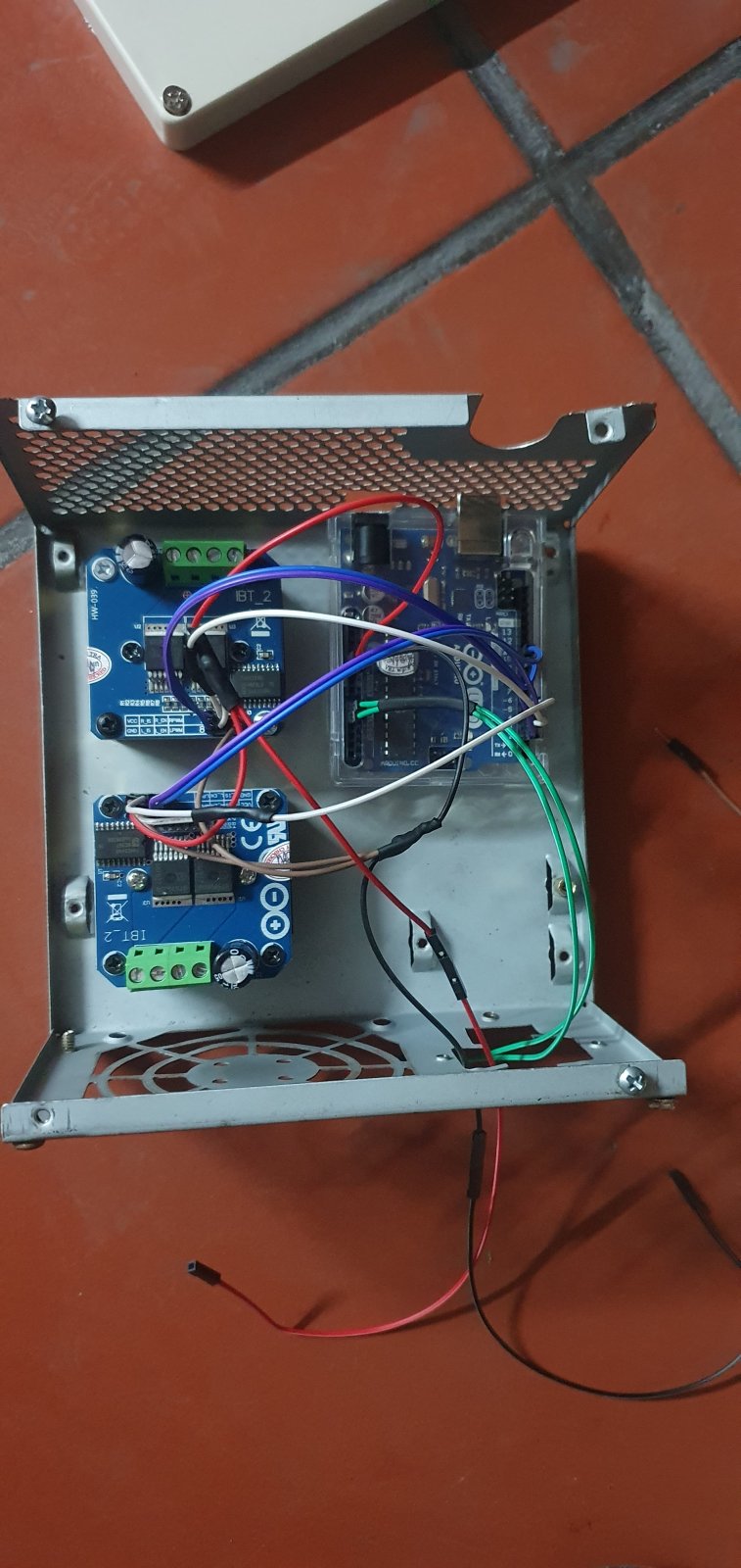

  16. Quang Thuy
    Nov 30, 2021
    14
    87Coins
    I'm using an old power supply as a control box, adding 1 fan. Do I need thermal paste for the controller chip? There are a few cases of burning, I am very worried.

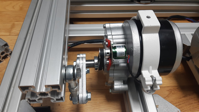

  17. scruck
    scruck Member
    Jul 18, 2019
    31
    España
    447Coins
    +73 / 0 / -0
    Gears and belts are MXL, belts are 200mm overall length, 20T and 40T gears, 40T gears have 17mm inner clearance perfect for my motors shaft
  18. scruck
    scruck Member
    Jul 18, 2019
    31
    España
    447Coins
    +73 / 0 / -0
    better 2 sources, since having one you will force the source and apart from the fact that the fan will bother you, you will get more temperature
  19. scruck
    scruck Member
    Jul 18, 2019
    31
    España
    447Coins
    +73 / 0 / -0
    I do not use paste or fans, so yes, lower the voltage of my sources to 18.5V to avoid overheating
  20. Michail
    Jan 5, 2022
    176
    748Coins
    +33 / 1 / -0
    Hello from Germany, I would like to ask about the Alu arms for the motor. I am a bit confused, in the DWG file is showing 10mm Alu and for the small part 5mm.
    In the video and the picture below it seams to be 2x 5mm for the arm and 5mm to fixed with the screws. Do you use 5mm for the whole project and put 2x5mm instead of 1x 10mm width?
    Is this correct that we need 5mm only to fixed the arm, and 10mm width for the arm it self? So for 1 motor 1 handle (10mm) and 1 fixing part 5mm?
    I would like to purchase by the local dealer and we are confused. I also want to ask, if 5mm steal is enough for the arm.
    Thanks.
