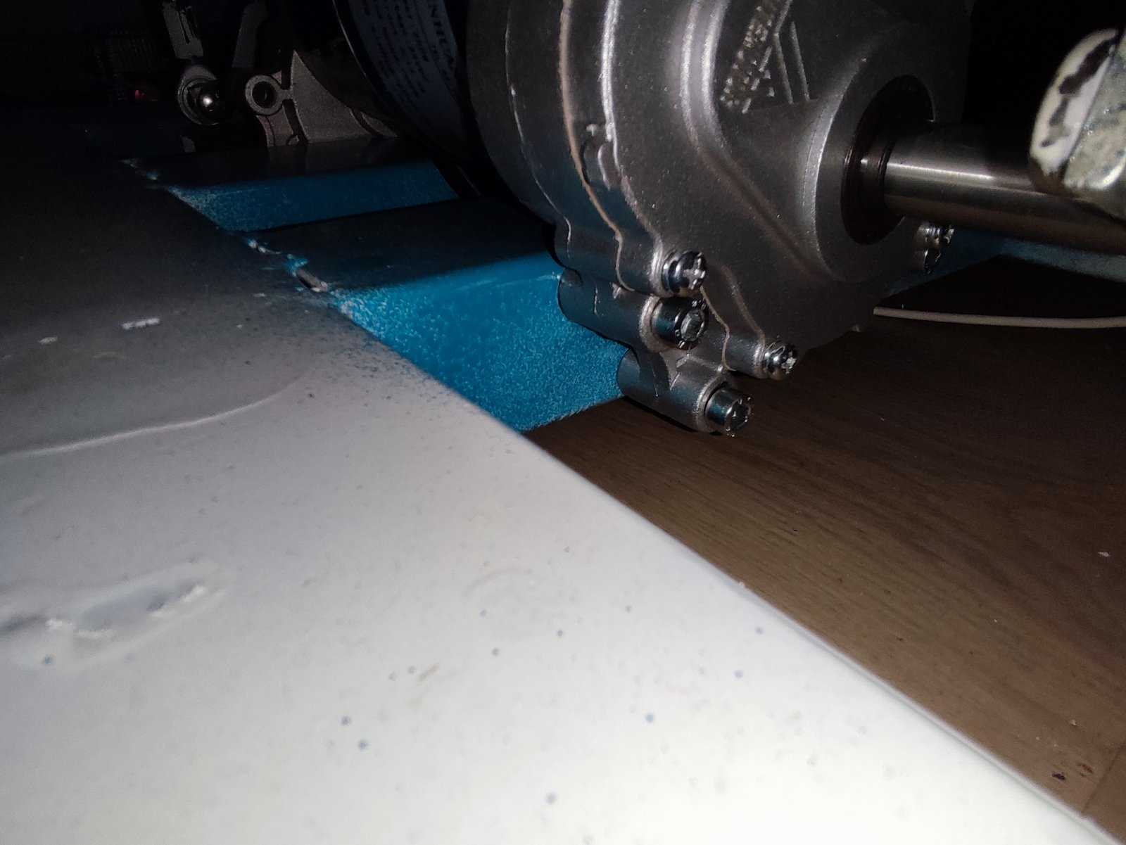

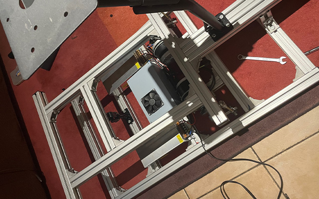

    2 x 10mm for motor arm, in the image you see two because where they cut by laser the maximum thickness of the aluminum was 5mm, so I made two for motor arms and then joined them with screws.

    So I need only 10mm without the small parts in 5mm?

    You need the 10mm cams and the small 5mm cams to attach the 10mm cams to the motor shaft, in the image there are 2 cams joined because they are 5mm and to get the 10mm I had to join them.

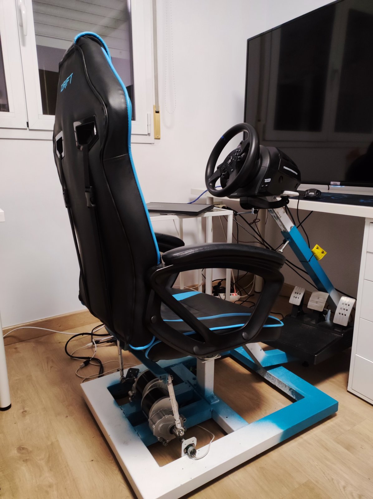

    Very good tutorial, I have been able to make my simulator thanks to how well it is explained, explaining every last detail.

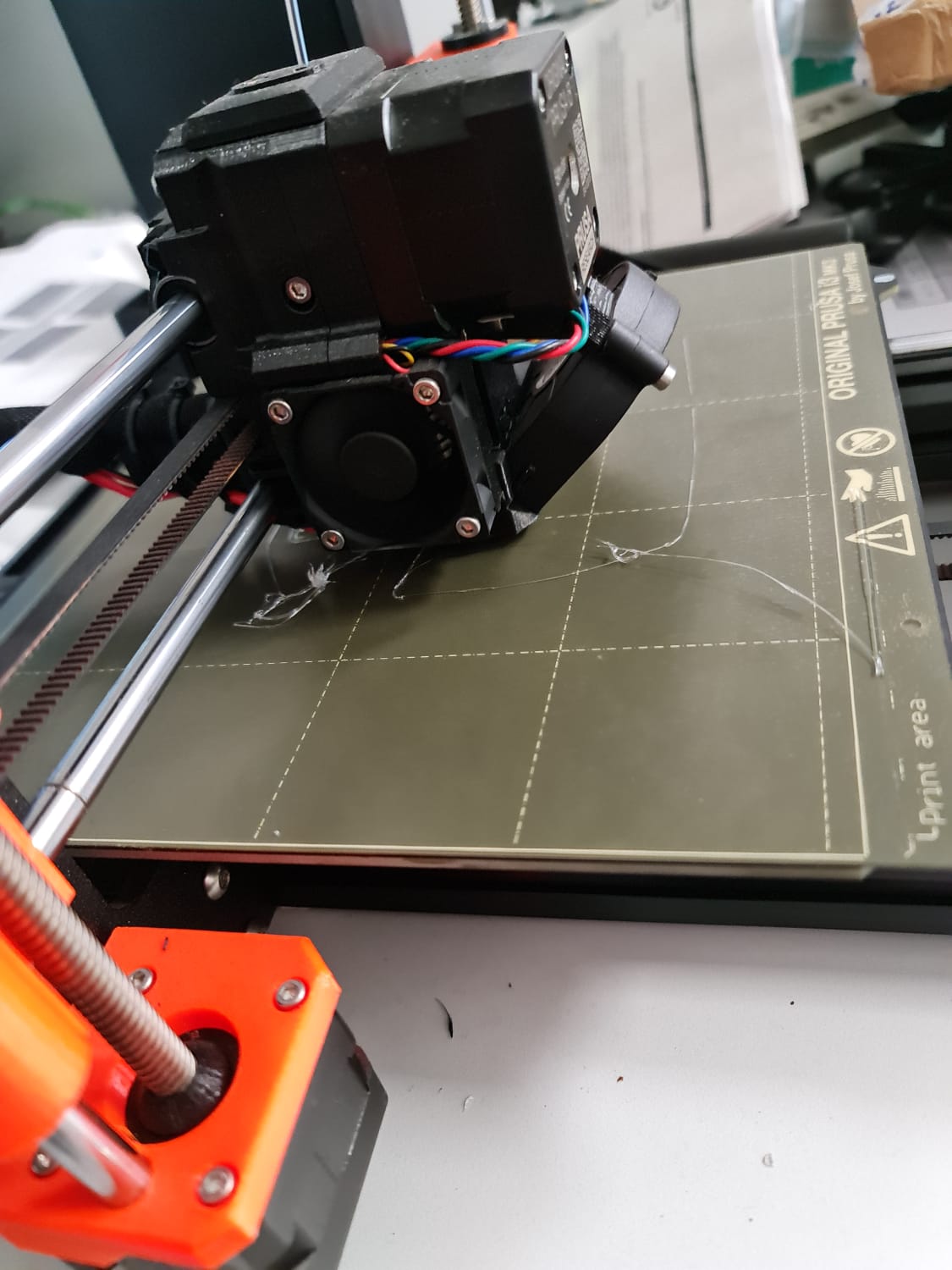

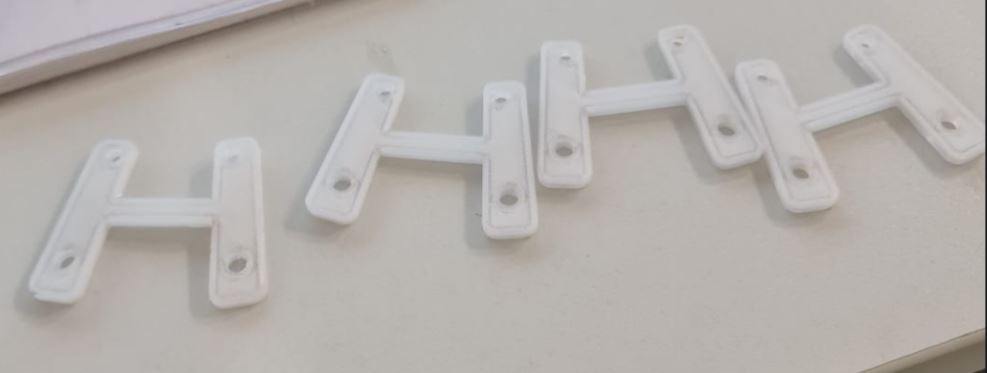

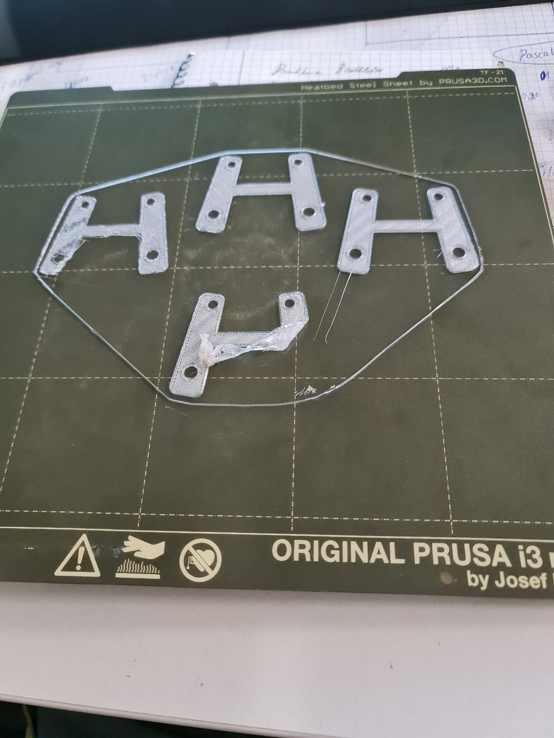

    Something is going wrong with the STL file.
    May you can give the amount of infill and material, we have PETG not PLA? Thanks

    hello, I print in ABS and 100% infill as they are small pieces.

    Unfortunately something is going wrong, can you post your print settings ?
    we use a Prusa MK3S printer.

    After recalibrate the Z axis, it seams to be ok!
    Thank you!

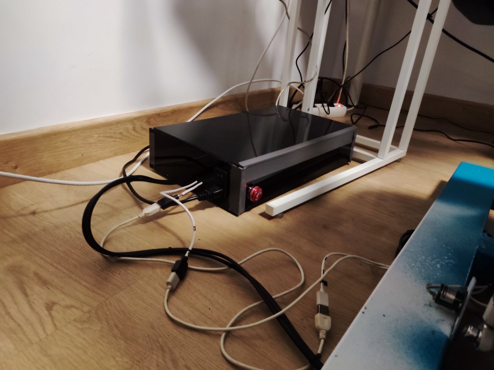

    Hello Again, the Power supply which you have linked on your Website (24V 480W) have at the left a screw which you can adjust the output voltage over a potentiometer between about 16 and 24V (measured in idle). Is this not enough?
    And i want to ask you wich mm² cable for the motors and for the sensor do you choose, aswell which kind of
    heat shrink tubing in size do you have use. Thanks I will start today with the Arduino and SMC3 etc. THANK YOU for your tutorial.
  11. Rull
    Rull New Member
    Jan 6, 2022
    12
    - 66Coins
    +9 / 0 / -0
    2DOF, 3DOF, Arduino
    Hello good afternoon, the power supply has a potentiometer where you can adjust the voltage between 18v to 26v approximately, it is valid for that motor, the motor is 250w and the power supply is 480w. As for the signal cable for the potentiometer, with a 0.75 mm cable is enough, as I said, I used a cable from a mobile charger, because the current intensity is very small. And regarding the thermotractile tube, when you get the cable you will have to see it in an electronics component store because it depends on the diameter of the cable you are going to use I can not tell you exactly the diameter you need. I hope it helped you. Greetings.

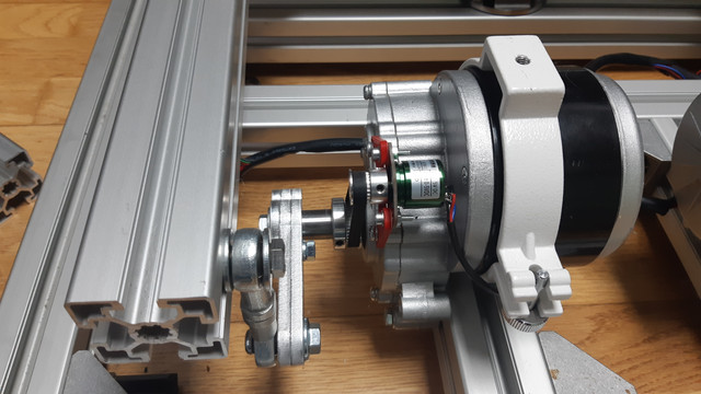

    Hi , Can you tell me what size are the Rod ends you use?
    looks like M8 or M10 but it looks a bit fragile to me , I was thinking of getting minimum size M12

    I used M10s on my compact rig, which has relatively small deflection, but the more robust the better and M12 would do fine.

    Hello, sorry, I have not noticed your last message, it has not reached me in the mail. But I put 10mm threaded rod, but it all depends on the distance between rings and the diameter of the inner hole of the ring, mine is 8mm. Greetings.

    nice build what motors are you using?
