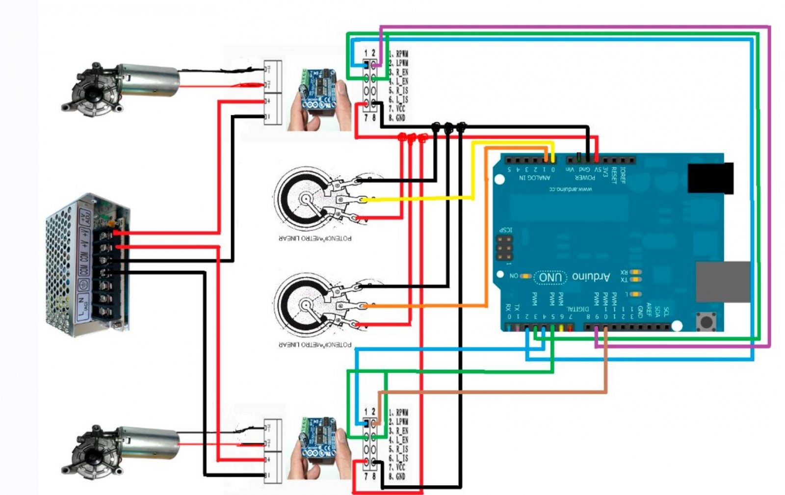

  9. tsamt
    tsamt New Member Gold Contributor
    Mar 31, 2022
    - 102Coins
    This is an exciting article, learned a lot, I want to know what the circuit diagram looks like? Could you send a detailed wiring diagram?
    thank you
  10. SaintFrank
    SaintFrank Active Member
    Aug 14, 2021
    100
    Proces operator
    Nederland
    232Coins
    +39 / 0 / -0
    2DOF, 3DOF, DC motor, Arduino

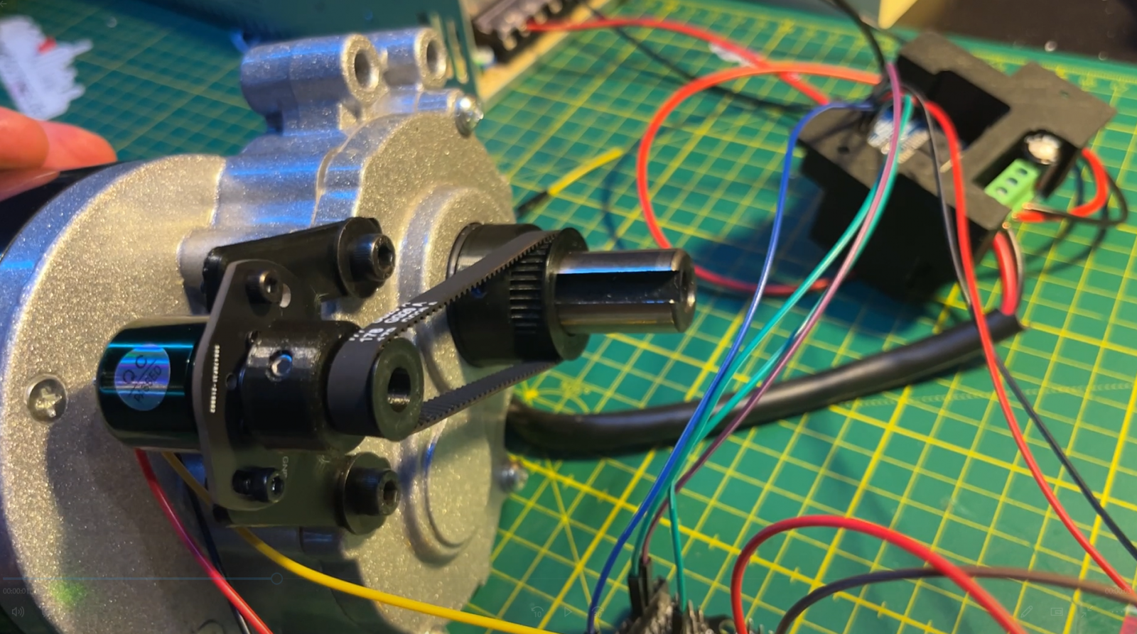

    Since I didn't want to order pulley wheels from China and they were really expensive from amazon I went ahead and 3D printed them, so far it works like a charm, will see how good they cope on the finisshed rig...

    This thread is a gold mine for me! Thank you!
    I've ordered two wheelchairs motors that seem to be very similar to those in your videos

  20. tsamt
    Mar 31, 2022
    - 102Coins
    This is a very good teaching case, but I am not a good student. I made a mistake in wiring. Could you send the wiring diagram again?
