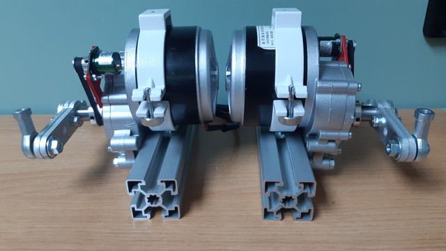

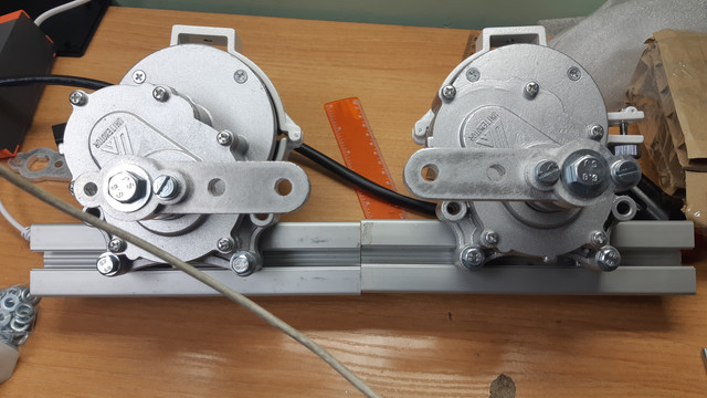

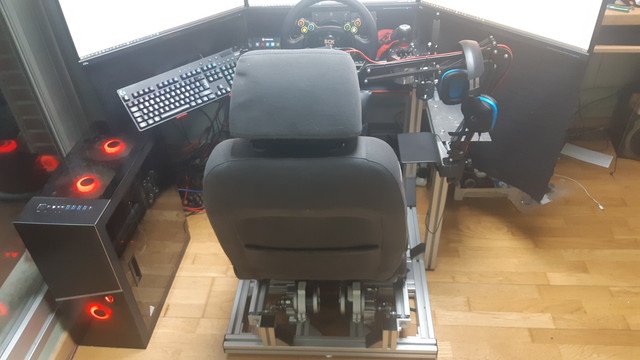

My finished 2DOF project (VideoTutorial)

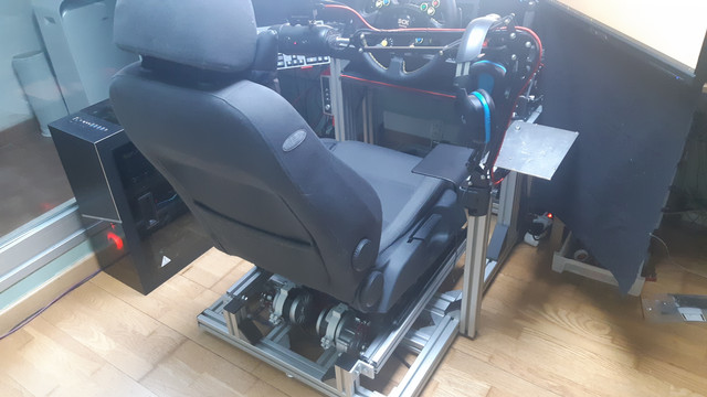

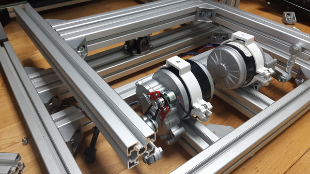

    did you use these aluminum profiles for ease of assembly or because they are sturdy? I know they cost a lot, to save money it would be better to use tubular iron or would the structure be less robust?

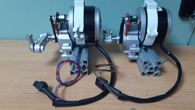

    Good job scruck. I'm from Mallorca, I'm working on a project similar to yours and I have doubts about the motors since I want the entire cockpit to move. Do you think these motors would move the entire simulator?

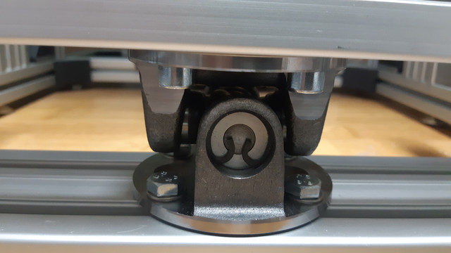

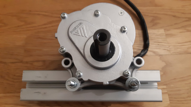

    I bought my universal joint, assembled it with a hammer, hitting it with an aluminum dowel, and the locks that come with it I put on with needle-nose pliers....

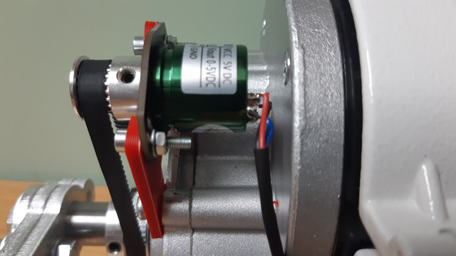

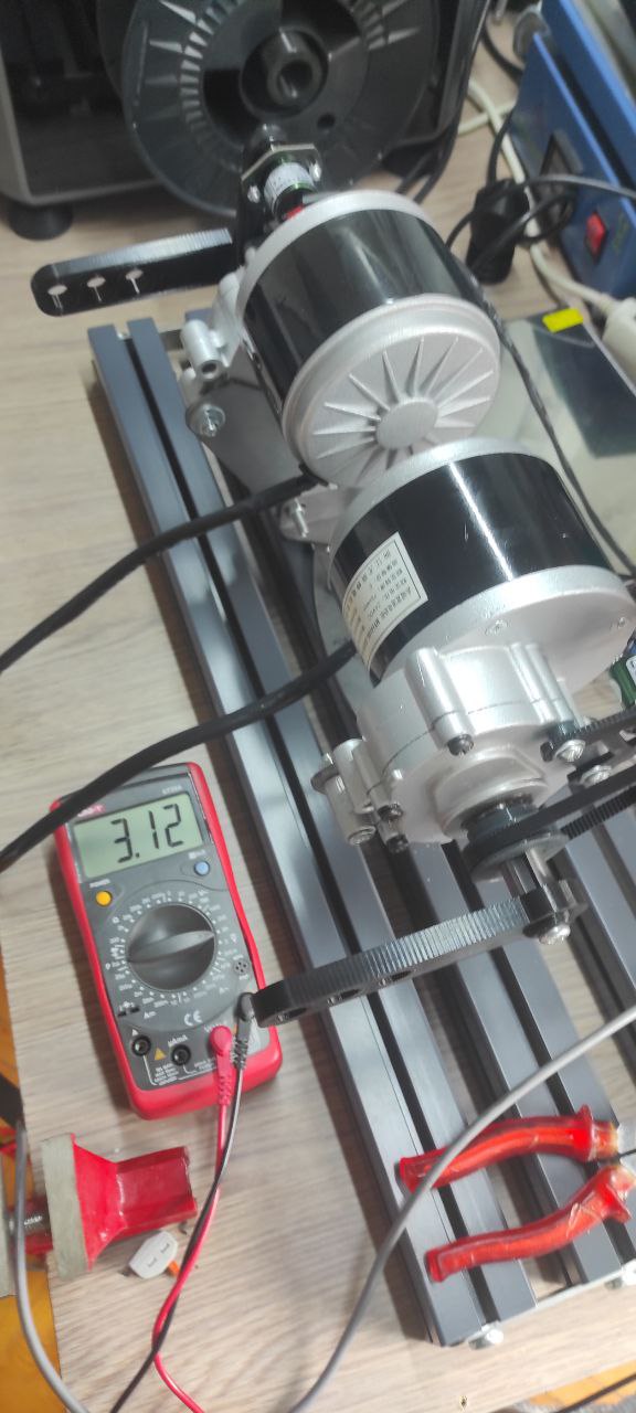

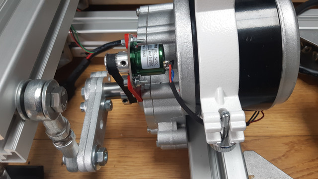

    Hello I have one question, and I'm new in this. I agreed all the instructions. I see that Hallsensor is at 2.425V to me is at 3.12V. Maybe I missed something? How can I adjust to 2.5, to reduce it by 0.5V? Do it even bother it if it is on 3.1V?
    Sorry for English I use translator thanks :)
