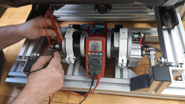

    The Hall Sensors I use are 4.5v to 5.5v: https://au.element14.com/bi-technol...fs/sensor-hall-0-2v-20v-to-10v-pin/dp/2319662
    What are the brand a actual published specs of the ones you use?

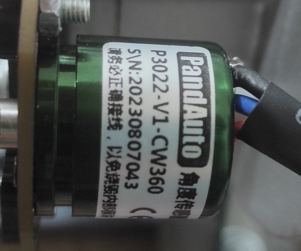

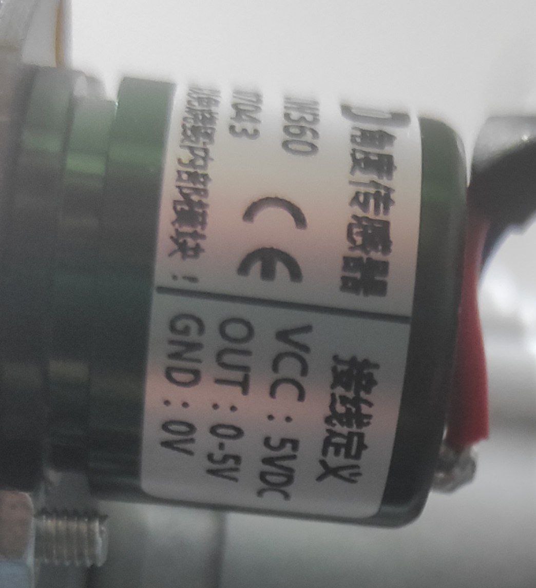

    Hi man i have sensor on picture.

    Yes 0-5v. Half would be 2.5v approximately. To me, Out- gnd is 1.72V and VCC-Out 3.12V. So its total range is 4.84V. What does it mean to me that in half to me would be at 2.42V. I wonder how to grasp that when I start everything he is halfway through 2.42V. And if that is possible at all. I would like to get values as in the picture (on the first side) upload_2024-1-3_22-54-53.png
