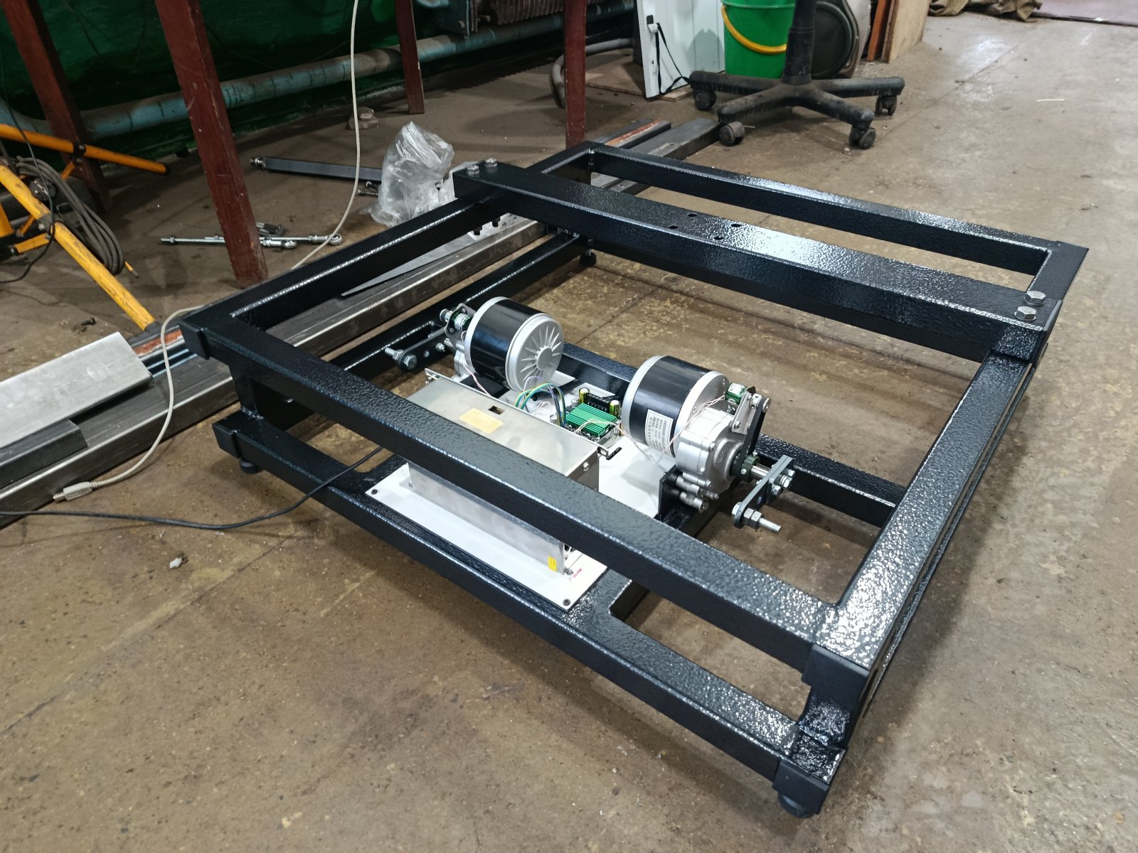

    Hey! Congrats for your project. Just one question: Your recommended motors come in 2 options. One states electromagnetic gear and the other "ordinary". Which one have you used? Tia.

    Hi, I'd like to build a new simulator for my brother. He lives in an apartment, so your compact simulator would be great. I'd like to use your work as inspiration if that's okay? If so, could you please give me the dimensions of your simulator and the power of your motors (I think they're 150W)?

    And where did you find the ball joint under the seat?

    Thanks to this topic, I started building my own 2DOF simulator. I used the same motors and sensors as the author, but a different H-Bridge. I am very satisfied with the bridge, as it has a large power reserve and is cool.

    im trying to make 2DOF as you shared but i have a question about motor.
    does it have to be 75rpm? or can i proceed with higher rpm like 100~150 ?

    You shouldn't use motor reducers with a high number of revolutions. Even 75 revolutions per minute seem excessive to me. Using motor reducers with a high number of revolutions, you will lose in torque. These motors are very powerful and fast. Even excessively fast. I lowered the settings in the control program, as with sharp movements my head tries to come off my body ;-) With a sharp change in direction, the platform even jumped.
