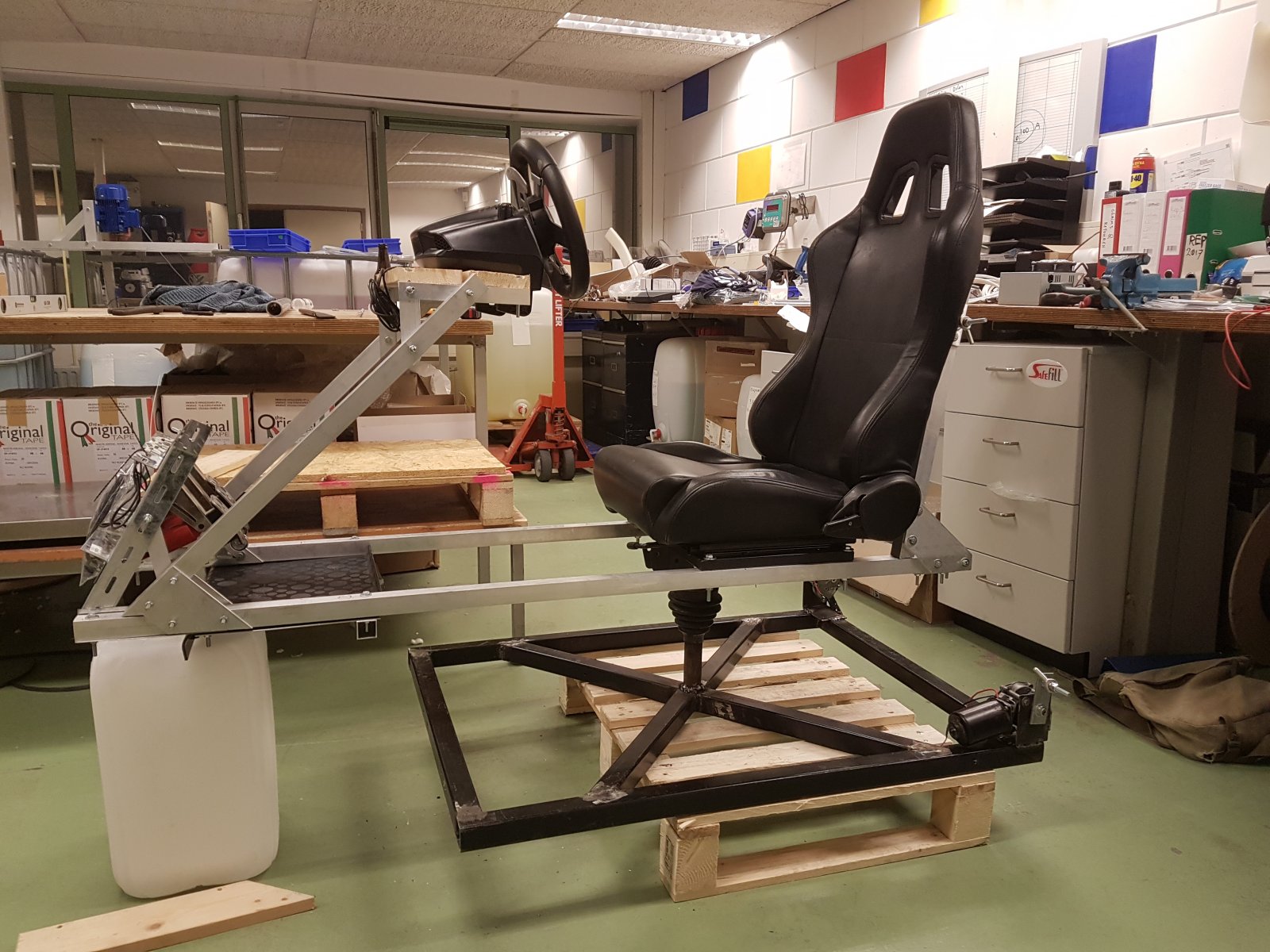

    First, the COG was determined. @FargusFaustmeister ...sorry I didn't check the COG shift with different people.
    We will find out how the seat-shifting will work when the apparatus is up and running.
    I took an thick Aluminum pipe, like 60mm x 5mm. Put it 90° under my rig.
    @Pino Pistolidas pushed me back until I flipped backwards.
    After a few attempts it was quite clear where the COG was/is.
    It surprised me that the COG is more to the front than I expected.
    Normally I game with nice, soft, smelly "old man slippers"...Now my balance was checked with some heavy army boots. (1,5 Kg more on the paddles instead of 500 gr)
    So I corrected the COG with 2 cm backwards, not because I calculated ....just because of a feeling.

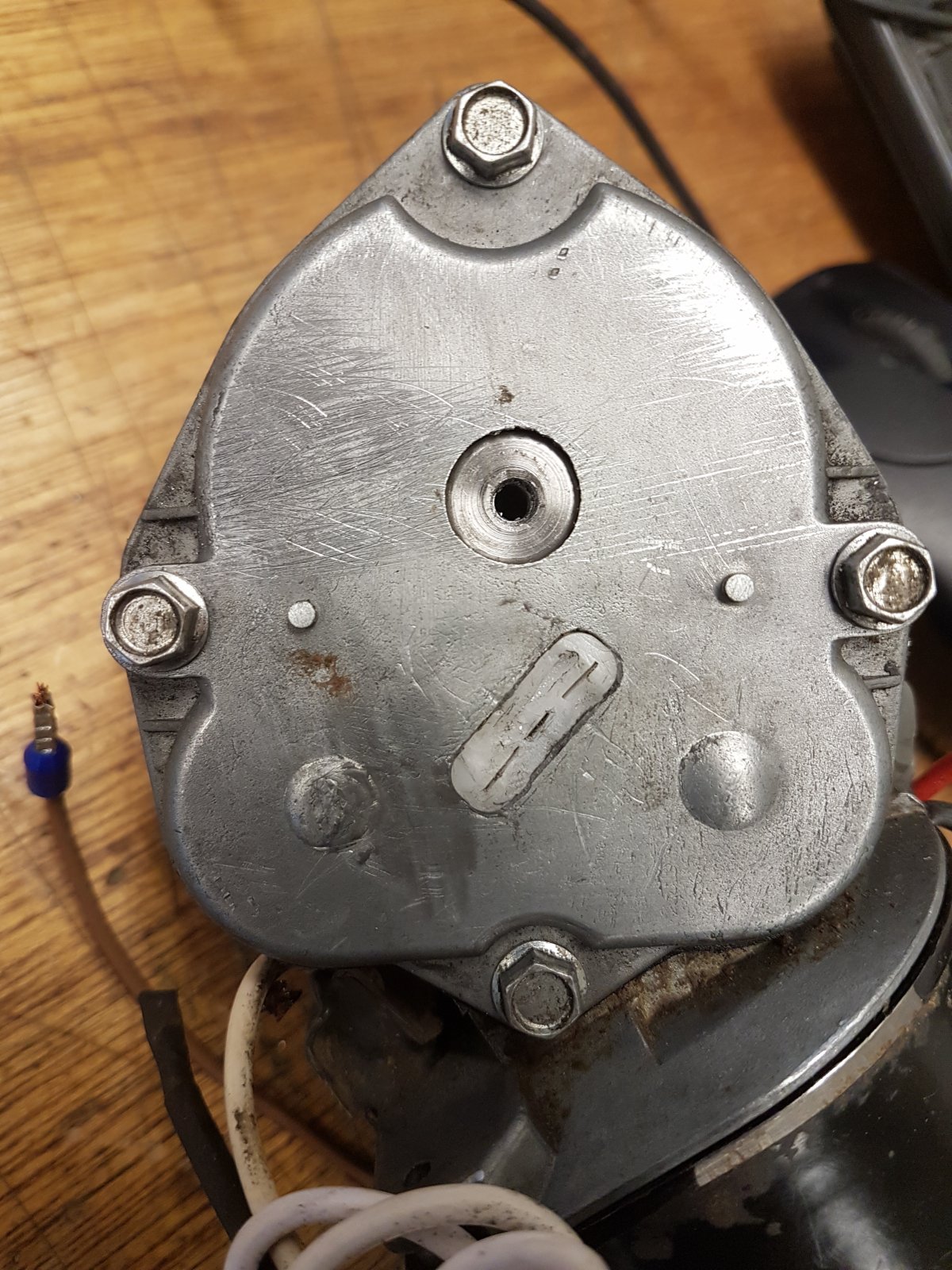

    As you can see the CV-Joint ( @noorbeast ) is welded and also the brackets for the wiper motors.
    As this point...(it was like 22:30) I wanted to see some movement into this thing.
    So I connect a 12V supply to 1 motor.
    Lets see what it does, and get a kind of feeling with the outcome :)
    Question:
    The angle between the wipers and the back, is it to steep? (20° - 30° to the front, 10° inwards....?) If I'm wrong, please correct me.
    I can lower the threaded point on the backside.....first try it like this, and then we will see.

    The pot's are mounted with an threaded M4 hole in back of the drive shaft.
    With a flexible connection, a 'non rotating' PVC tube (10mm x 6mm) between the back and pot (pic's will follow)
    Do I set them by hand in the middle position.....512 (0-1024) or ....5 Kohm (0Kohm-10Kohm) maybe .... 2,5 V (0 - 5V), and then install them?
    What will happen if my potential meter is turned to the MAX ( - or + )........And SMC3 utilis turns on?
    How to calibrate the Pot-meters?
    Can anybody explain this in layman's terms.
