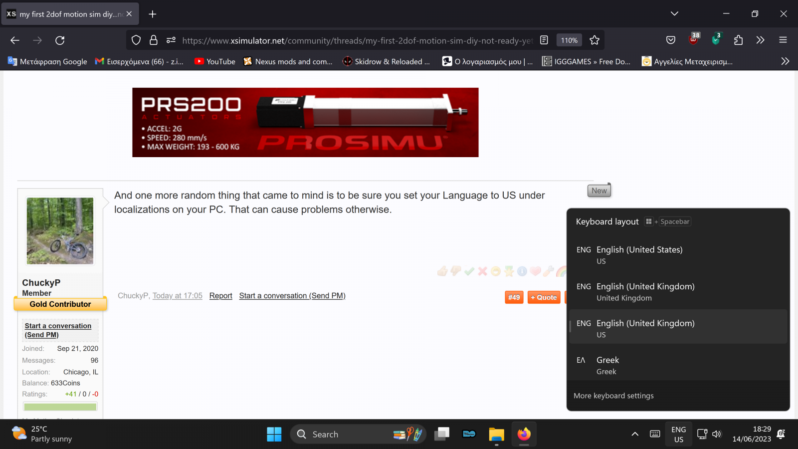

  9. ChuckyP
    ChuckyP Active Member
    Sep 21, 2020
    122
    Chicago, IL
    738Coins
    +65 / 0 / -0
    And one more random thing that came to mind is to be sure you set your Language to US under localizations on your PC. That can cause problems otherwise.

    hug:hug:hug:yeeeeesssssss!!! this is it my man!!! it was the language bug!!!
