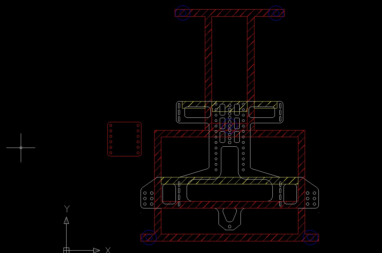

    Cards from the calendar.
    Steel -cut profile , tomorrow welding

    Laser Cut oxygen

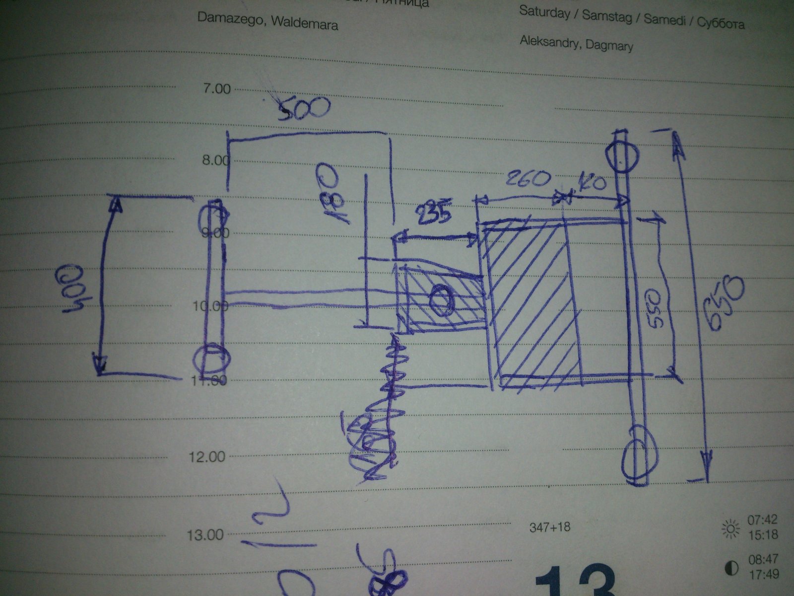

    A little better picture frame.
    White - handle seat
    Yellow - profile welded to the seat holder
    Red - frame profile (base)
    Blue - foot frame
    Sink hand drawing plates will be welded to the shaft .
    It will be secured with a screw.

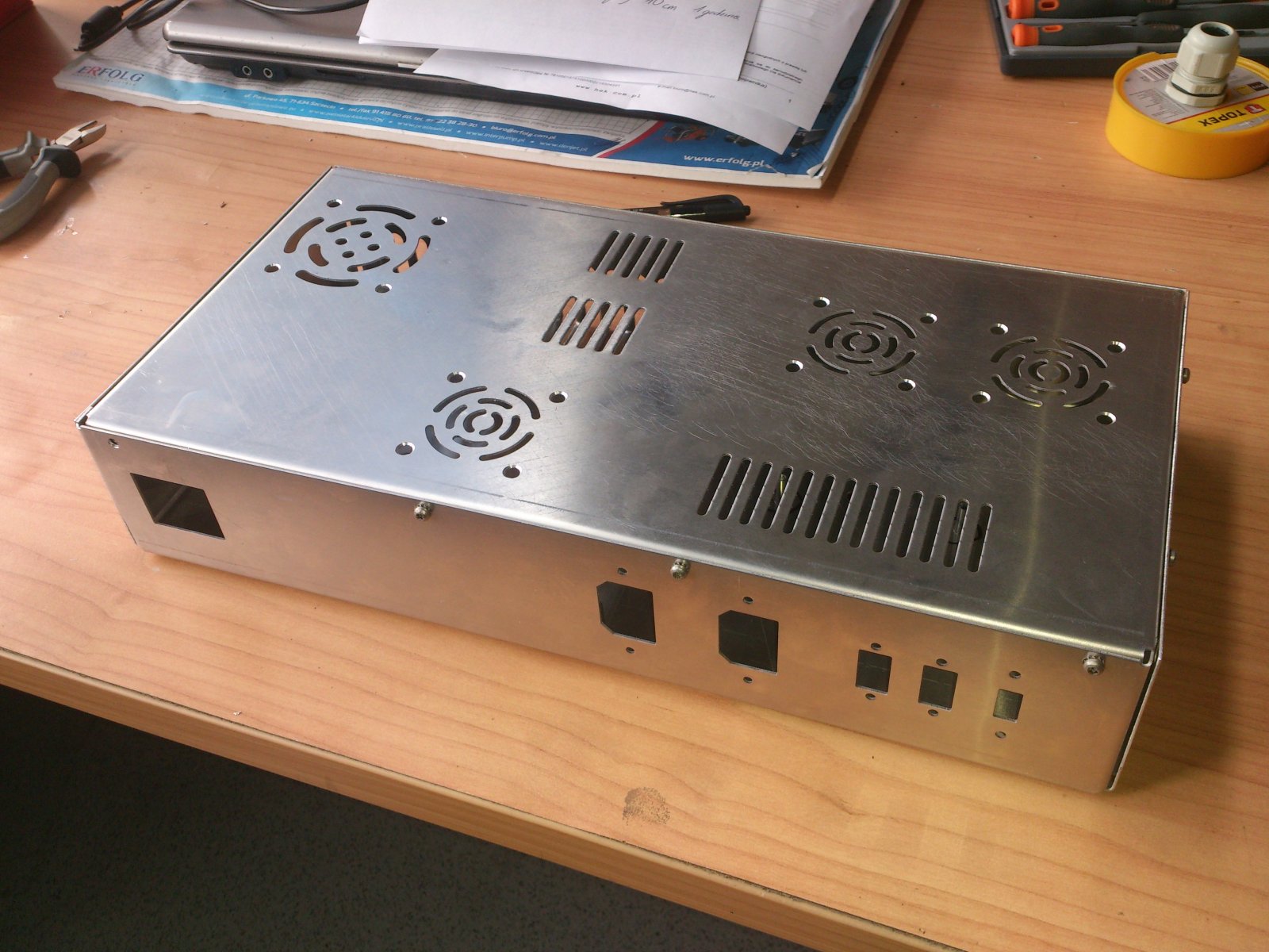

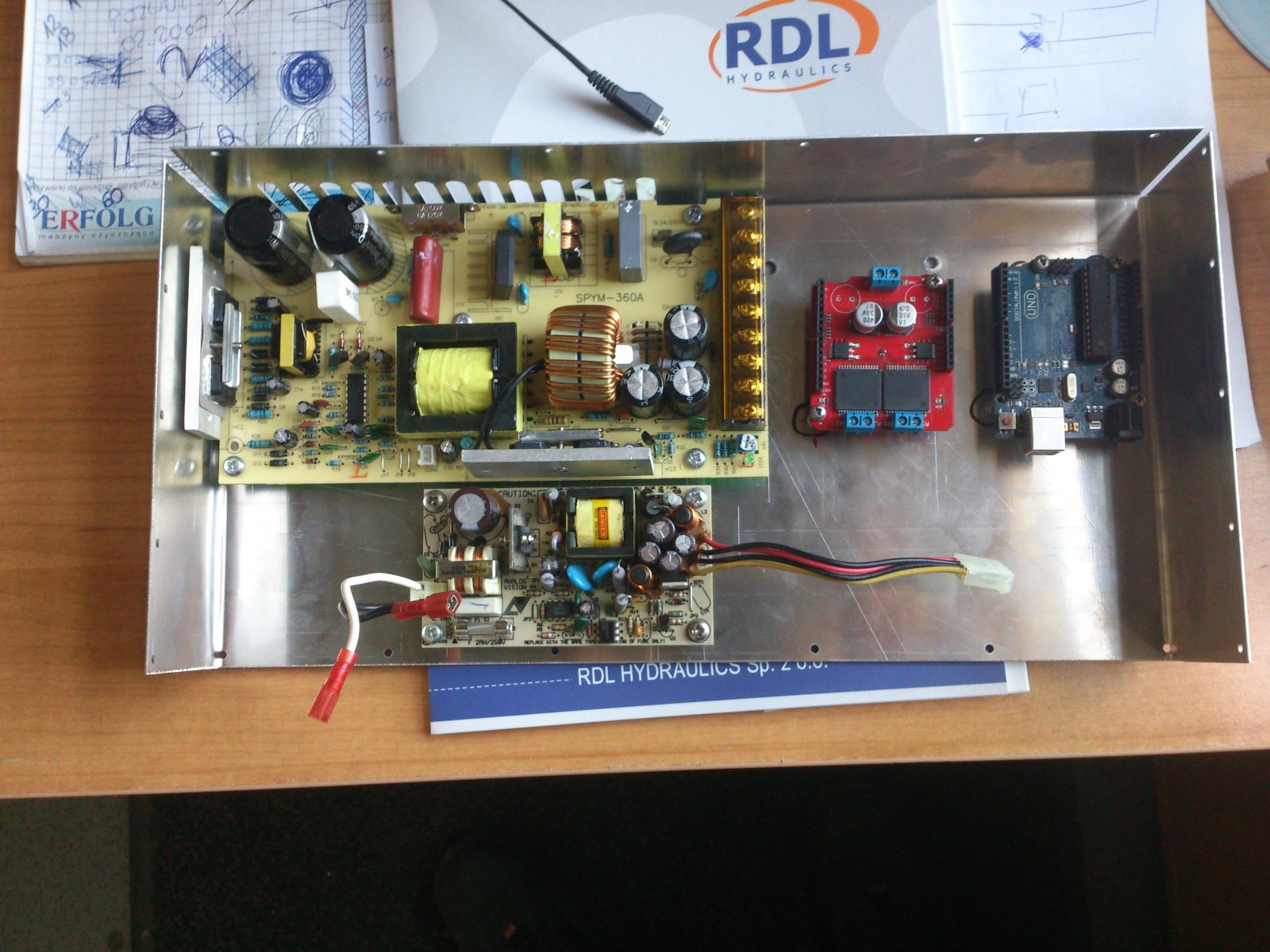

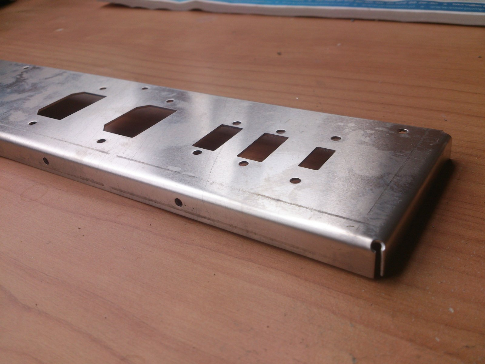

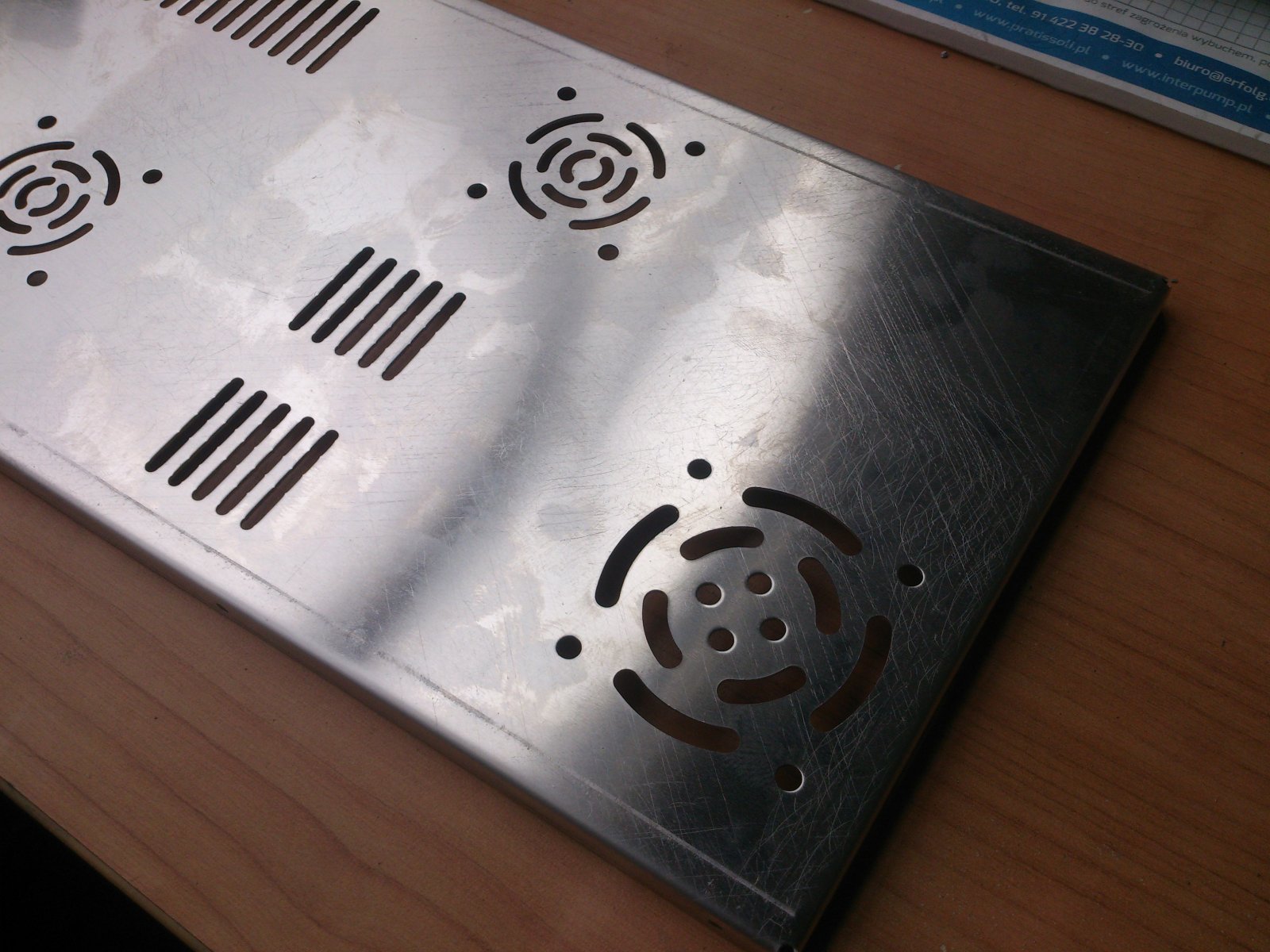

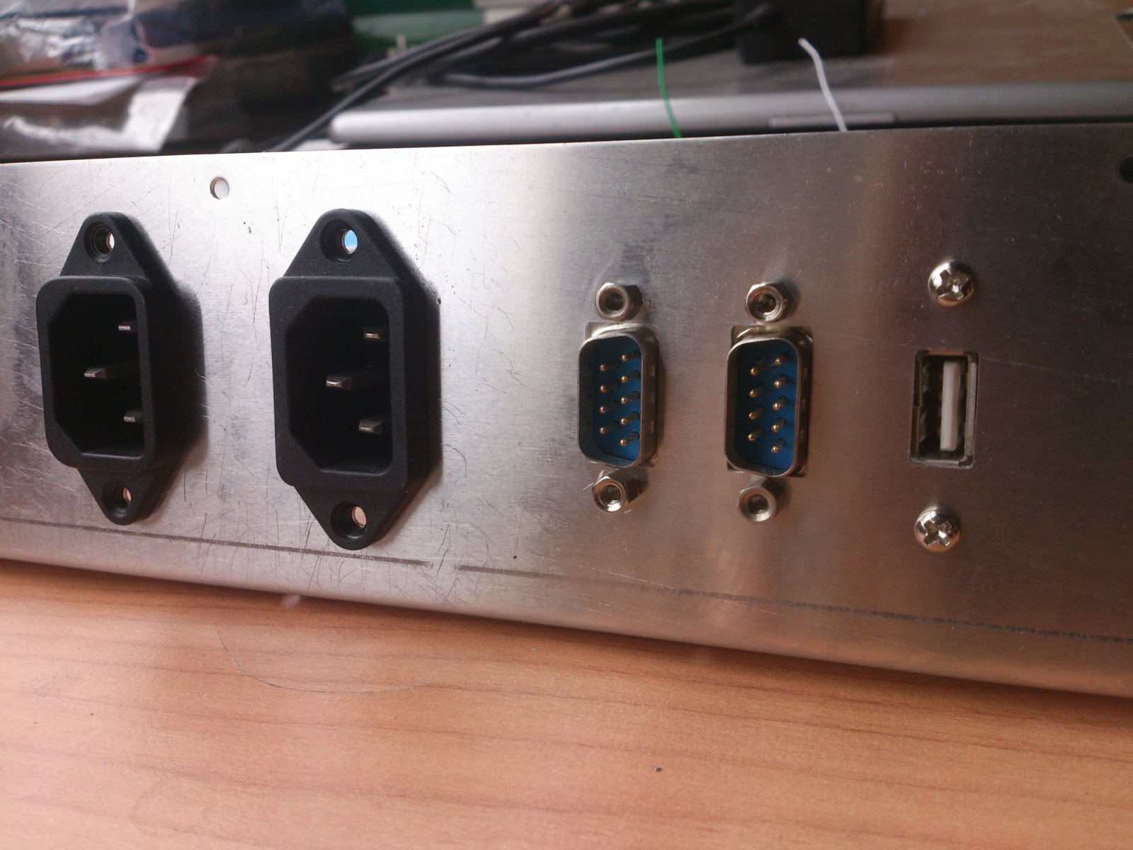

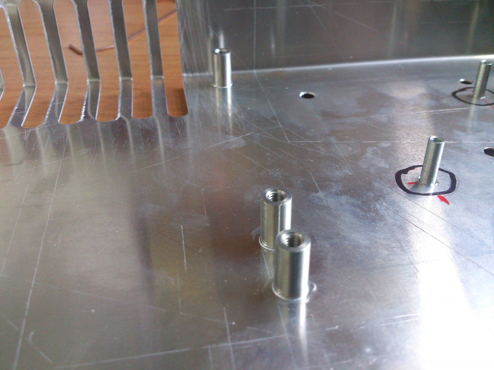

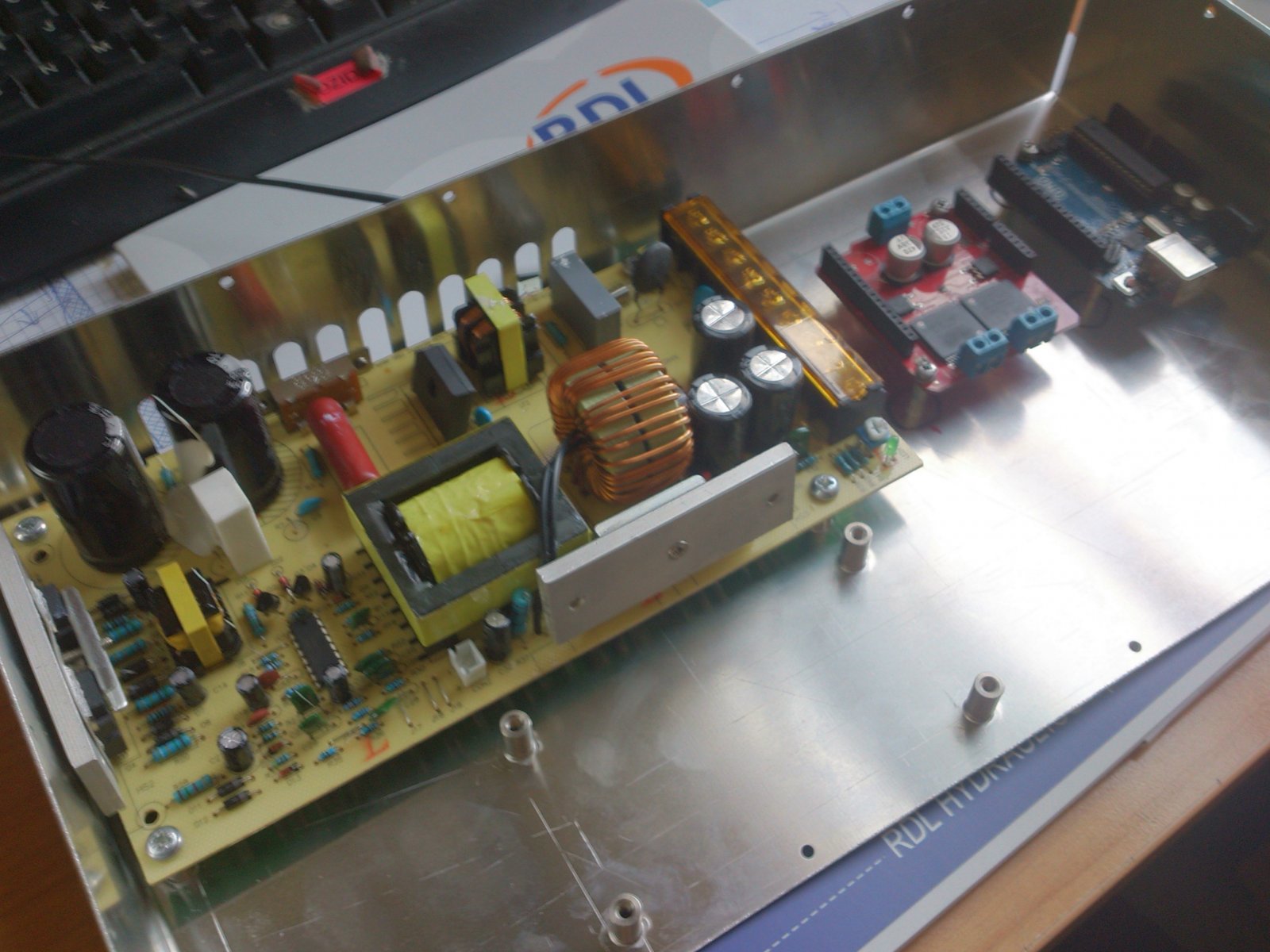

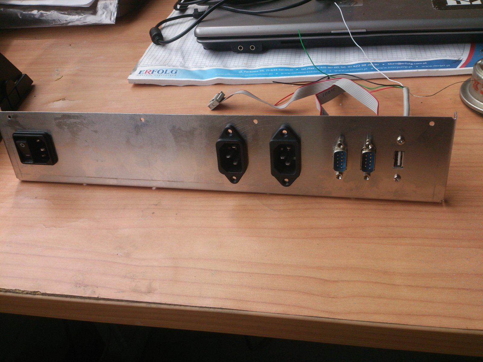

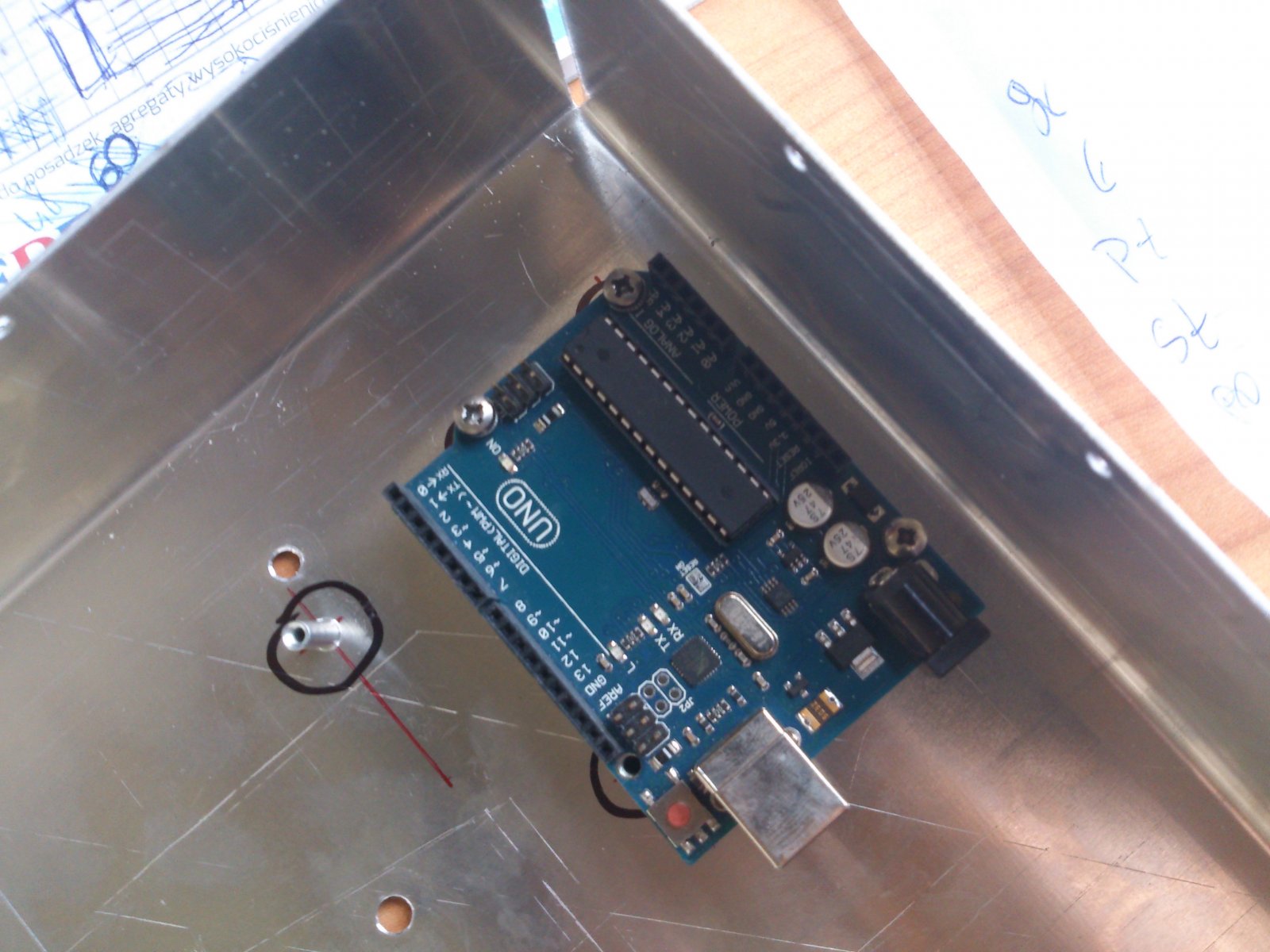

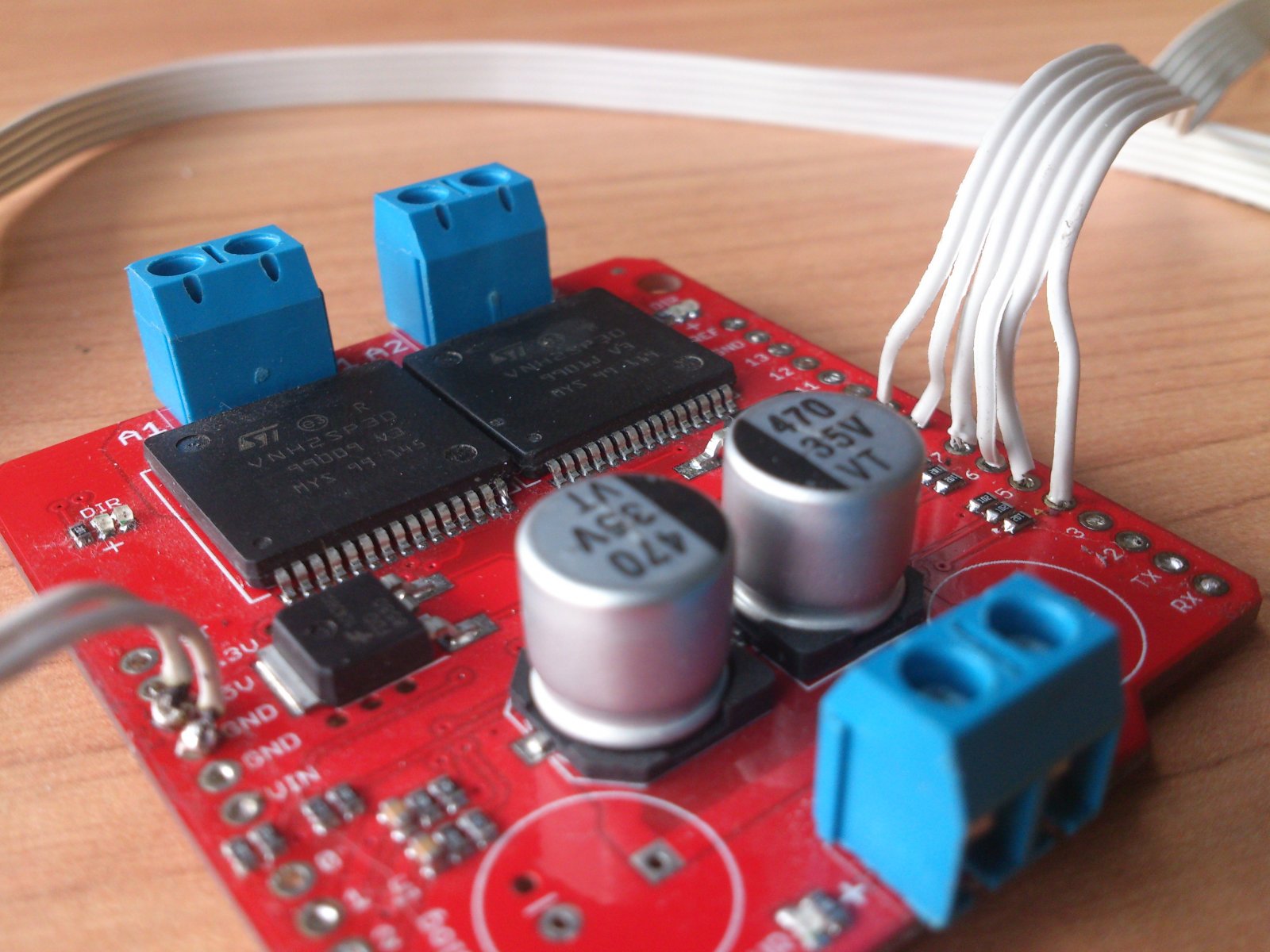

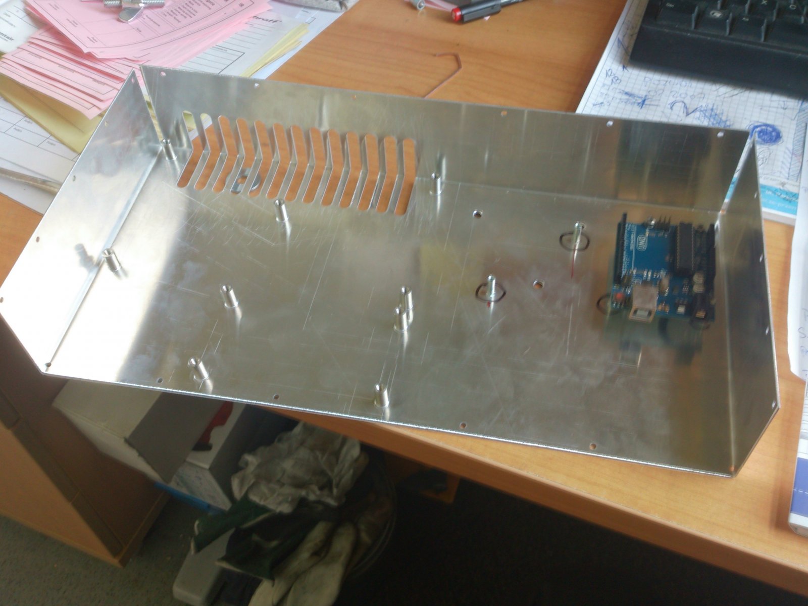

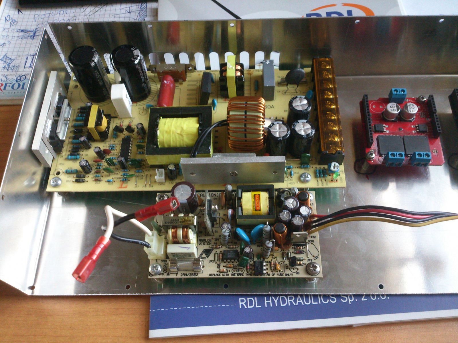

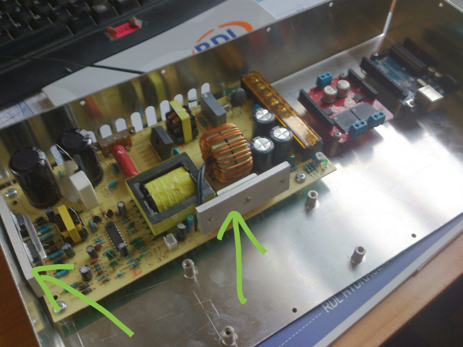

    Hello, I had a long break , I'm starting to work . I have a box electronics (aluminum 1mm , will be painted black ) . Installed power adapter 230v / 12v , separate power supply Arduino Arduino controller and Motomonster . I'm beginning to draw the cover top ( will be installed cooling fans ) , and the front cover of places to plug into the engine . I will keep sending photos . Regards Luke lukas12
  12. lukas12
    lukas12 Member
    Sep 16, 2015
    52
    Poland
    118Coins
    +35 / 0 / -0

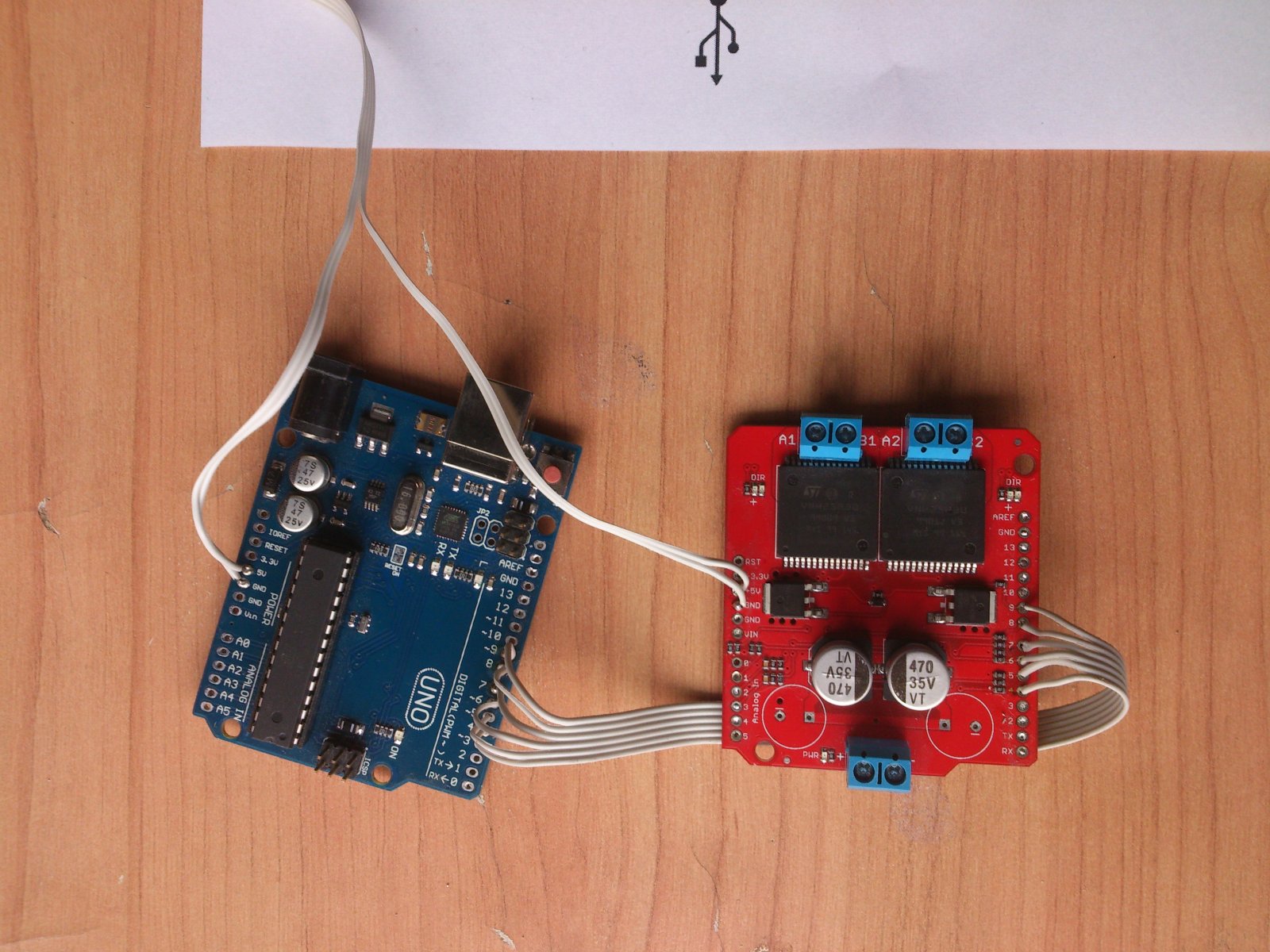

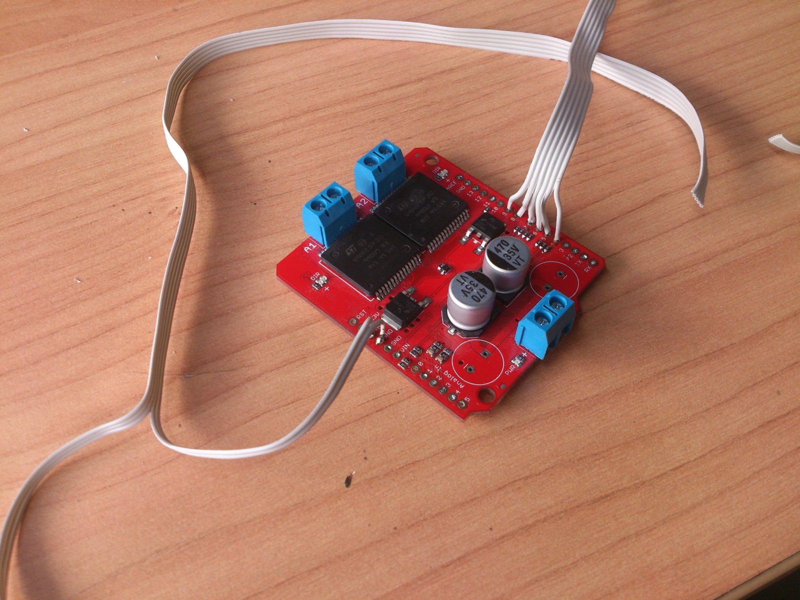

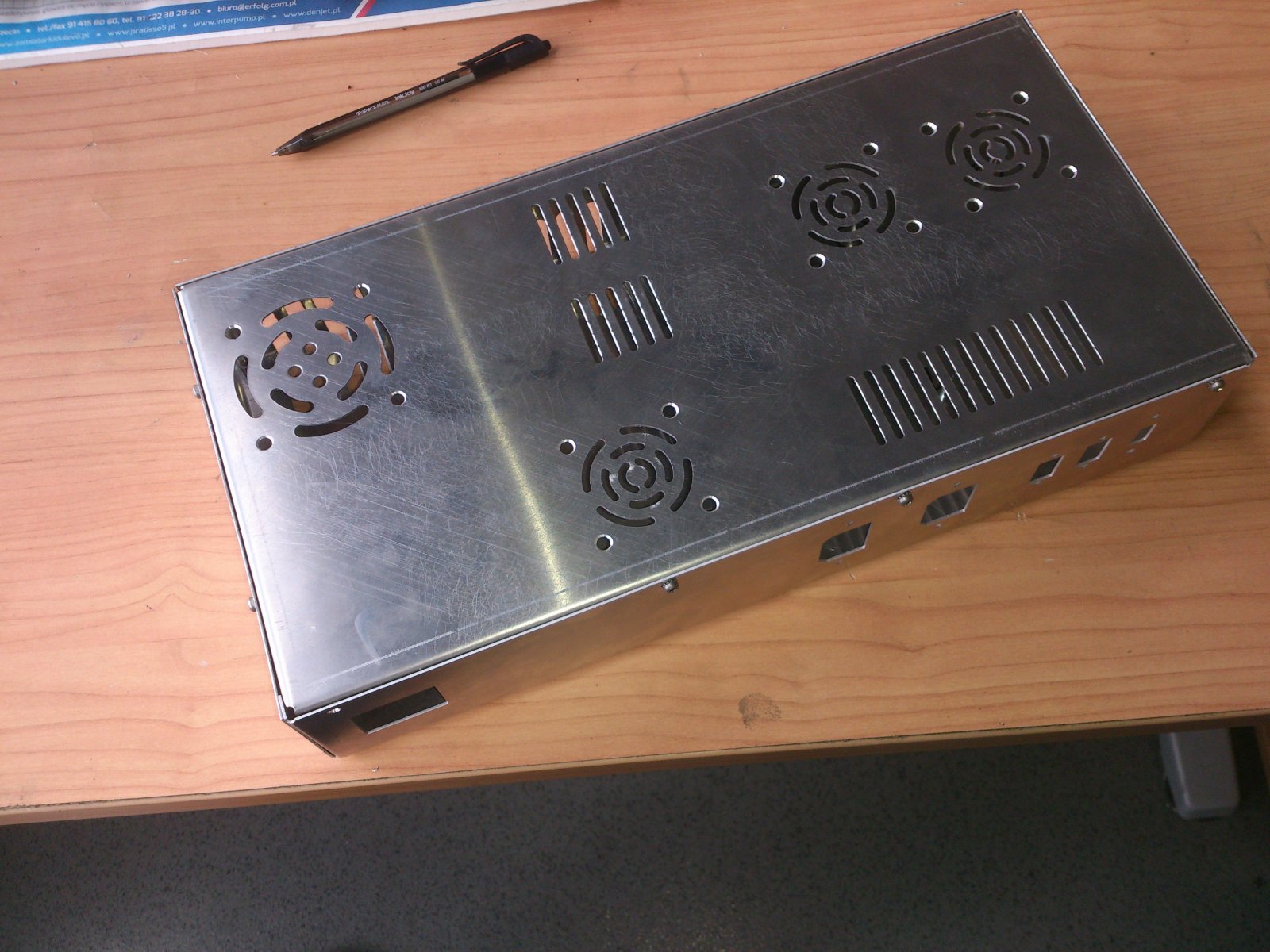

    I made the front cover , the top cover .
    I connected with Arduino MonsterMoto .
  13. noorbeast
    22,208
    154,711Coins
    +11,210 / 57 / -2
    Awesome sheet aluminum work :thumbs
  14. Nick Moxley
    17,057Coins
    +2,507 / 30 / -2
    couldn't agree more, VERY impressive Lukas. How exactly are you punching out all those shapes ? water jet ?

    Punch and laser

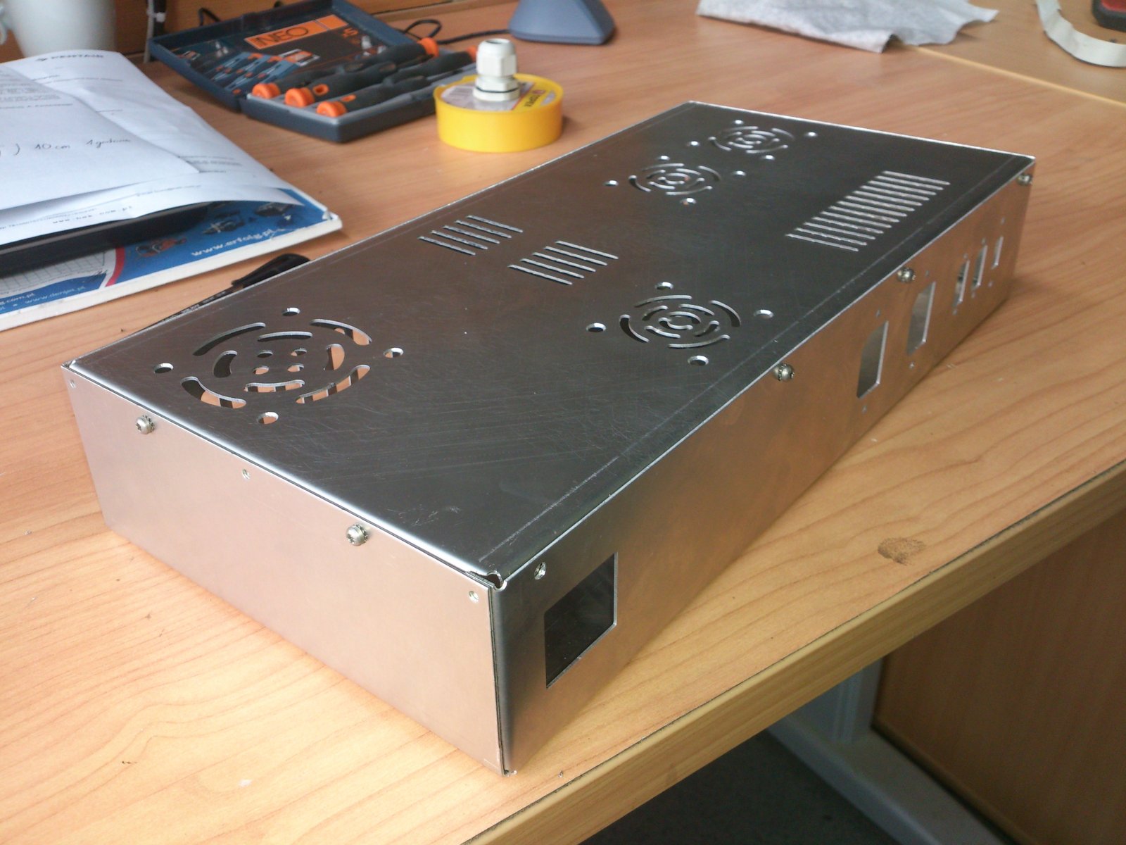

    Housing complex now only paint

  18. Icefox
    Icefox Member
    May 15, 2015
    82
    549Coins
    +29 / 0 / -0
    good job ! a remark in the power supply I would have left the bottom because the cover dissipates the heat or else it would be necessary to add aluminum heatsink as in the photo.
